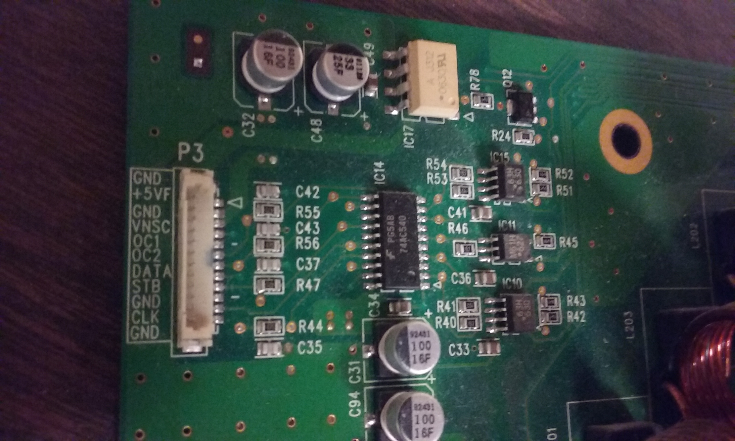

                        ysus board 6871qyh039b
                        no fuses blown, i found though one white pin GND/+5V/GND/VNSC/OC1/OC2/DATA/STB/GND/CLK/GND
                        the 2nd GND does not ground, but the VNSC pin grounds continuity with ground. is that my short?
                        if so what in pic do i need to change?
                          Re: Another Toshiba 42HP66 NO PICTURE, SOUND OKAY
                          here is the pic of the ysus where i think i found a short
