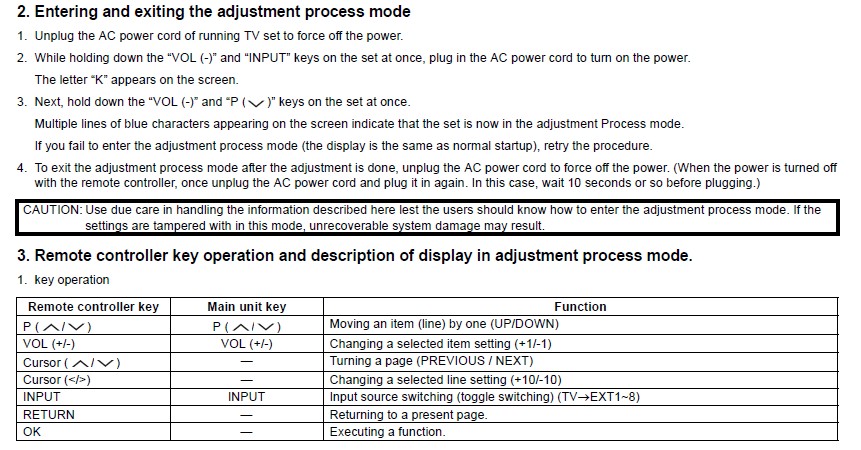

                  Re: Sharp Aquos Flashing Standby Light!

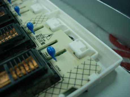

                  Defective lamp socket, making lamp errors
                  Affected Serial Number Range 902011112 - 907xxxxxx
                  try to get into the adjustment mode and look at the lamp error
                  You could also look at the inverter board and the sockets
                  Often you could see that its slightly burnt
                  Often second or third from the top

                    i've stripped off the inverter board and there are three points where it looks like its burnt on the sockets ( No. 2 , 3 , 7) can these be repaired?
                      No, two way to fix it.
                      Change 18 sockets or as I have seen in another forum
                      use a coppar wire wraped around the tube.
                      Sometimes the inverter is so badly burnt, so you even
                      had to change it, to make a good contact.
                      Dont forget to reset the lamp error in the service menu.
