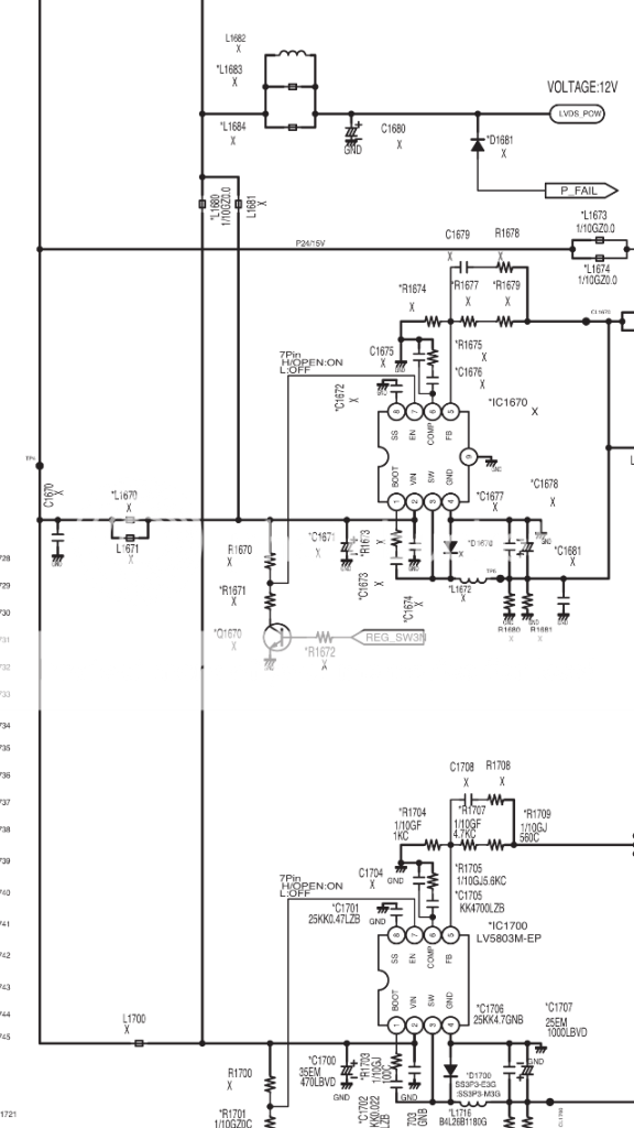

dp42740 sanyo green light on/off power fail mode

    well i got the digital main board in Friday and installed it and still the same no 13v on audio everything else i have checked is good on the board i checked c1671witch is the straight line wiring to the audio and it hot but is not on the audio pin point . i am confused because my symptom is a no power issue and i have replace 3 boards totaling 120.00 so far .. power board , digital main board , SS board . and all that should have brought this baby to life . i know how to read a print and diagnose pretty well .. and scotts manuals are pretty in depth straight line wiring diagrams .. bought my boards from shop jimmy.com and i have requested tech support from them since no one cares about these types of threads .. im starting to think im all alone here and all the TV techs that are out there are laughing at me cause its something simple and stupid .... for fuck sakes man !!! help a brother out !!!

                Re: dp42740 sanyo green light on/off power fail mode
                I had a few minutes to look over the board prints for your main board and I found Ic001, also another inductor the 13v appears to travel through. I marked them up on shapshots of the manual for you. the other 4 chip inductors I marked I believe are on the output side of the audio chip but doesn't hurt to check them too. I also marked up a couple resistors and inductors you could test on the feedback circuit. would be easier with a full schematic but we don't have one.
                  Ok I have a full schematic off Scott's manuals , that's where I found most of the info . But I will trace it out and report back ! Thanks !
                      ok i have tested (new board) and starting with first pic ie: 1,2,3
                      on diode setting on my meter
                      p1-1c001 p-6 = 0.6 ohm
                      L001/L002/L003/L013= 0.6 OHM
                      there is no cap above c1671 and the circuit is open point to point
                      2nd pic
                      off the p24v-15v - R1673 = open no continuity
                      R1673- L1681= 0.3 ohm but across the diode it is open.
                      3rd pic
                      L1676 the first 2 down = (open across no continuity) , but on front side following the line it has continuity
                      L1675= .01 ohm
                      L1674= .01 ohm
                      L1673= .01 ohm
                      R1683= .440
                      D1671= .618
                      should i start a return for shop jimmy.com for this new board ? cause i feel like it is bad .. but why ?
                          no p1of speaker plug - p6 of chip
                            what pin on chip is supposed to have power?
                              pin 8 has 15.6vdc
                                Ok so chip is not shorted and has power, feedback circuit it is, can you upload that section of the schematic so we can see what is in between that chip an d1761?
                                  i cannot for the life of me put this straight line big enough to read on here .. i went to toms service manuals and look at page 47-48
