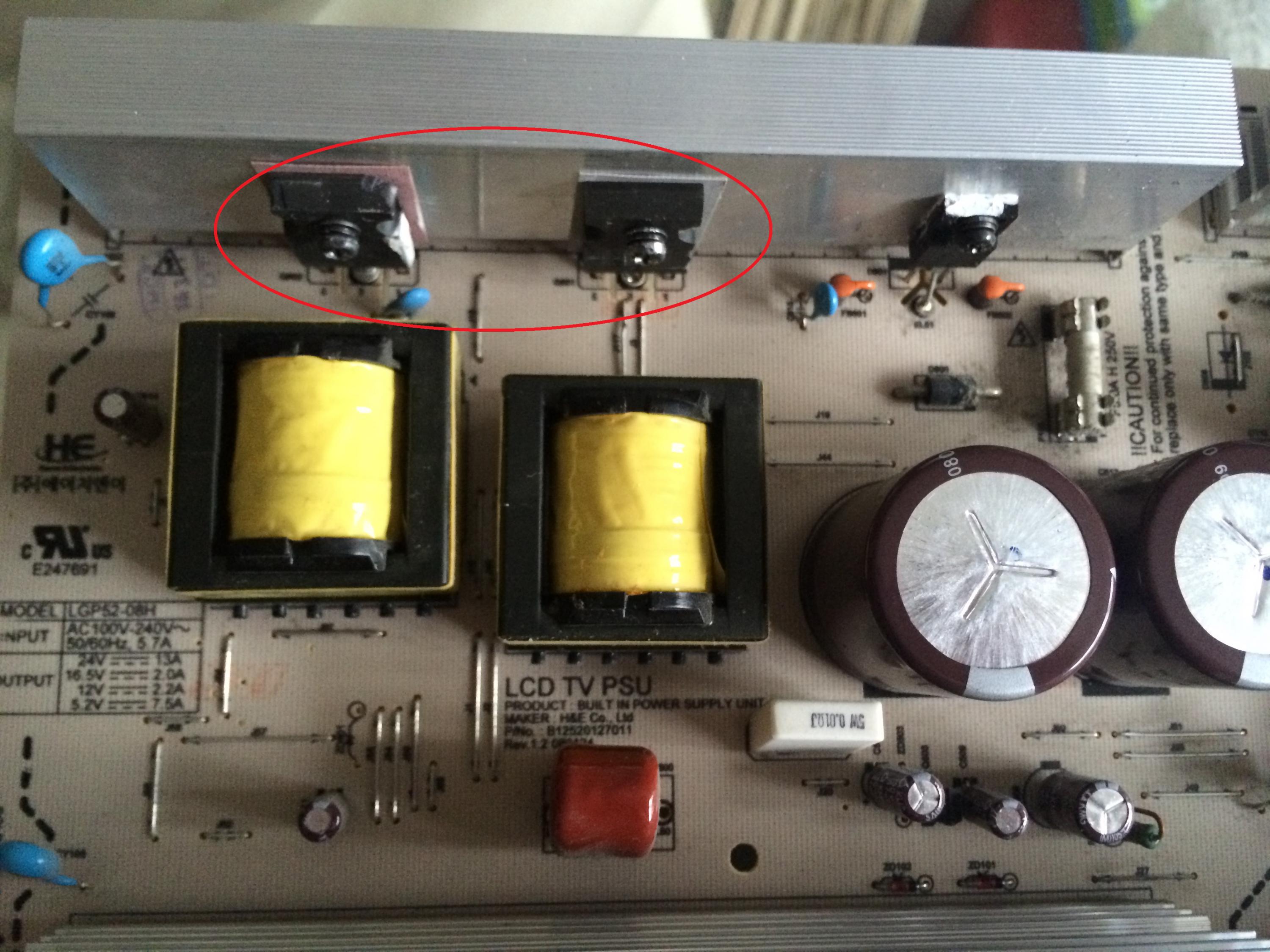

    Got this 52lg70 with no standby light and no 5v voltage. Opened up, found blown main ac fuse, and two shorted W20NM60 FETS. Replaced everything, plugged it in, still nothing.
    Rechecked everything after, Fuse tested good, new FETs tested good. Measuring across main PFC caps, there is low voltage, about 3V. I also noticed that I don't think the main voltage is reaching the bridge rectifier either (low voltage across it, both in dc and ac). the rectifiers seems to ohm out good though. Any thoughts on this??

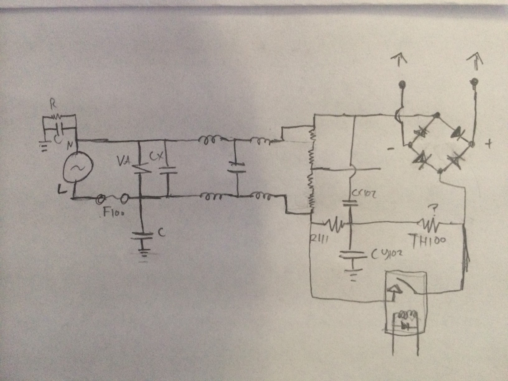

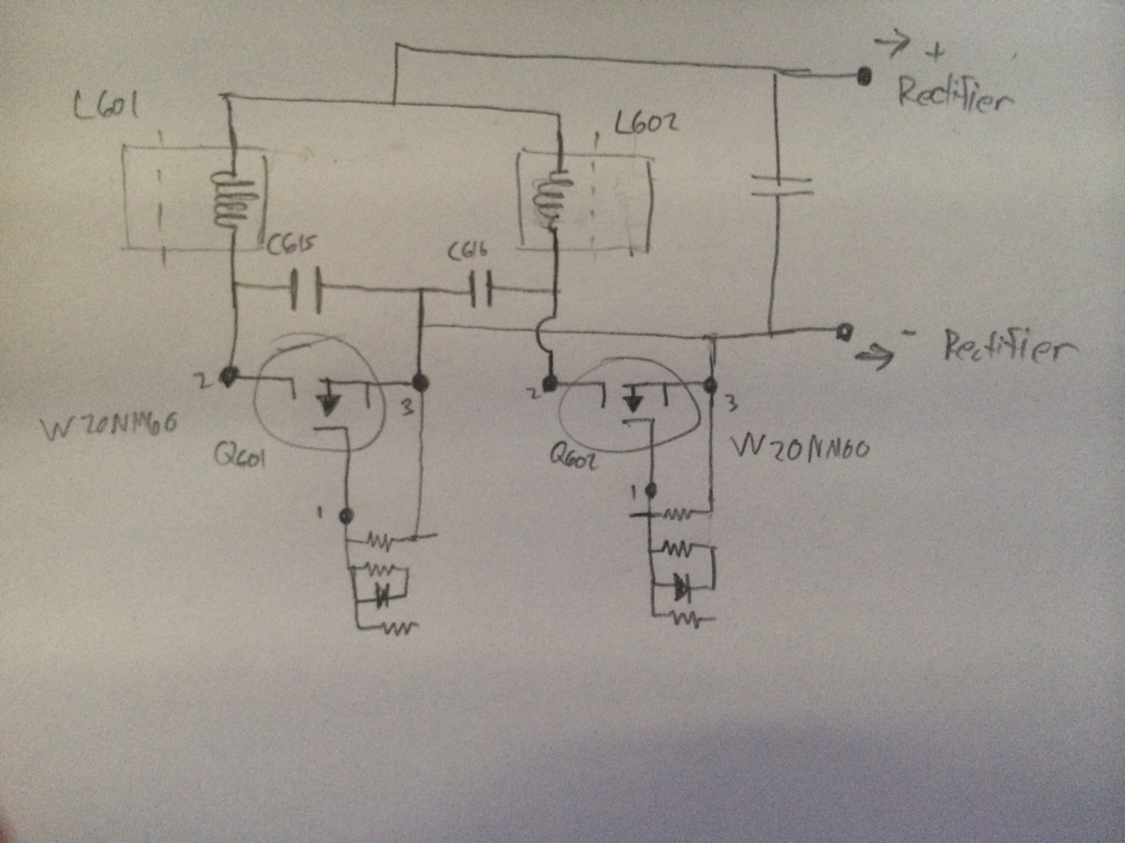

              Still trying to figure this out... I tried to draw out the schematic for the problem areas. Probably not perfect though.

                Is TH100 good, i.e. not open circuit? (Should be 10 ohms cold)
                The common mode inductors on the input, are they OK?
                Do you have ~120VAC at the AC terminals of the bridge?
                  Re: LG 52lg70 PSU problem, no standby
                  Th100 is good,, and the inductors are good also. But I do not have the 120vac on the AC terminals of the bridge.
                    R111 good?
                      R111 is labeled as 5W 6.8ohm J. Is that just 6.8 ohms? I'm getting an open circuit reading or its just out of range for my meter. Seems suspect I think?
                        That would be 6.8 ohms, you need to figure out why it went bad, it could be random failure but also shorted MOSFET, or bridge rectifier.
                          Ah I see, I did have those two shorted FETS (W20NM60) when I first opened it up
                            What you can try is removing those FETs and installing a new resistor, set should come out of standby and have sound. No backlight of course, but it will prove the rest is working.
                              Just put in another 5w 6.8 ohm resistor and removed the FETs. Standby light is back! And looks like its able to turn on normally just no backlight.
                              Just put the FETs back in, and looks like it seems to be working normally again.
