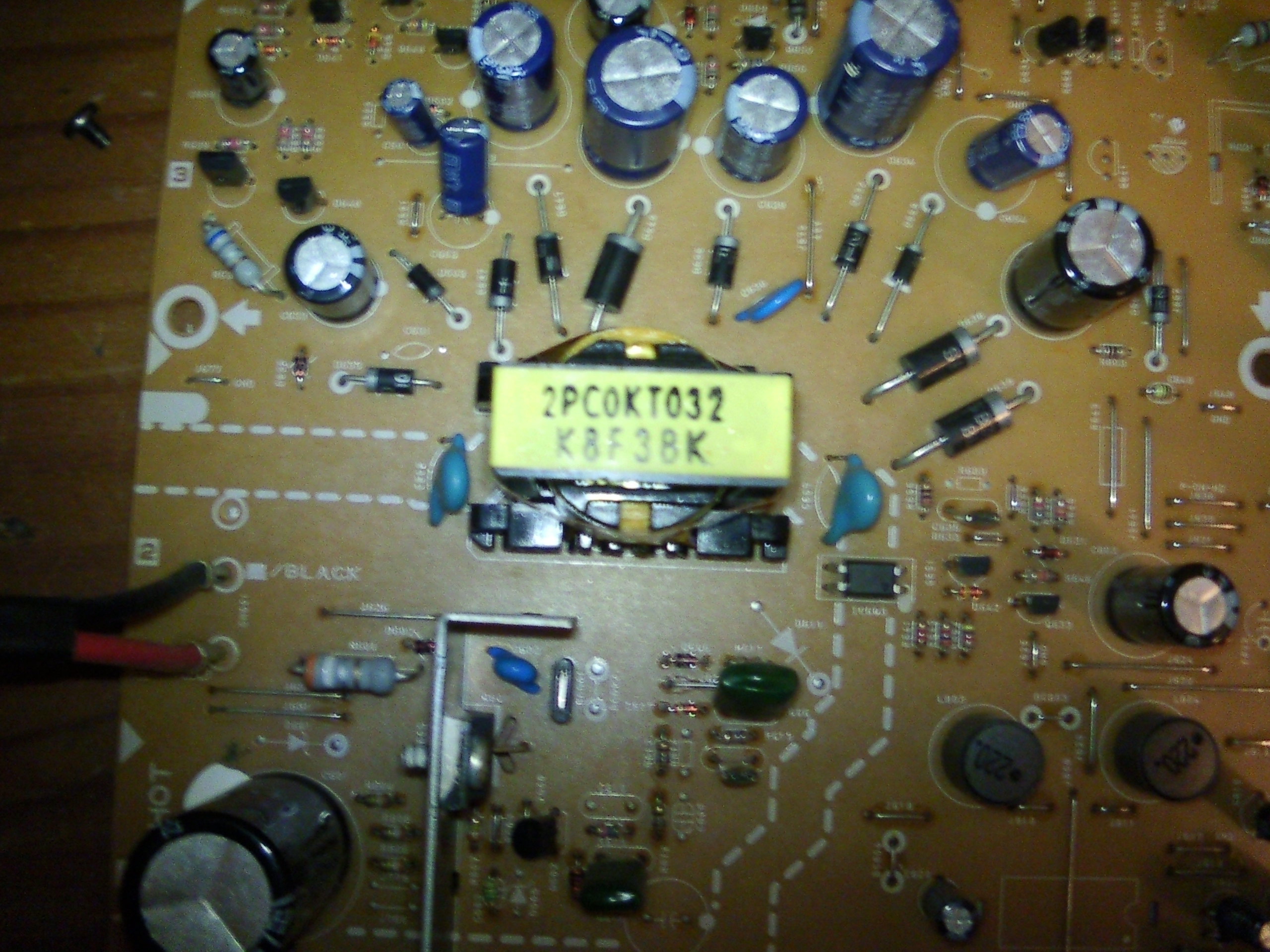

    Hello.
    Picked up a couple of sets this afternoon. Long drive for a headache(s).
    Got the one fixed (Mit 62" DLP projection) Looks great, but out of date. Hope to flip it quick to recover the expense of the trip to pick up.
    The problem child that is confusing me. Emerson BLC320EM9 A
    Picked this one up at the same time for cheap enough. Screen does not appear cracked (which is not my #1 check, look for damage)
    The TV does not make any effort to switch 'on'. Upon plugging it in, I do hear a relay click. (I get that if I allow everything to discharge over time and then plug it in)
    No clear signs of cold solder joints, or bad capacitors. (They actually all look very good).
    I'll post up some photos in the daytime when I get back to being fully awake. I've done some basic poking around.
    Does anyone have a schematic of the power control system(s)? Fuse tests fine. The set just has zero power? The gent I picked it up from stated he was watching it in the morning fine...shut it off... Came back several hours later and it was totally 'dead'.
    Like I said. I'll get some photos up in the morning. Just wondering about direction to take. I did some basic voltage checks on the main board. (Power board I think (and I'll double check this) puts out 170vdc to the main board. The main board has a transformer and a series of diodes and such. Most of the voltage readings at the various test points are odd. One points to a blown diode (hence asking for a schematic) It's the 3.3vdc line. It's reading 1/2 of the expected voltage.
    Just asking for ideas. I'll post the photos quickly in the morning.

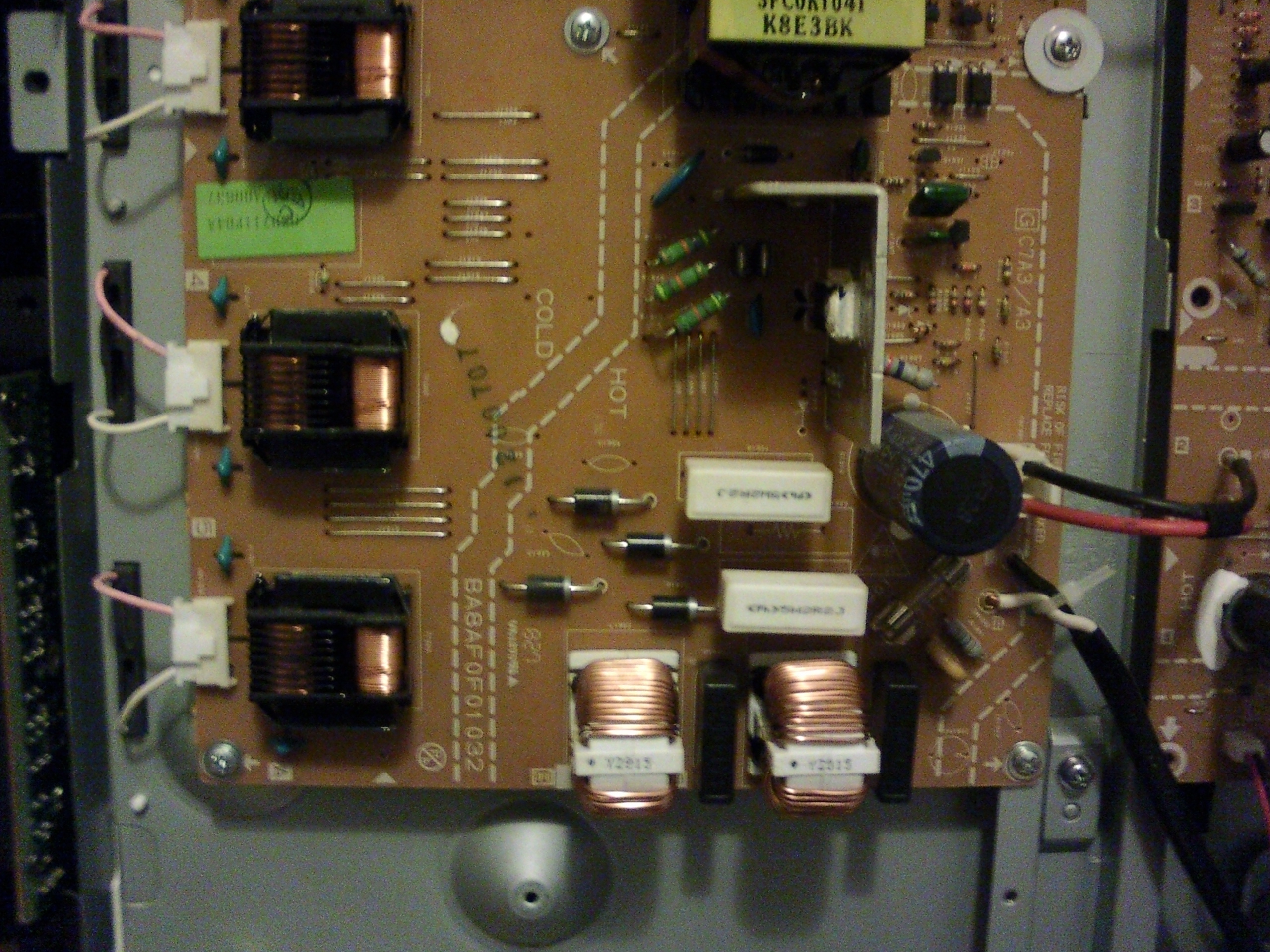

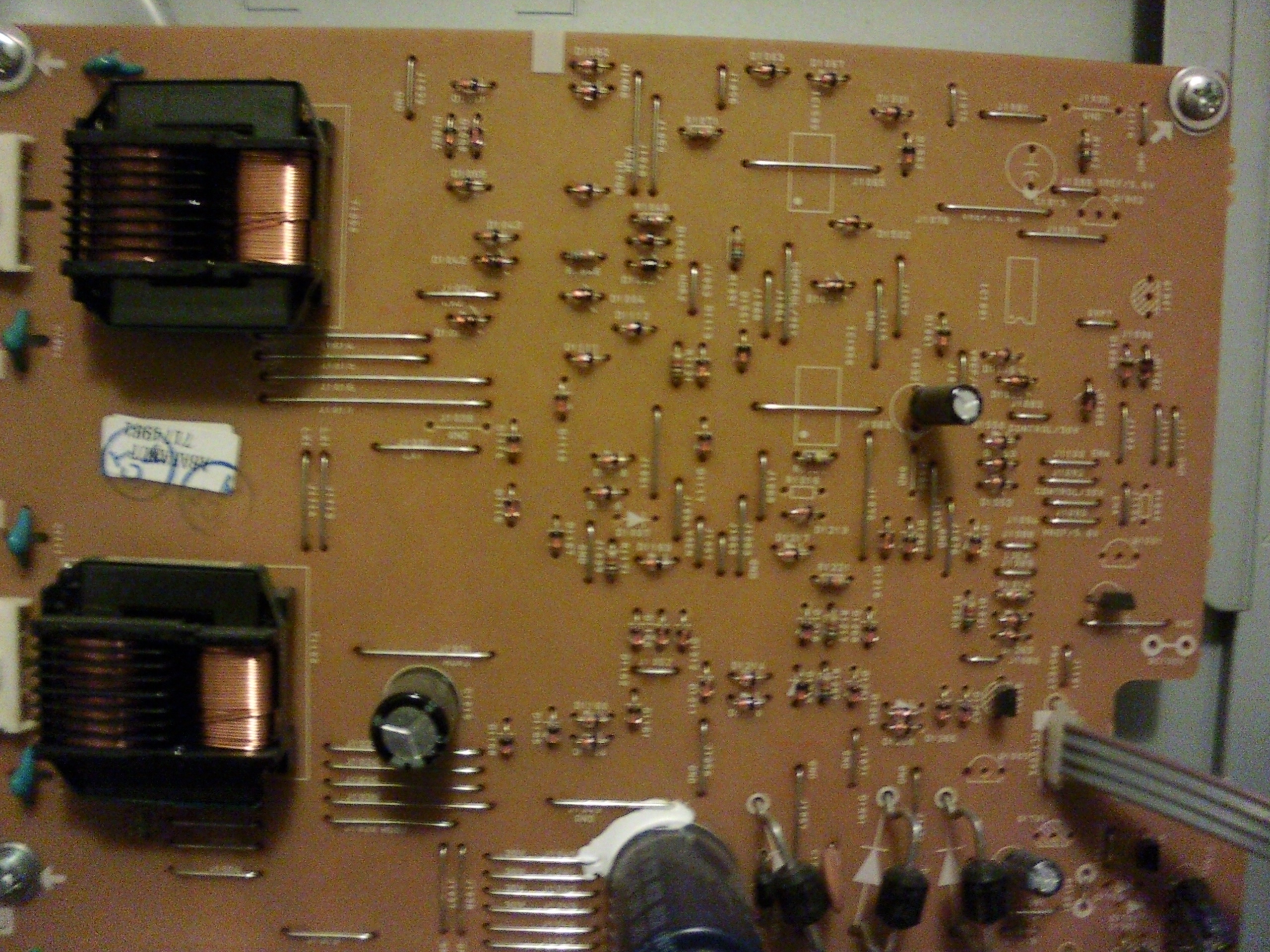

              Hi everyone.
              Sorry about dropping off. We had a few issues to correct with the 62" DLP--wife complained about getting headaches and the colors just not sharp and generally yucky.
              She found out why the guy stated "I took care of my baby and pulled it apart to clean it monthly". This guy must have been smoking some interesting stuff. The rear of the screen was coated with a yellowish goo crud. (I'm a former smoker, had to give it up after the heart attack a few years ago. So I know what smoke 'tar' looks like) Along with heavy dust on the mirrors and lens. I'm proud of her for figuring it out. 4 cleanings later with soap and water--and we're talking rinse and repeat... Whites are pure and crisp and the picture is 100% again. (not bad for a $30.00 DLP first generation.)

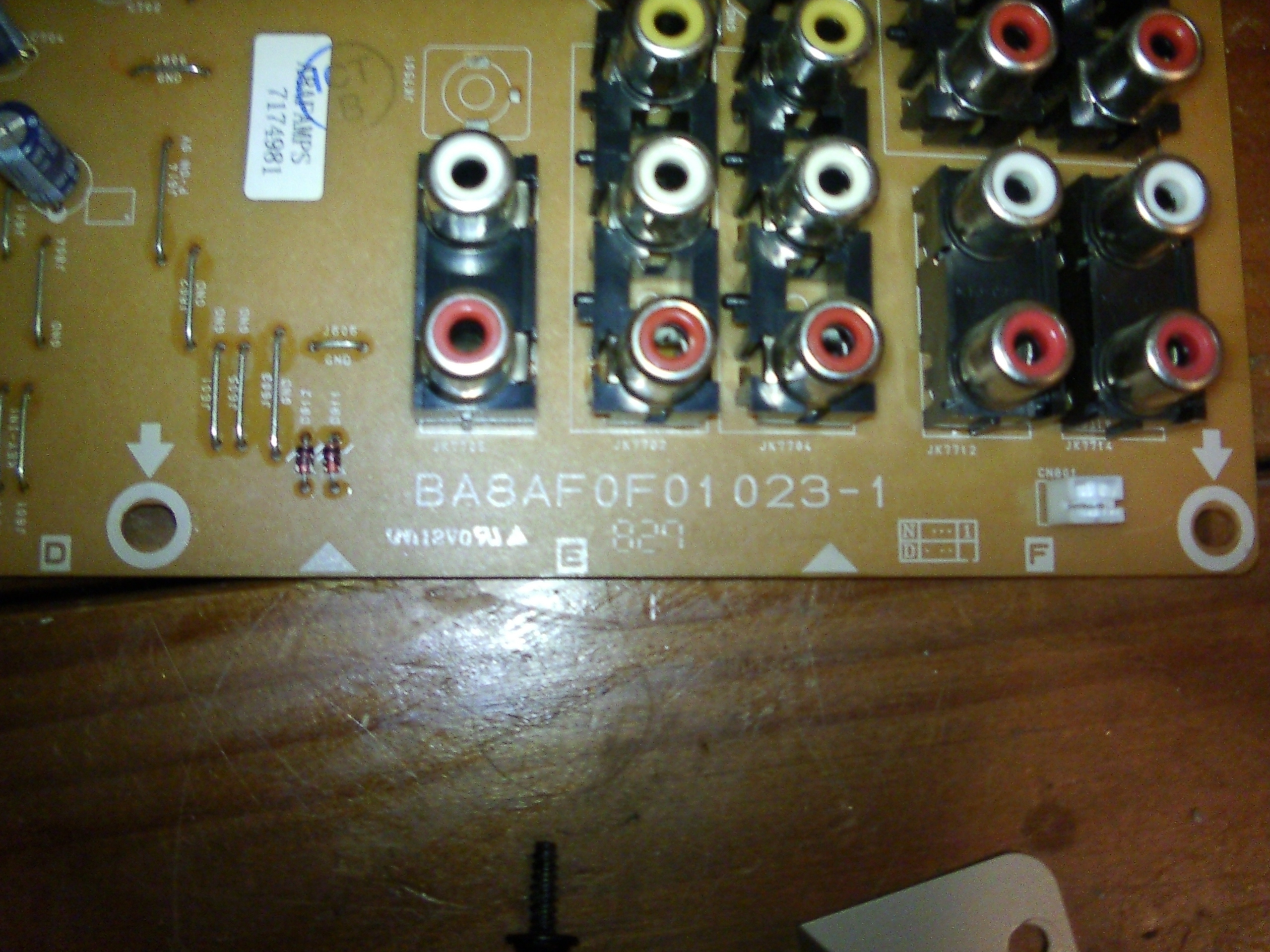

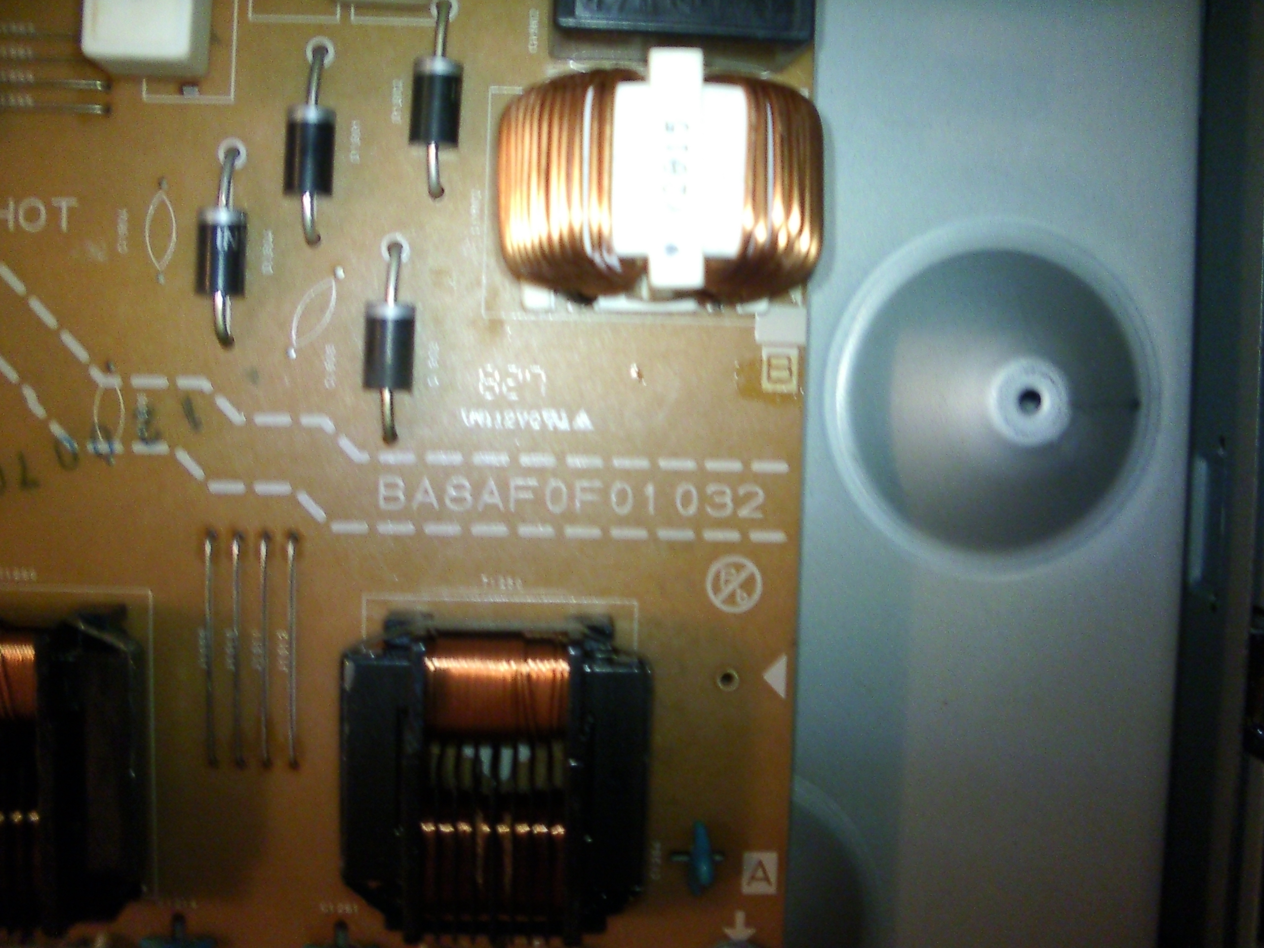

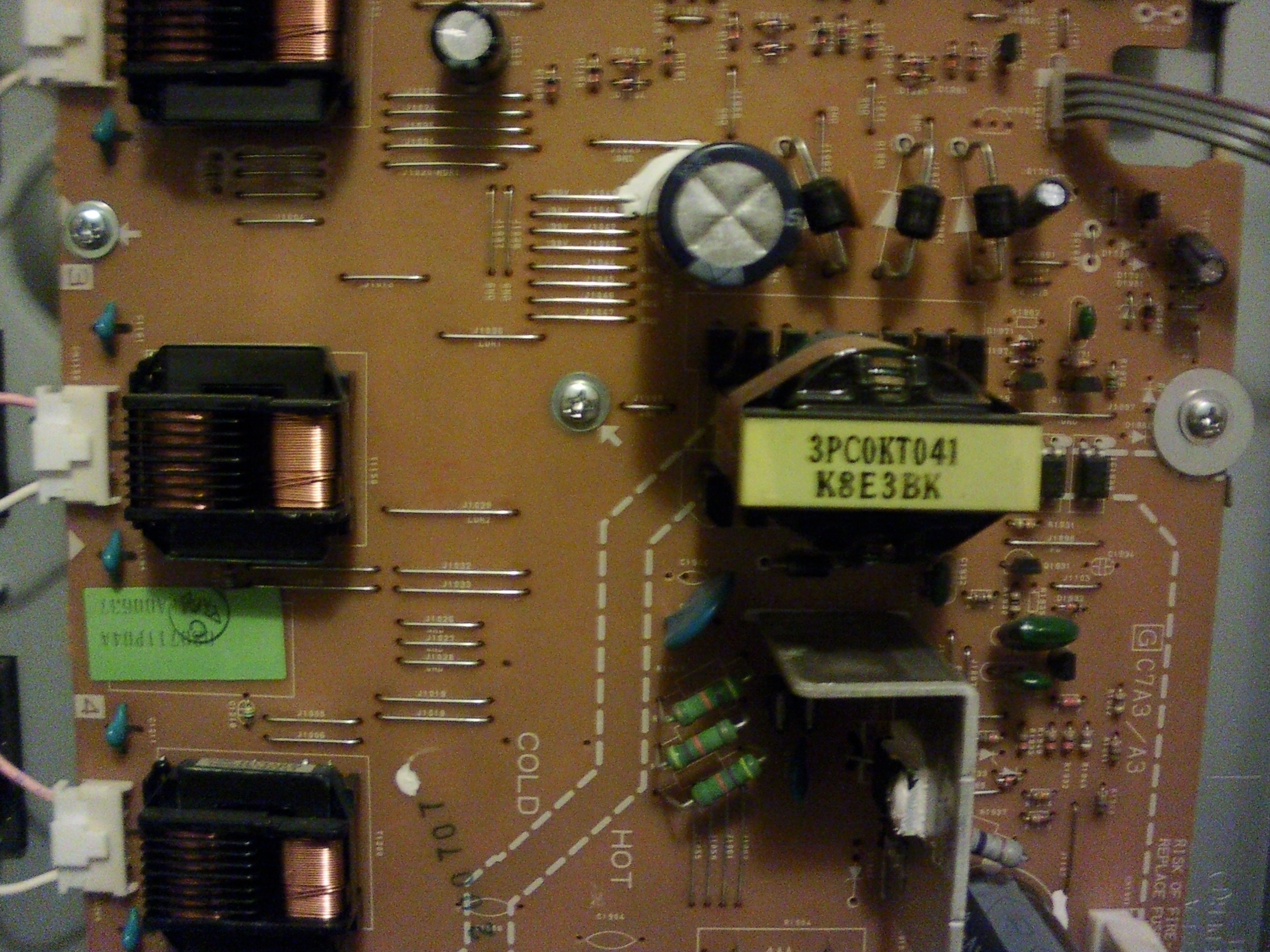

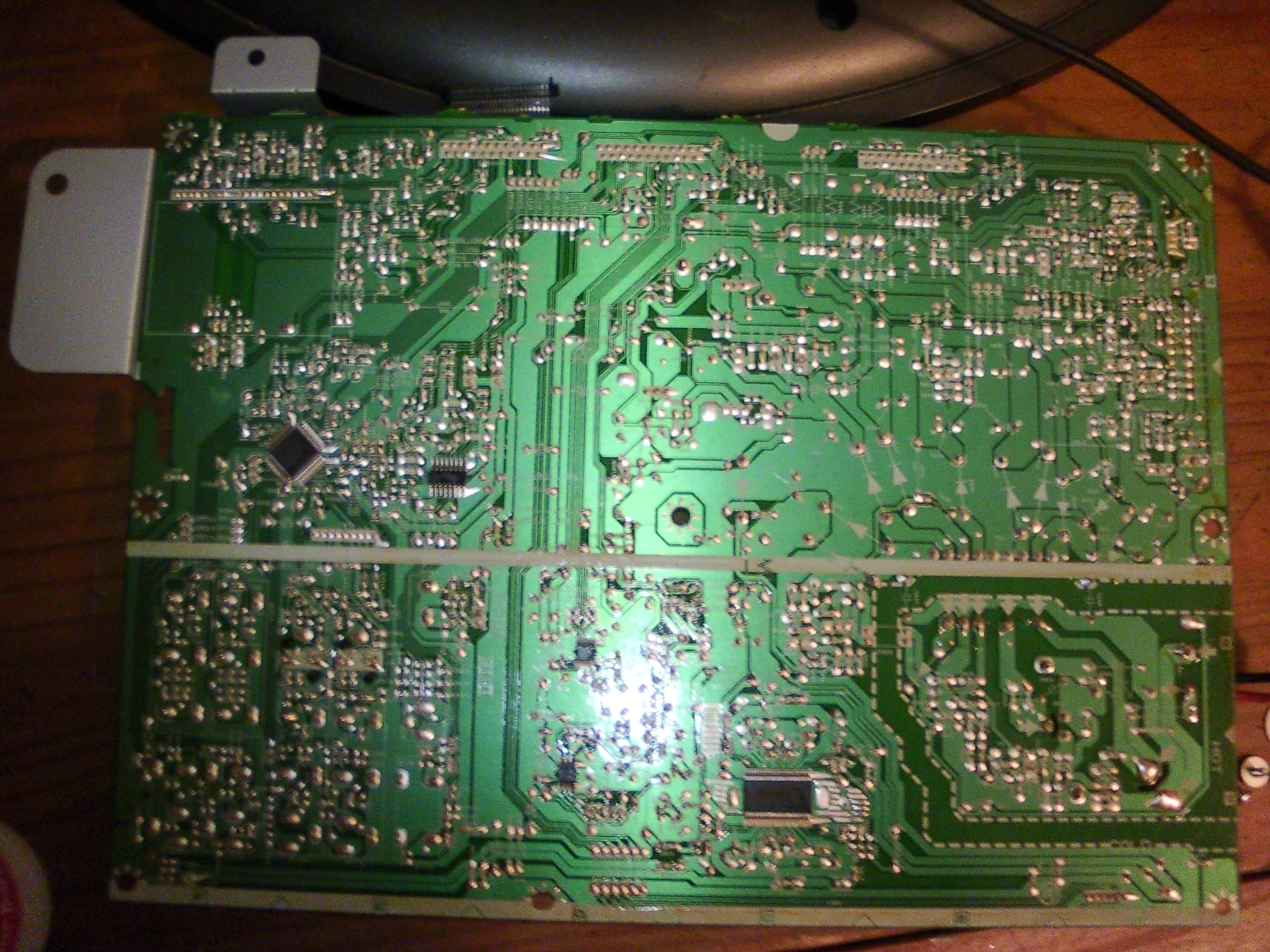

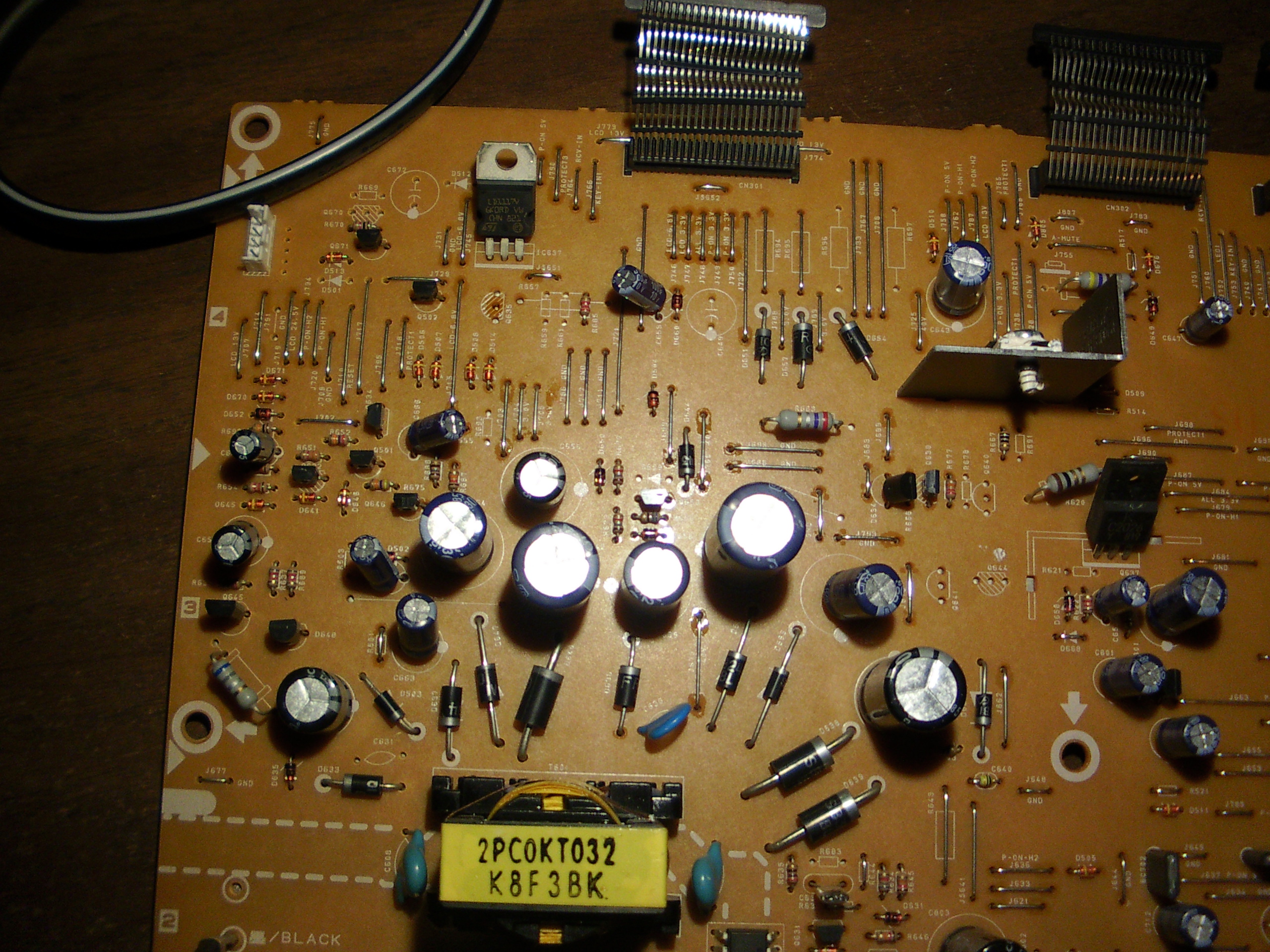

              Okay Okay. Back to the POS..errr....Emerson set. The photos had major issues trying to upload. (server errors out the bazoo) So I will attempt again.
              Upon measuring the main power connector from the P/S and Inverter board, I have a steady 170VDC. It does not change or waver. (pushing the power button has no effect) I ran out of time doing voltage checks, save one. The 3.3vdc line at the test points reads "1.8vdc" (Same reading with the 'test points' on the board and using the chassis ground.) Also not sure if this means anything? But when I do the 170VDC check, it's only across the B/R wire. I go to chassis ground and both lines are dead. I do a direct test--and then get the 170vdc. Not sure if that means anything?
              I did find complete used boards on eBay and ShopJimmy also has them pretty cheap for the main board. (The one with all the RCA connectors) I must admit to being a bit lost here. Also the 'transistor' (I have yet to pull the number off to see exactly what it is) under the small transformer on the main board. This has the 170VDC sitting on the center terminal. (pin 2) Pins 1 and 3 show no activity.
              If the issue is with the main board, would I be better off just saying 'screw it' and ordering in a known good replacement and call it a day? The P/S board is much more expensive and I did note one 'transistor' had been replaced prior. I'm good at spotting fresh looking solder that has been clearly not done at the factory. (Also they got sloppy with the white paste...)
              I of course would love to see this through from the board level repair. Have to swap out my multi meter today however. I did some diode testing around the board and my meter reported a lot of 'open' diodes (to be honest...it reported ALL of them open while tested in circuit. And that would be just about impossible for ALL to fail at the same time). FR104's where the ones I was mainly testing. 50 V, 1 A, Fast Recovery Rectifier Diode is what the spec sheet states. Each one I tested in circuit read full 'open' on the test. I pulled a leg off the board just to see if something odd was going on with the circuit causing issues--it read 'open' again. So I will be changing out the meter just to be sure.
              Oddly enough the meter has been acting up a bit. It's a Tenma brand meter (probably spelled it wrong). One of the higher end ones we use for work. When I did the test of the 2nd leg of the part under the small transformer--the one that read 170VDC? The meter made a couple of oddball beep sounds and then the 'beeper' was making some odd static type sounds.
              I'll bring the basic Rat-Shack meter home this afternoon.
              Thanks again for the help!!! If more pictures are needed, just let me know which areas to focus on. The server appears to be working normally again for pictures.

                    Sense most of the problems seem to be with the main board--and NOT the inverter power board? That's the cheapest option is to get an eBay board and just call it a day.
                    And just so everyone knows. I replaced the fuse with everything plugged in. Fuse blows. I remove the two wire power connector (the one with the 164VDC across the pins) and the fuse does not blow.

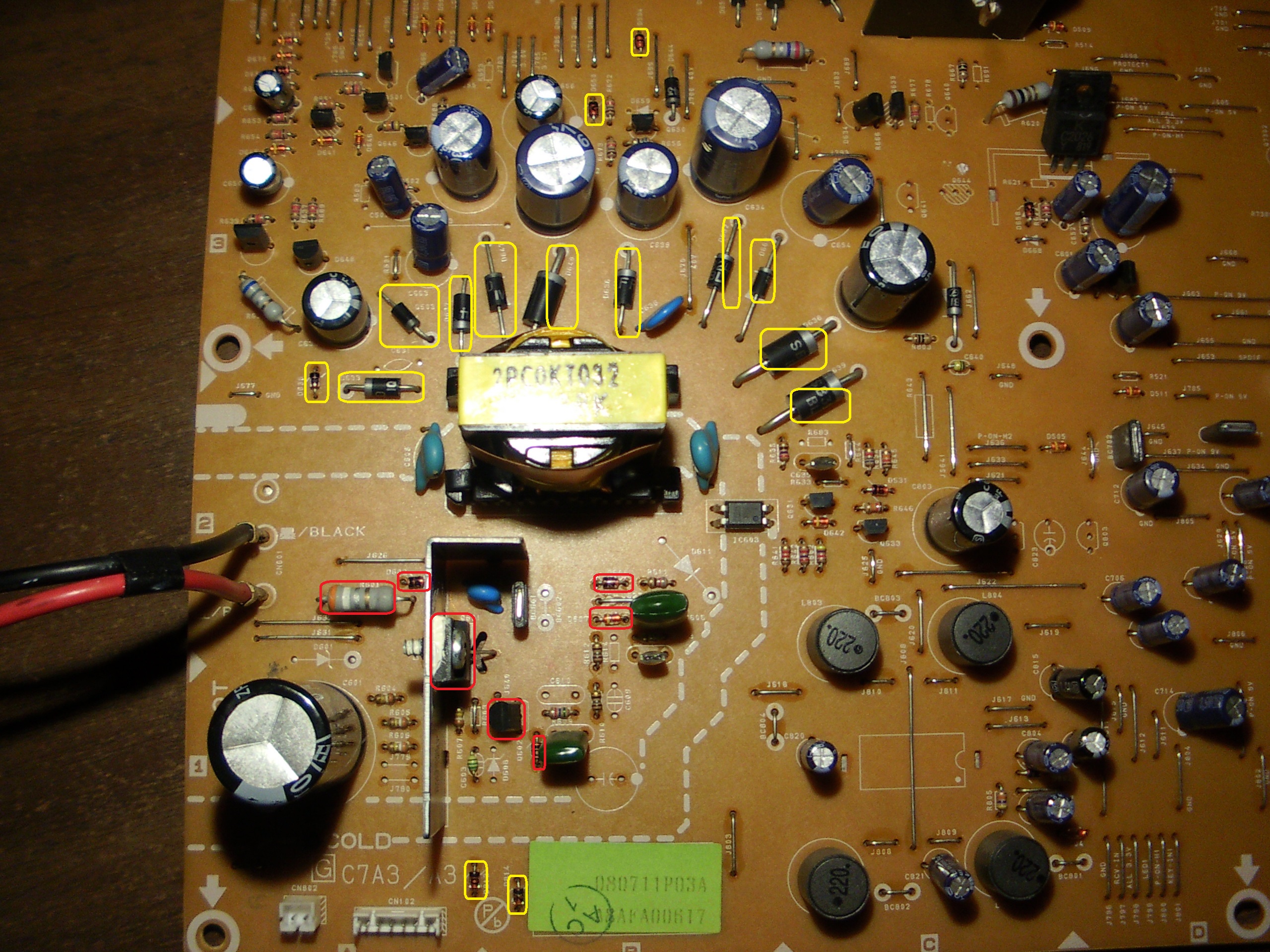

                      If you shorted the mosfet it will blow as many fuses as you care to feed it until the current limiting resistors go open anyway. I would check the gate circuit, you will need to replace the drive transistor as well as the mosfet. Check all the zener diodes and small signal diodes around the fet. Most commonly Ive found a shorted output diode on all but one of these funai power boards. If you can get a focused well lit picture I can circle the likely suspects for you.
                      Added the service manual as well below

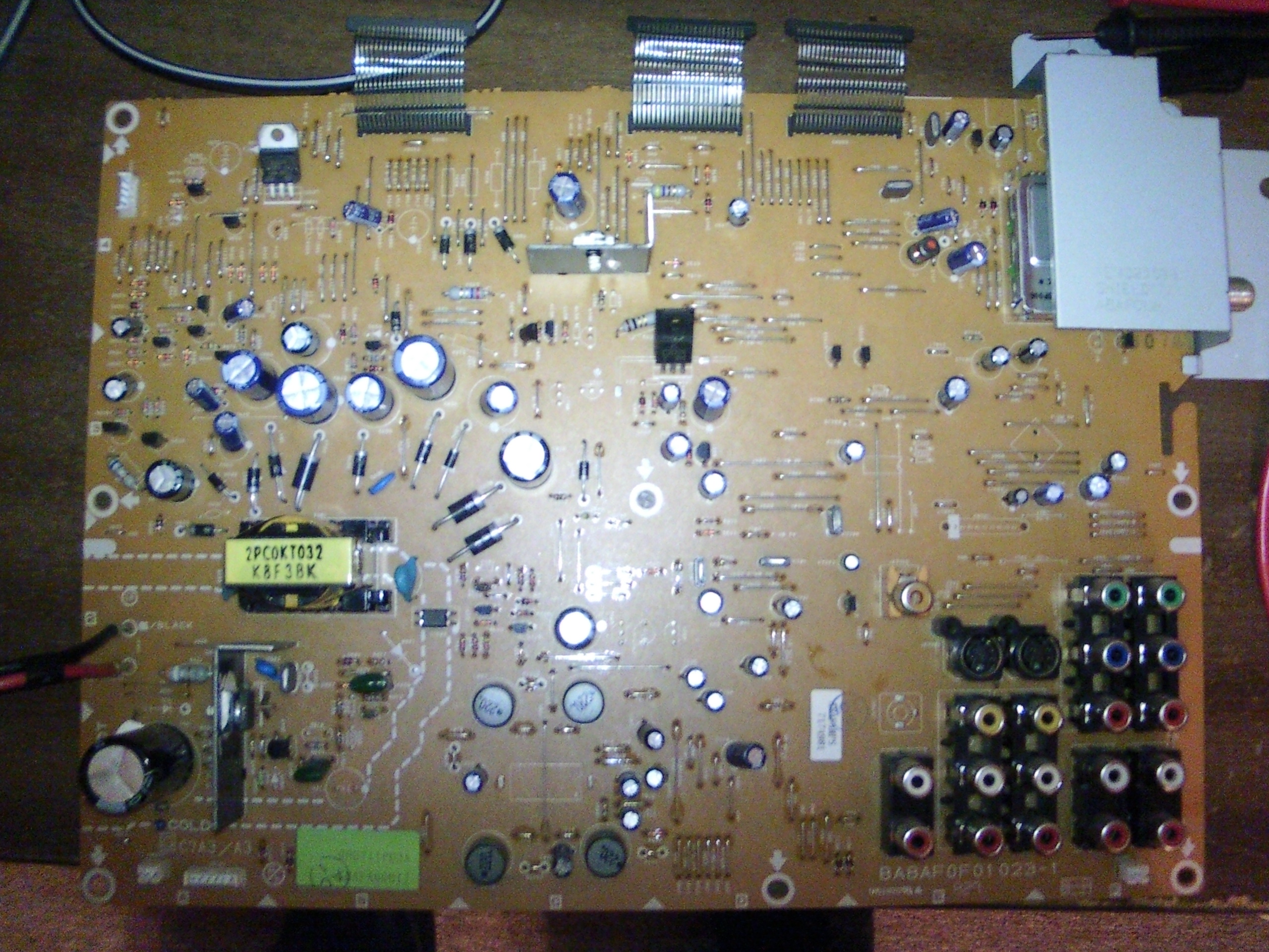

                      • Tedybear
                        • Sep 2014
                        • 104
                        Re: Emerson BLC320EM9 A
                        Sounds like a plan to correct the blowing the fuse part. The first part of course is that the set has voltage to the board (164-170VDC) But does not seem to have any other voltages present, other then 1.8VDC on the 3.3VDC line. Everything else is dead. Well...it's dead now LOL. My shaky hands didn't do it any favors.
                        I'll post up a piccy in a bit. Just the main power 'hot' area, right?
                        S-
                        • Caleb
                          Smokin IC's
                          • Feb 2013
                          • 645
                          yes just a good clear pic above and below the hot section

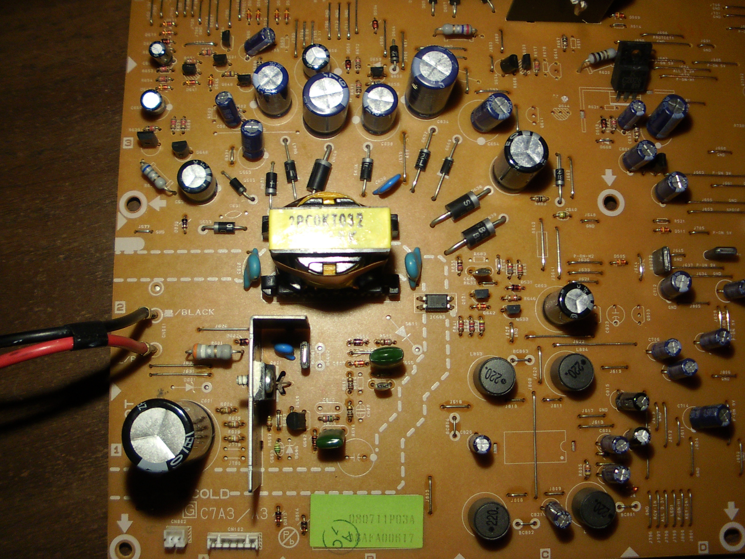

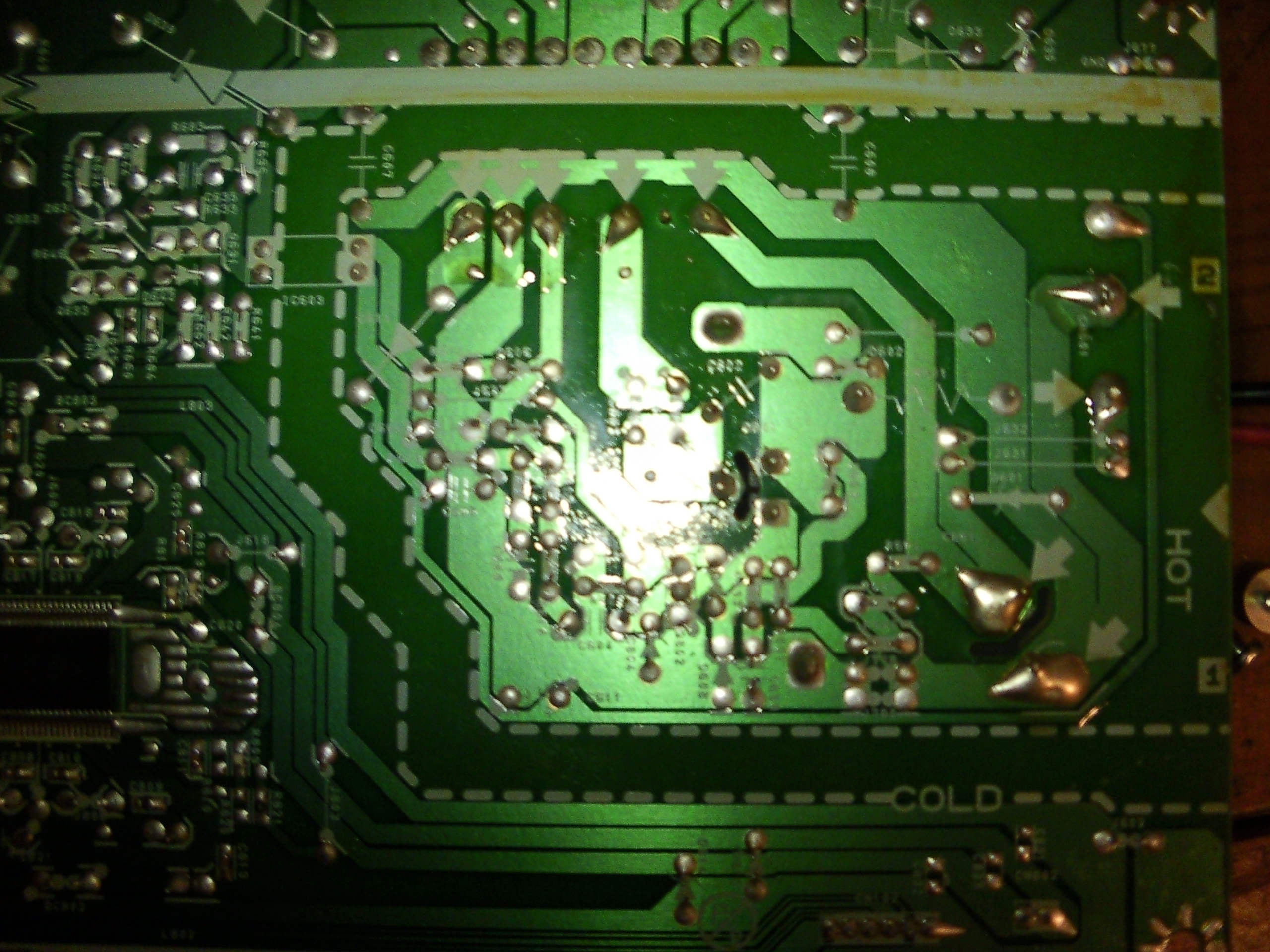

                          • Caleb
                            Smokin IC's
                            • Feb 2013
                            • 645
                            Just a good clear pic of the hot section above and below
                            some numbers to start on, likely all these are toast
                            Q602
                            Q601
                            D604
                            D602
                            R601

                            • Tedybear
                              • Sep 2014
                              • 104
                              I can do more if needed. The server seems to like me this time.

                              • Caleb
                                Smokin IC's
                                • Feb 2013
                                • 645
                                Circled in red the components likely to be blown, in yellow others you should check

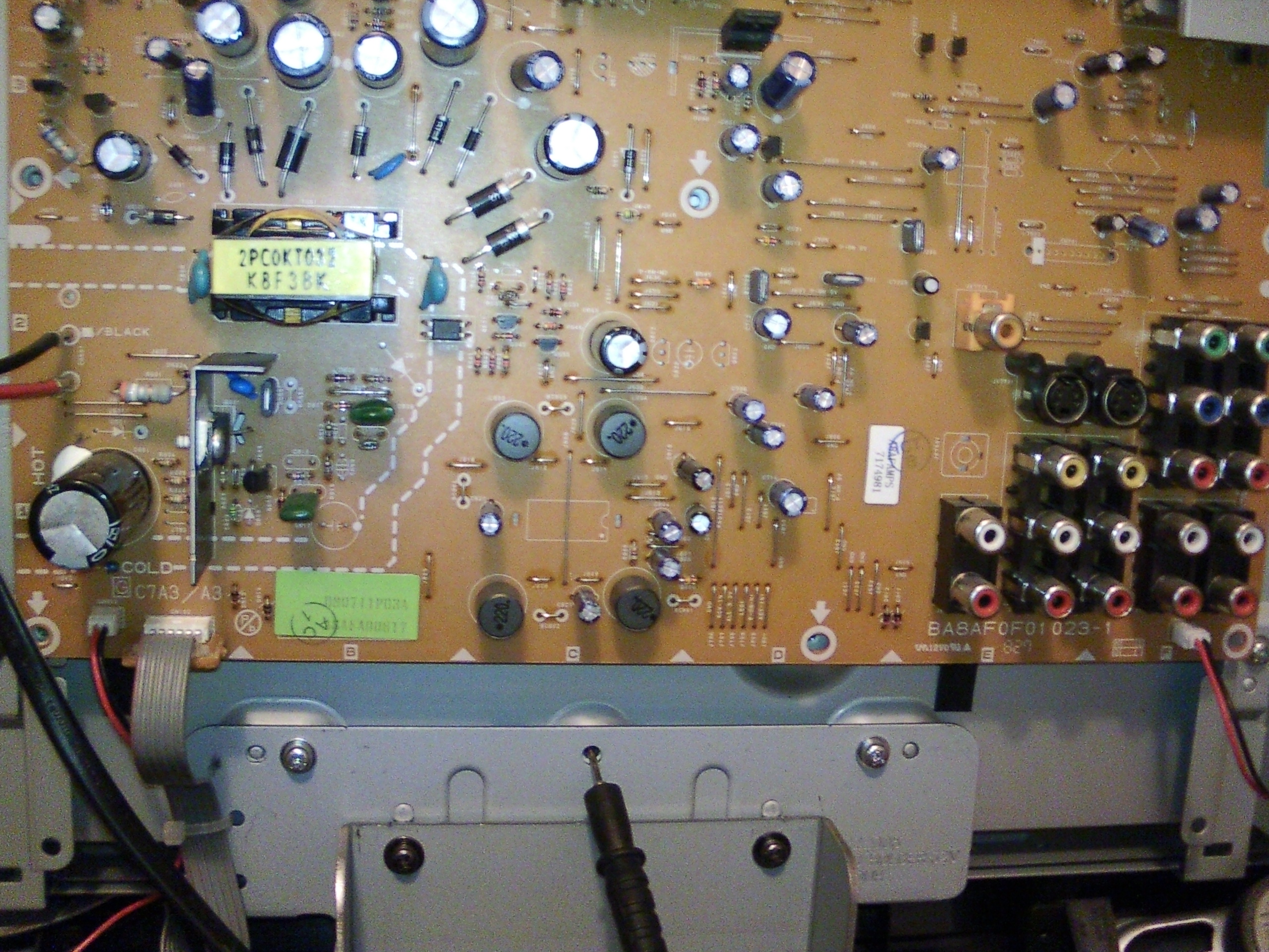

                                • Tedybear
                                  • Sep 2014
                                  • 104
                                  In all honesty. I've found this board all over eBay for under $30 bucks supposedly out of 'working pulls' (aka, some idiot threw their Wii-Remote at the screen)
                                  I can smell a very light burnt smell around the mosfet that I did the booboo on.
                                  But in all honesty. Would this be better served just to order in a different board and just call it a day? I'm thinking by the time I order in components and pay for shipping-It might just be as easy to replace that entire board.
                                  Considering the primary problem (before the blow-up) was no juice at all....Except the 170ish VDC from the inverter board.
                                  I can of course open up the old account at MCM, or any other recommended supply house and do part by part testing and replacement. Just wondering if in the long run--just ordering in a complete board might be the better solution.
                                  I'll do some print work of the schematic as well. We have a laser printer at work that does a good job on fine print items.
                                  Thanks again for all the help!!
                                    If you can find one for 30$ I would go that way. These boards can be a bear to get working. That said its good practice to track down the fault, if you keep it long enough the "new" power board will fail too.
