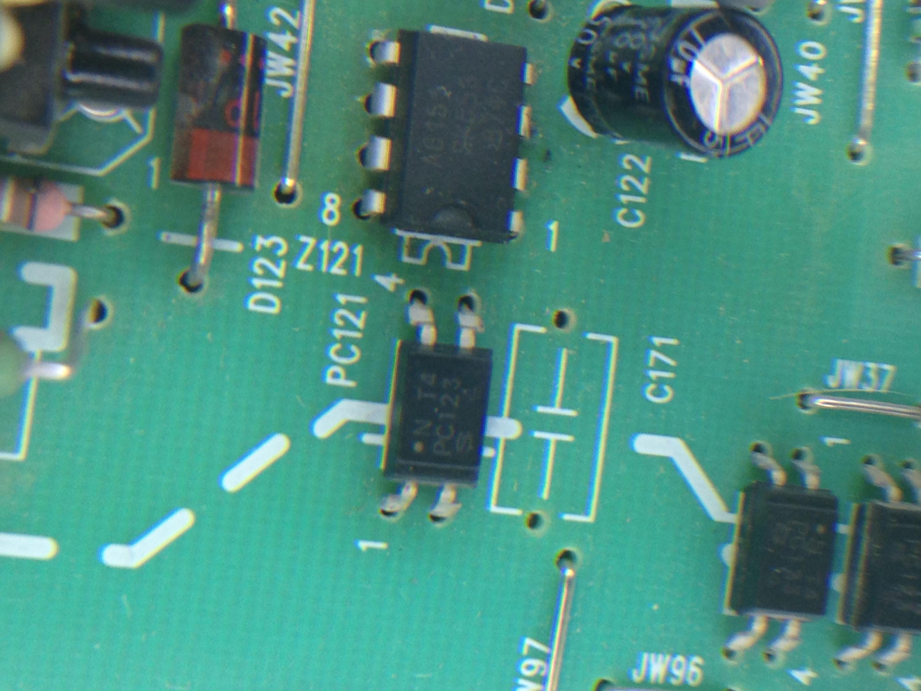

LG42PX4RV-2A no 5v stb
  • topng
    • Dec 2013
    • 56
    • ISRAEL
    Re: LG42PX4RV-2A no 5v stb
    Hi sorry we have an holiday in Israel
    I can't find tl431 but I find kis431
    Is it this one ?
    • kasfamily
      • Aug 2014
      • 774
      • Russia

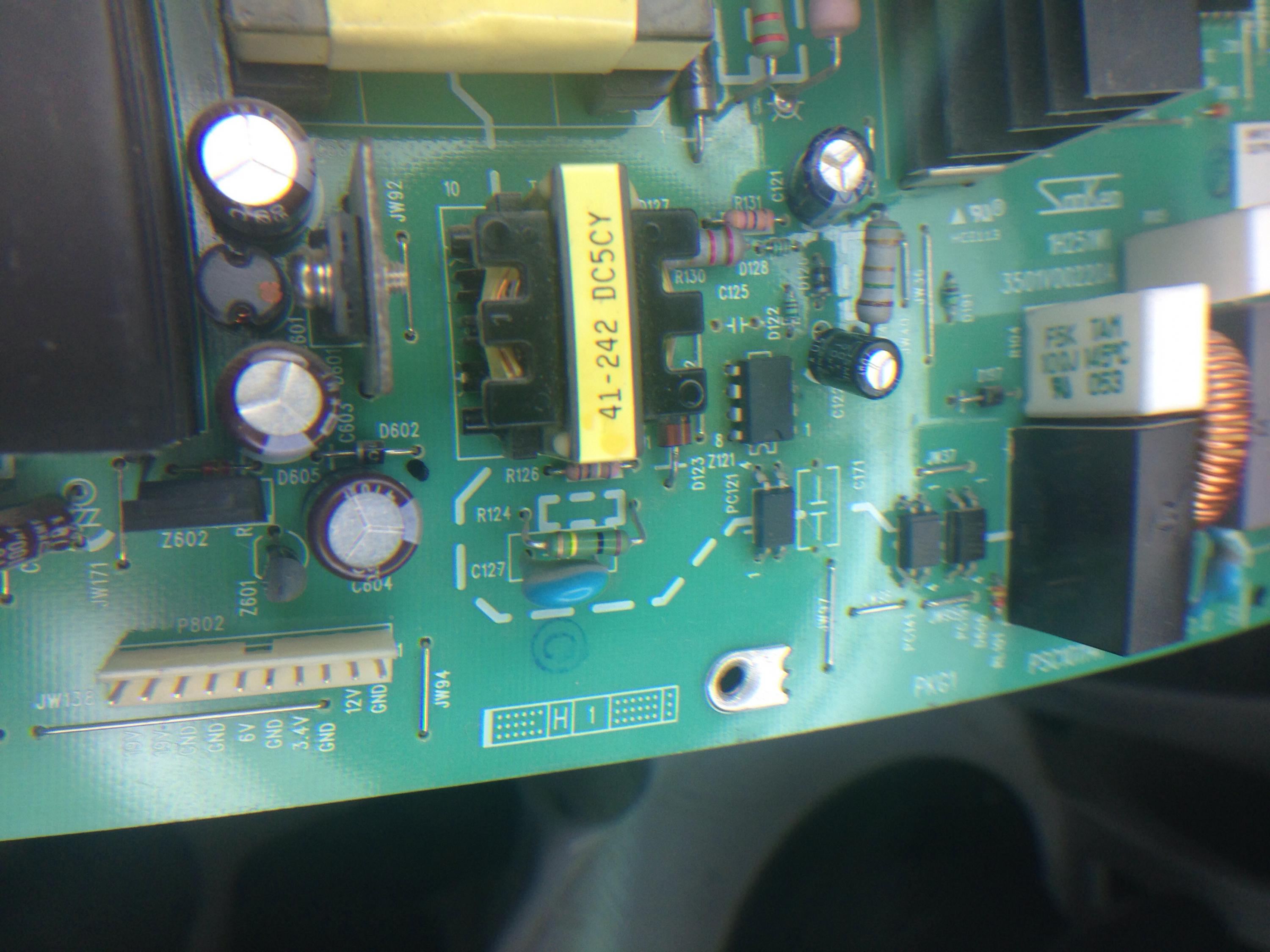

      Сongratulations on the holiday! Show photo 431
      • topng
        • Dec 2013
        • 56
        • ISRAEL
        This one
        • topng
          • Dec 2013
          • 56
          • ISRAEL
          Z601
          • kasfamily
            • Aug 2014
            • 774
            • Russia
            markings on the Z601 is not visible. Must be in the circuit P121
            • topng
              • Dec 2013
              • 56
              • ISRAEL
              Pc 121.?
              • kasfamily
                • Aug 2014
                • 774
                • Russia
                Show photo inscriptions on kis431 (Z601)
