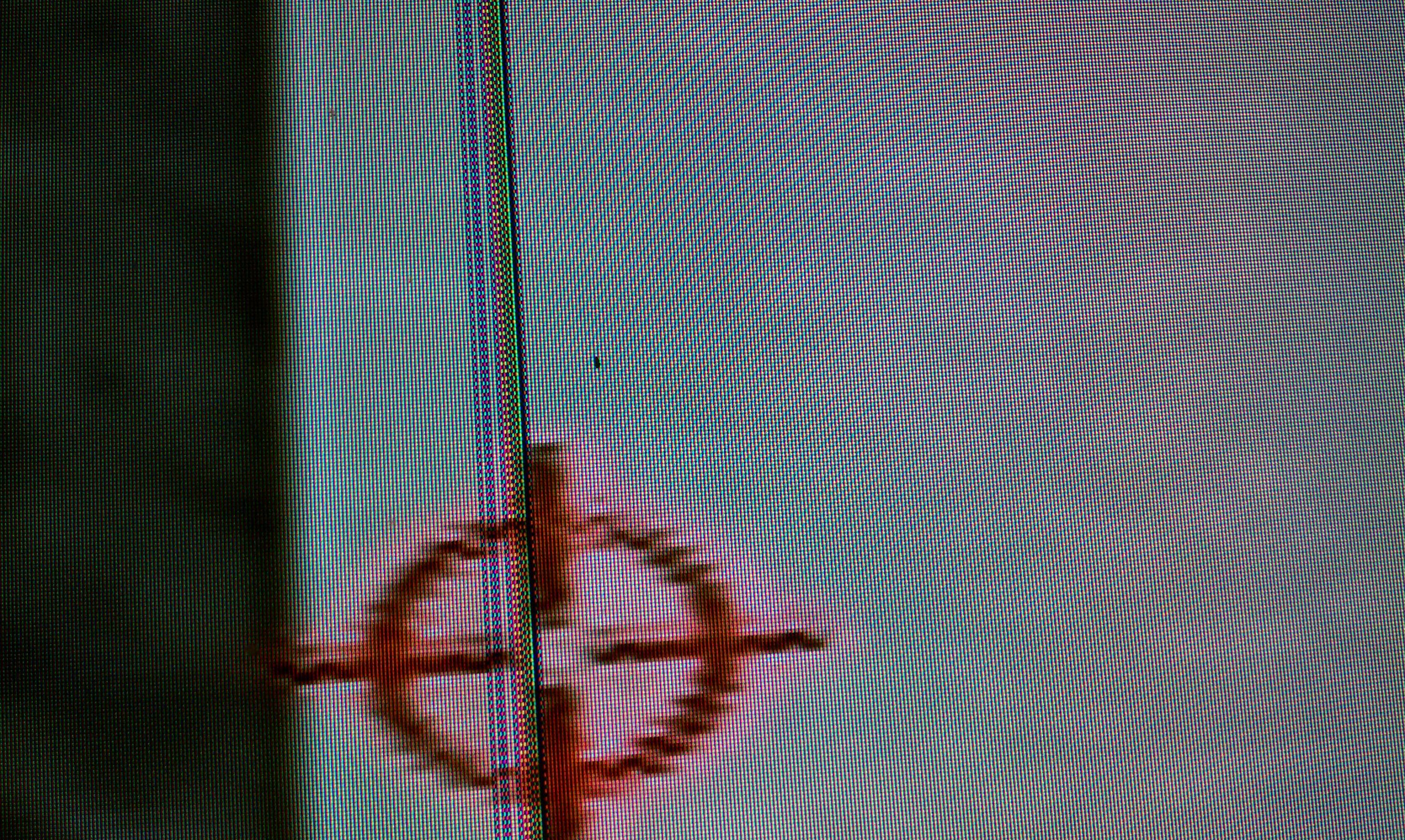

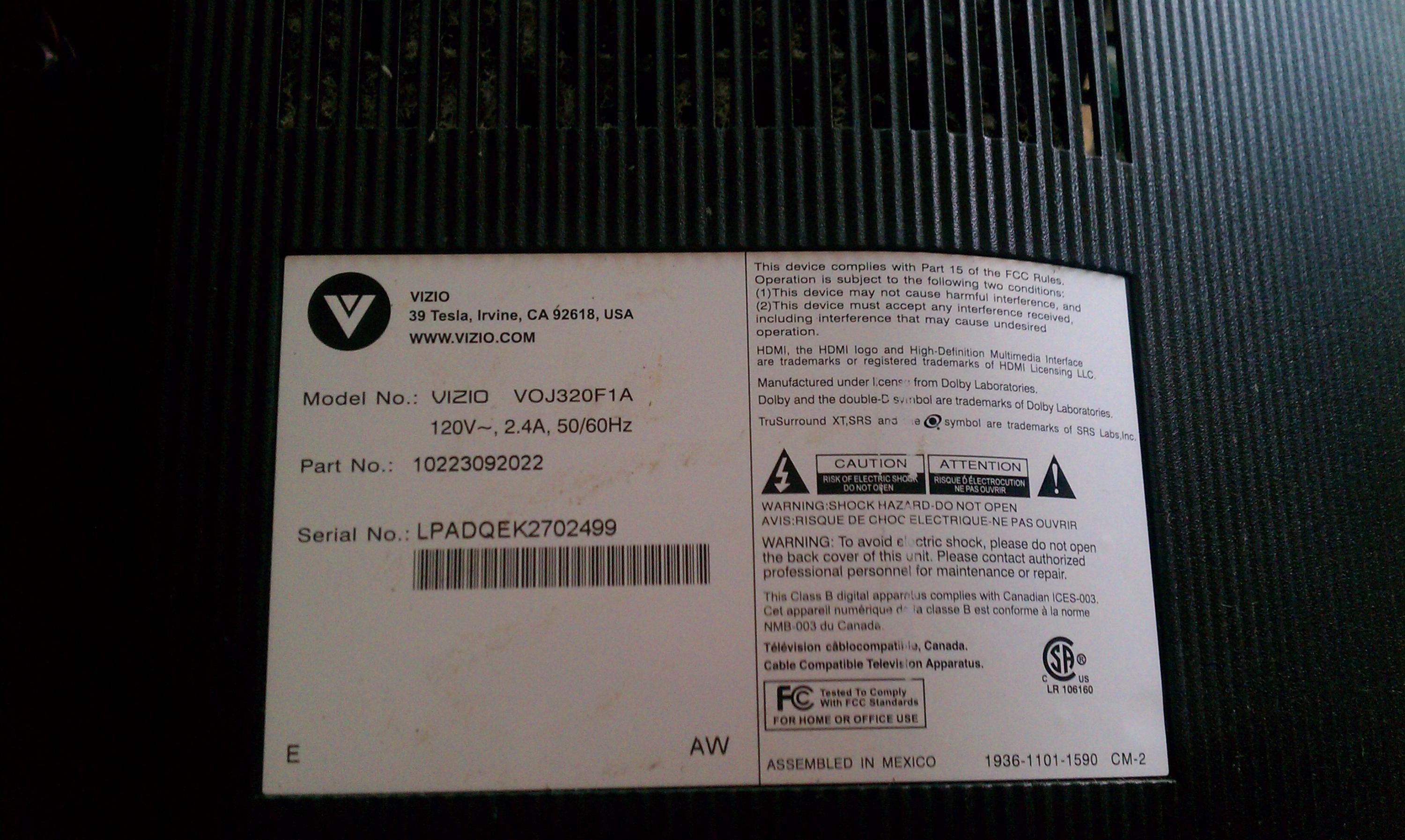

    im still not entirely clear on how to tell if its bad panel or bad TCON but maybe someone here can help.
    heres some pictures
    1 and 2 show the effect covers the whole screen, including the menus, leading me to think its probably not the main board?

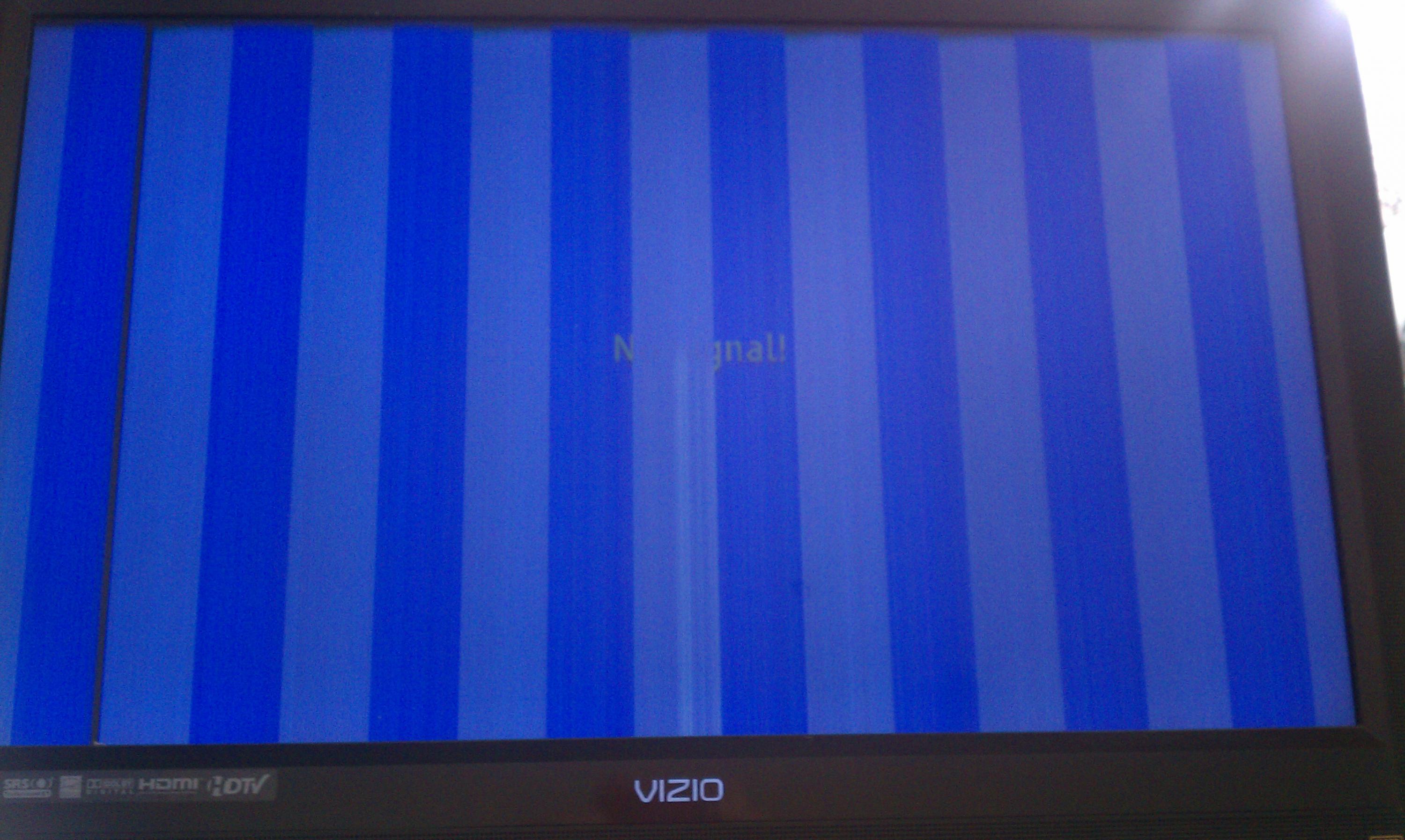

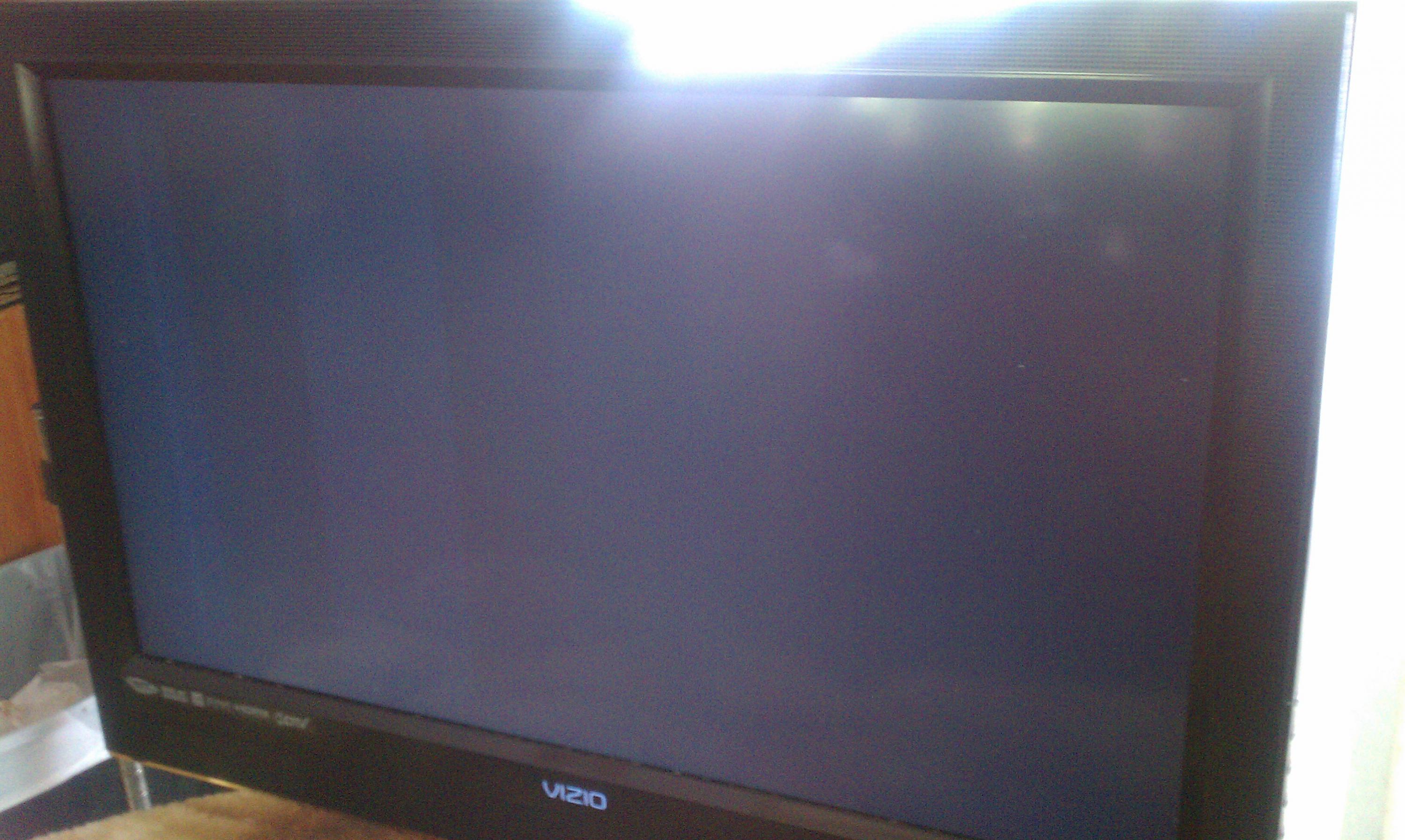

    3: right side disconnected
    4: left side disconnected , you can just barely make out a faint gray vertical bar on the left side of the screen. right side is completely black. i was expecting to see left side black, and distortion on the right side just like the opposite of picture 3, right?
    what do we know?

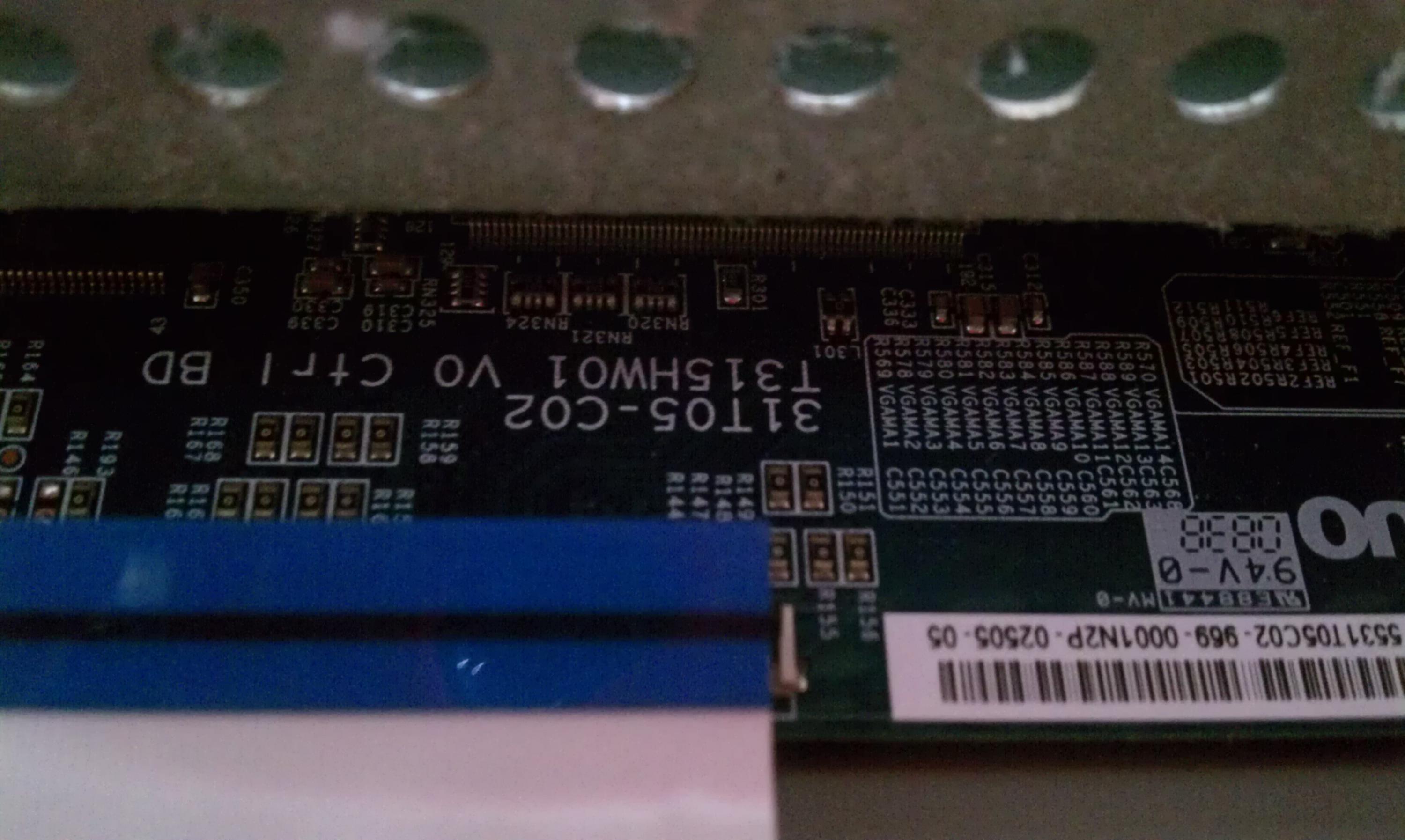

            • triplefour
              • May 2014
              • 1747
              Re: VIZIO VOJ320F1A bad panel or bad tcon?

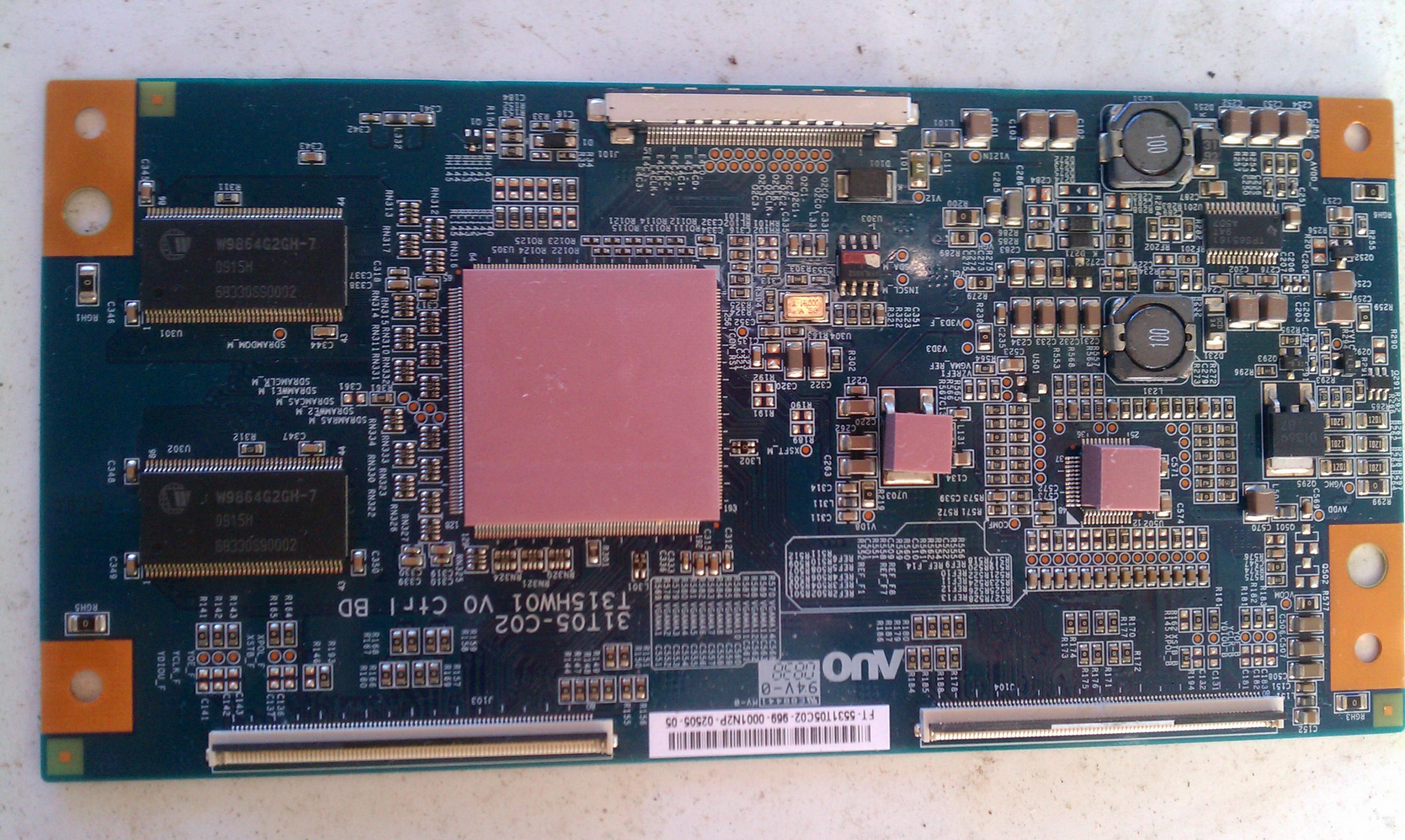

              heres a pic of the TCON
              Don't fear the repair...

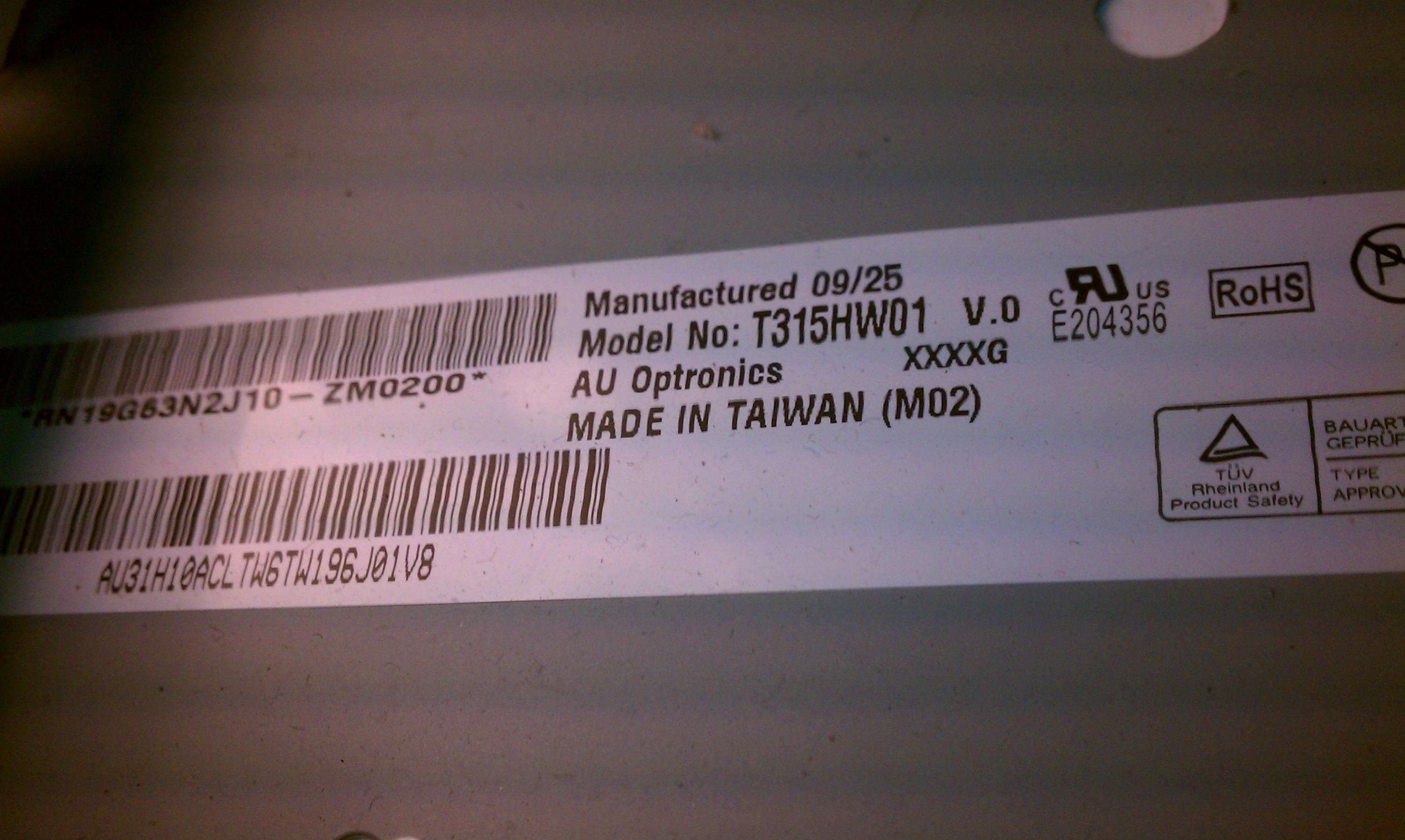

                how can i figure out what other TCON boards would be compatible with this panel and motherboard?
                the panel says:
                T315HW01 V.0
                • triplefour
                  • May 2014
                  • 1747
                  dang i guess i answered my own question, cause after typing that into ebay i found my TCON for only 19 bux! sweet deals. lets hope that's it!
                        well the tcon came in today so of course i put it in. and it appears i was correct in guessing that it was a TCON problem causing the distortion of the screen but after that was cleared up, i noticed the tv ALSO has a thin black vertical line going down the left side of the screen just a few inches away from the edge.
                        when i flex the panel i can make it change some, but cant make it go away.
                        this is bad panel and there is nothing i can do...or so im led to believe by everything ive seen myself and here on this forum...
                        wouldnt mind trying something though, as with a bad panel im going to just part it out on ebay. no one will buy a 32 inch tv with a line going down the screen for more than 50 bux if at all...
                        anyone need parts??
