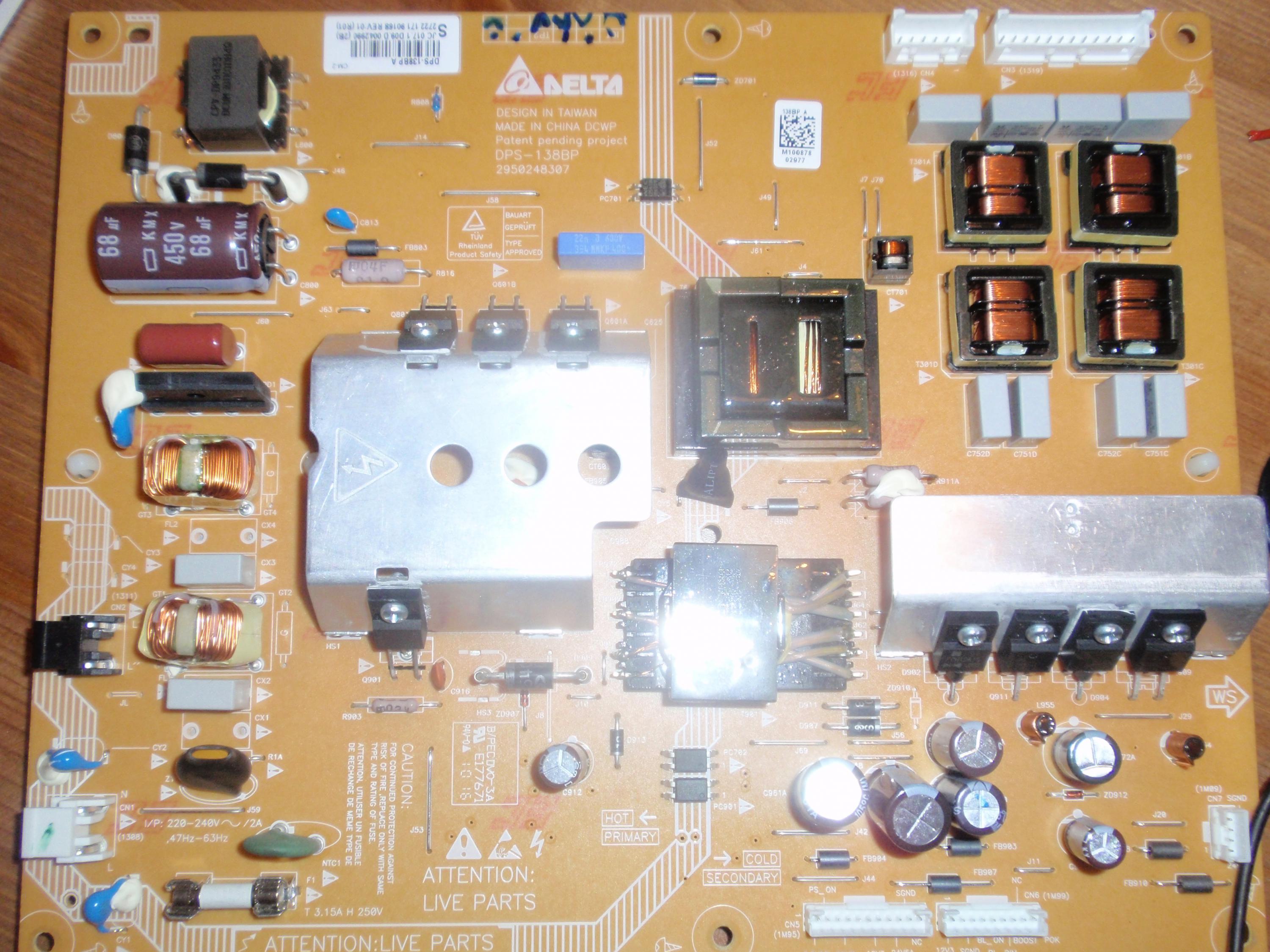

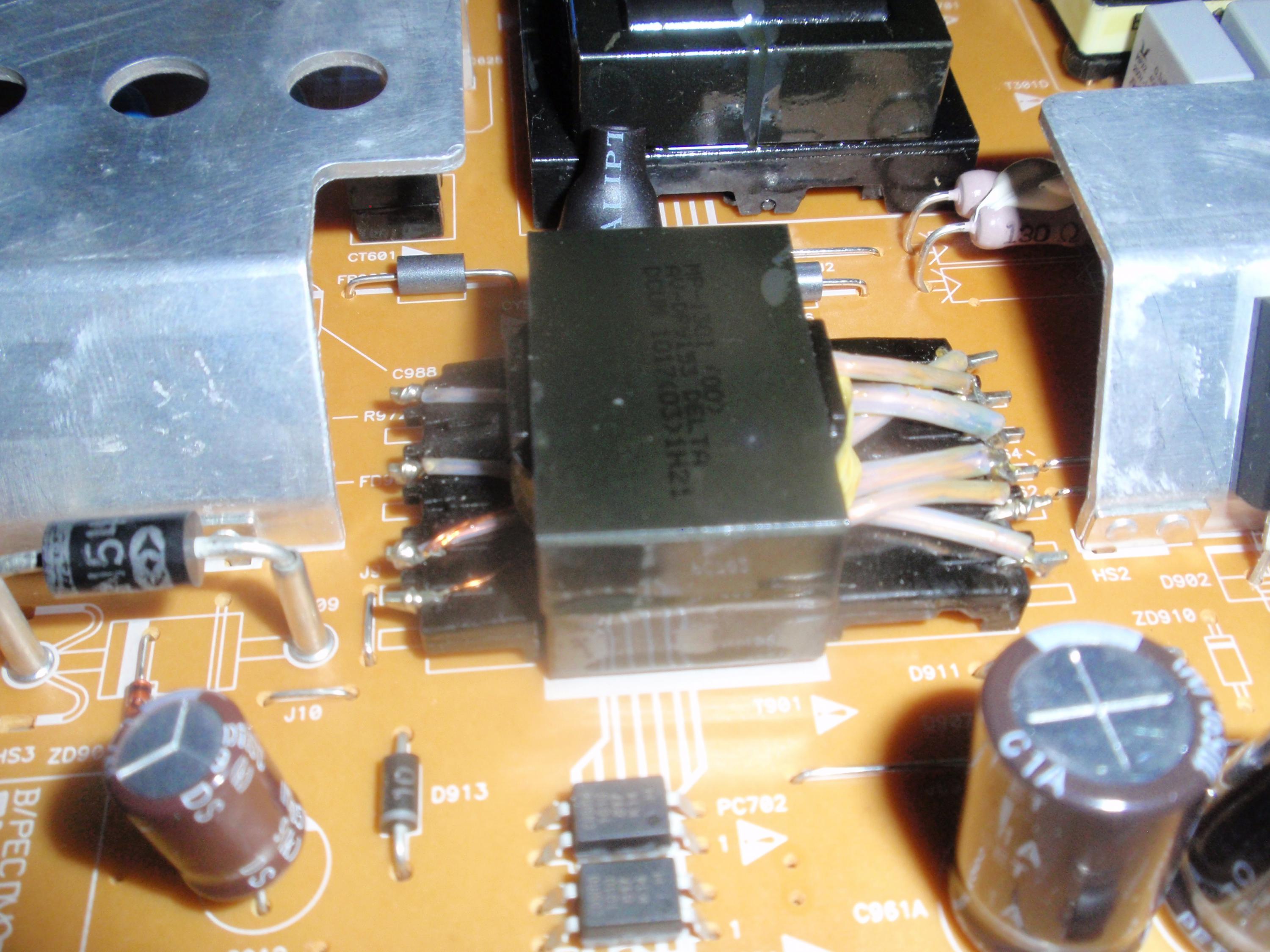

          Re: Samsung LE 32A559P4C What is this part?
          philips dps-138bp power supply,
          is this part burn? the wires seems to be in a bad shape...
          problem is that screen is all white, nothing. everything seems to be in good shape except that..
            #45
            I cannot really tell from the pictures. White screen like glowing screen but no pictures? That may be bad T-CON.
