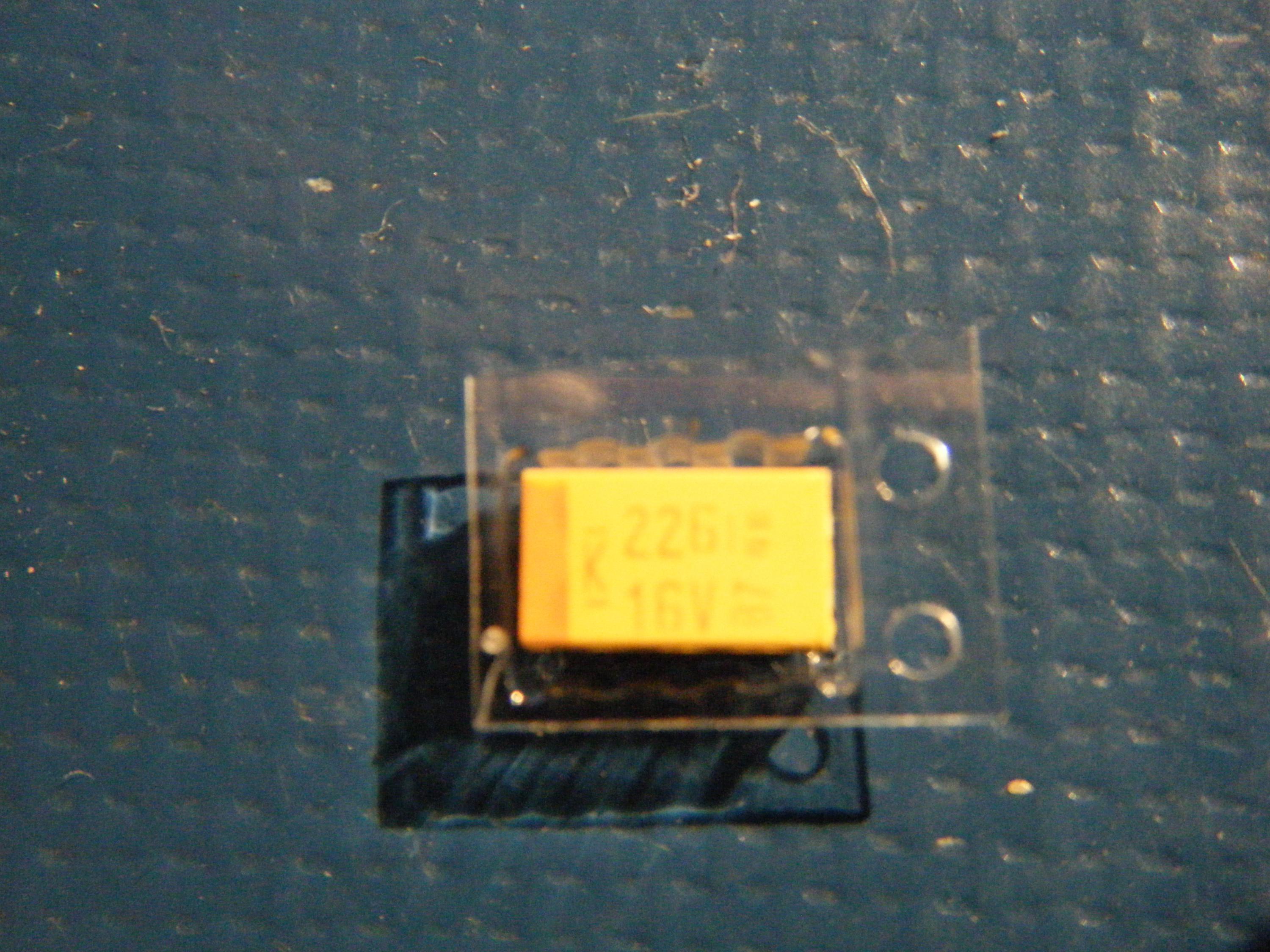

                  #48
                  Re: Matsui M32LW409 no picture but sound
                  Hi Tom,
                  Picture of the 16v 22uf cap, I have a 35v 22uf one as well. Or shall I do what I suggested in last post?
                  Thank you
                    #49
                    That is quite big.

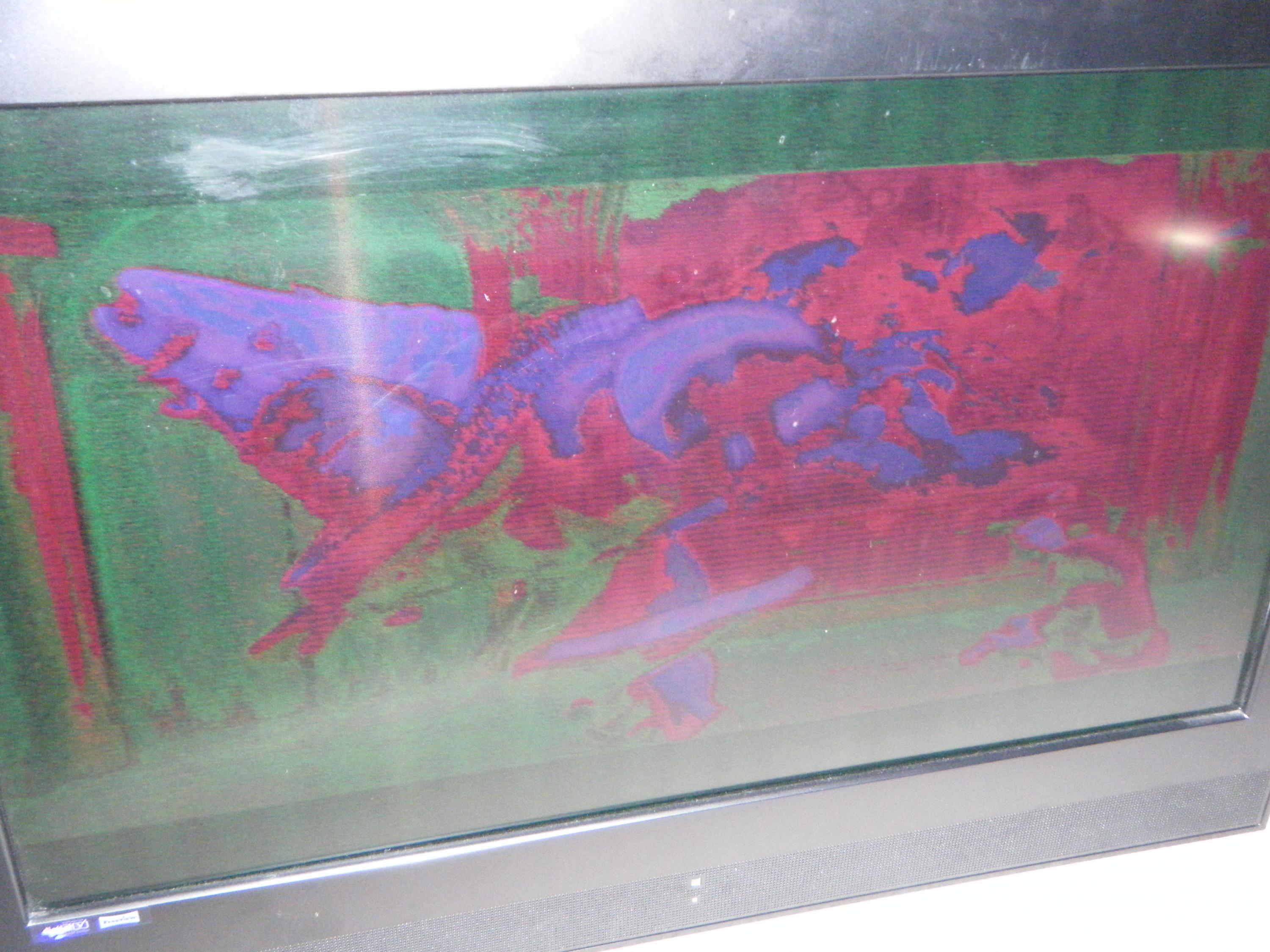

                          #52
                          Hi Tom,
                          I fitted the two caps and replaced the fuse and I get a picture but see the attachments as it looks awful.
                          • Th3_uN1Qu3
                            Believe in
                            • Jul 2010
                            • 6031
                            • Romania
                            #53
                            Hmm. Looks like something else on that T-con is fried also.

                                  #56
                                  Check LVDS cable and setting in service menu (Menu-4-7-2-5)
                                  • Andyd1970
                                    • Feb 2013
                                    • 374
                                    • united kingdom
                                    #57
                                    Hi TOM, The LVDS cable is nice a secure, I do not have a remote for the set can I still get access to service menu? what setting am I looking at adjusting/checking?

                                        #59
                                        Any Vestel or Philips remote will work.
                                        You WILL need a remote to access it.
