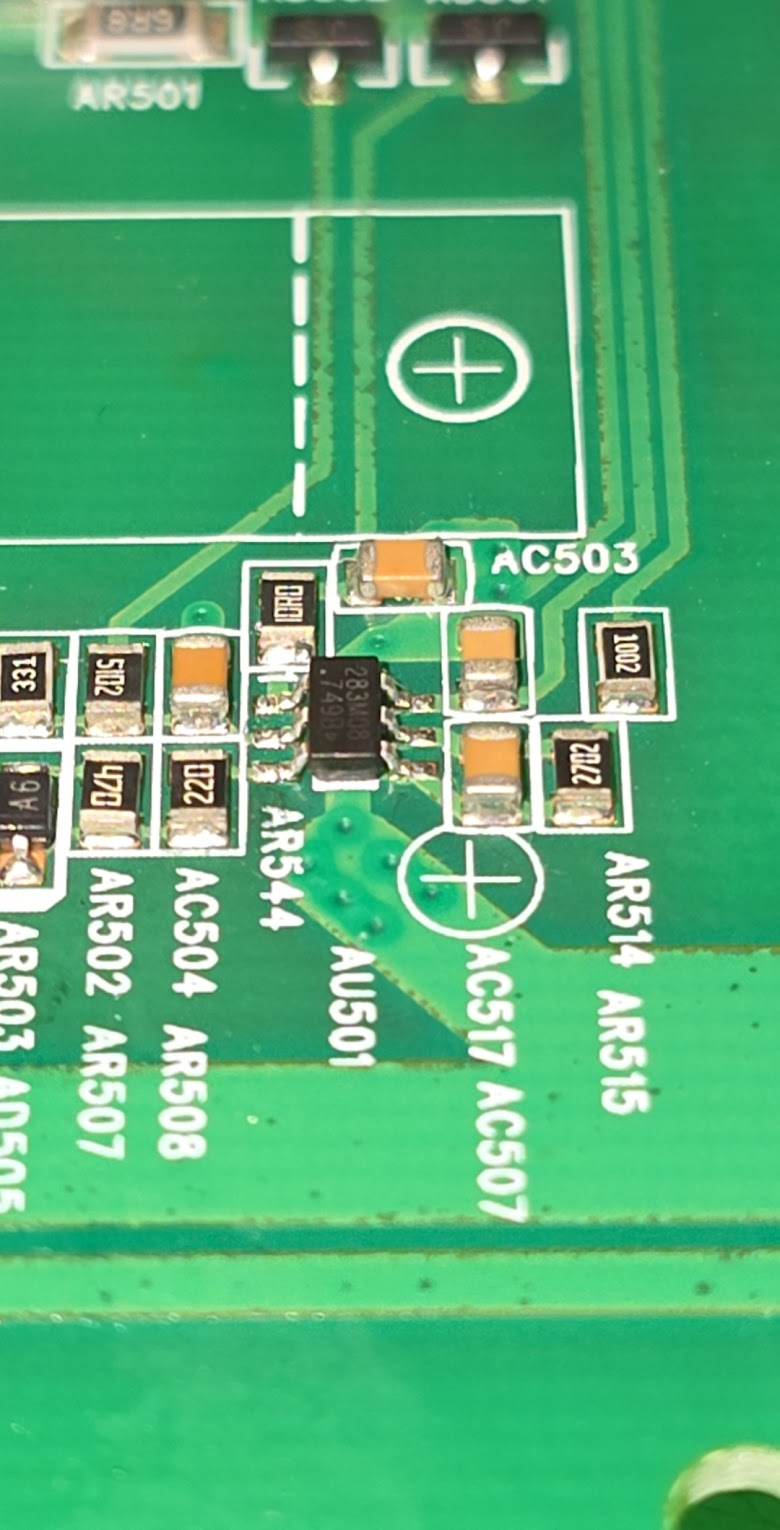

    I am after this SMD marked AU501
    283M08
    749B
    Anyone knows it's part number pls?

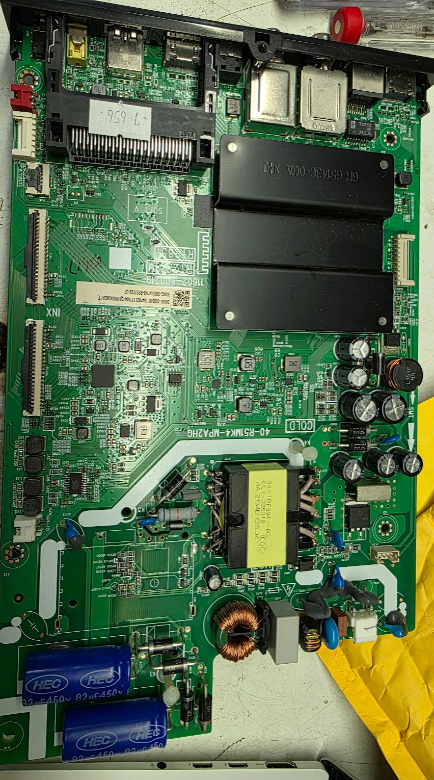

    Main Board: 40-r51mk4-mpa2hg

    After some digging up, I think the part is OB2283 datasheet: https://taoic.oss-cn-hangzhou.aliyun...0255940000.pdf
    But stand to be corrected!

      OB2283B (OB2283BMP)

        Thanks!
        • lotas
          • Jan 2016
          • 4984
          • Russia
          83xxxx - OB2283
          283xxxx - OB2283B
          They differ in pin 5.
