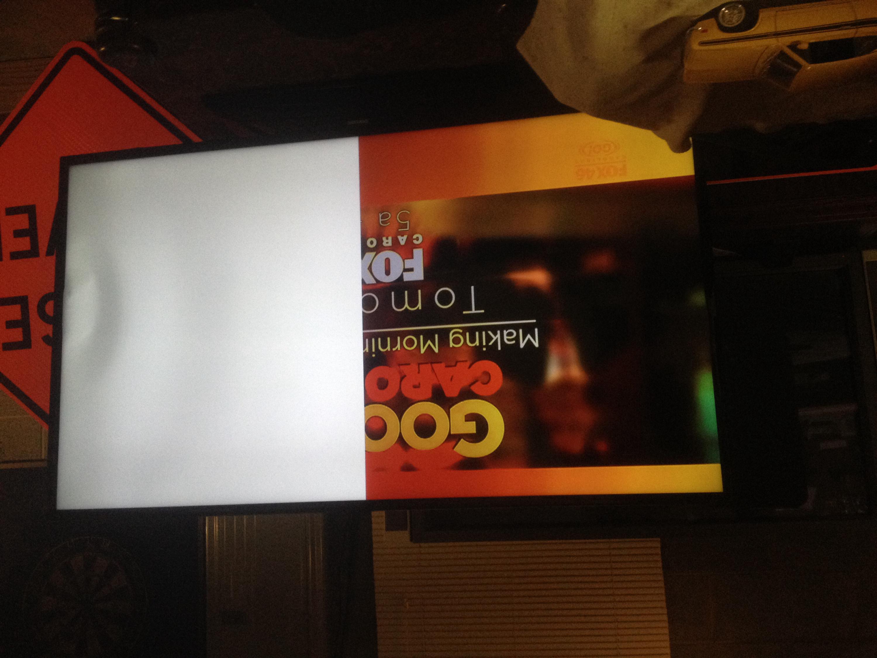

    Left hand side of the screen, but the right hand side is solid white. I replaced the T-Conn now all I have is just a glow from the blacklight. Anybody had a issue similar to this? I have also tried 2 mains boards as well. Does this look like a T-Conn problem?

    Re: Samsung UN55EH6000 screen problem pic included

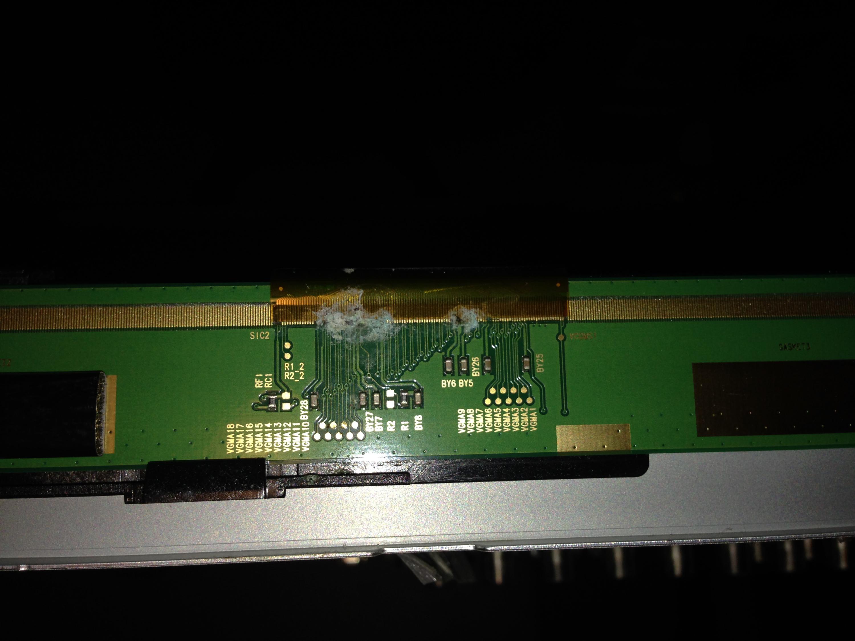

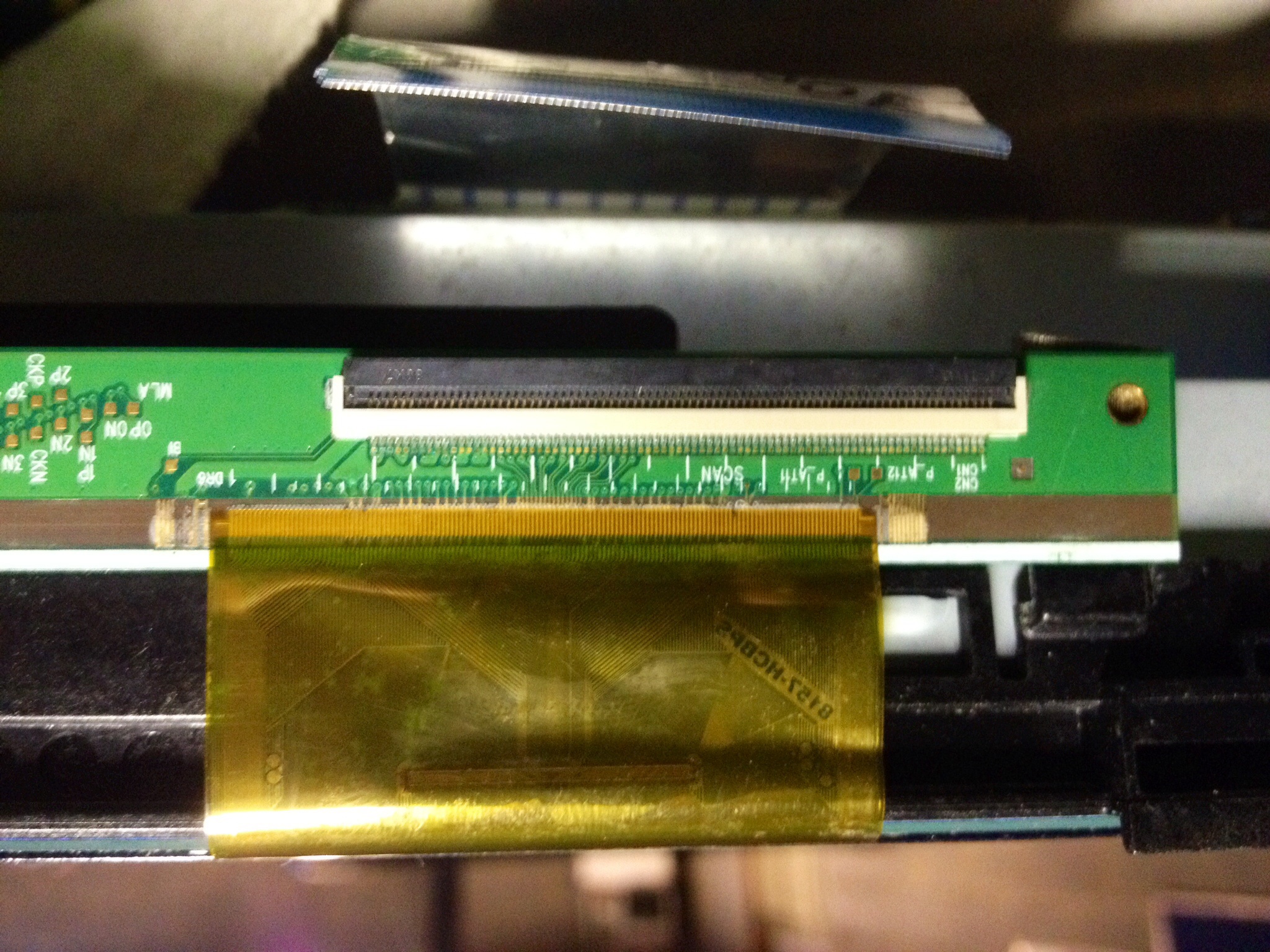

    Panel may be water damadge.
    check reples or swap cable from Tcon board to panel. if no result then open panel and check for oxide on panel pcb.
      It sounds like the new Tcon board is also faulty and at a guess i would suggest its a Tcon problem...
        I would go for panel myself having seen similar symptoms before. Maybe water damage or could just be sudden panel death...
          Sorry guys I've been out of the loop. I have another T-Conn on the way from a reputable company. I will advise what happens, hopefully it doesn't have water damage!
          Thanks for the advice guys!
            Have you broken the panel down to the TFT Tab bond boards to see if there was damage or Electrolysis build up on the connections?
            I have seen 5 panels die to Windex soaking screens!
            I would check out those tabs before putting in a new t-con cause if that corrosion/Electrolysis is shorting out you are going to blow that T-con.
              Shinju, thanks for the heads up! I tried the tv with the corridored connector unhooked and the screen didn't change. So I reckon this TV is cashed by water, windex, and or Busch Light. Anyone need componets for a Samsung UN55EH6000? I would also like to thank everyone that posted advise and or opinions on my first thread!
