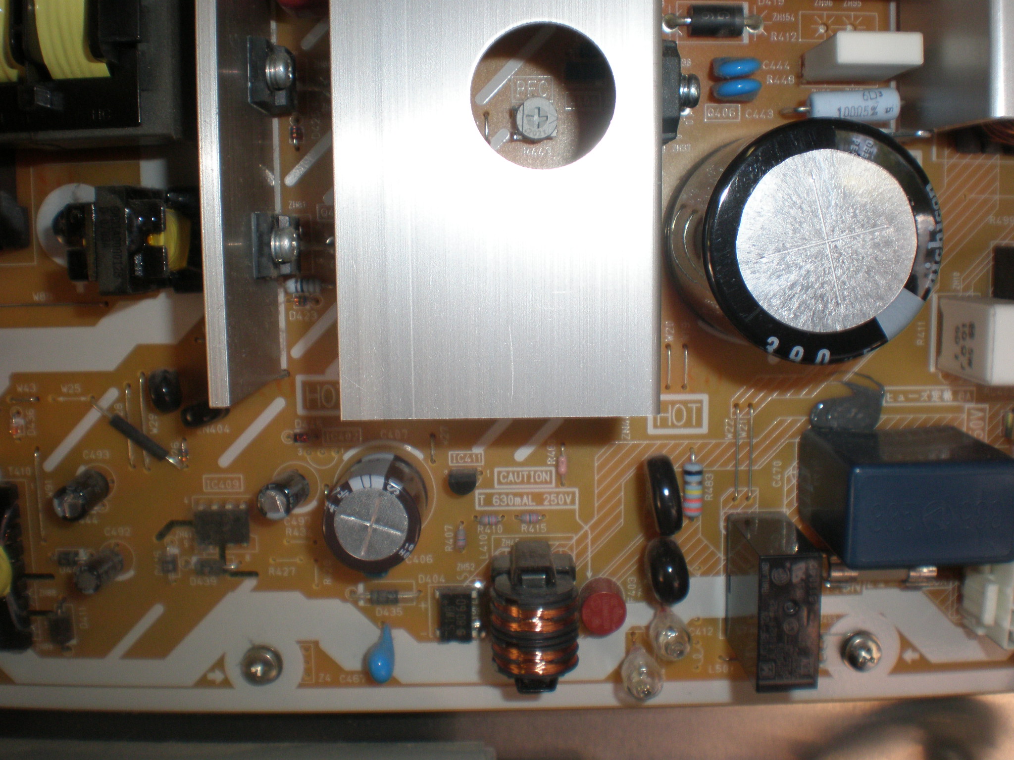

    I have a Panasonic Viera Plasma TV (42PX75U) that the top half of the screen will start flickering intermmittently with a white screen. The TV will actually work fine for about 2 hours or so when I first turn it on, and then the flickering will start. Then it will get worse and then finally the whole picture will completely go away. Then I get the 7 blinking red light. If I unplugged the power to the TV and let it sit for a while, it will work fine again, and then repeat. Any ideas on what card this might be?

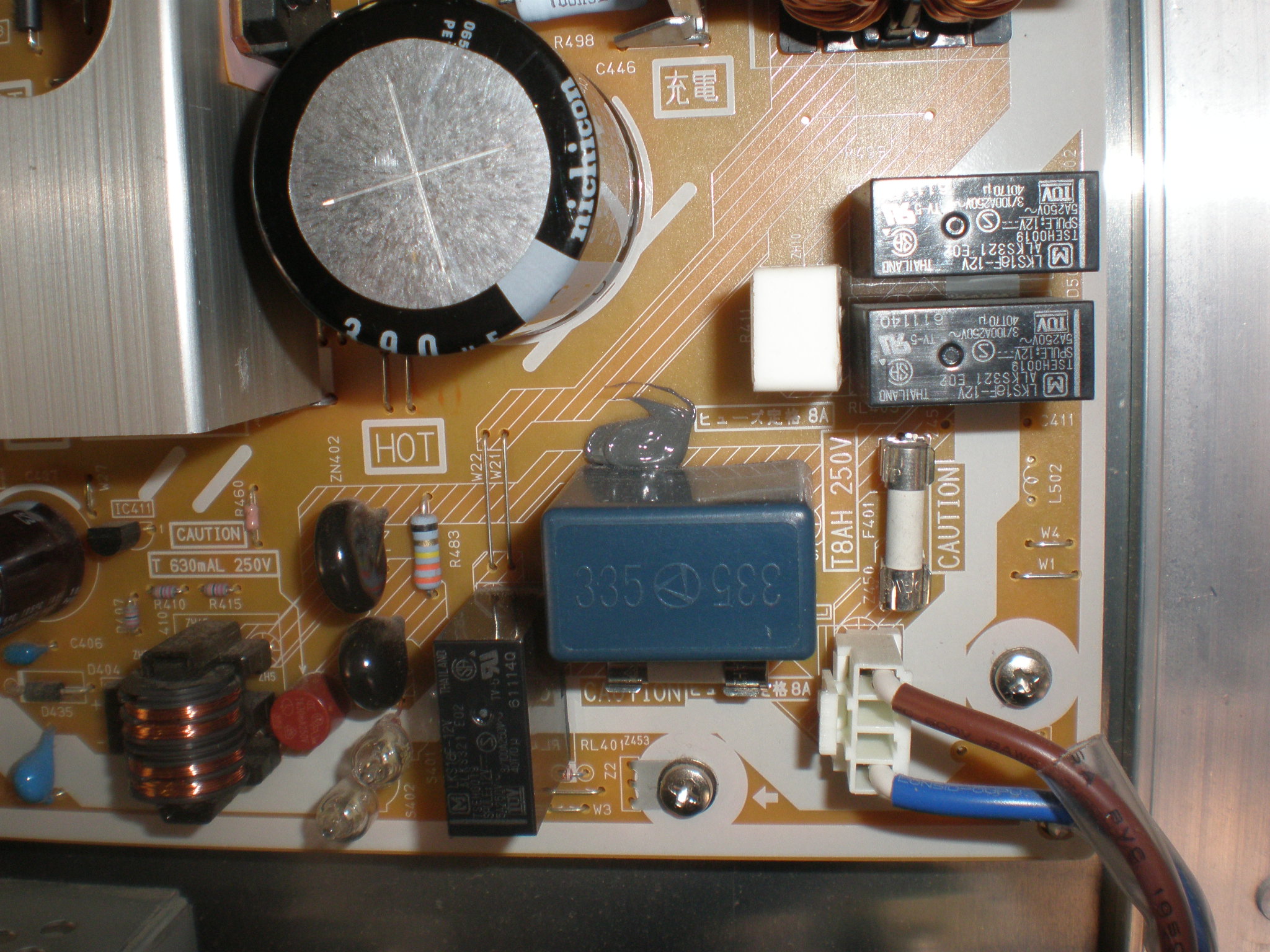

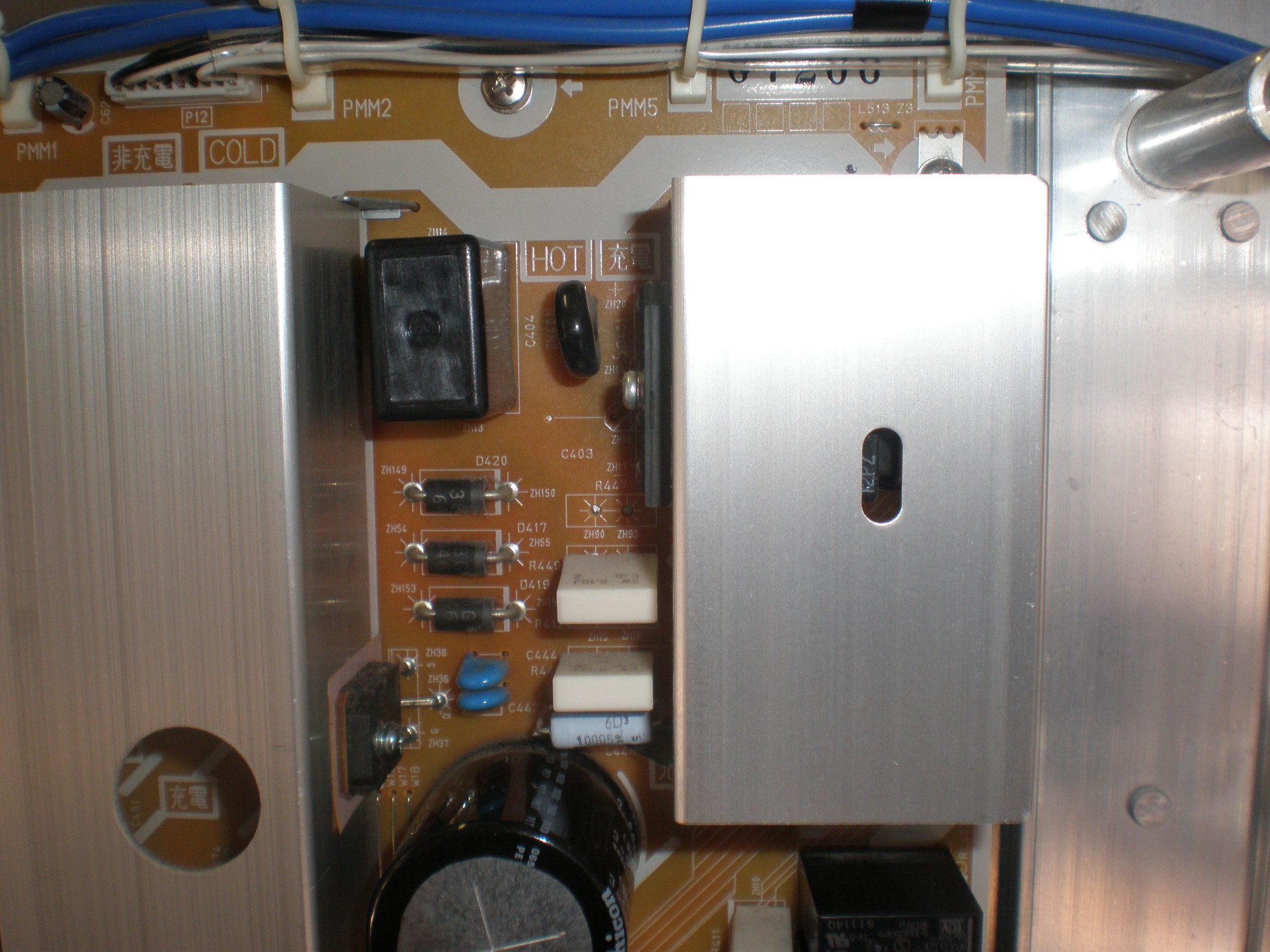

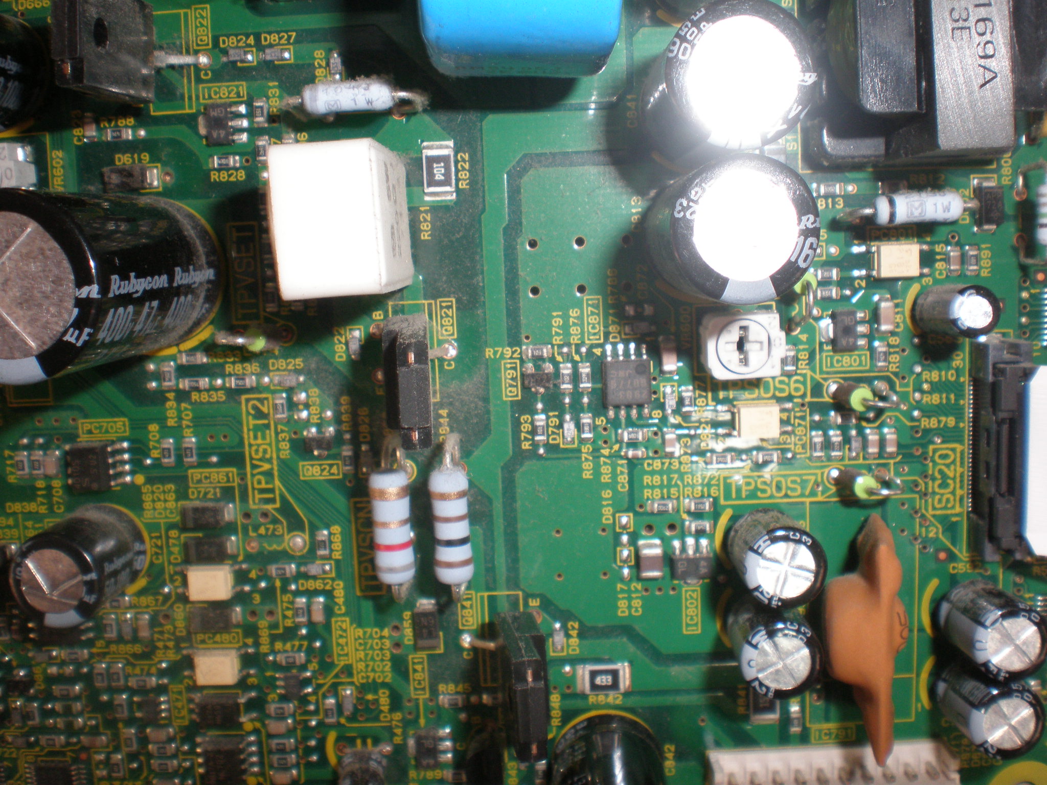

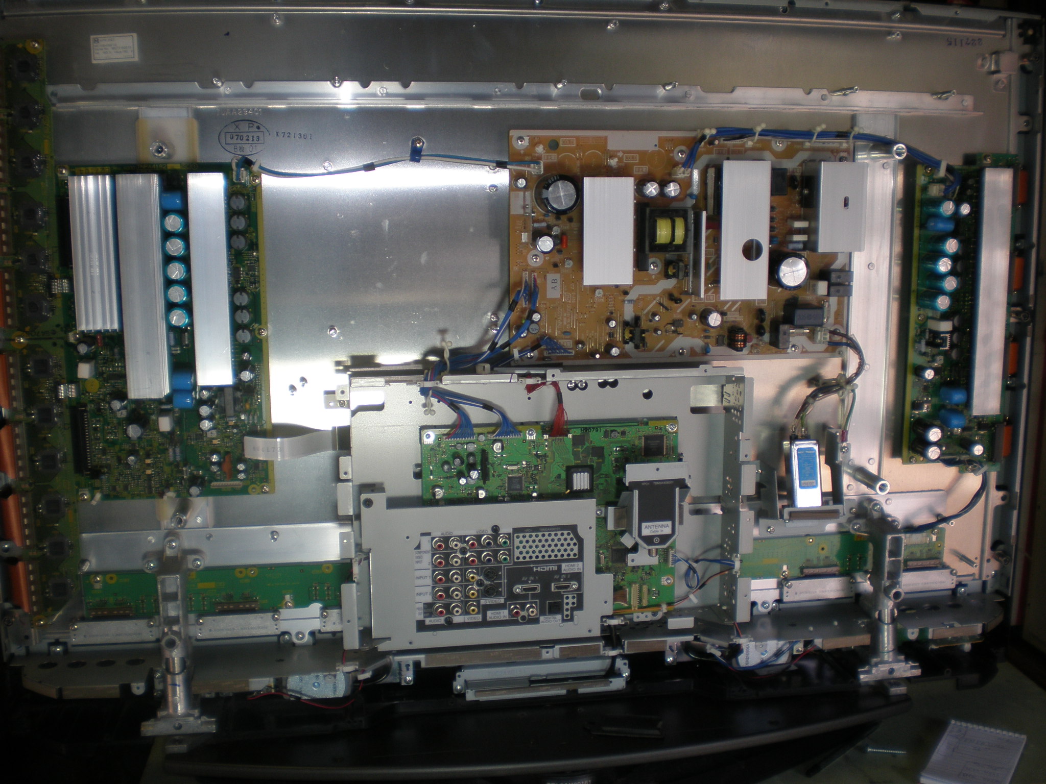

      Can you take clear pictures of the back of the tv with the back removed. and then clear pictures of each board. (unplug the tv and let it sit for a good half hour before doing so. Plasmas especially carry enough residual juice to knock you over to the next area code

        Yes - I will try do that today and reply back to you. I really believe this is heat related. I took the back off and cleaned all the vents real good and set a box fan up to blow on it while it was turned on. It played for a long time without and problems. However, when I put the cover back on and let it run normally, it lasted about 2 hours before it started flickering and then shutting down.

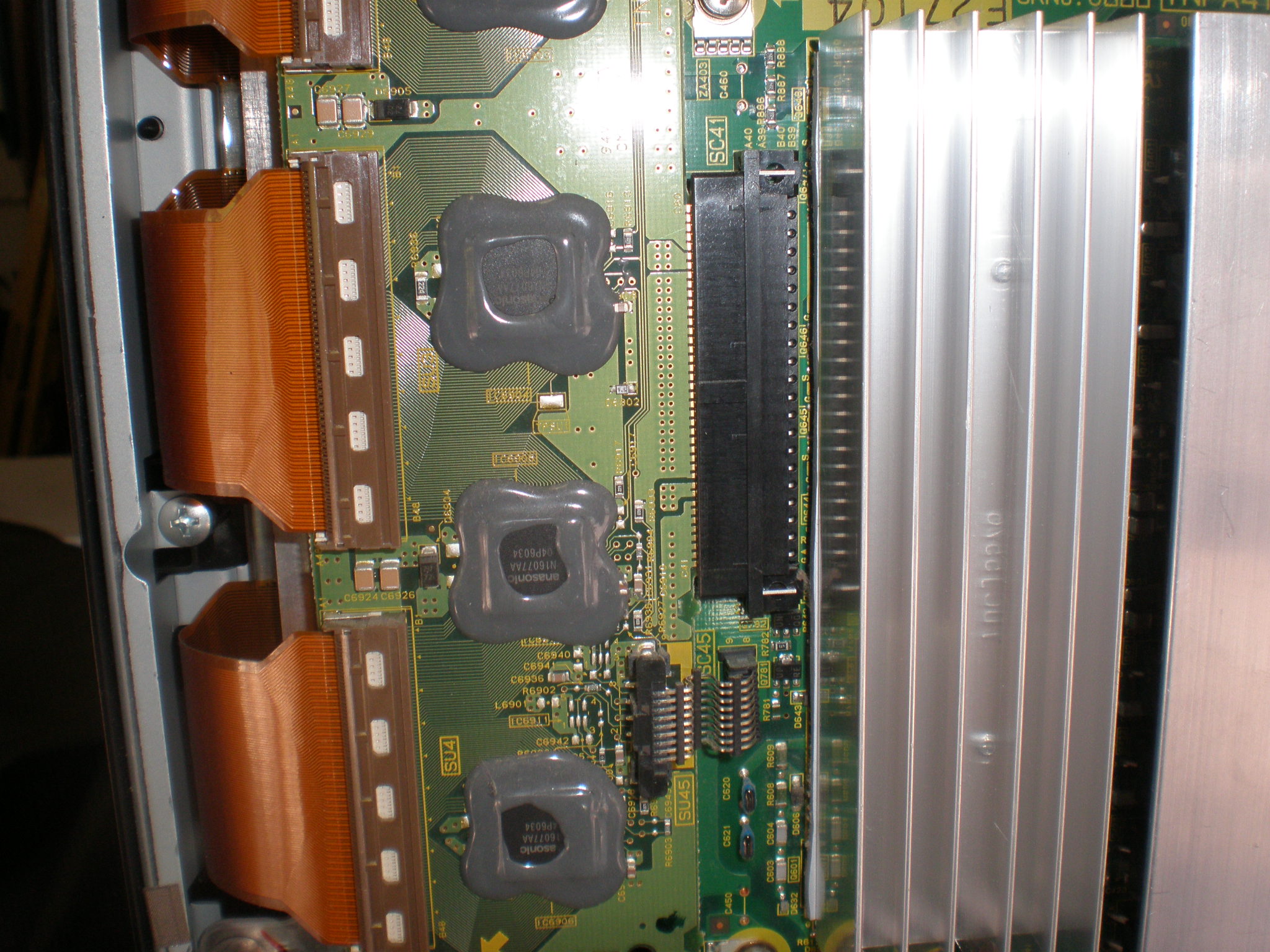

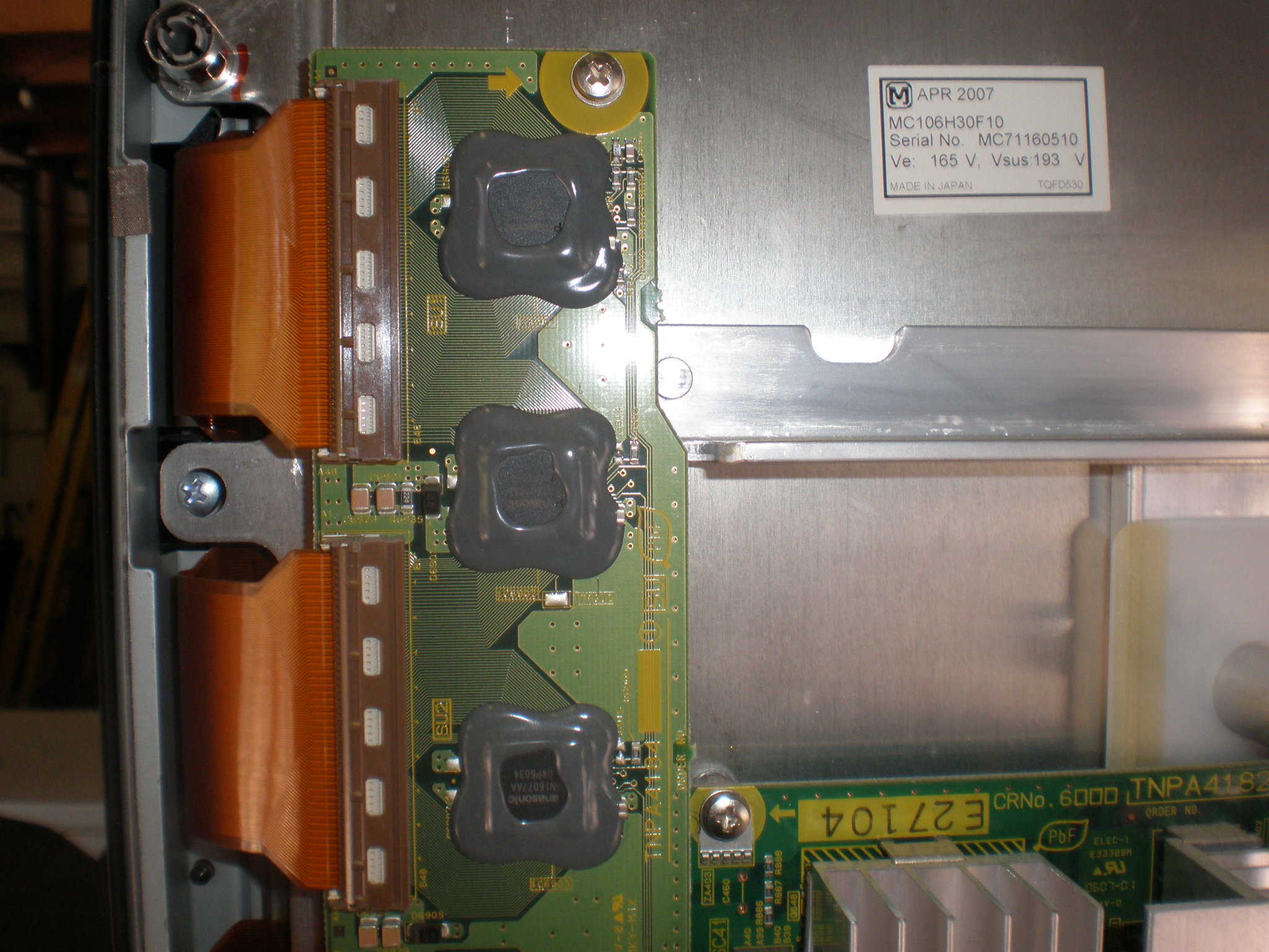

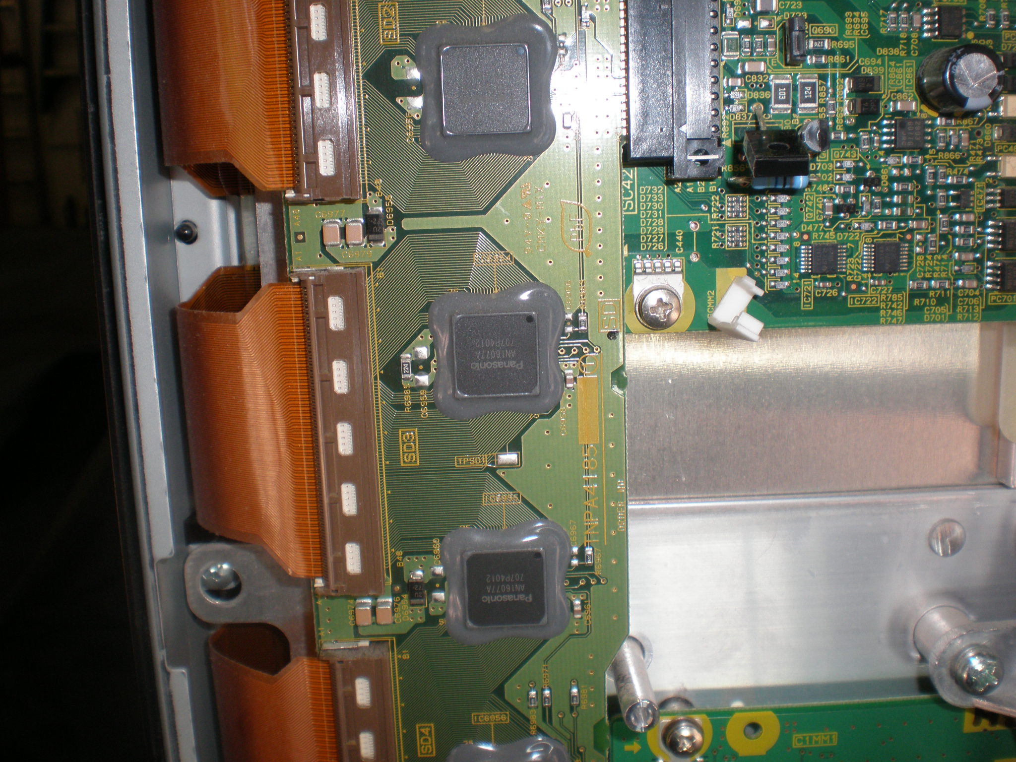

                Re: Panasonic Plasma TV with flickering screen

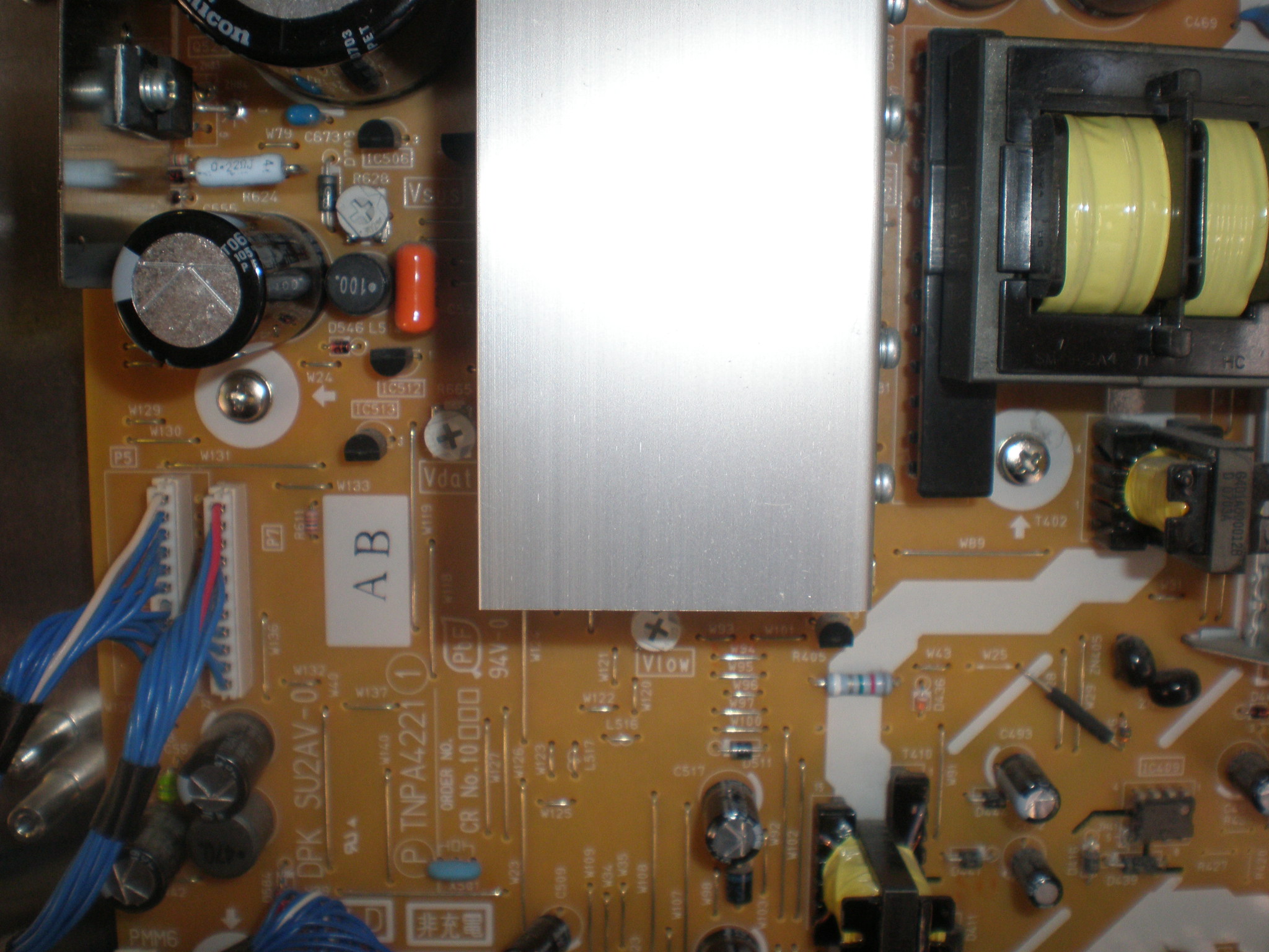

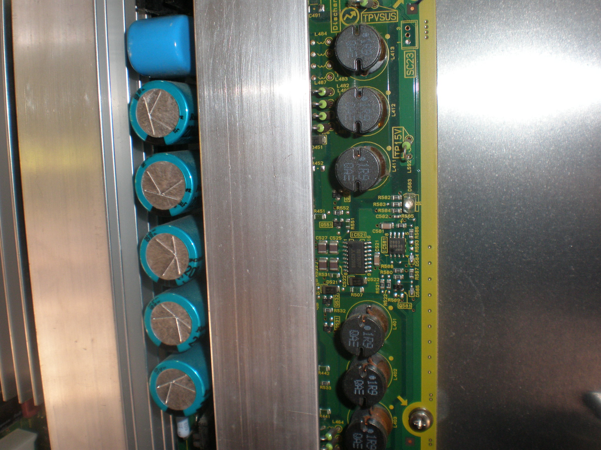

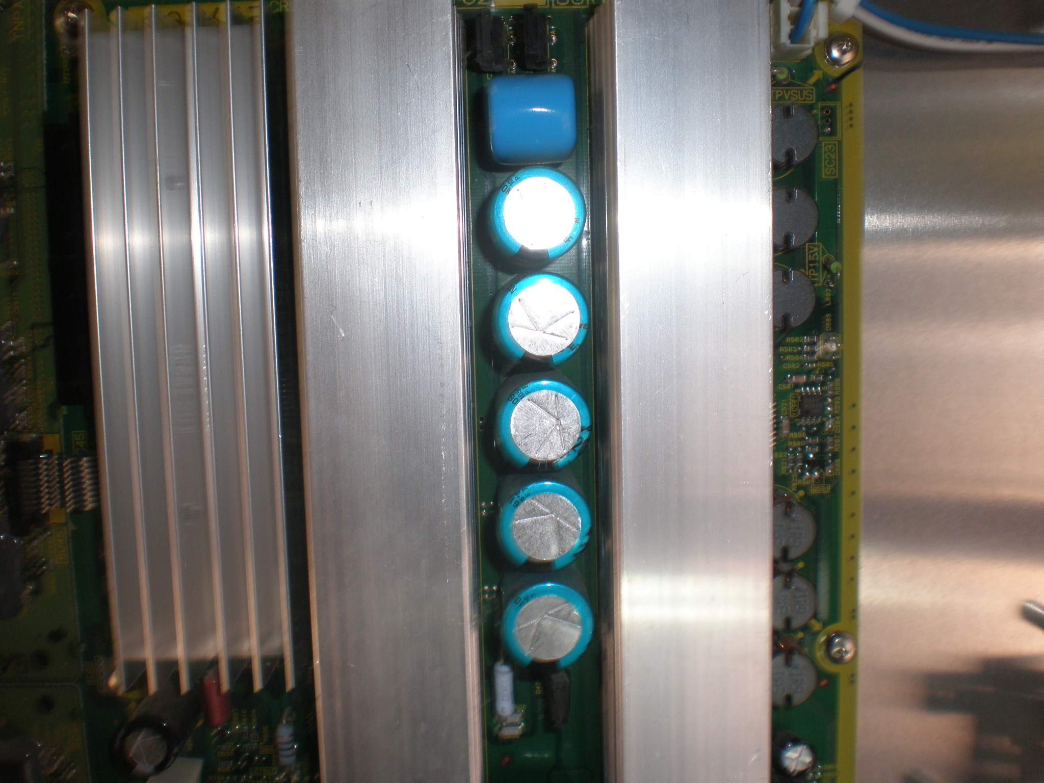

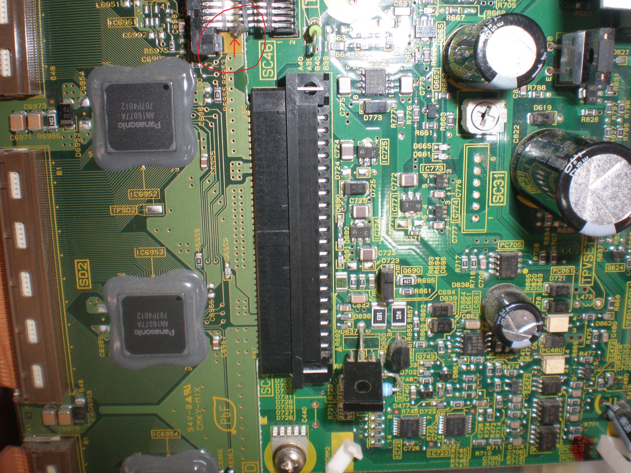

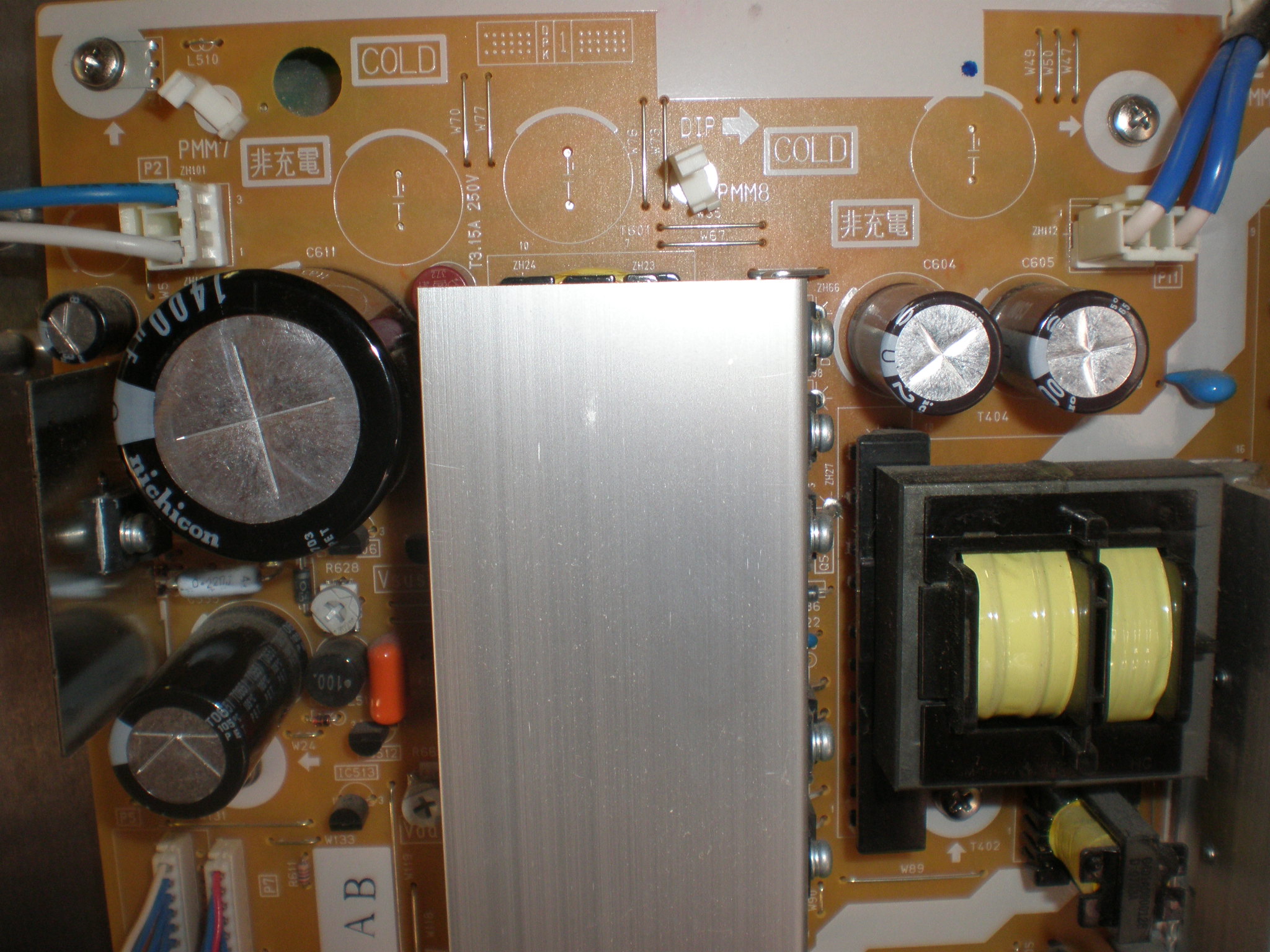

                Zacheriaj - here are the pictures you requested. I was thinking the SU card on the top left might be a suspect for my trouble, since this card is attached to the top half of the Plasma screen. I may have to send you 2 sets of pictures for clarity.
                  Yes, SU board is the likely cause. SU = top buffer board
                    +1. Shopjimmy appears to be out of stock for that board however there are a few choices on ebay if you find a good seller.
                      That looks like a screw?! Be sure to remove that or you may see a good show lol. Was it there the whole time?
                      You Can't Succeed Until You're Willing to Fail
                      • JimmyG
                        • Sep 2014
                        • 17
                        Zach - I checked this out . Looked like a piece of fuzz or something. It is gone now.
