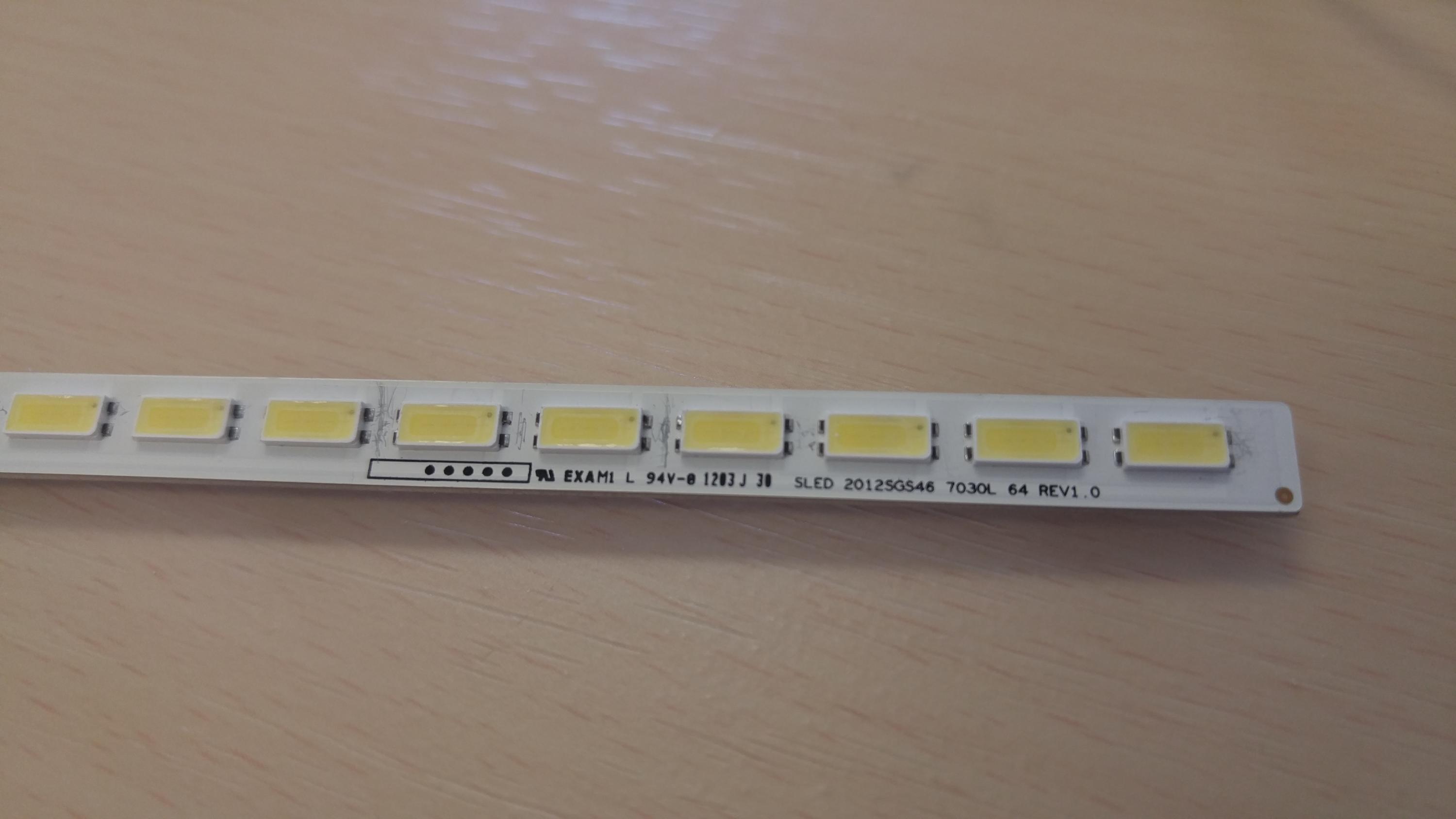

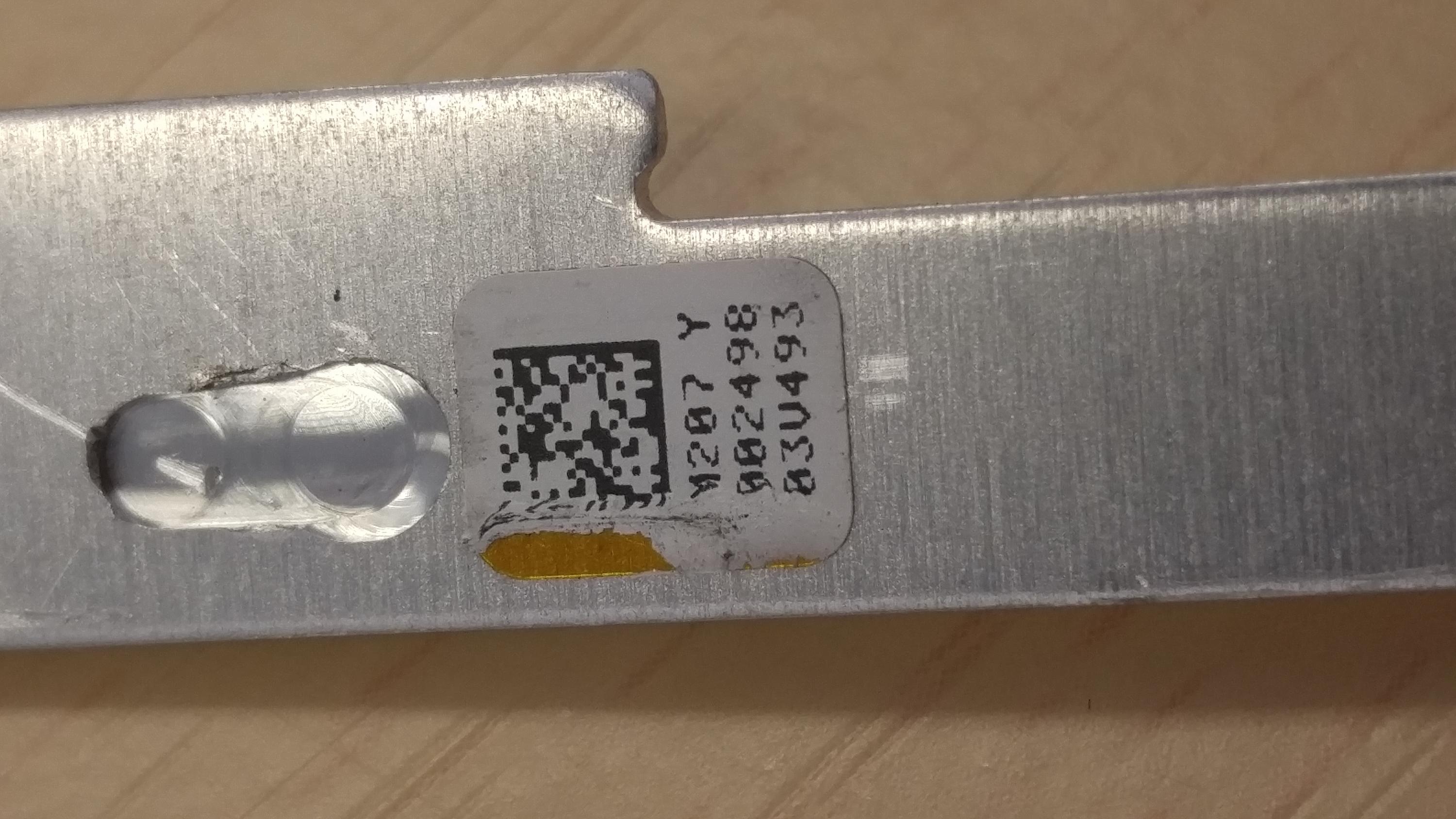

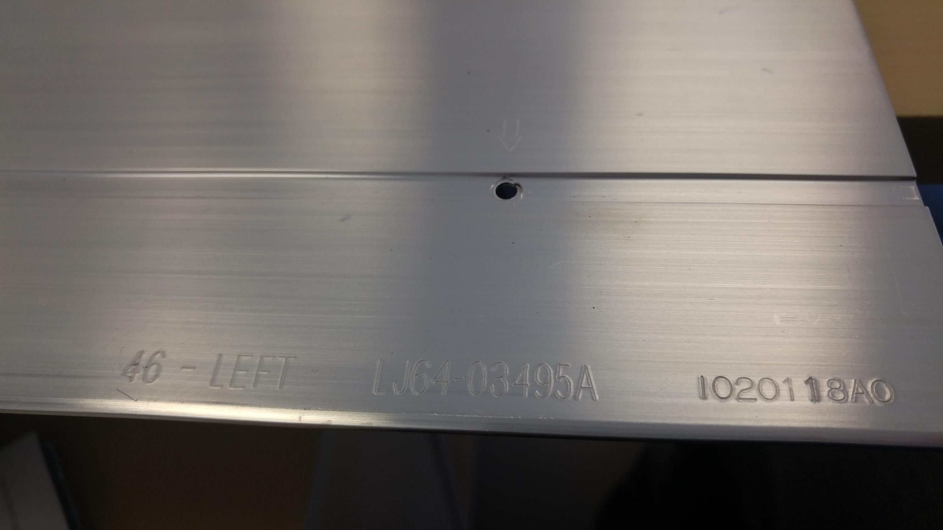

                                Ok I wanted to avoid tearing this set apart, but it looks like I also have a bad LED on this set, and have no replacement I can use in shop due to the dual LED package. How does one figure out the exact LED this strip uses and where to buy a replacement diode for it?
                                Any help would be greatly appreciated.
                                LJ64-03495A and 2012SGS46 seem to be the 2 part numbers popping up for this strip.
                                Couldn't find any specs on this edge lit led strip but here is one link to where they sell it
                                http://www.yoycart.com/Product/520801002367/
                                They are selling these for cheap but I don't want to have to wait for china to send it all the way over. To much shipping time.
                                Also this is a dual diode, there are 2 led's in each package.
                                An alternative solution using zener diodes was mentioned in the link below, but I would rather replace the LED with another LED
                                https://www.badcaps.net/forum/showth...hlight=46TL963
                                Anyone have any idea what could be a good replacement, and what info I need to provide for this?
                                Pictures of the strip are attached

                                  Re: Toshiba 46L5200U flash logo on screen when turn on
                                  it is LED Modul 7030 6 Volts current 260 mA Lumens 70Lm
                                  look here where i bought and tested 100& perfect
                                  https://www.badcaps.net/forum/showthread.php?t=52847
                                    WOOO! Thank you just bought the 100 lot!
                                    My next question for you DIAH is how did you figure out this information, and how can I figure this out on my own without having to bother you and others on this forum about it?
                                    Thank you so much for the help!
                                      take look on yours Photo No 3.
                                      from left to right ------>
                                      o o o o o = 4 Groups with 1 GND
                                      94 V. Max
                                      SLED date... S46 = for 46 panel Size
                                      7030L = Led Type / size
                                      64 = No of LEDs on Strips
                                      64 / 4 = 16 LEDs each Group 16 x 6V = 96V close to 94V. Max.
