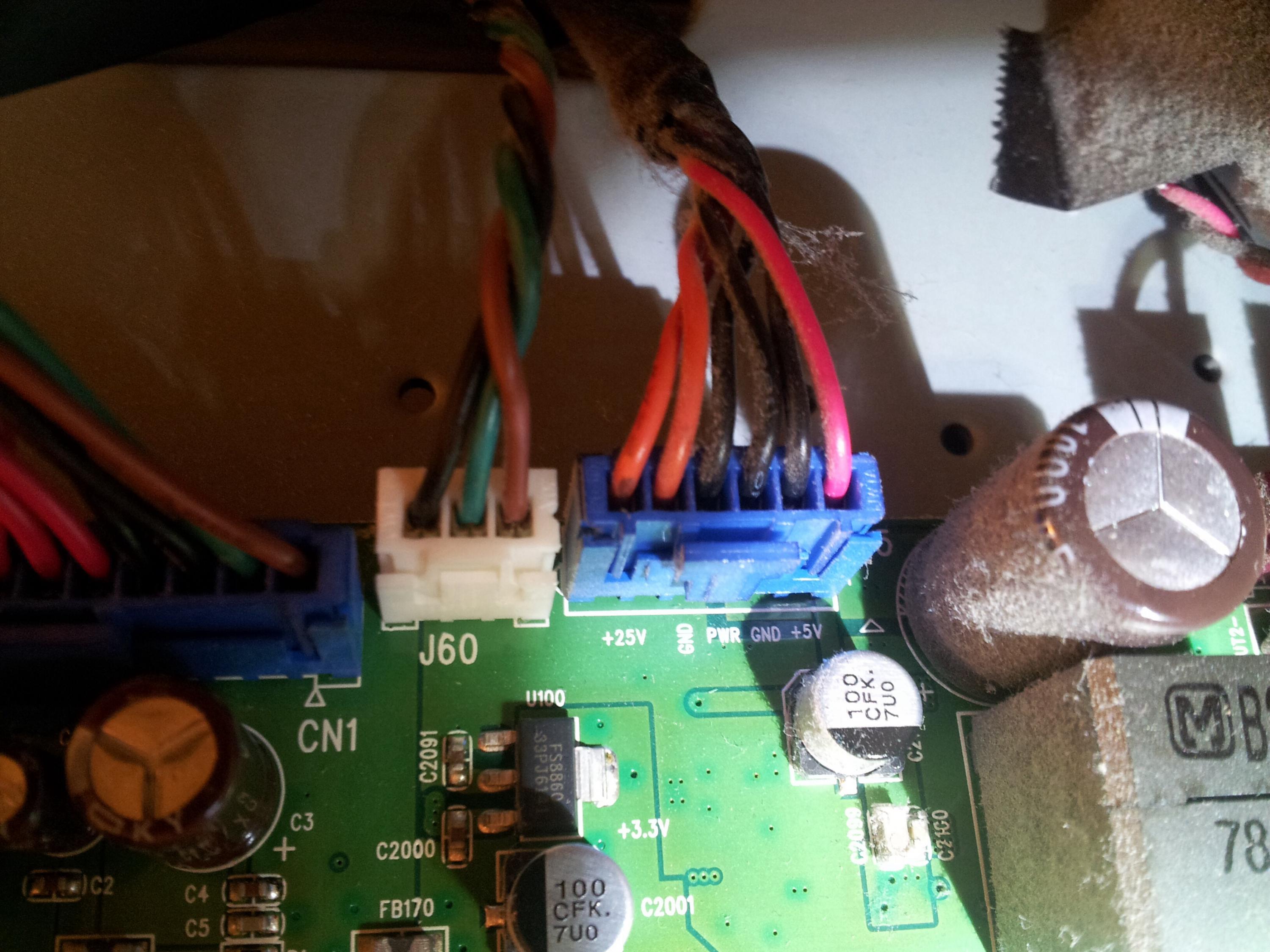

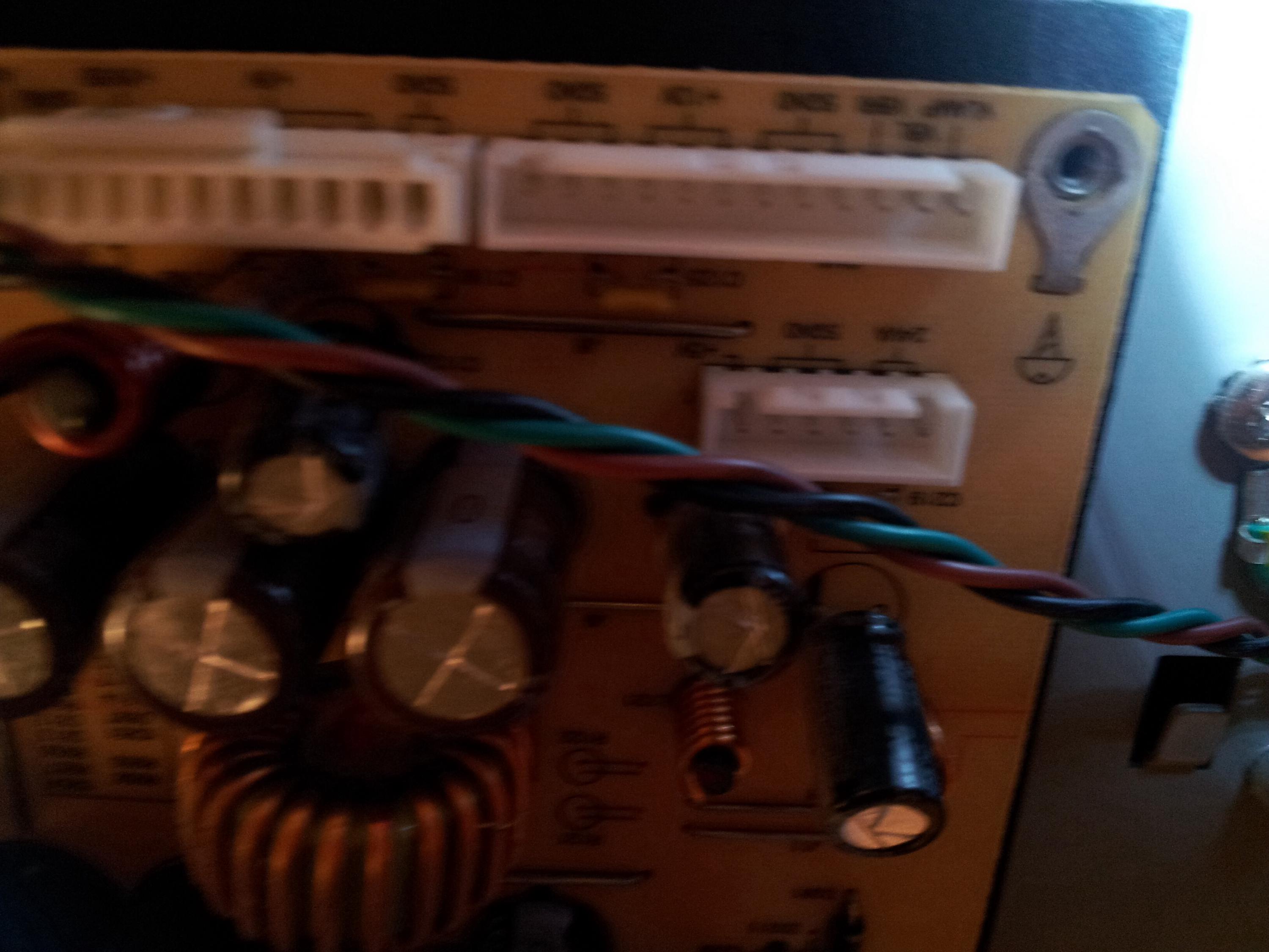

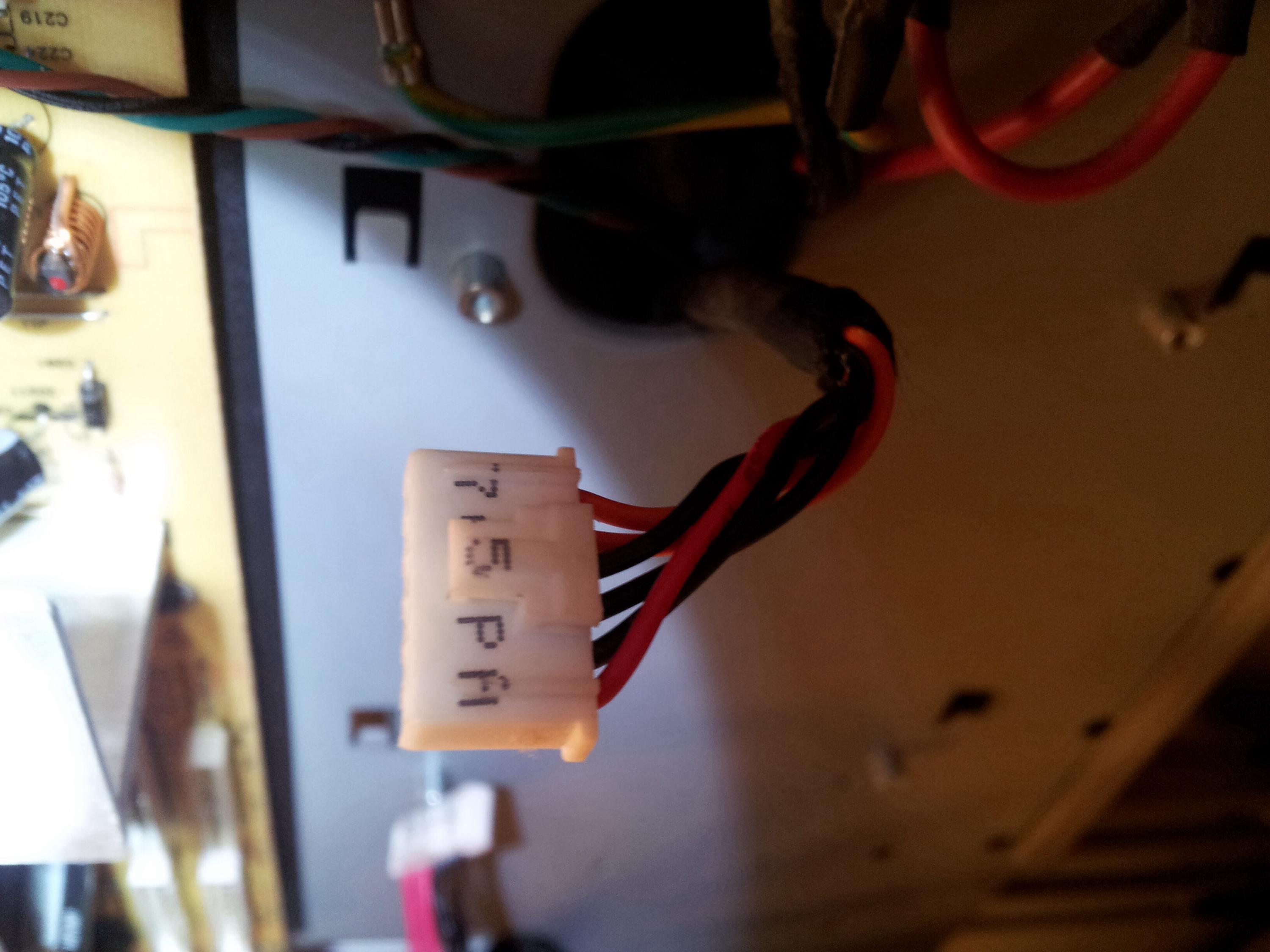

                  I noticed the following that might help you, when I unplug one of the cables from the power supply board and then turn the tv switch to on, the power supply starts giving the right voltage, all the sudden the 24 gives me 24 and the 5v gives me 5v.. When I plug this cable back on, the issue comes back... Might be related? I am including photos of the cable I am mentioning.

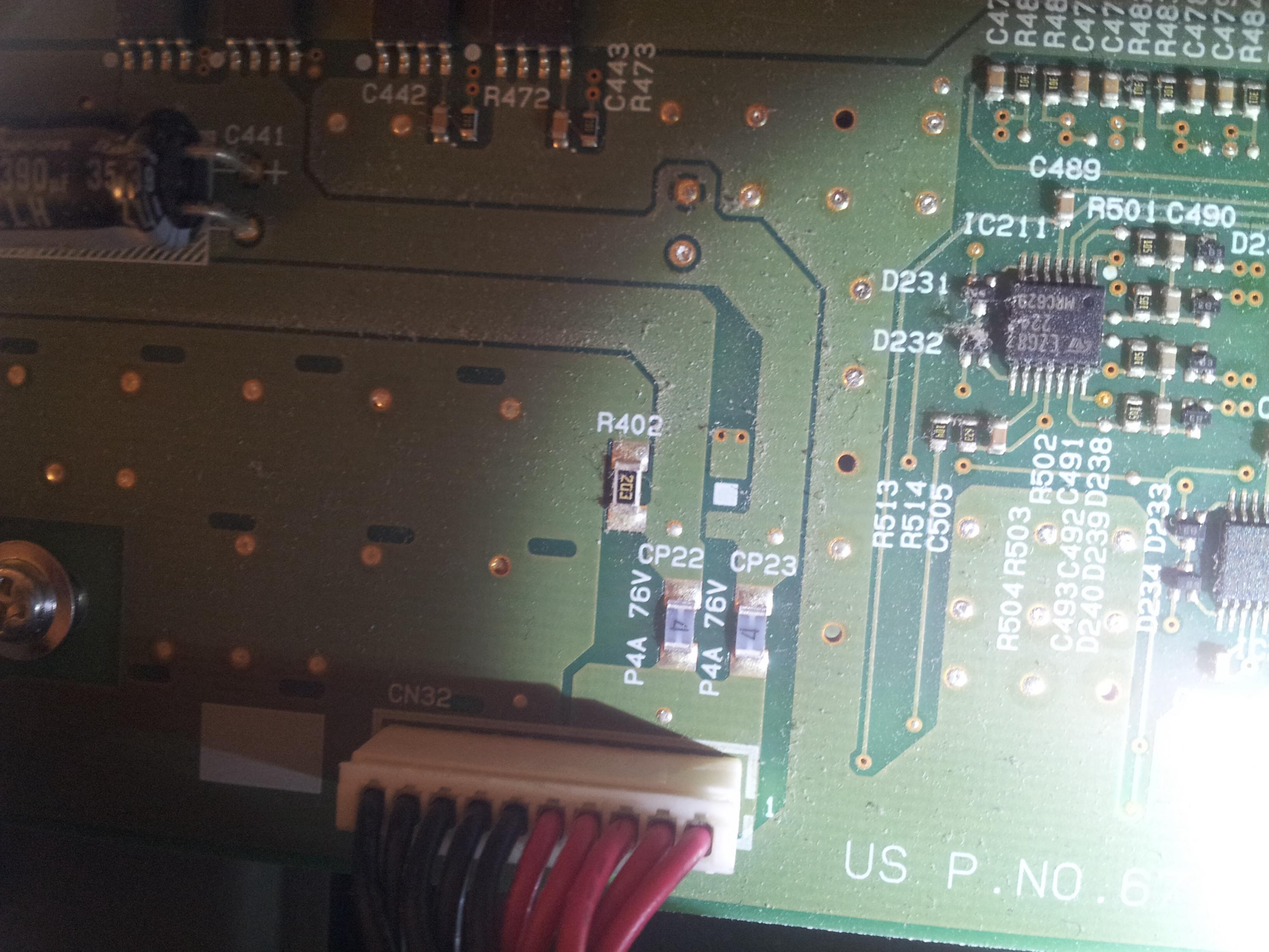

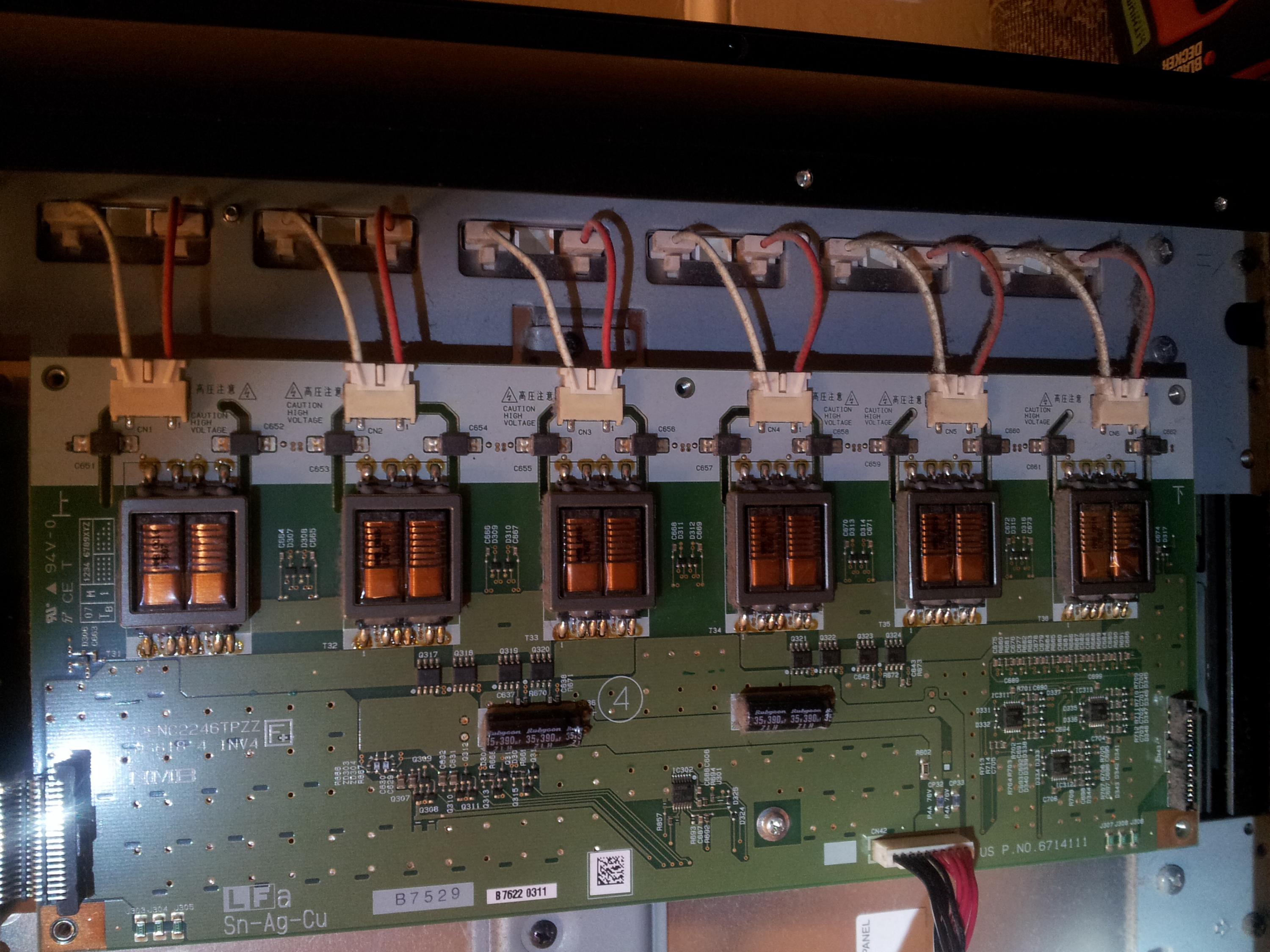

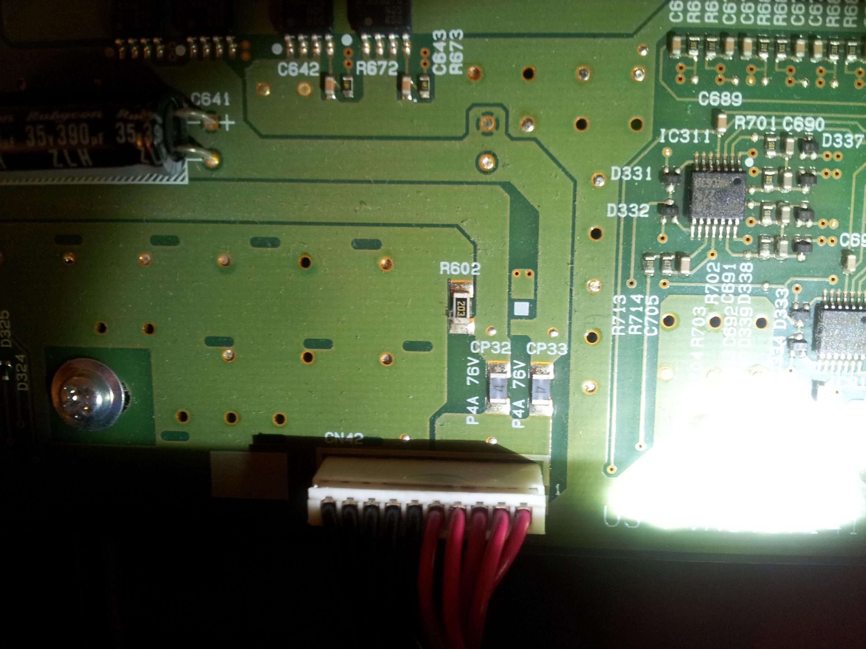

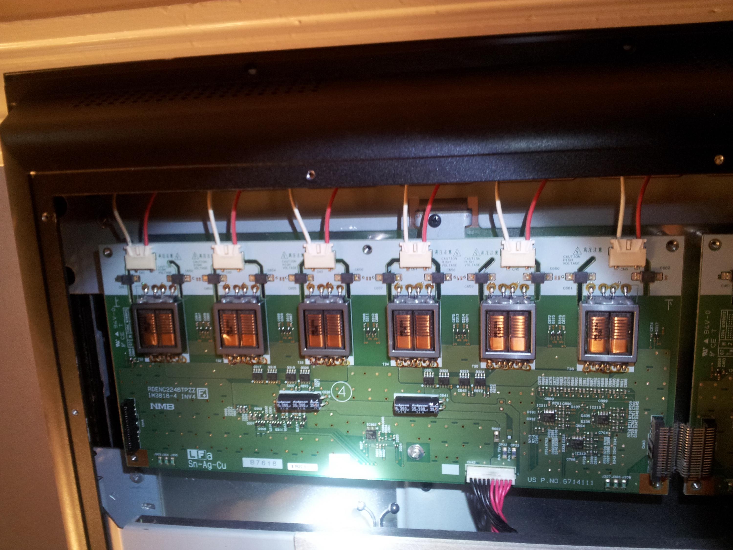

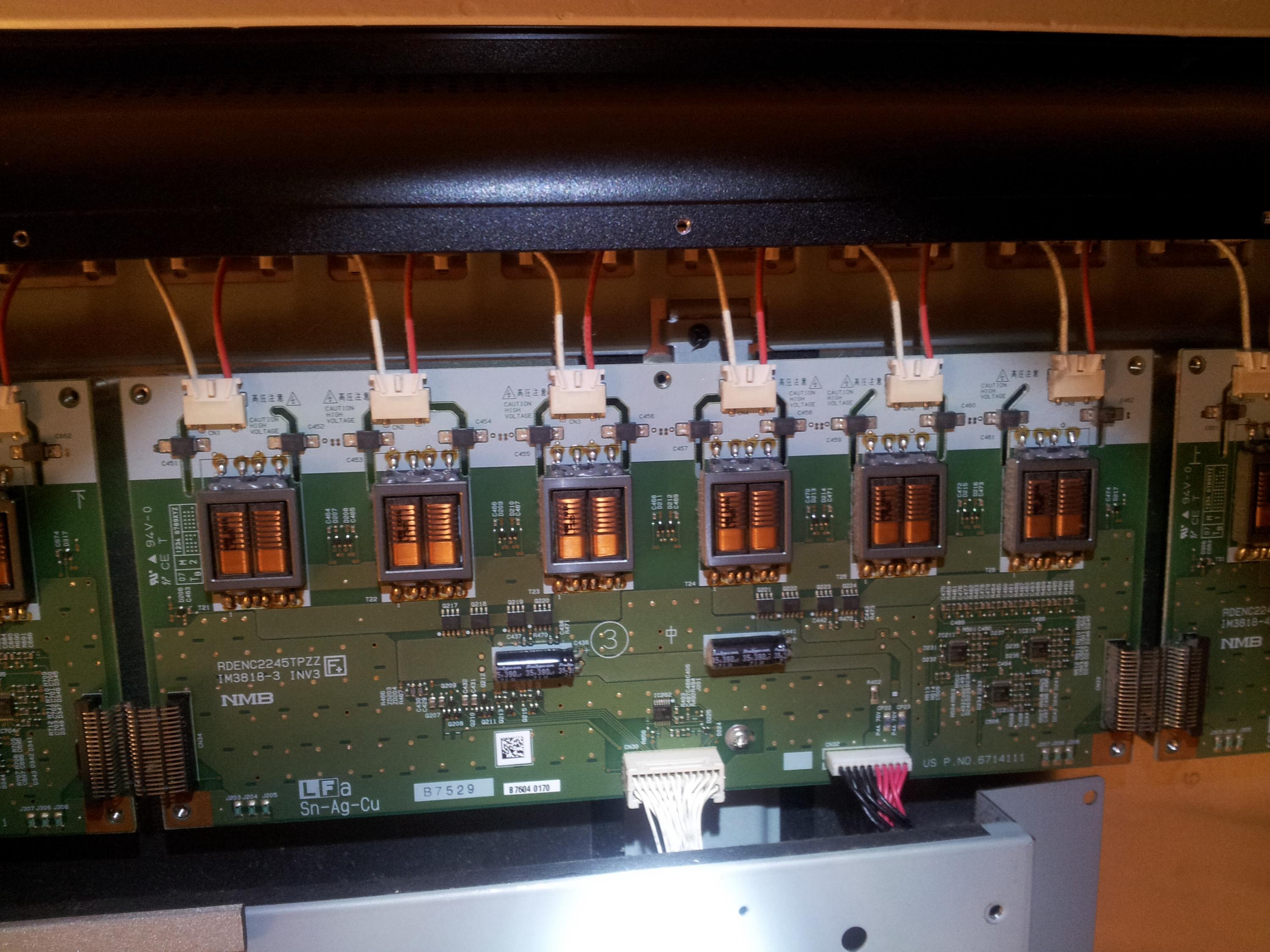

                    OK, the right side (looking from the back) seems to be the problem side since your video also show the left side (looking at the screen from the front) of the backlights do not light up. At this point I suspect the inverter board problem. There are SMD fuses on the inverter board that need to be checked and also the inverter transformers. Please take good pictures of YOUR inverter board (the one on the right looking from the back of the TV, which will be the one that is connected to the power supply that does not have 24V).

                      Good morning and thanks for the reply! I will check as you say. On the right looking from the back there are three inverters, 2 number 4 and one number 3. I will take pictures of the three!

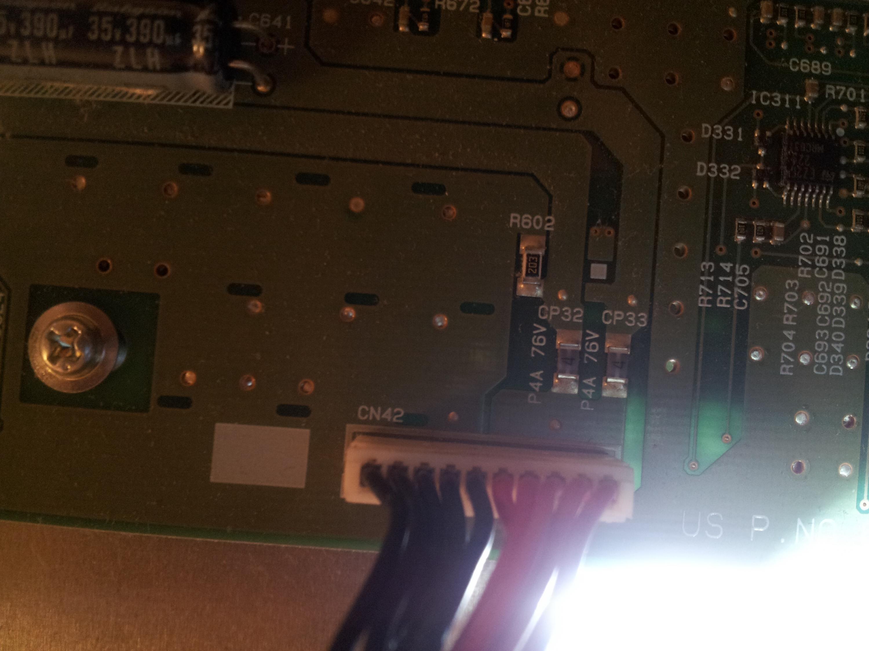

                        Ok, I was able to get to the inverters from the side with the problem. To the naked eye, it does not look bad... But I am not a pro.. So I am attaching a picture of the smd fuses and transformed for all three inverters on that's side. Please, Let me know what should I be looking for or should I meassure something with the multimeter? Thanks again!

                          Budm, let me ask you a question, besides the photos I just sent you of the inverter, yesterday around 11:46pm, I sent pictures of a cable that when unplugged the power supply's starts working just fine... This cable goes to the main board. Now, I just unplugged all cables to the inverter, checked the voltage on the power supply's having plugged and unplugged the cable I just mentioned to the main board... And the problem persists when plugged. Seems having the inverter disconnected didn't to any difference on how the power supply board works when having this other cable plugged or unplugged.

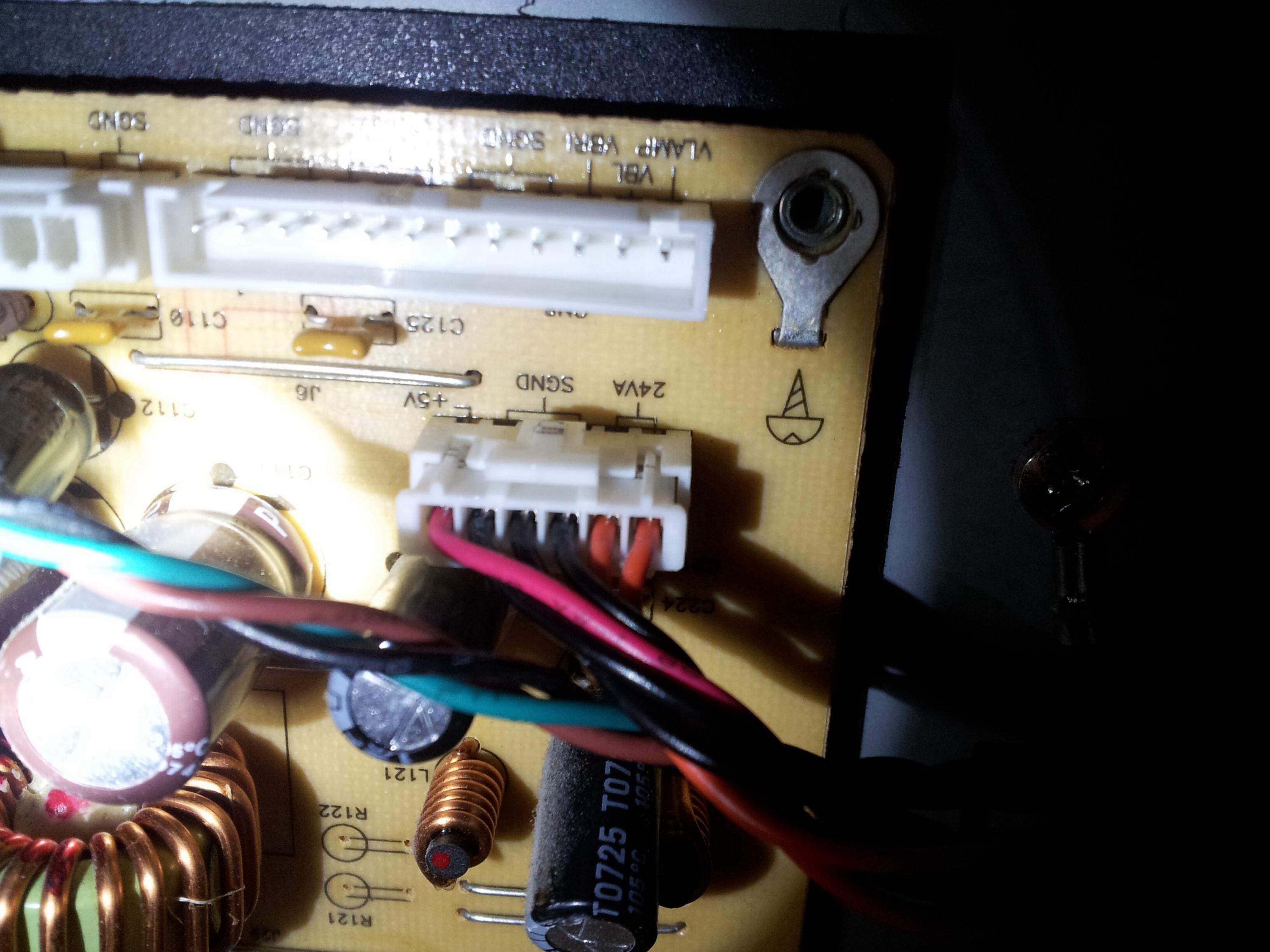

                              Budm, I don't want to confuse you anymore, since now I feel we are close to find the problem. Like I explained earlier, disconnecting the inverter does not gives me the 24v back.. But there is a cable that I do disconnect from the power supply and when I do it does give me all 24v back... The cable I am talking about is attached on the pictures. It is a cable that goes from the power supply to the main board, I am showing you pictures of the cable, where it gets plugged and where to the main board it goes. Let me see if you still have questions, I will try to better explain myself
                              Images, white plastic cap goes to the power supply board, blue cap is the same cable and goes to the main board.
                              Thanks a lot for the patience.

                                So you get 24VDC output from both power supply bundle of red and black wires to both sides of the inverter boards with inverter boards all connected? I do not know what the connect that you removed is for.
                                  #36
                                  Re: OLEVIA 265TFHD-t11
                                  Hi Budm, thanks for the reply, yes, when that wire is disconnected, I get 24vdc in all red and black that goes to the inverters on both power supplies. But when I try to turn on the tv with that wire disconnected my screen doesn't light up at all no matter how many times I power on the tv.
                                  So you are not sure what that cable is for, is there any info I can provide to help you ?

                                        No at all, I am still trying to figure what are the connections are between the main boards and the two power supply boards, so far I cannot figure out why it does what it does when you disconnect that connector.
                                          #40
                                          OK, try to do this for me, write down each pin function of connector of the main board that are connected between the Main board and the power supply boards, inverter board. Do the same with listing of the power supply boards, inverter boards.
