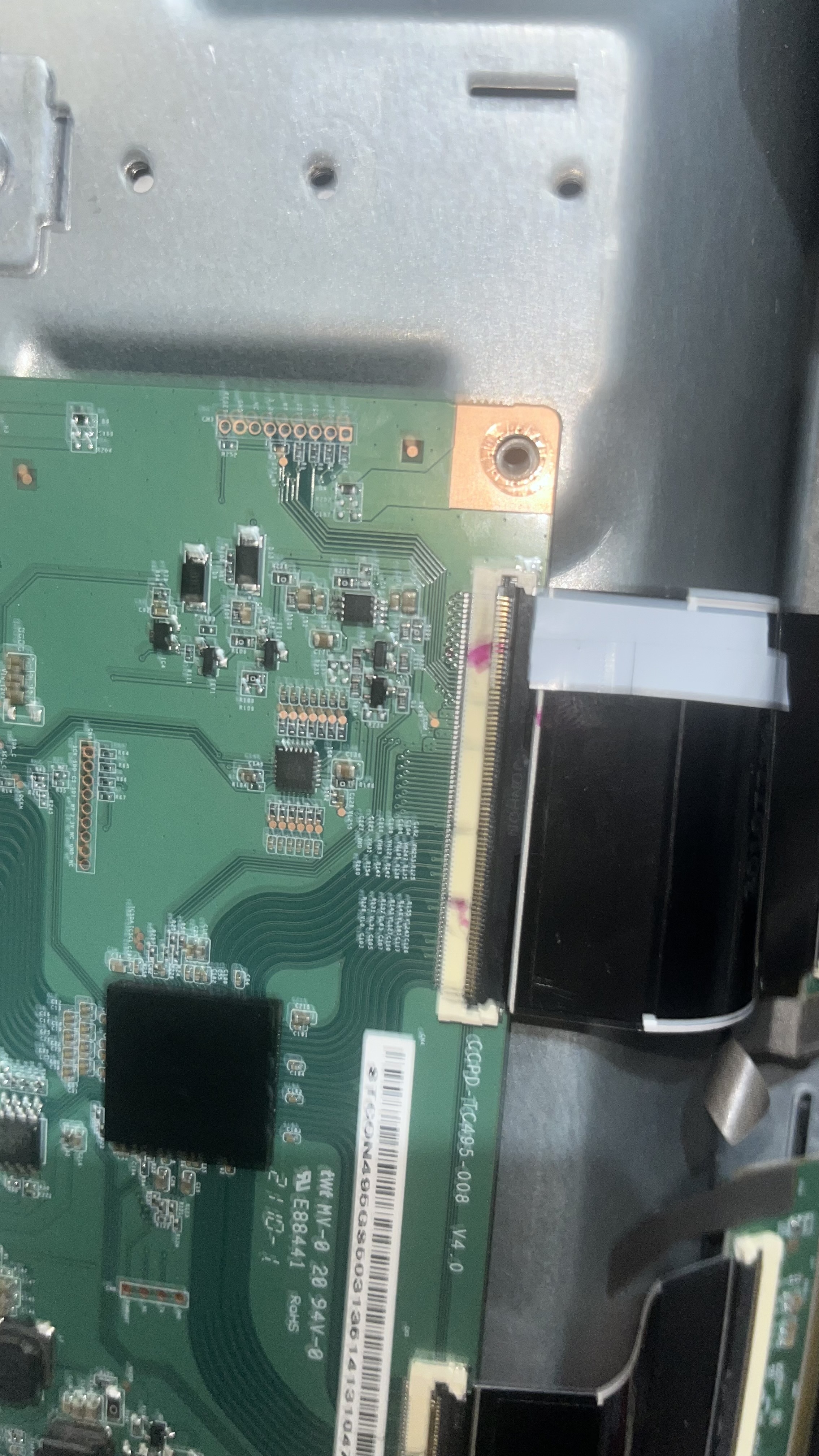

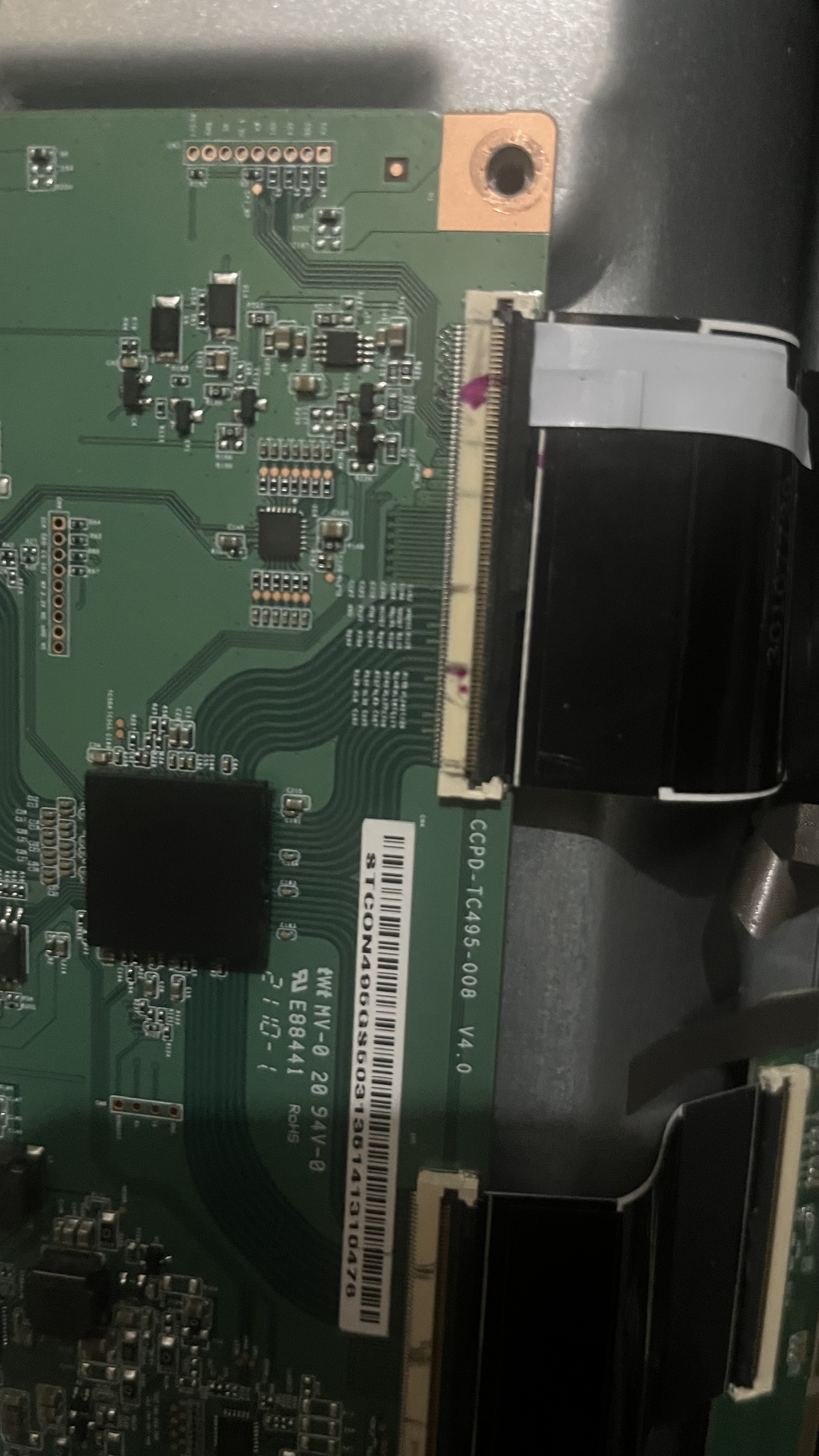

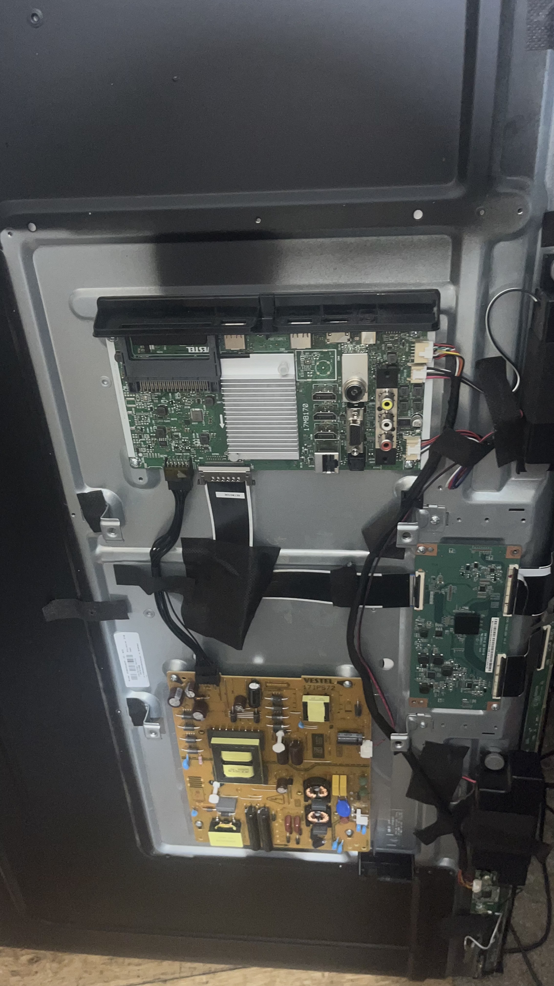

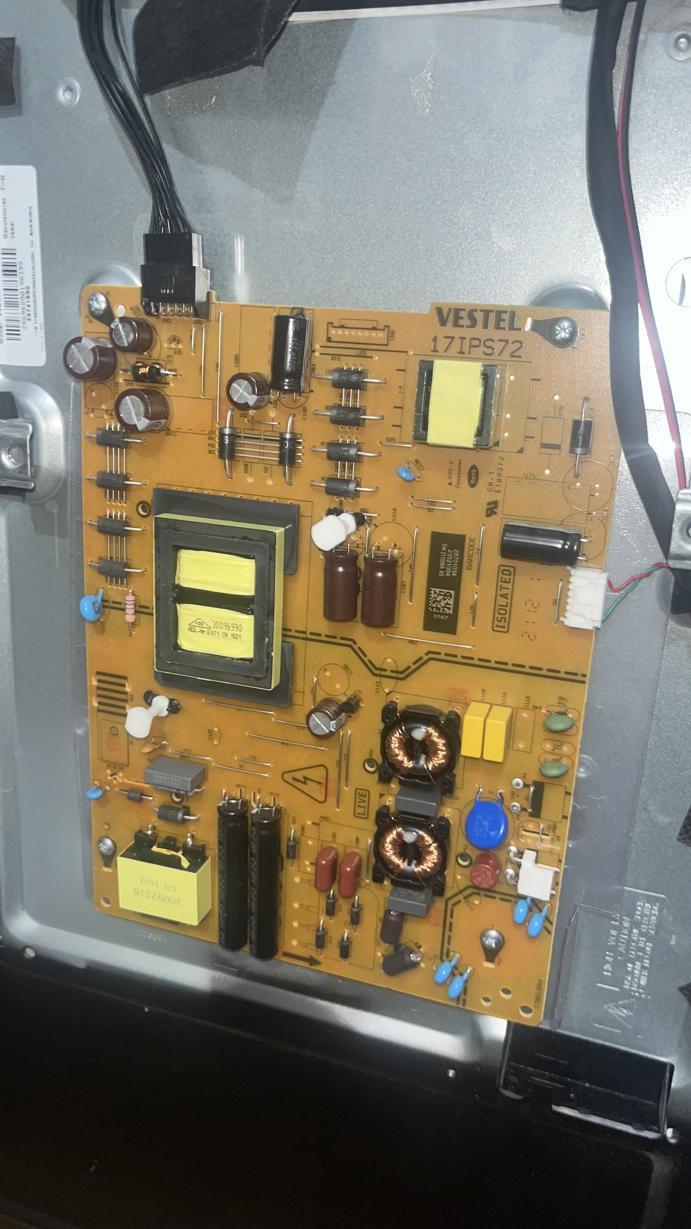

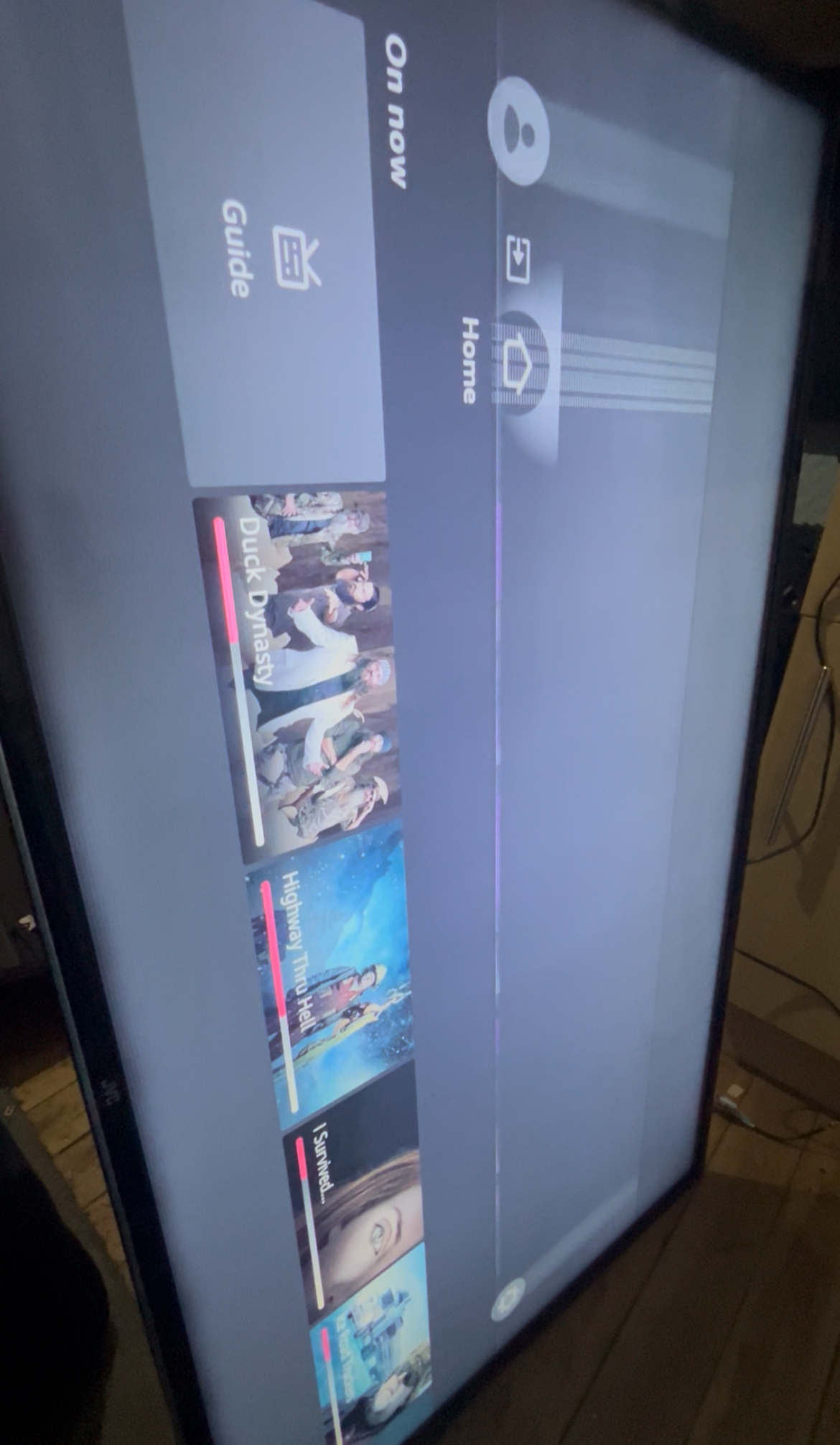

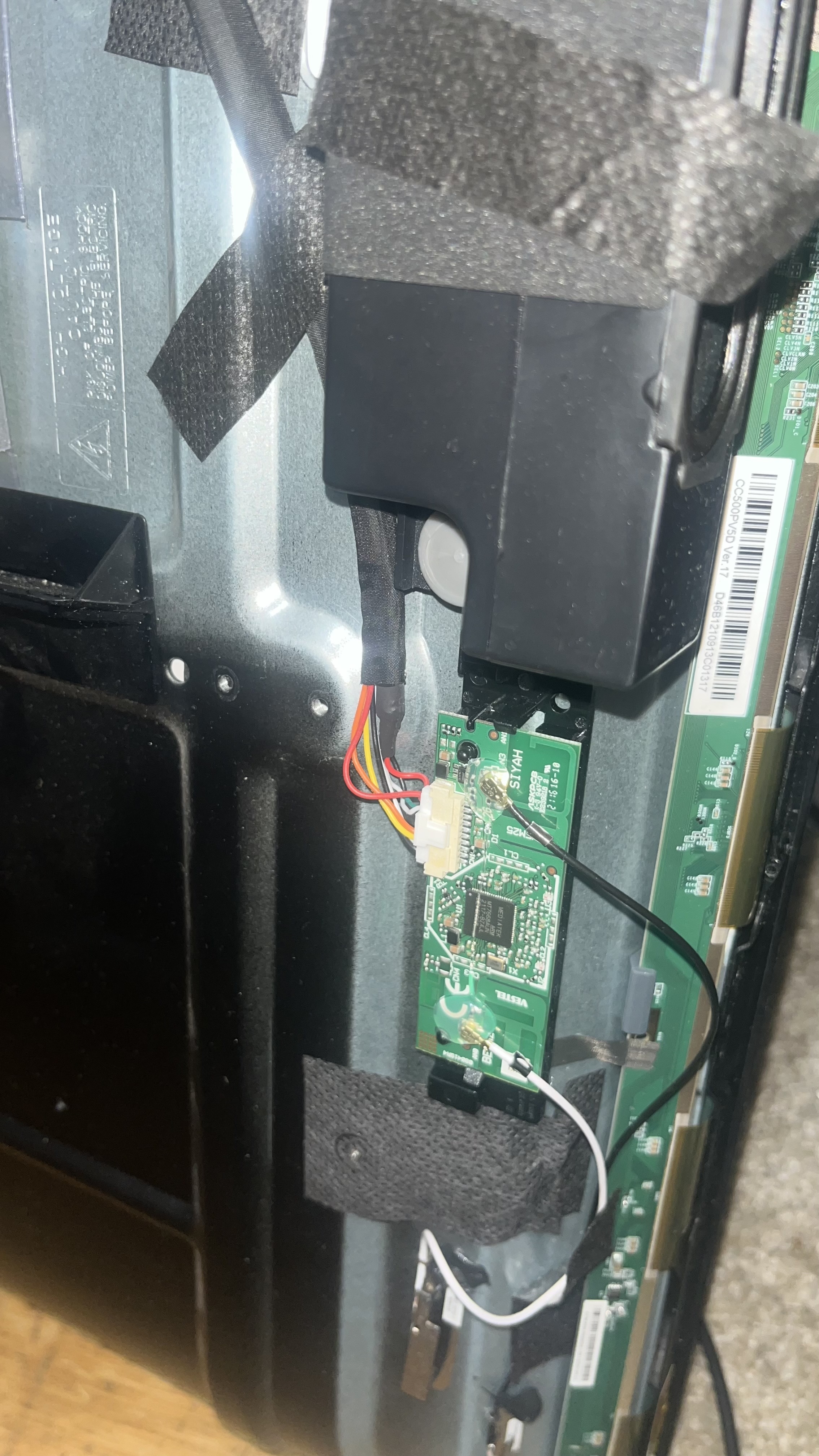

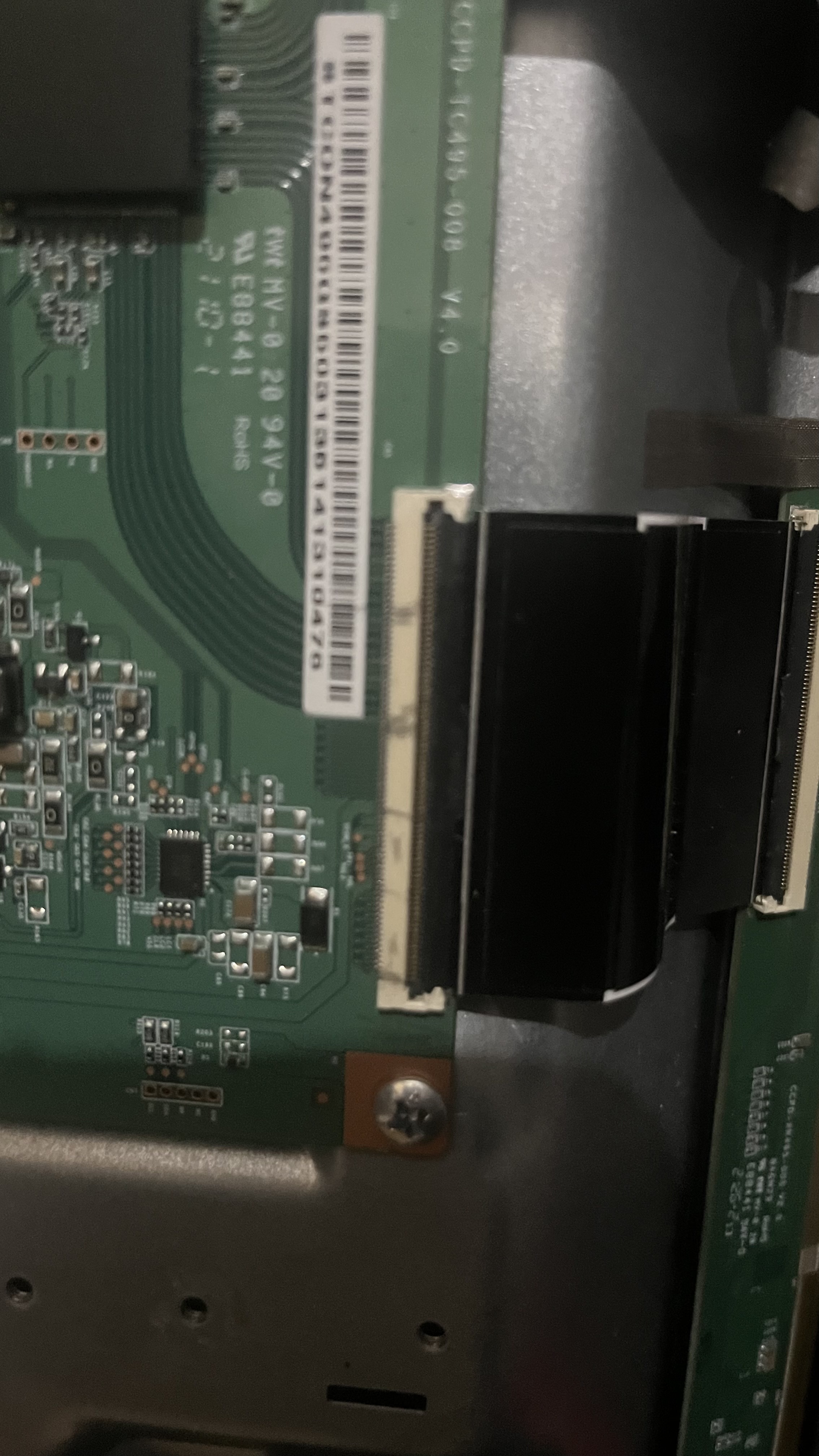

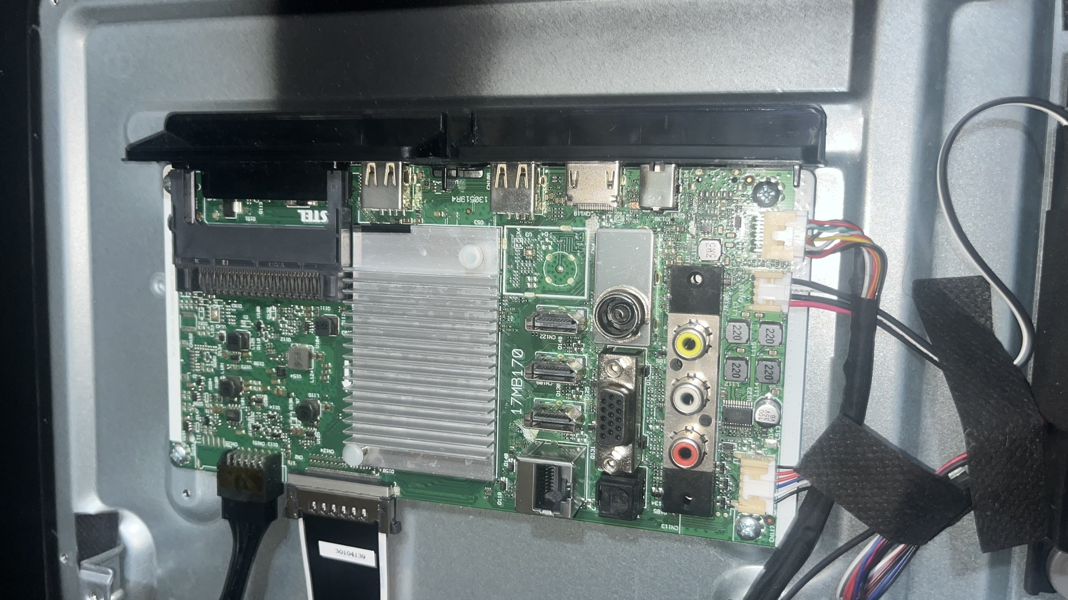

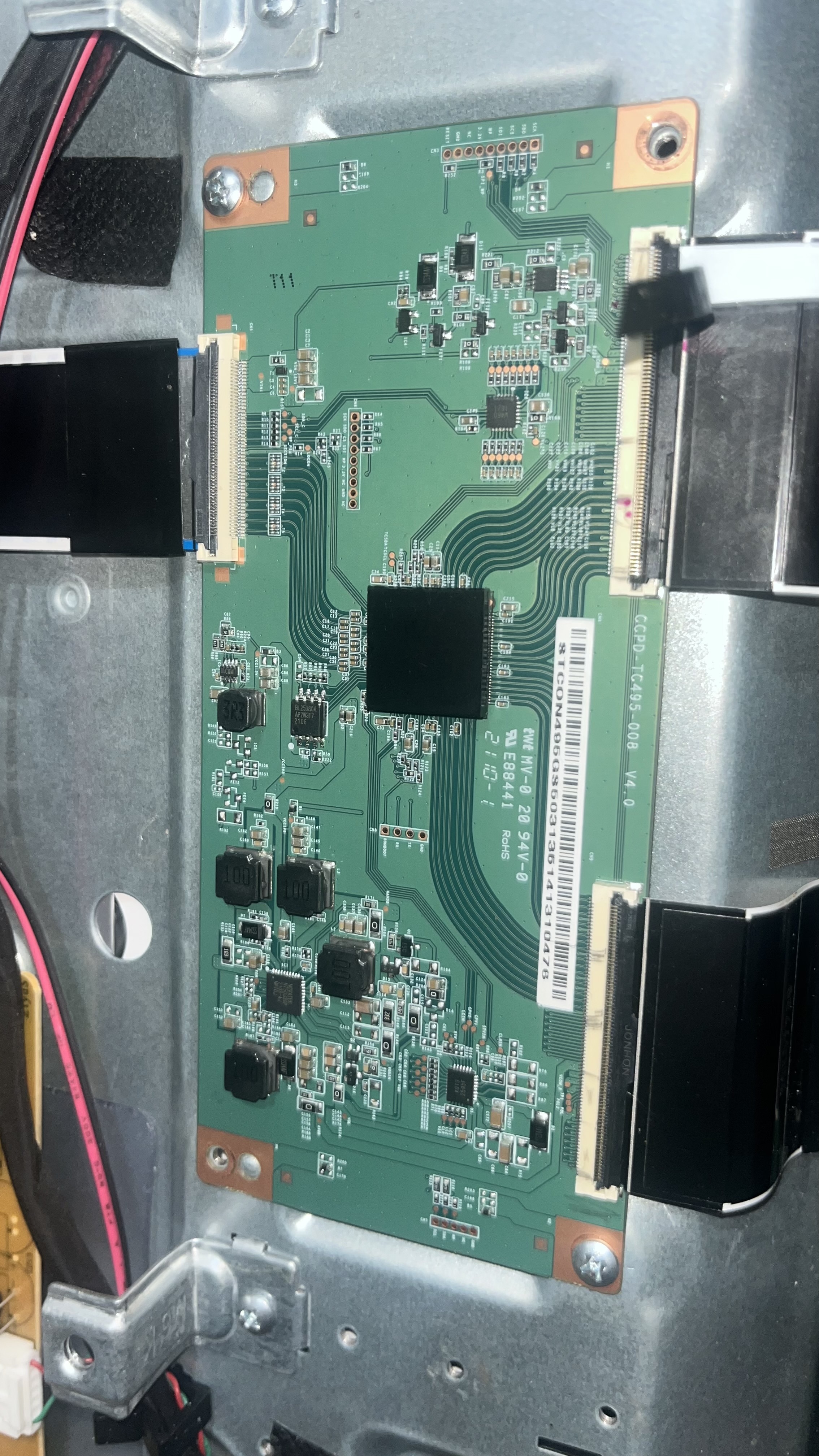

    Hi again all,
    I’m busy trying to sort this tv out JVC LT-50CF890 (c) , originally i had nothing on the screen, but after removing the Tcon strips off I got half a picture, now while trying the tape method I have a complete picture but after the boot screen I’m getting lines , I will upload photos & any help would be appreciated Click image for larger version

      There's nothing more you can do, these panels are known to fail

        That half picture you got, was it a good one or did it have lines also?

          I'll throw out some thoughts, Thinking it could be dirty flat cable ends from tcon to panel, bad tcon, maybe bad tab bond.

            You can try the simple things, never know I guess. Try plugging tv straight into wall outlet if using a strip. No joy, try unplug tv for 5 minutes, press and hold power button on tv (if equipped) for 45 seconds let go, plug tv back in and try it. If you can work the menu try a system update, try factory reset, make sure during test that no hdmi or rca cables are plugged into tv.
