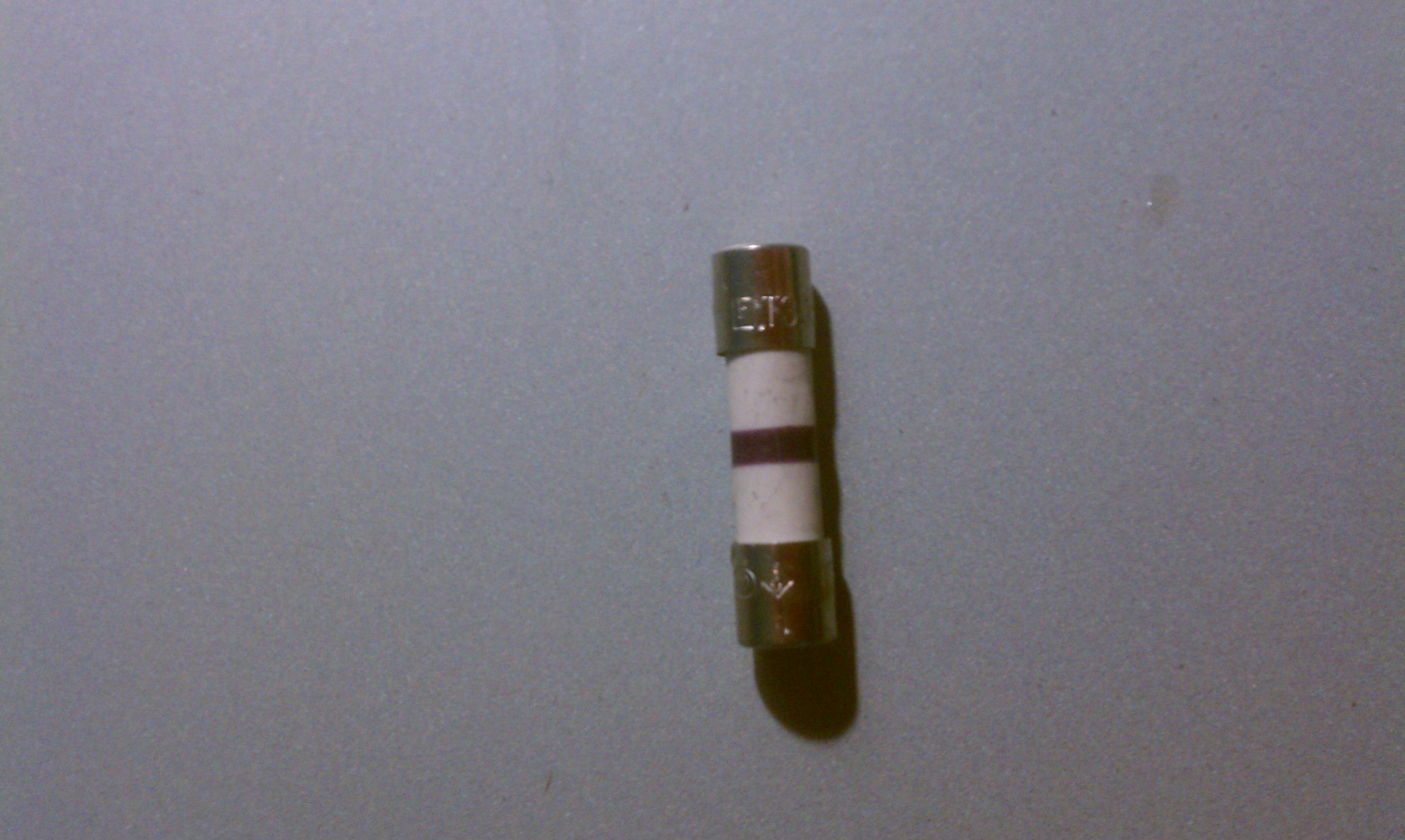

    got this TV for 10 bux because it doesnt turn on. no standby light, no standby voltage.
    i noticed that one of the big ceramic fuses tests as open.
    so i replaced it with another ceramic fuse from a dead PC power supply i had lying around. when i plugged in the TV, not even a second later i heard a loud pop and thought i saw spark even at the fuse i just replaced. also it looked like the fuse got cracked or damaged in some way.
    i assumed the TV had blown the fuse just like it blew the one before it but when i checked with my meter, the fuse is still OK!
    so what popped then?
    the original fuse says T3.15AH250V but the one i replaced with just says 250V on it. what does the 3.15AH mean? is it possible i used the wrong fuse and blew something else up?
    also i notice now that it takes forever for the main filter cap on the right to discharge itself. the one on the left discharges in a couple minutes but the one on the right takes a really long time! i didnt really test this before changing the fuse though so im not sure. but i think i remember it draining pretty fast because i was able to change the fuse without waiting forever.

    3.15A is the current rating of the fuse. You MUST replace the fuse with a 3.15A fuse or damage/further problems could occur.

      ah dang well the one i replaced it with said 10A on it...live and learn.. i thought all those ceramic fuses were the same for some reason. guess ill have to get a 3.15A to see if i did any other damage...

          BTW, the AH after the current rating of the fuse means that the body of the fuse is of ceramic type. If AL then it means glass type

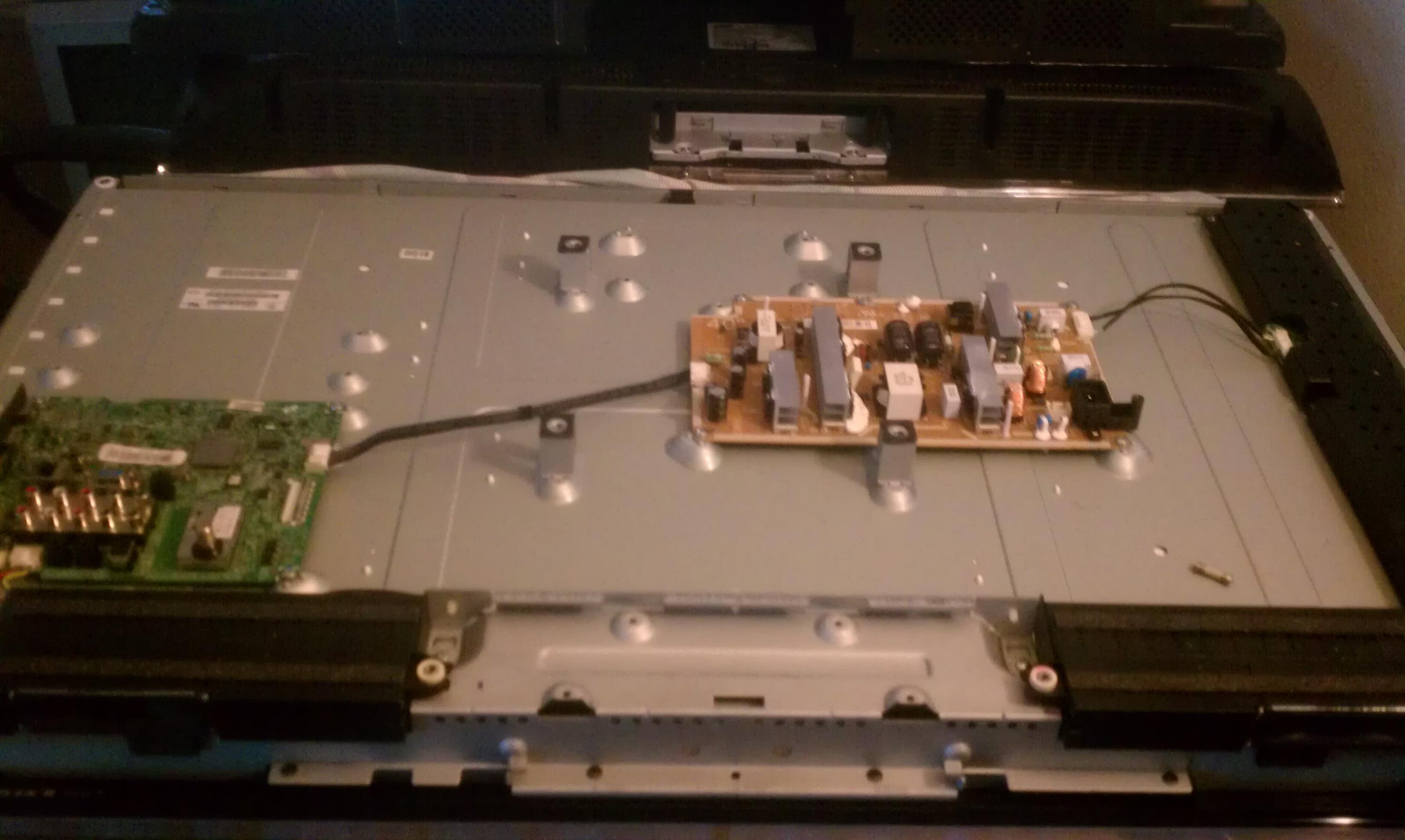

            thanks, i was wondering about that. yeah the fuse didnt blow but something else made a loud pop noise and sparked. i tried testing diodes around that area and they seem fine. but i guess i wont know till i find one of these fuses...radioshack or ebay??

              You have probably caused a lot more damage to the power board. Maybe best just to replace it. You should not just replace a mains fuse without identifying original failure... too much risk of damage.

                how do i go about identifying the original failure if i cant see any obvious damage? dont i need to get the tv at least powered on to see voltages? i would like to learn about the SMPS in detail by trying to fix this one... and fuses are cheap so i dont have much to lose. ive gotta at least try. i cant even find a replacement PSU on ebay...

                  T3.15AH250V
                  The T means its a time delay fuse (Slow Blow)
