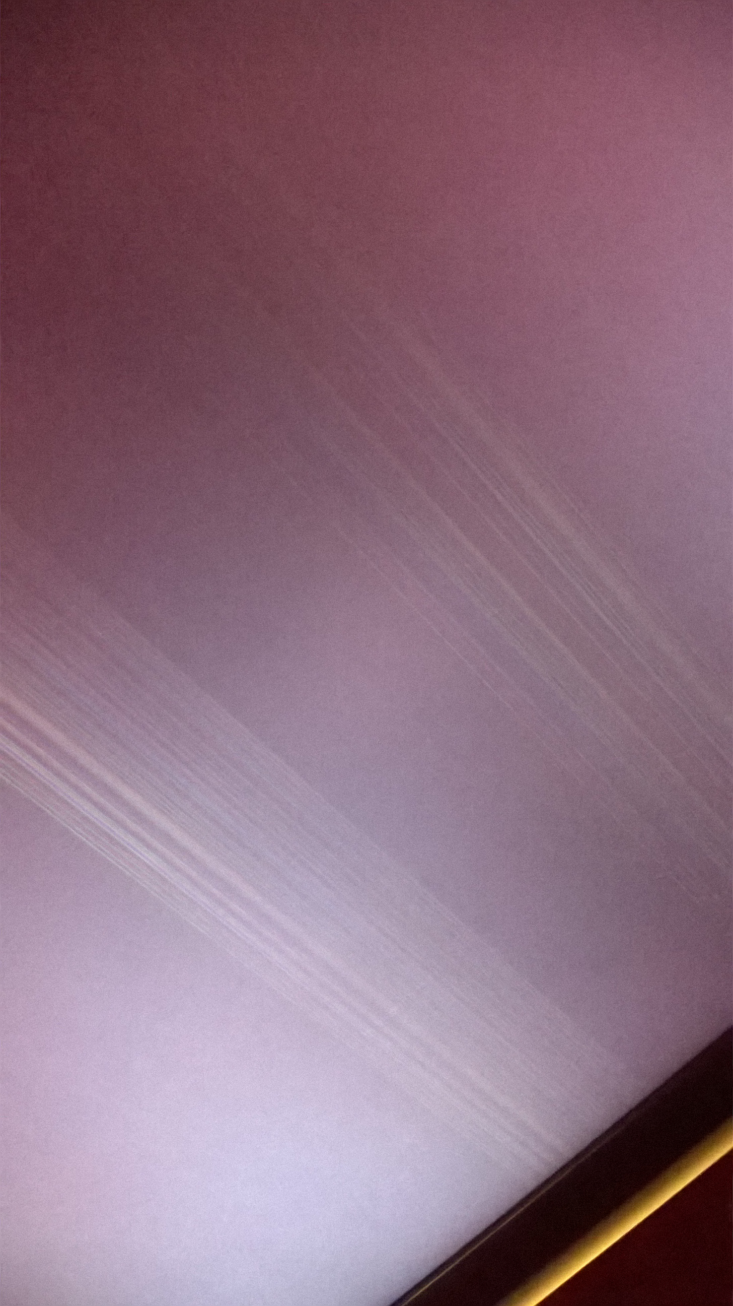

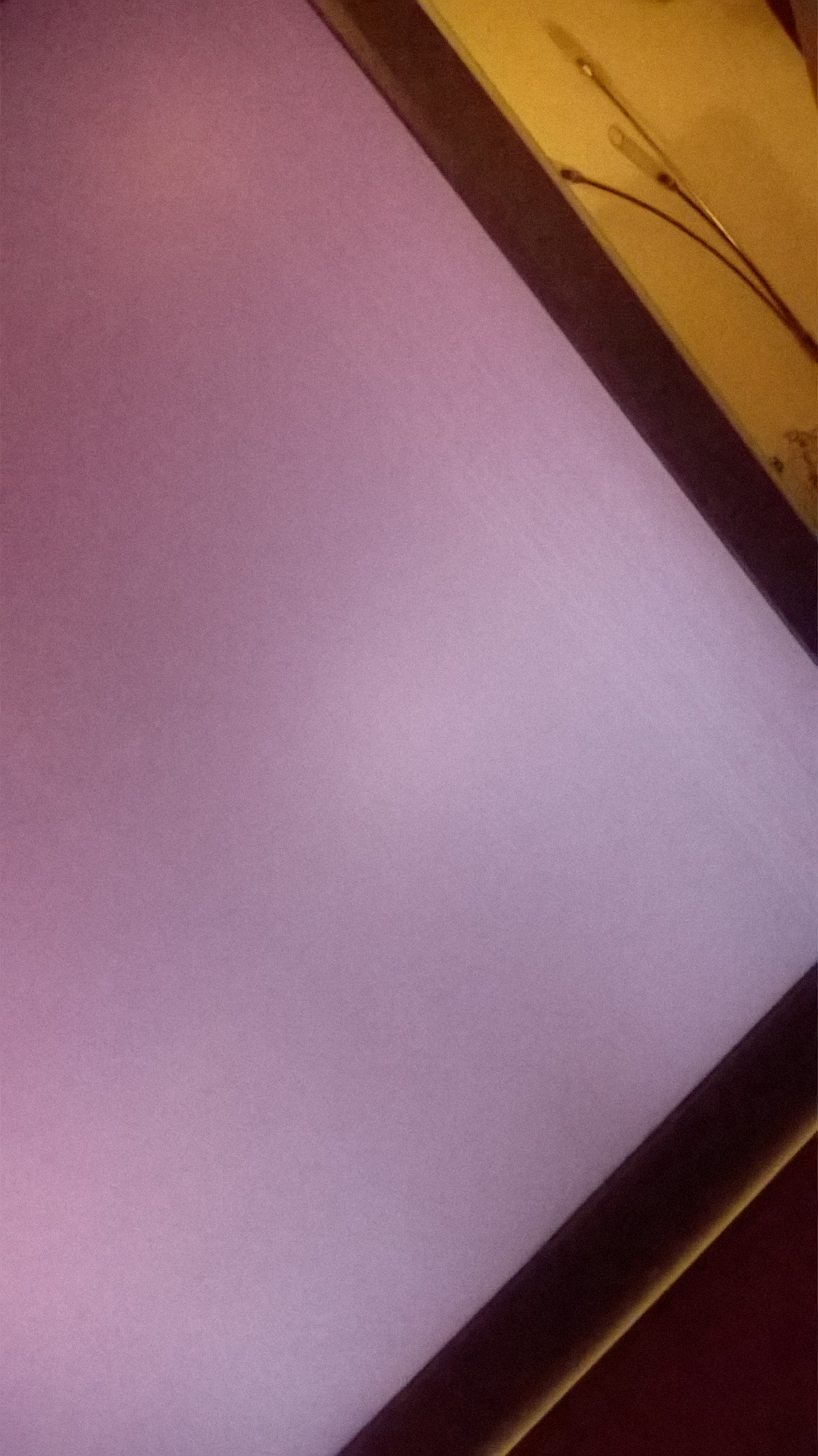

    toshiba 47wlt66 help

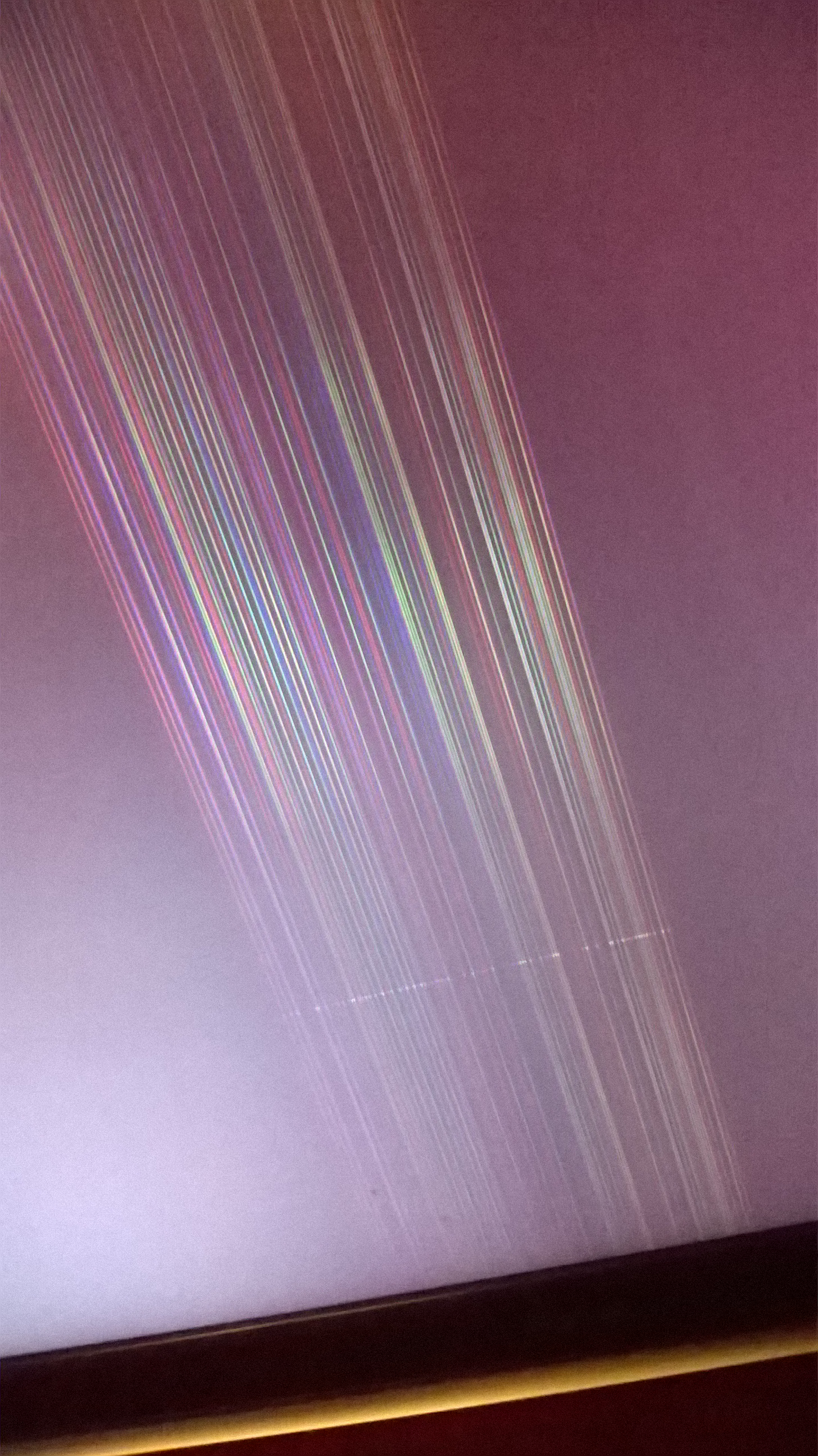

    Picked this and a phillips 42inch ambilight last night the phillips tv has a smashed screen so that's going to the tip but the screen on the Toshiba seems ok so I plugged the Toshiba in and was greeted with a dark screen with just the backlight on nothing else happens no menu etc when powered down with the standby switch then powered up again there are coloured lines down the screen which fade and it goes back to the dark screen and backlight could this be a bad tcon or isit another bad panel? Cheers

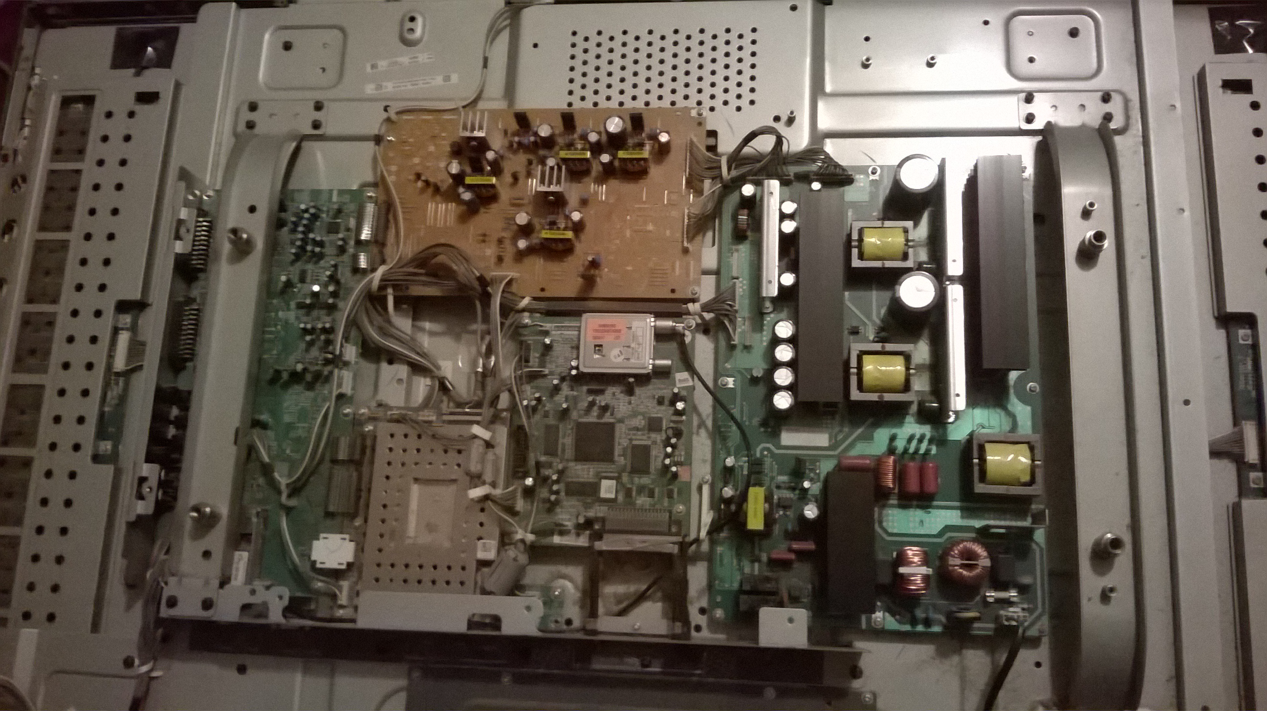

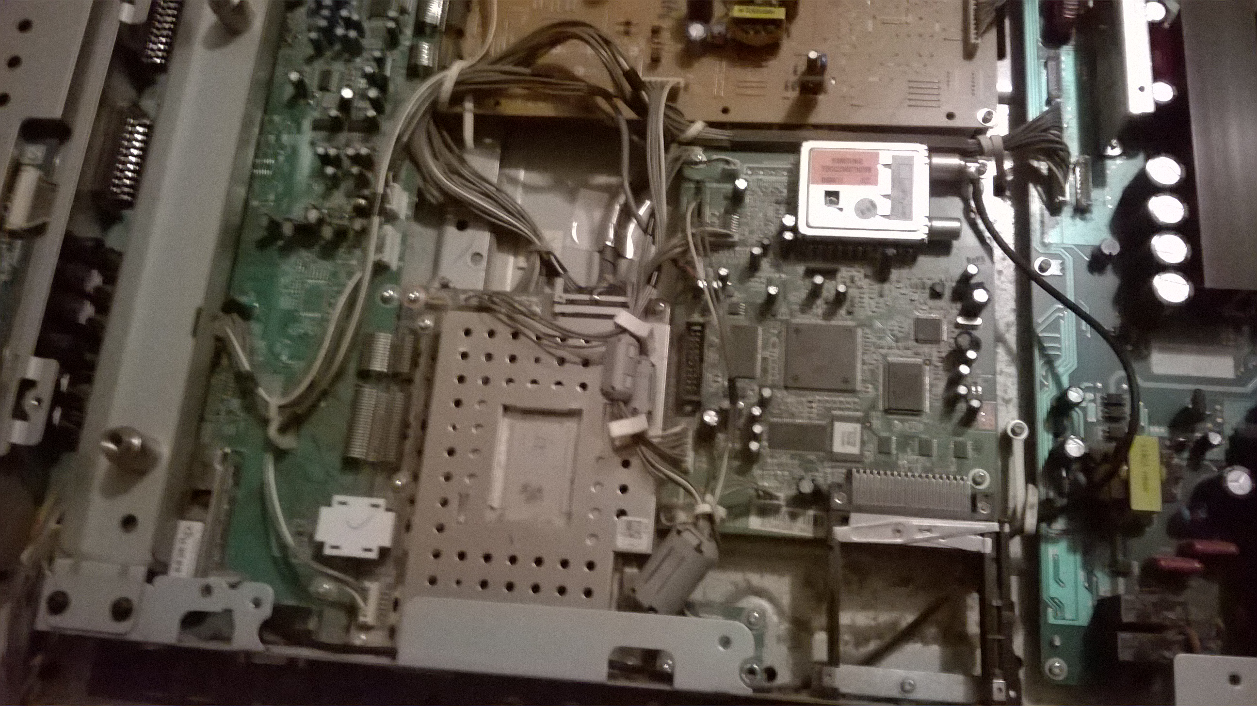

    Re: toshiba 47wlt66 help
    Can we see the whole back side of the TV so we can see how all the boards are connected? It may be T-CON board problem.
      Here's the pictures hope there ok
        Try unplugging one of the ribbon cables from the T-con board, one at a time. Could be shorted panel. If picture comes back in part it would confirm it.
          Hi I tried the ribbons 1 by 1 and still no picture still has the Lines any ideas

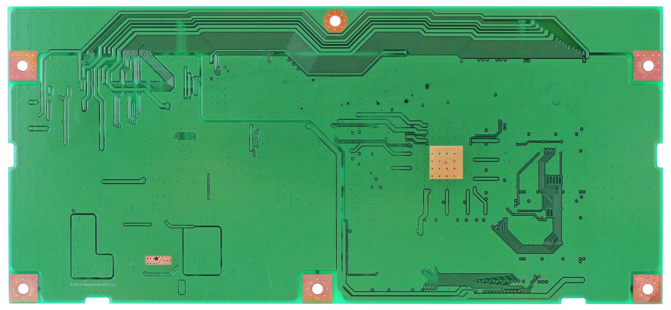

              Picture of the T-con board?
              Hi already put the tv back together and didn't get a picture of the t con ive got a stock picture mines exactly the same
                Can't see anything in that picture; you're going to need to provide a much bigger one.

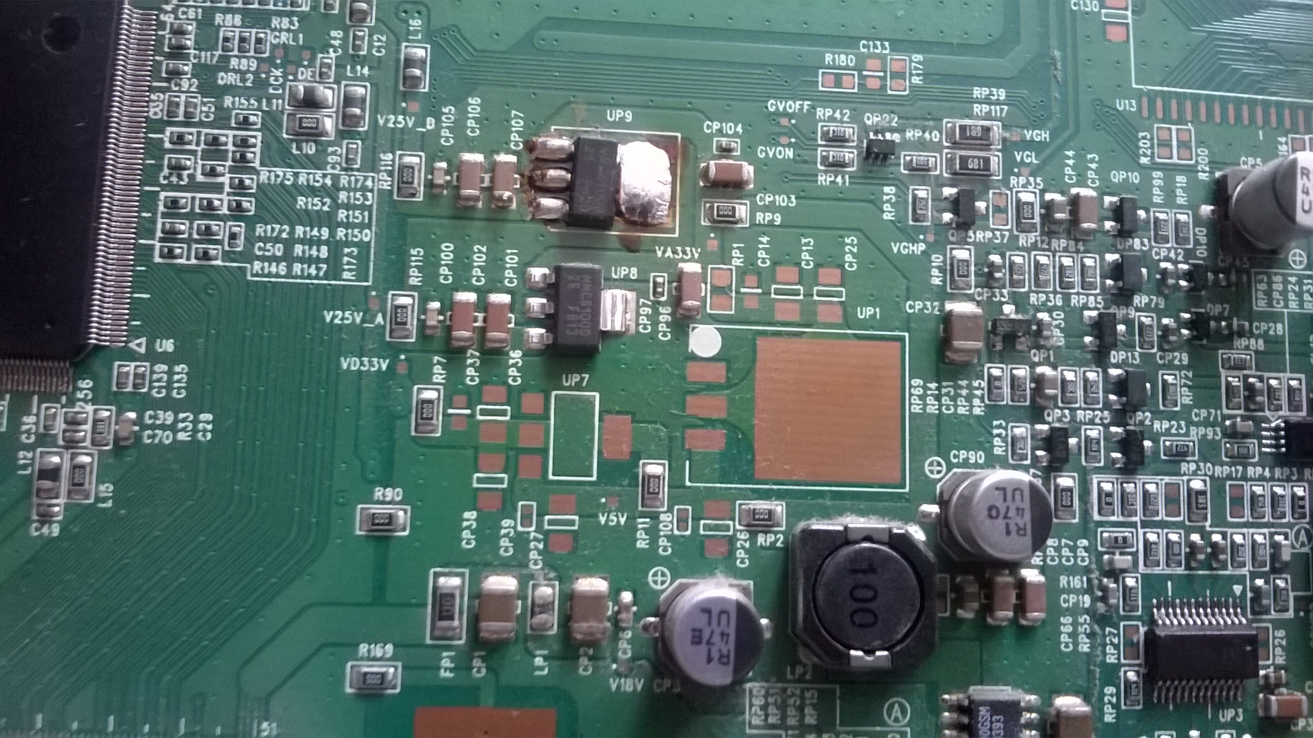

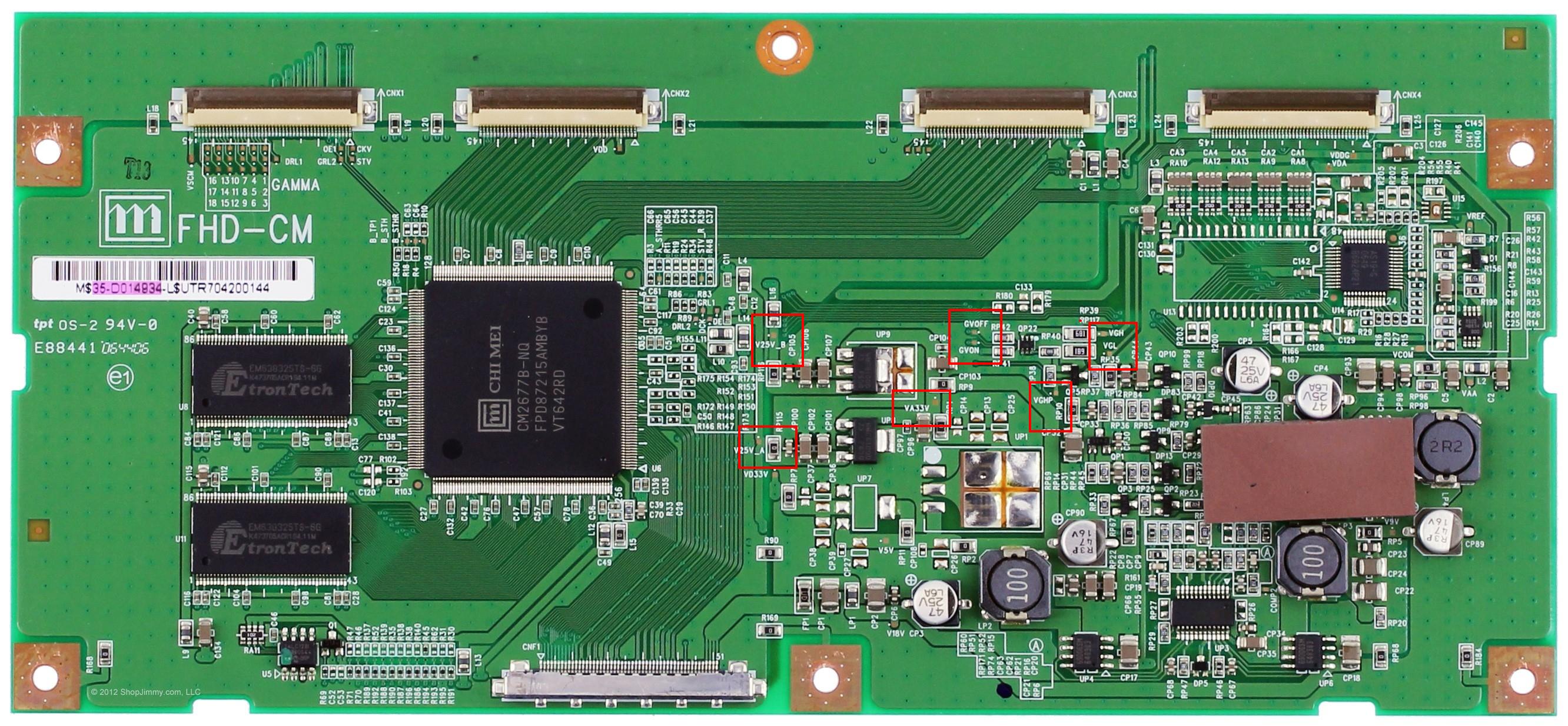

                    Check voltage as red circle on front pcb and post here.
                    Regards
                      Regards
                      I took the tcon board out this morning and just cross examined it with your picture of the tcon and it appears up9 has been soldered but its been soldered over other solder points would this be the problem?
                        Looks like it's been replaced before. Maybe it is bad again?
                          @ tom66,
                          I agree with u. may be need to replace up9. also check up8.
                            @ tom66,
                            Regards
                            Ok what are the components called and where would I find them? ive looked up the numbers on them but nothing comes up?
                              Maybe you should tell us what's printed on them...
                                Sorry been moving and the tv is at my mums from the pictures I have got the components say
                                Mmc6100d 25 f613 &
                                Mmc6100d 25 f620
                                Hope this helps
                                  Mmc6100d 25 f613 &
                                  Mmc6100d 25 f620
                                  Hope this helps
                                  Upon some research am I right in thinking these are dc voltage regulators? If so which ones will I need to get to replace them? Many thanks
