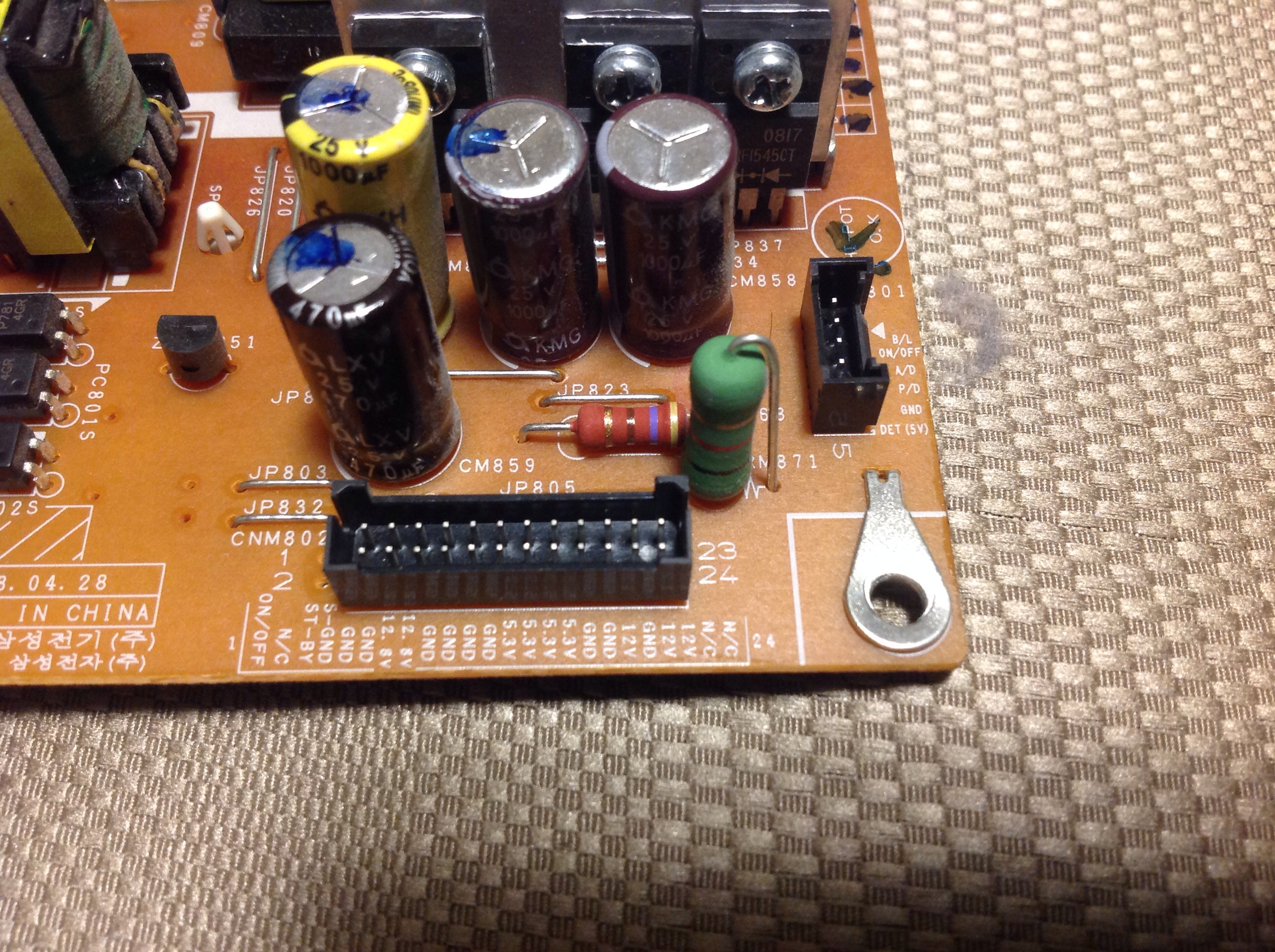

                  The attached picture below indicates which pin is which as far as I can see.

                    Re: New power supply, but tv fails to power on.
                    OK, '1' = over range.
                    And those that show 0.6 are the ground pin,
                    Other pins are not showing low resistance, so it can be active shorts that will not show up until power is apply.

                        Just to be clear (you posted the power board pic) you were testing for shorts on the main board correct? If so the short is beyond a switching component and will only be presented to the power board when it is switched on. You wont be able to measure resistance with the board on, you could put your meter into current mode and check for current draw, standby should draw less than an amp. That makes it very difficult to locate, the only way Ive been able to find one like this is by applying an alternate power source to the shorted circuit and waiting for the component to get hot.
                        If you want to try that you will need a current source preferably 5v limited to no more than 800ma. You will have to pull the affected circuit out of the wiring harness on the power board and add in your current source in a minute or so the bad component should get quite warm.

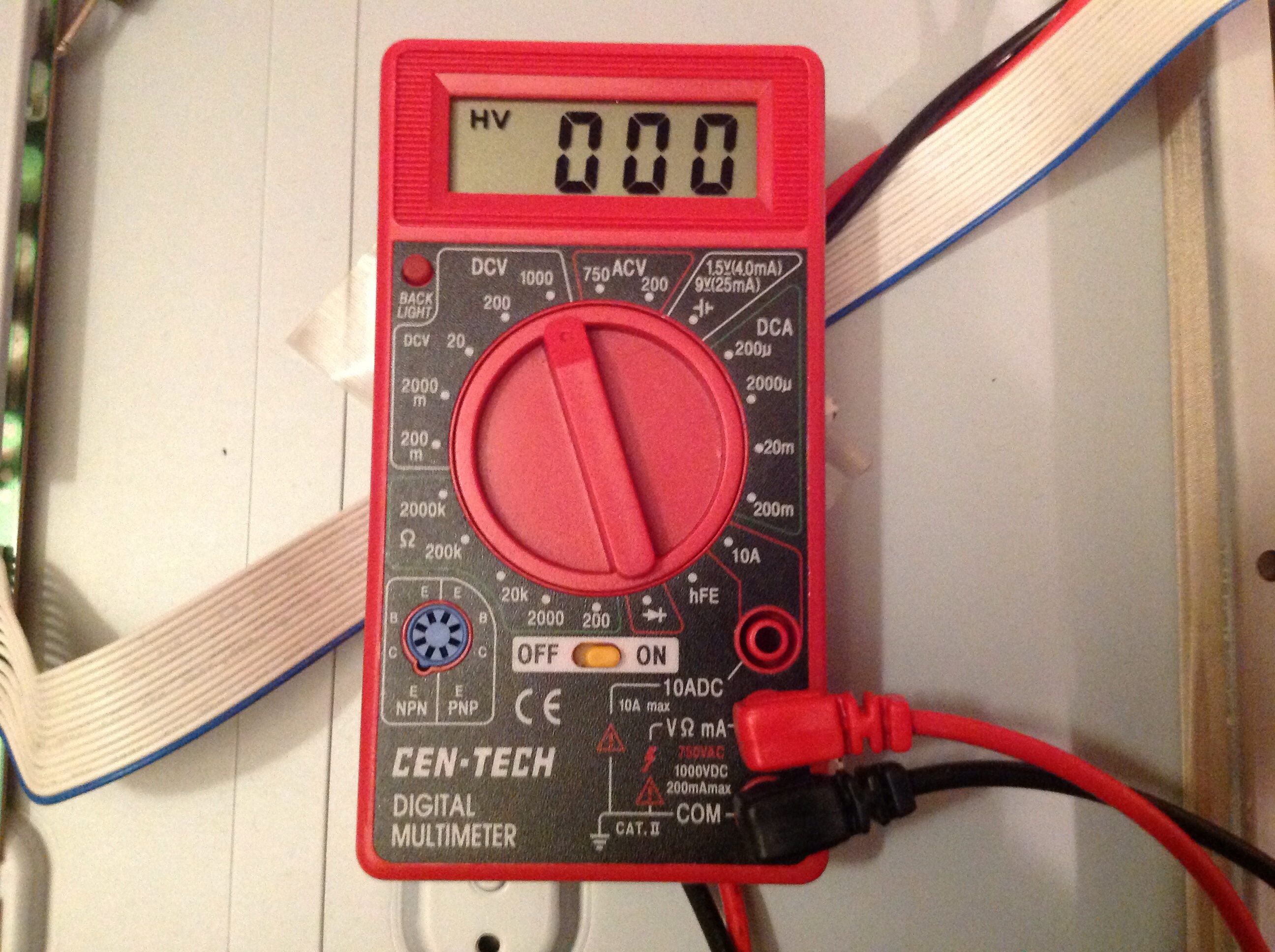

                          Just tested with the main filter cap (CP815) with the main board attached. If I'm reading the multimeter correctly (I had it set to DCV 1000) it read between 245-265. I attached a picture of the setting I had the multi meter on.

                                        Read the owners manual, and followed the instructions for conducting a DC current measurement.
                                        I conducted this test with my multimeter in 10A. I assumed that the 5VSTBY wire is the wire correlated with pin #3, so that's the wire I snipped and tested.
                                        According to my multimeter, the current draw changed with each of those 'tick' sounds.
                                        E.g: it would display 0.38 *tick* 1.59 *tick* 0.51 etc.
                                        As far as I could tell, there was no pattern to the current draw, but it fluctuated between 0.30 and 2.08.

                                          This reading is from just having the boards connected but the power switch not activated? 2A is quite a lot for being in standby mode, it is varying because the STBY power supply voltage is going on and off.
