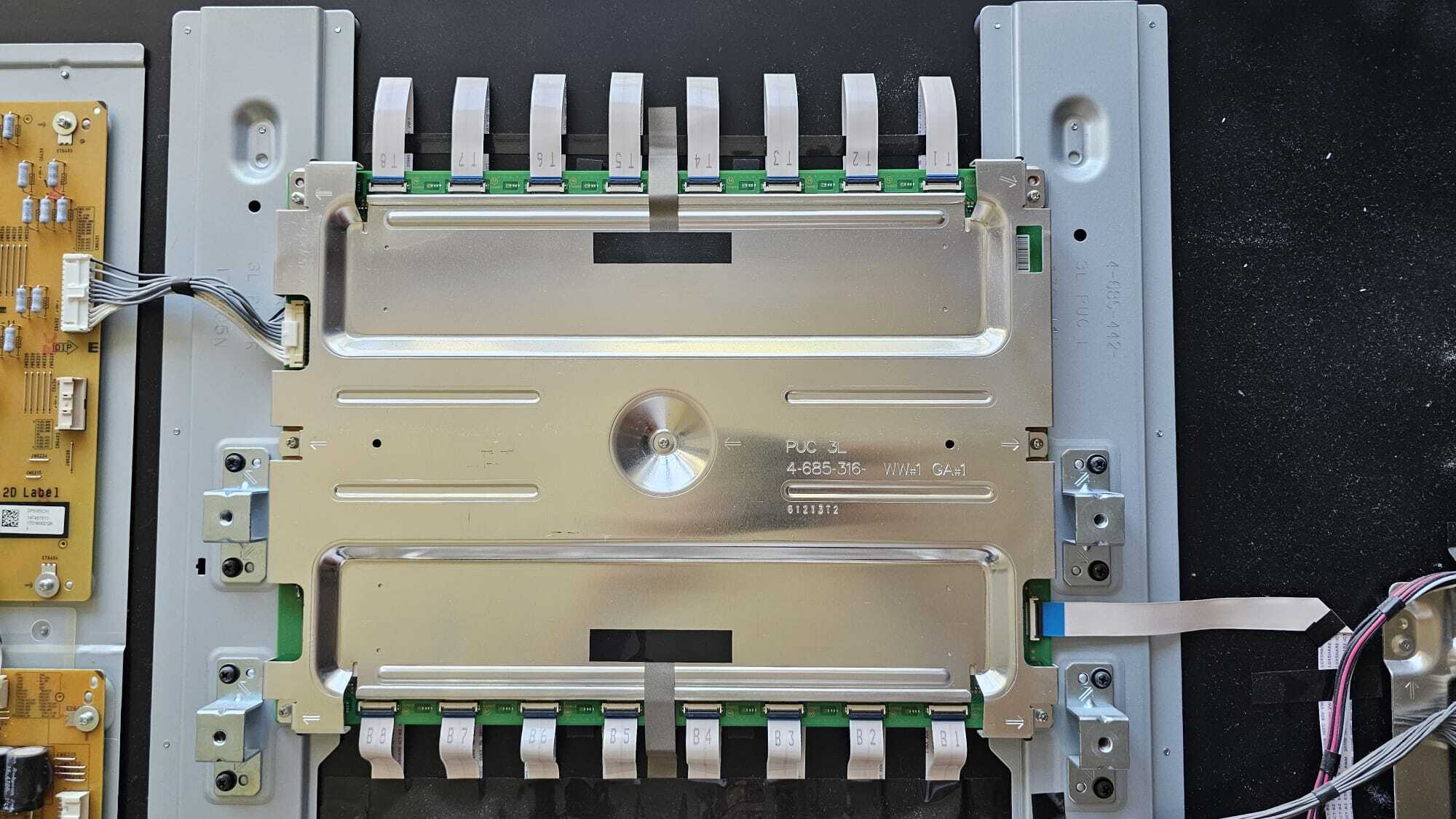

Sony XBR-75X940E intermittent 6 blinks error code

        Originally posted by GoodCapDude
        Hi nomoresonys, thank you for the interest. I was planning to give an update once the story is over but it's still going on!
        So I went to a professional repair shop which is going to test the three boards (forming the power supply) one capacitor and other relevant items at a time (he told me he would desolder them and resolder them). Before that, I tried to ground the BL_ERR and the TV started to blink red four times instead of six times. I was not too sure what to make of that. I hope I did not damage the connector.
        Where and how did you ground BL_ERR?
        Also, I've never seen a bad LD board on Sony...

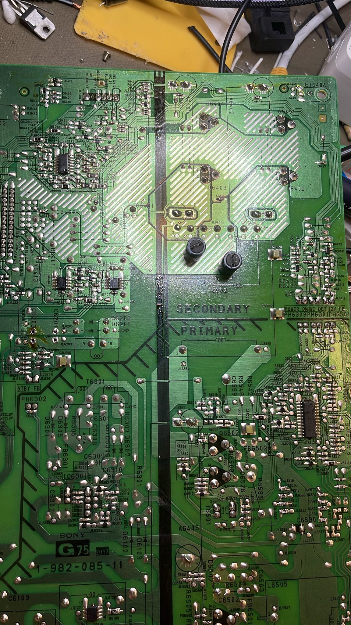

        • Davi.p
          Hobbist Tech
          • Sep 2009
          • 4458
          • Italy - Milan
          OK so no BGA IC, then what could go bad temporarily are maybe those 4 electrolytics, but them are top brand, if i would be in you i would buy a very cheap chinese market multi tester with capacimeter/esr meter, and test them all, or give the board to the shop, the replacement of them is not so easy as the ground planes are big, since the set can fail to start so the problem is at cold, like all the bad electrolytics.. the metal cover could crate too heat, especially if the beast was hooked to the wall..

            • zomi
              • Nov 2011
              • 509
              Theres a couple of bl err lines on this looking at the schematic ?
              https://www.youtube.com/watch?v=31V_s17USnU
              its got like 500 plus leds..

                • GoodCapDude
                  • Sep 2025
                  • 17
                  • France
                  I gave the three boards to a shop that is supposed to test them for 30€. Then they are going to give me a price for a possible repair.
                  The problem is not only "at cold". I mean if it has started, I can keep it working for 30 minutes, turn it off and then on and get the 6 red blinks. Not sure if that counts as "cold".
                  It has been hooked to a wall indeed. Thanks.

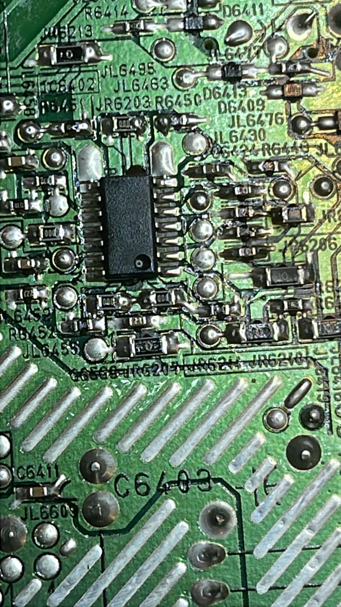

                  • GoodCapDude
                    • Sep 2025
                    • 17
                    • France

                    Yes there are multiple BL_ERR connectors. I Chose the one between the power supply boards and the bkmp board like I saw a guy doing on a youtube.
                    There are 576 leds! It was good for 2017.

                          • Davi.p
                            Hobbist Tech
                            • Sep 2009
                            • 4458
                            • Italy - Milan
                            #33
                            They can test shit without a tv.
                            What do you mean? All three boards can be connected toghether and turned fully on and tested with test loads..
                            OP: have you checked the el.caps. soldering on the led board? It's 30 seconds test..
                            so to repeat one second, TV set turns on with blinking error both when at cold and at warm?
                            It's a suspicious situation for a real electric fault, i would surely try to update the software.. as soon as possible..
                            otherwise the second suspicion is the main processor with some bad soldering.. i hope you would sell or give for free the set
                            and not trash it, it's a sin..

                            • tiki66
                              • Jul 2016
                              • 52
                              • Croatia
                              #34
                              They can't. Where is the backlight? Even one wonky LED could trigger backlight error.
                              • Davi.p
                                Hobbist Tech
                                • Sep 2009
                                • 4458
                                • Italy - Milan
                                #35
                                But no.. i mean, the direct feed for the led is the led driver board, the function of the "brown boards" are only to feed low volts, to the Main-tcon-led board, them are completely testable...
                                • zomi
                                  • Nov 2011
                                  • 509
                                  #36
                                  Maybe best just to strip the lcd and look at the leds if all else fails
                                  Backlight error codes tend to always be backlight issues 99.9 % of the times
