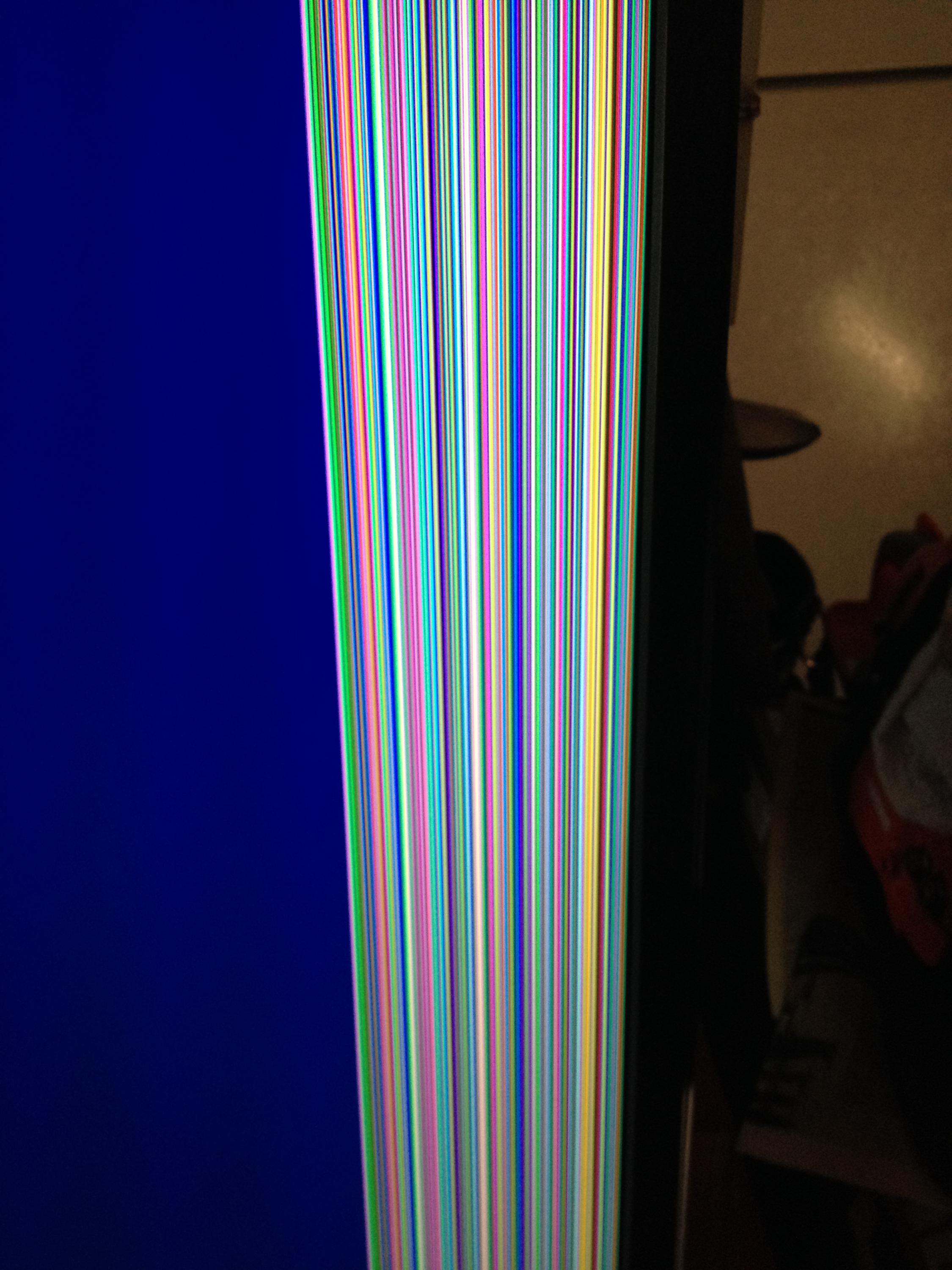

    Mitsubishi lt-40134 vertical lines right side multicolored
    just picked this up and it fires up but has about a 3 or four inch vertical lines that are multicolored and unit will run about 15 minutes and shut down but will start right back up. Haven't dug into it yet, just wondering if anyone has run across the symptoms.

    Re: Mitsubishi lt-40134 vertical lines right side multicolored
    A picture would help,... but to me it sounds like a defective LCD panel... For your sake I hope it's not

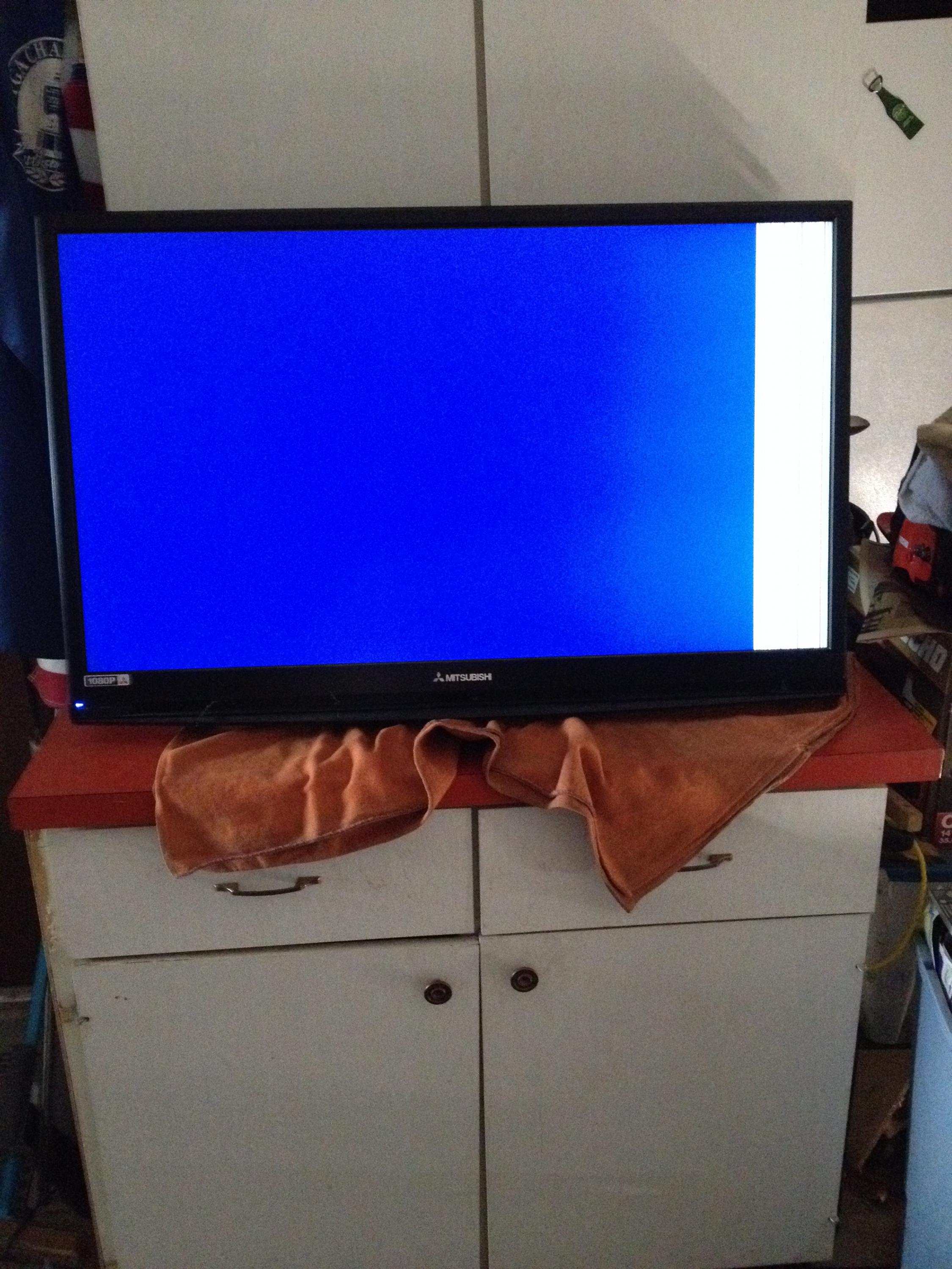

      My mitsu had this issue and it was panel faliure, the IC's in the tab bonds are/were staring to fail.
      No fix for this.
        Here are som pics of panel on.
