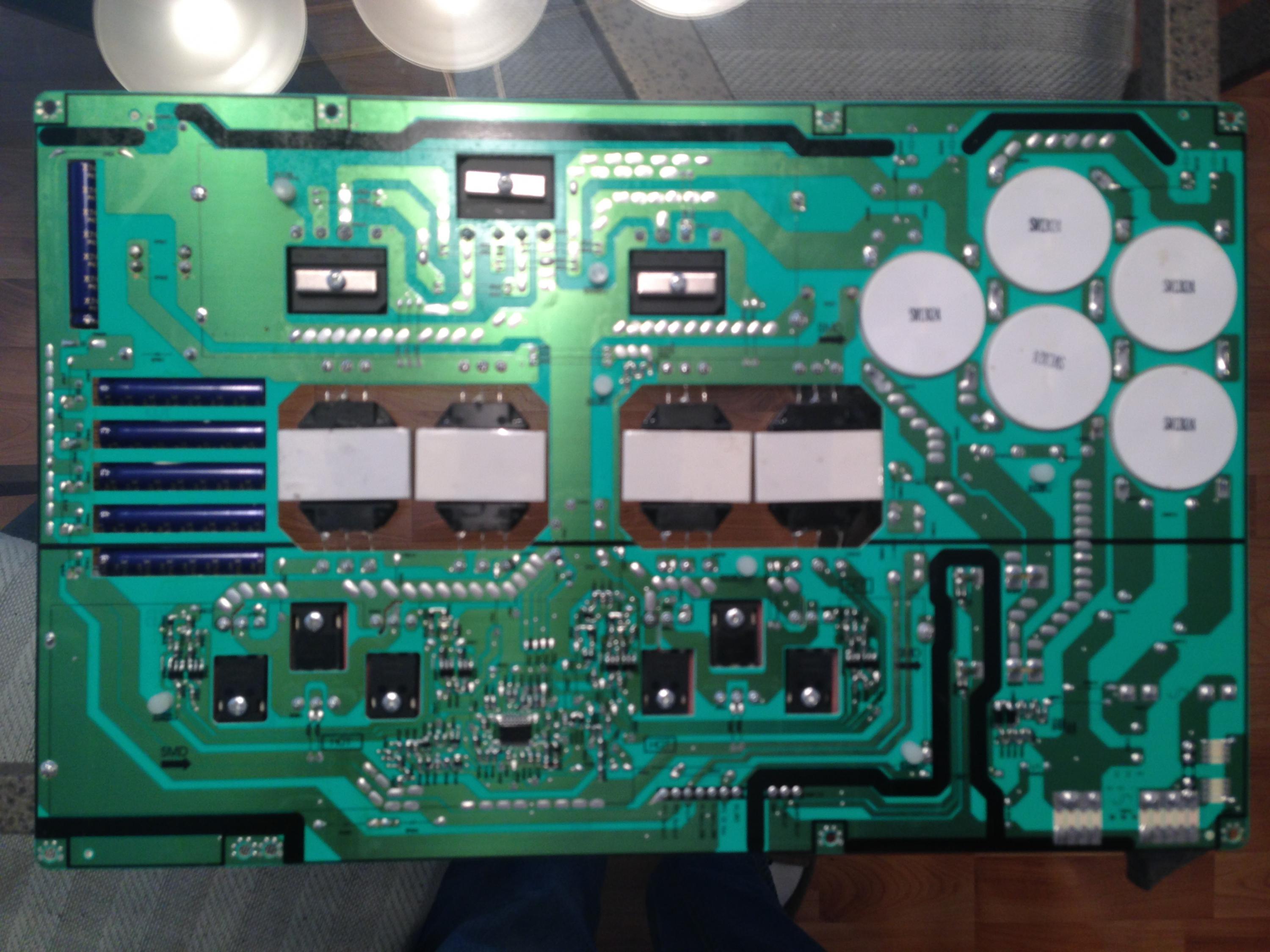

            Vd code bn44-00278a
              Re: Samsung PN58B860 Plasma suddenly shutdown and will not restart
              Hmm, no schematic. Have to do this the hard way. Can you remove the board and get detailed, clear photos of the top (white side) and bottom (green side) of the board. Be careful to allow the capacitors on it to discharge to a safe level (less than 30V DC.)

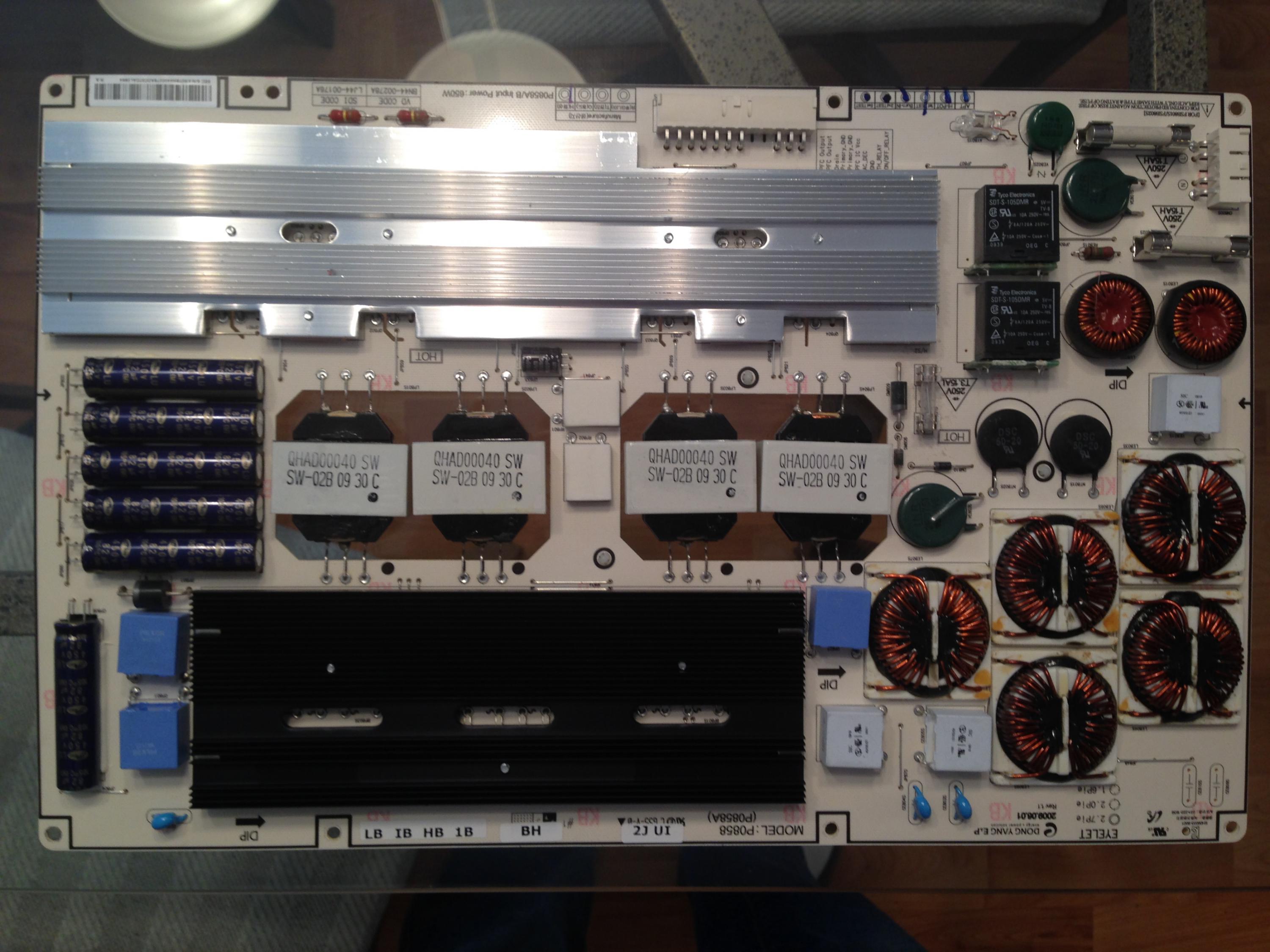

                How's this?
                The back looks a little blurry, guess I'll try that one again
                  Yeah, I'm going to need a clearer photo, any chance you can take a closer up picture, maybe in multiple photos?

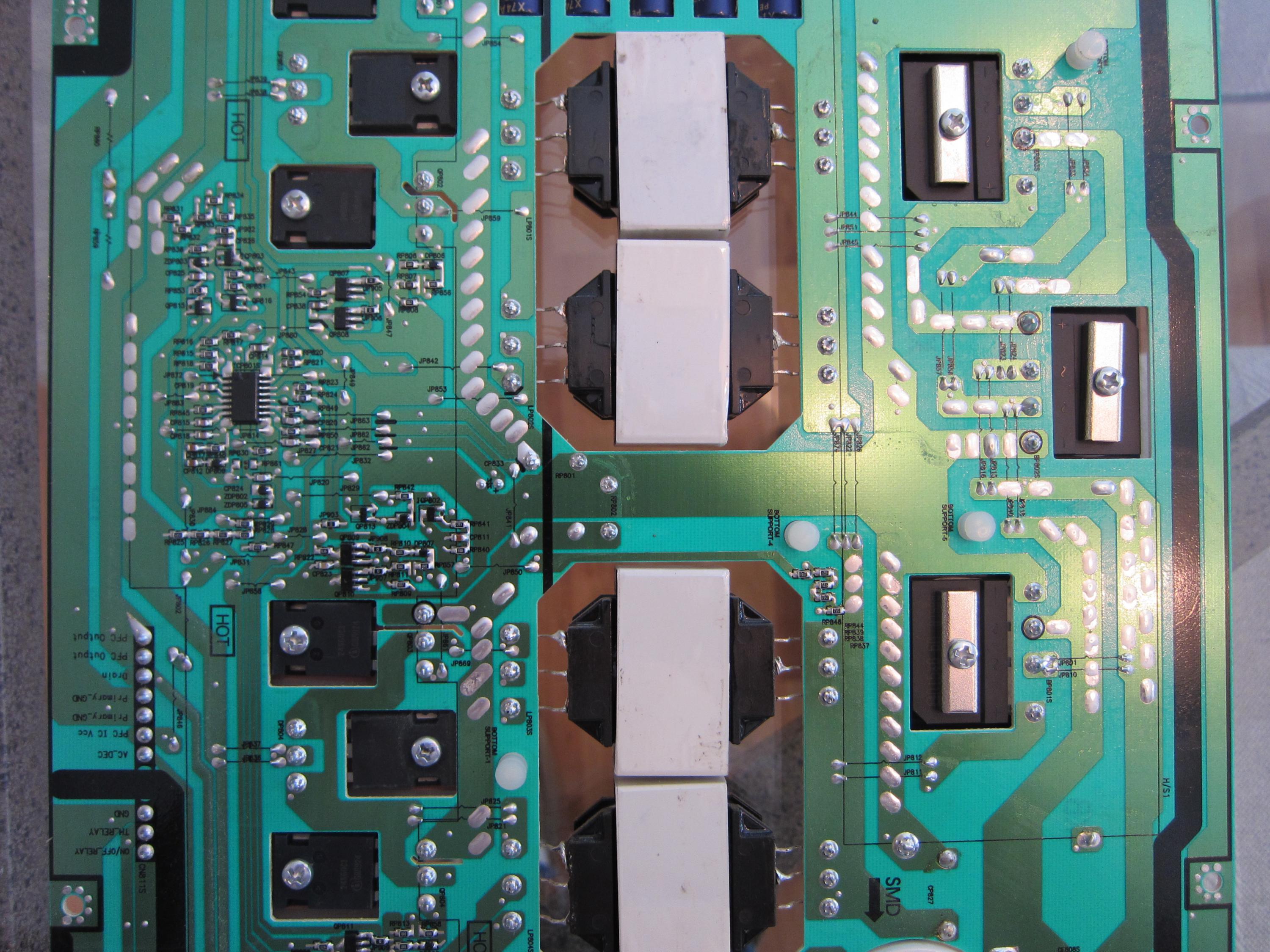

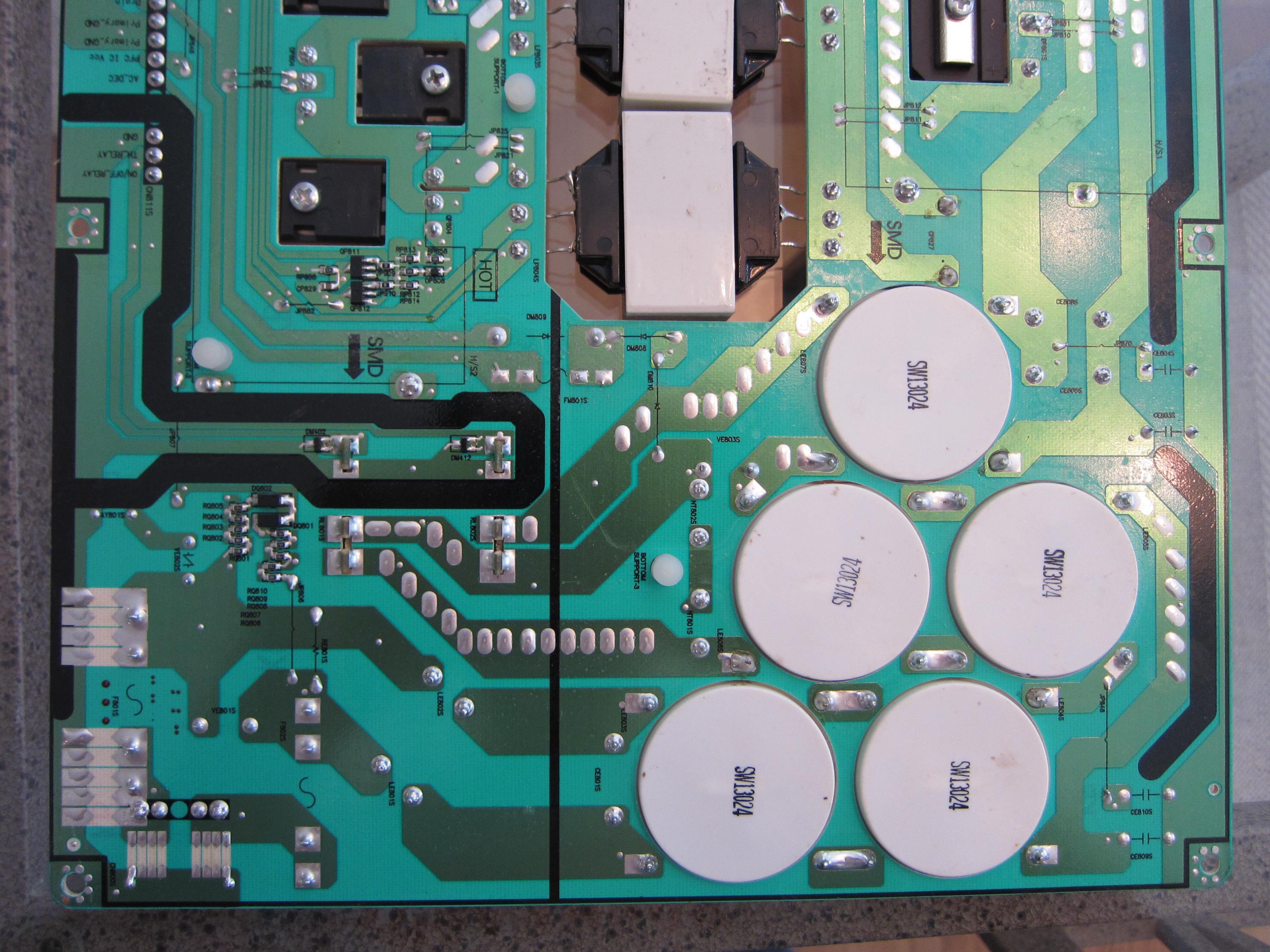

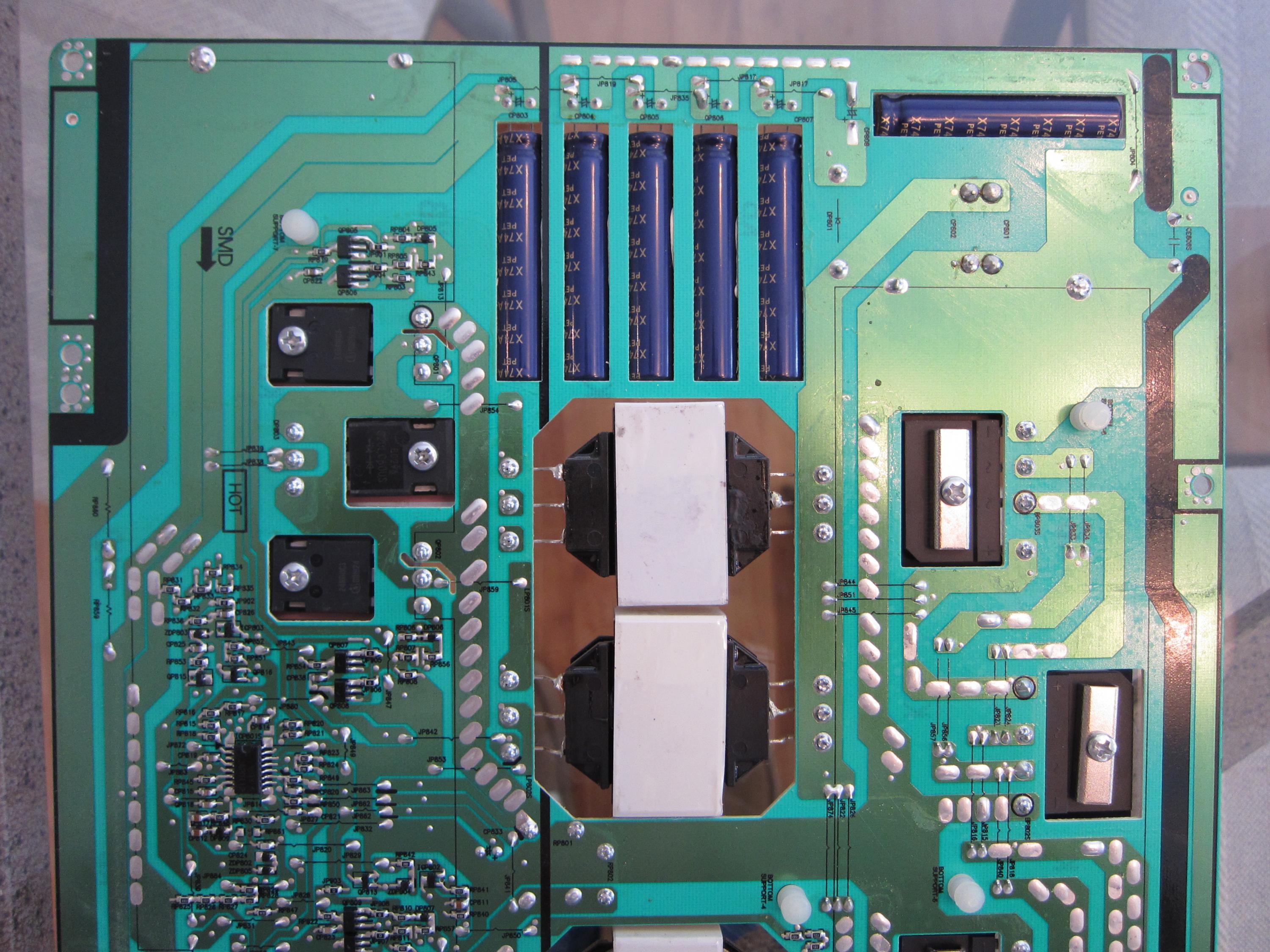

                      Here are three more pics of the back
                        #31
                        No need to purchase a manual, at least for now.
                        What is the part # on ICP801S, the multi-leaded chip?
                              Check DP803, DP804 for shorts across pins 1-3 to 2 (note pins 1 and 3 joined on PCB so will show as shorted)
                              With board installed in TV, check voltage on JP830, positive on JP830, negative on a PRIMARY_GND pin. Should be near 14.5V.
