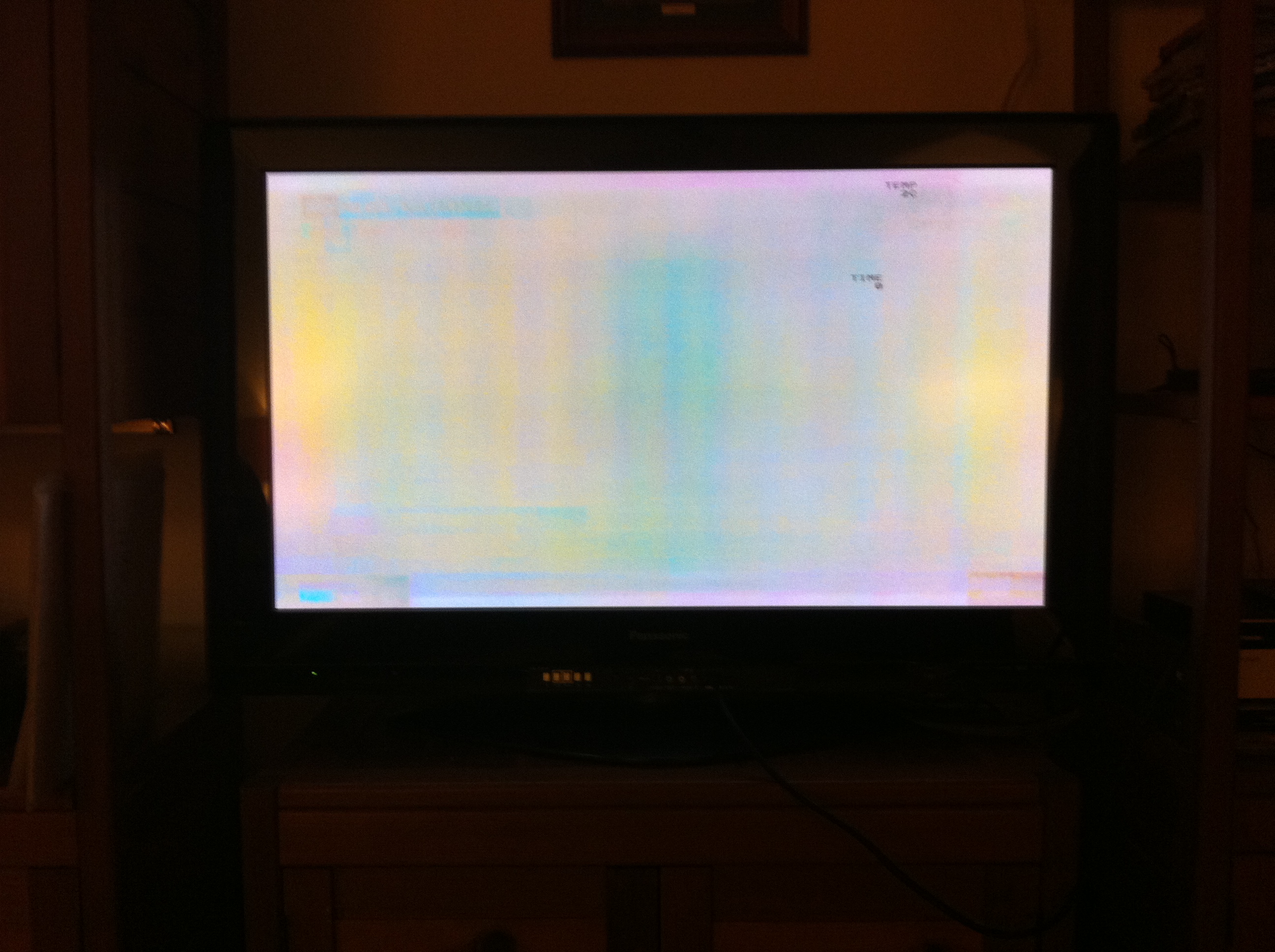

    Hi
    I have a problem with my plasma TV I have yellow and blue shadows appearing when the screen is white (white cloudy sky) I went into the service menu and have a picture of the white test screen all the other test pattens are OK.
    Other than the yellow & blue shadows the picture quality is good and have no blinking lights on the TV, any suggestions would be appreciated.
    Re: Panasonic TH-42PZ700A-yellow shadow
    That looks like either low Ve, -Vad or Vsus voltage. Can you post some pictures of the boards in the set?
      Hi Tom
      I haven't taken the back off the TV, can the voltage be adjusted through the service menu or do you have to do it at the board?. I have downloaded the service manual for the TV and there is a section on adjusting the voltages but I'm not sure how to do this its not clear if this can be done through the service menu or not.
      cheers
        Unfortunately you'll have to do it by opening the case up. It can't be done via the service menu on these sets

          I did reset the TV through the service menu this seemed to reduce the yellow color on white background when watching the TV. I'm not sure with my experience that I could do the adjustment so i guess I will see if it gets worse then get a price on having someone to take a look at the TV its 7 years old and as Panasonic no longer make Plasma TV's I can get the new Panasonic 50 inch led TV for about $1100 so if the cost is to much to repair this TV I will probably just upgrade . Thanks for your help Tom I really appreciate you taking the time.
            Tom,what would cause the voltage to change on the power board? would it be better to install a new power board and would this new board need to be set up for the TV or just installed with no adjustments needed?
            cheers
                Every plasma panel is slightly different, so the Vs is adjusted to match as appropriate.
                If you replace your power board, you will have to adjust Vs.
                I would not immediately suspect the power board to be at fault. You need to check the voltages first.
                If you do decide to upgrade, please give/sell this TV to someone who can fix it or live with the fault.

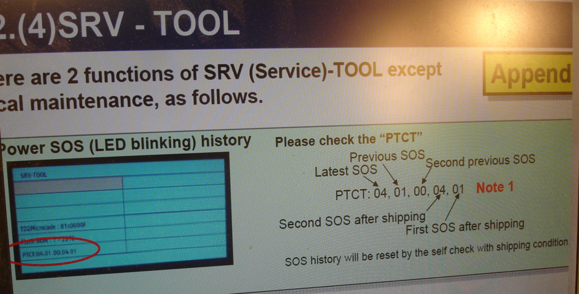

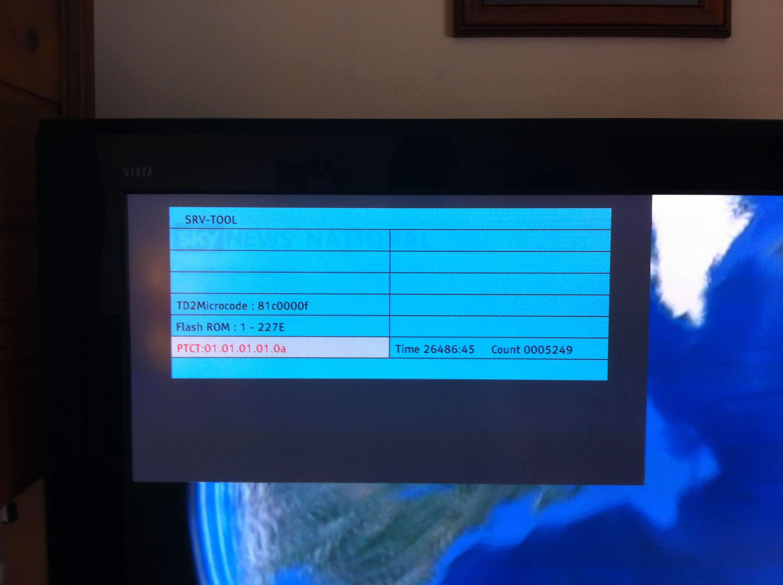

                                Anyone know what the SOS codes mean?
                                  Those are no SOS codes.
                                  Your TV has 26,000 hours. Wow, that is pretty high. Looks like it has burn in, though :/
                                    Yeh thanks to Foxtel they have logos on every program. What do those pic numbers indicate? last time I checked they were PICT:00.00.00.00.00 I thought I read that these are fault codes but could be wrong
                                      I think it's a software version. SOS info is elsewhere.
                                      Dubious award -- this is only the second Panasonic plasma I've seen with burn in.
