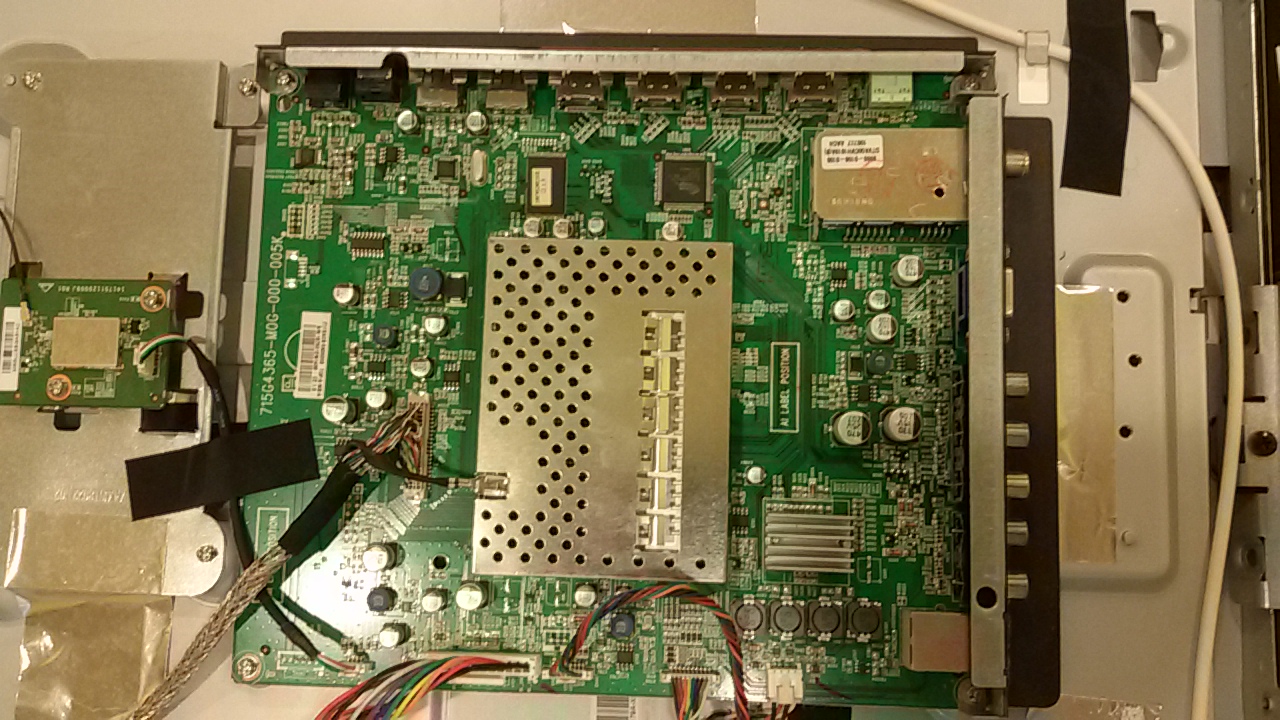

    The TV started flickering (or flashing) while it was on and being used (as reported by my son - I wasn't around). The TV was turned off. But couldn't be turned on using the remote.
    When plugged in, the indicator LED remains dim, like in stand by mode. None of the buttons on the TV or remote have any effect. There is no 'V' logo, no picture, no sound and no back light. I have tried power recycle as per Vizio tech support - no help. They said they can fix it for $180 - but I want to avoid that route.
    What could be wrong? Is it power supply board - I hope because I already ordered a replacement at good price.
    Re: Vizio E422VA - no picture, logo or backlight

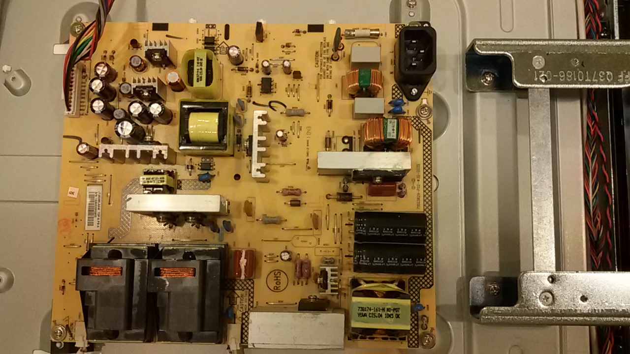

    I checked the voltages at a cable connector on power board which seems like the output going to the main board. I checked the 5 volts pins against the ground - they show 5.11 volts. However the 12V and the 24v pins don't show any.
    Is it that the main board is responsible for "turning on" the power board using those 5v terminals? If that is so, does it mean that the main board fails to "kick start" the power board? I am not an expert, but it seems that if that is indeed the case, I need to focus on the main board. But I only see SMDs and other components that look like capacitors every where on the main board - is there something I can do there to fix this TV?
    Also, there are no bulging capacitors on any of these boards - no smell of burn out or anything. Also, when left plugged in, none of the heat sinks on power board are hot.
    I will really appreciate any guidance here!

      Take the DC voltage and report the readings for each pin of CN902, make sure to list the name of each pin. Take the readings when TV is plugged in but not turned ON, and when the power switch is activated.

        Here are the DC voltages of CN902.
        There were no differences in the readings of CN902 at plug-in (not turned on) and power switch on (by pressing the power button on the TV)
        ON/OFF 0.0 Pin 1
        PDM 0.0
        +12v 2.9mV
        +12v 2.9mV
        GND
        GND
        GND
        24v 4.1mV
        24v 4.1mV
        PSON 0.0
        5v 5.11v
        5v 5.11v
        ACD Voltage was increasing when the multi-meter terminal applied to it starting
        from 0 to 280mV going onwards...
        I used the GND of the CN902 as ground.

            The main board is not sending the PSON to turn on the power supply, so the main board is not working correctly.
              Thanks, budm. Is there any specific that I can look into on the main board?
                According to shopjimmy, there is WIFI card in this TV.
                I would disconnect the cable to the WIFI card and see if you can turn the TV ON, if not then try disconnecting the cable to the T-CON board and see.

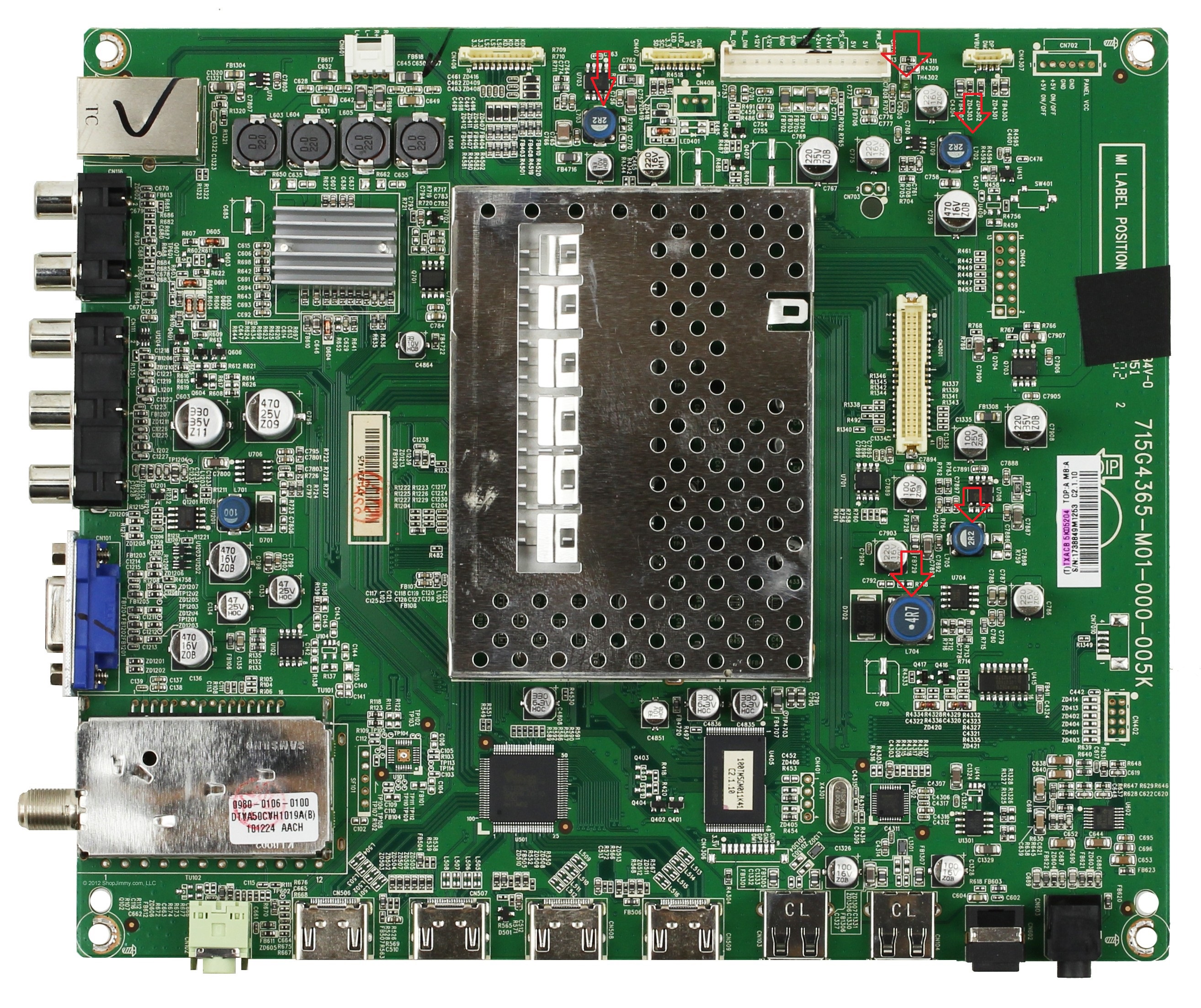

                  There is a fuse on the main board you can check.
                  the blue inductor you can measure the voltage on those, they should range from 1.7vdc to 5vdc.

                    I tried both in that order. No joy.
                      this is a smart TV right?
                      Yes, this is a smart TV. I measured the voltages across the inductors - no voltage there - it is in mV.
                      Also, the fuse continuity is ok - is it the one that you indicated on the board with a red arrow next to the connector?
                        Those inductors are for switching power supplies. So some of them are not working if you are getting any voltage or it can be that some of them runs off the 12V but since the power supply is not turned on to provide the 12V for them to run.

                          Yes, that's what I think too - the 12v supply is missing. I heard back from ShopJimmy guys - they say that the main board is faulty and needs replacement.
