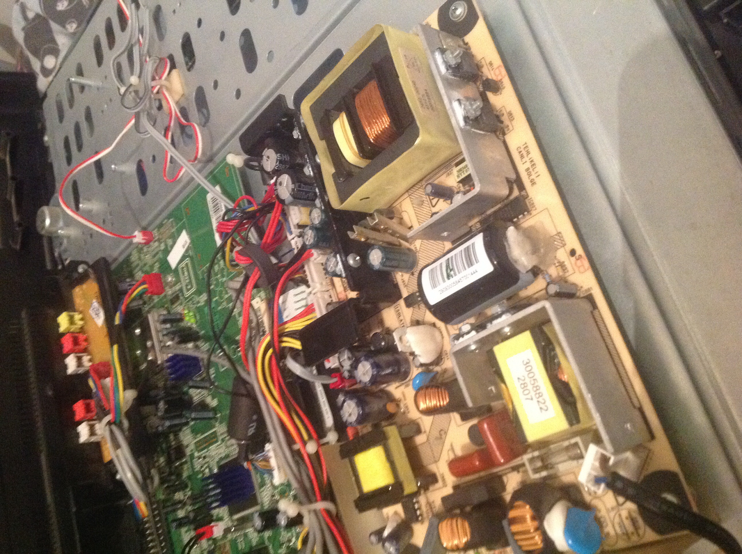

                Got another problem now the tv will shut off during use, found that the 24v line is failing when it dies it causes the inverter to shut off and the speakers to crackle and the set remains in stby, tracked it back to the voltage reaching the rectifyer is too low and drops. Im just going to replace the psu, cant be bothered to track down the problem as I will be replacing the set at the end of the year.
                  Re: Technika 32" Failing to start with remote !
                  If you do want to fix the issue it's probably the little 15n capacitors near the transformer on the PSU, common fault on this model.

                      Just an update I have decided to replace the set with a 40inch lg or sony as I suspect the tcon is now at fault as the set went blank backlights turn on but nothing is displayed so im scrapping it for parts as im putting more money into it even though I was going to replace it at the end of the year got 7 years out of it so im not complaining, thank you all for your efforts.
                      Image 1 showing a new main board and psu installed.
