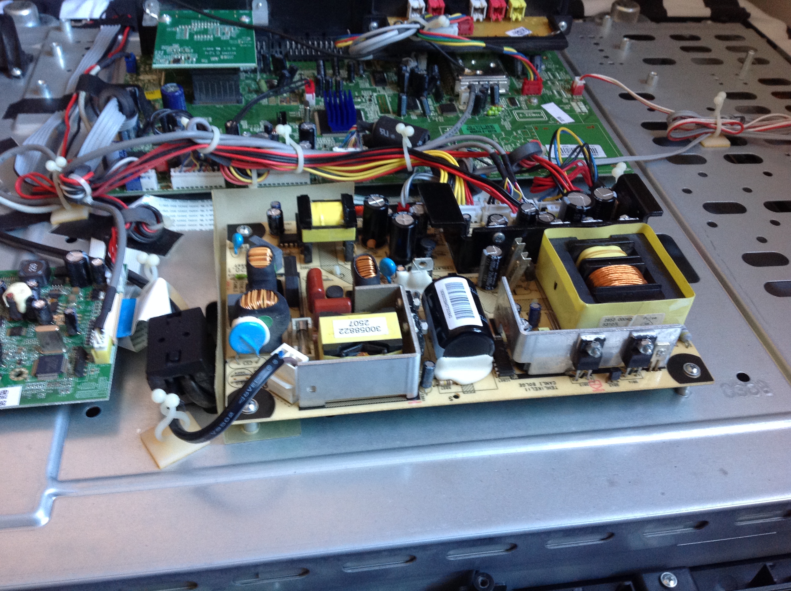

    Hello I have a 32" technika tv that has been running almost everyday since 25/12/07 it is a vestel manufactured tv and has a vestel 17pw20.1 psu (known to be junk) I replaced the capacitors on the psu around 2 years ago with rubycons. Anyway recently I have been experiencing a problem where the tv wont start at all with the remote (original remote) the power light flashes repeatedly and wont fire up but the tv will start with the side buttons and will run for a while but at random the tv will cut off and flash the power led just like it does with the remote issue. For some reason when powering on with the remote the voltage in the main capacitor completely goes but again with the side buttons the voltage in the main capacitor remains perfect and will fire on the set I haven't tested any of the components in the psu as it may not be a psu issue, if any one has any ideas please reply as this is driving me insane and I cant find anything on the internet, thank you.

        Hello Tom66 thank you for the fast reply here are some photos, they arnt the best seen as I took them after I recapped the psu years ago and its too late to open the tv up now but I can get some better ones tomorrow if you cant tell from these photos if that the same/simmilar main board ?

          Hard to tell from the photos, but it looks like a different main board unfortunately. Can still try a few things though.
          Turn the TV on, switch to any SCART input. On the remote, press Menu then 4 7 2 5. It may take some attempts. The service menu should appear. Select the factory reset option and execute it. (The TV should turn off a few seconds later.)

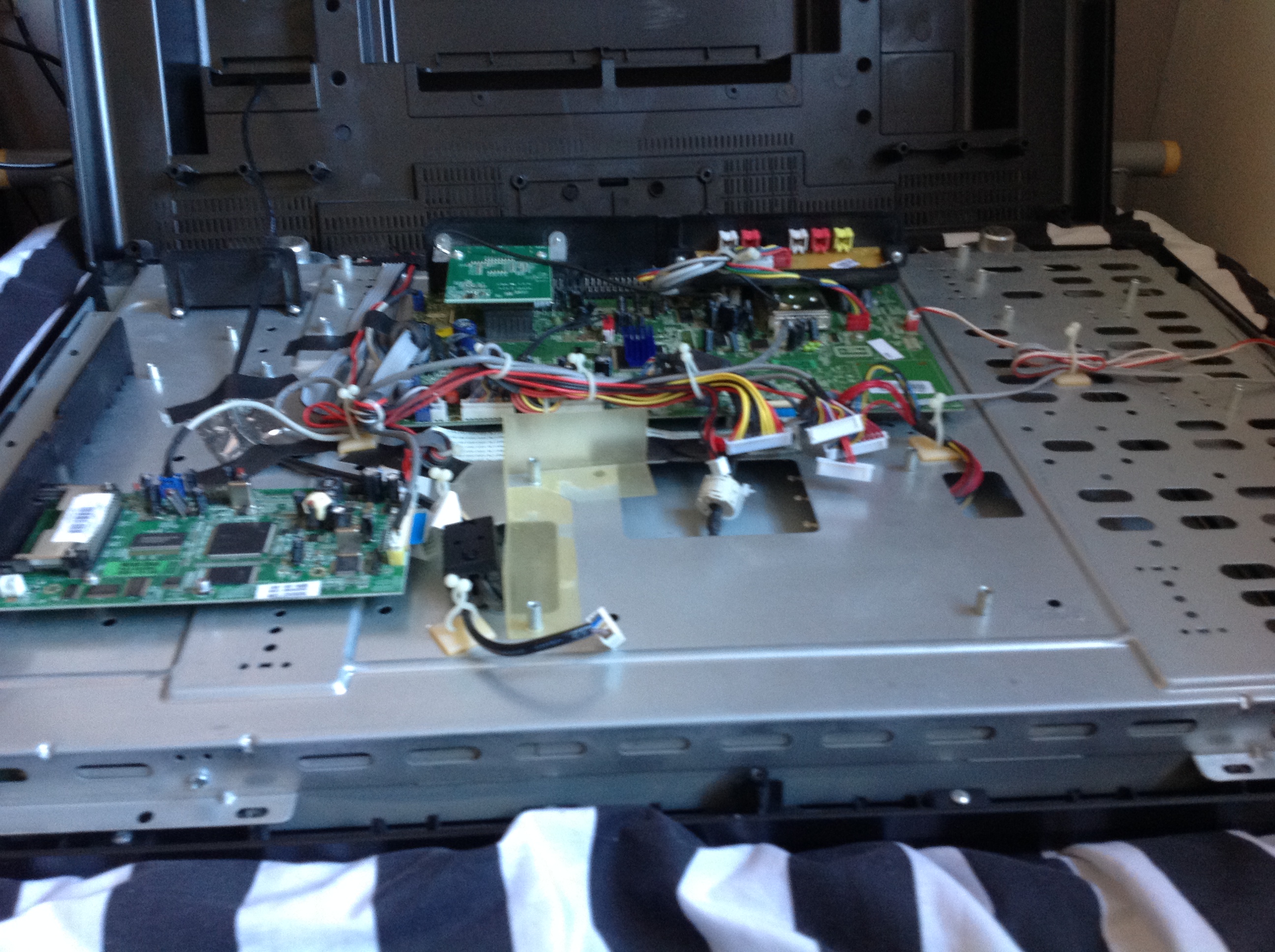

                          It's more likely that when the set crashes, it forgets to turn off the video output. The software for these is barely functional with many bugs and glitches, the digital tuner being the worst. I had one Vestel where if you entered the 7-day TV guide, the TV would shut off with the blinking light, but it left the backlight on, so you could slowly see the image fade away (as the T-con power was turned off.) I've had them crash when feeding them 1080p at 24Hz cinema framerate instead of 60Hz. etc. Bad software design and insufficient testing before release.

                              Ok here is a picture of the board and other parts, I think the mother board is a 17mb22-2
                              When I multimeter the 24v going to the inverter it reads fine so Im kind of pushing the psu out of the picture.
