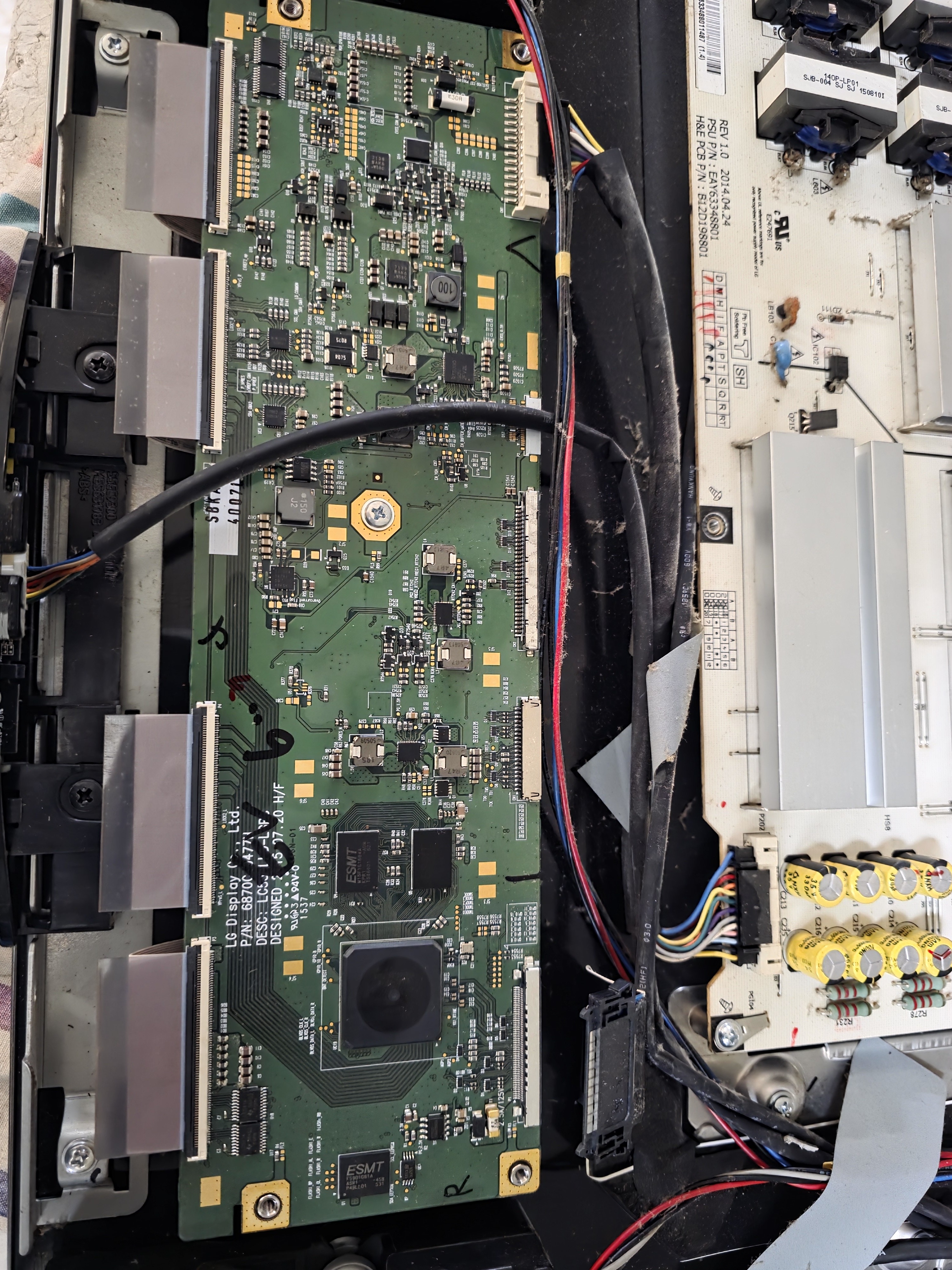

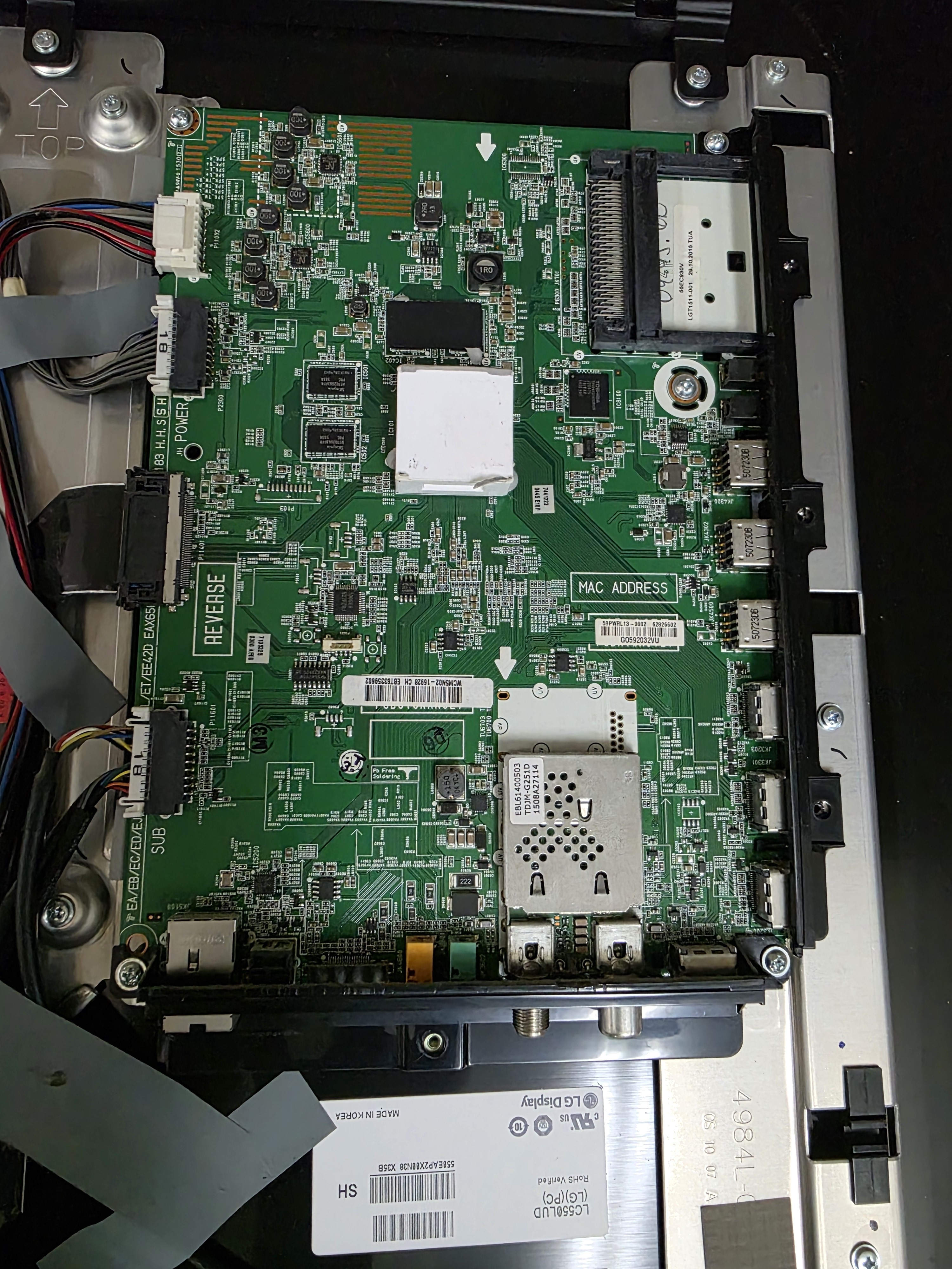

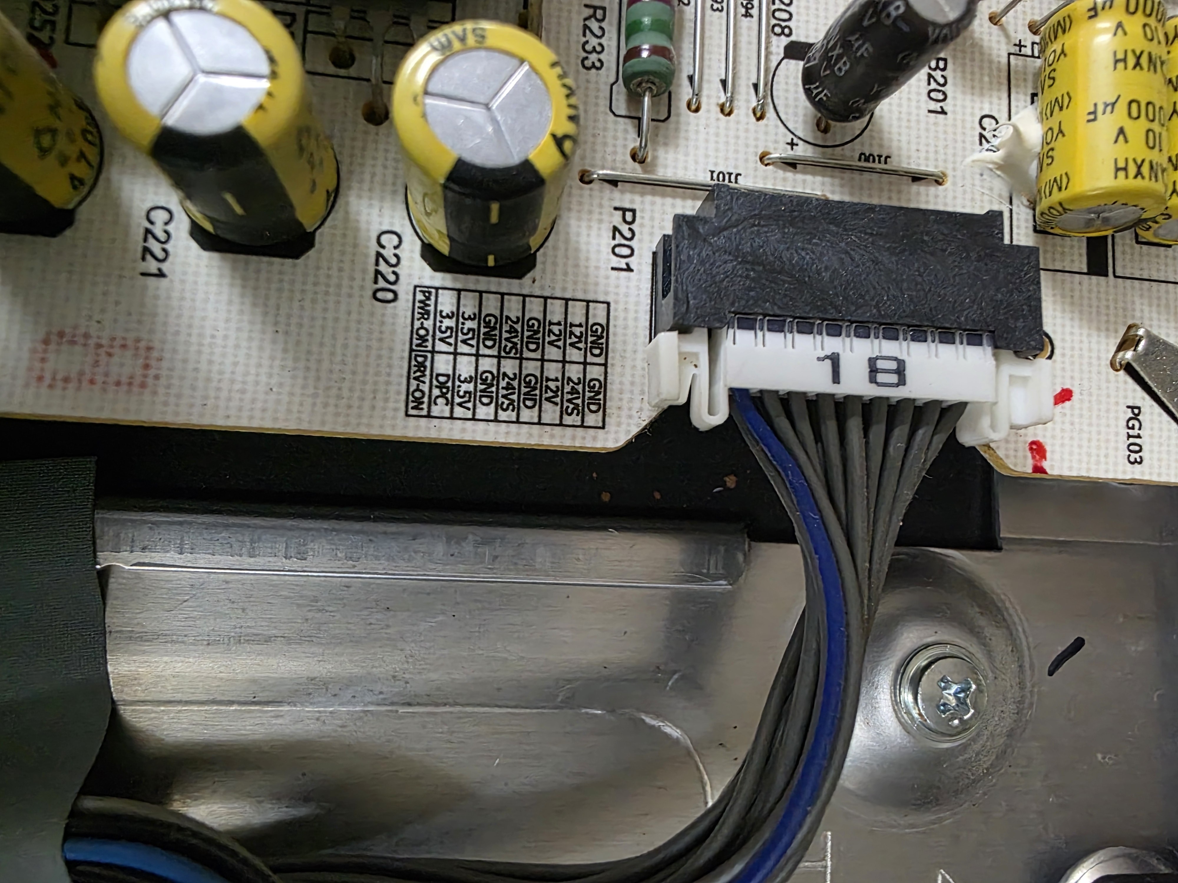

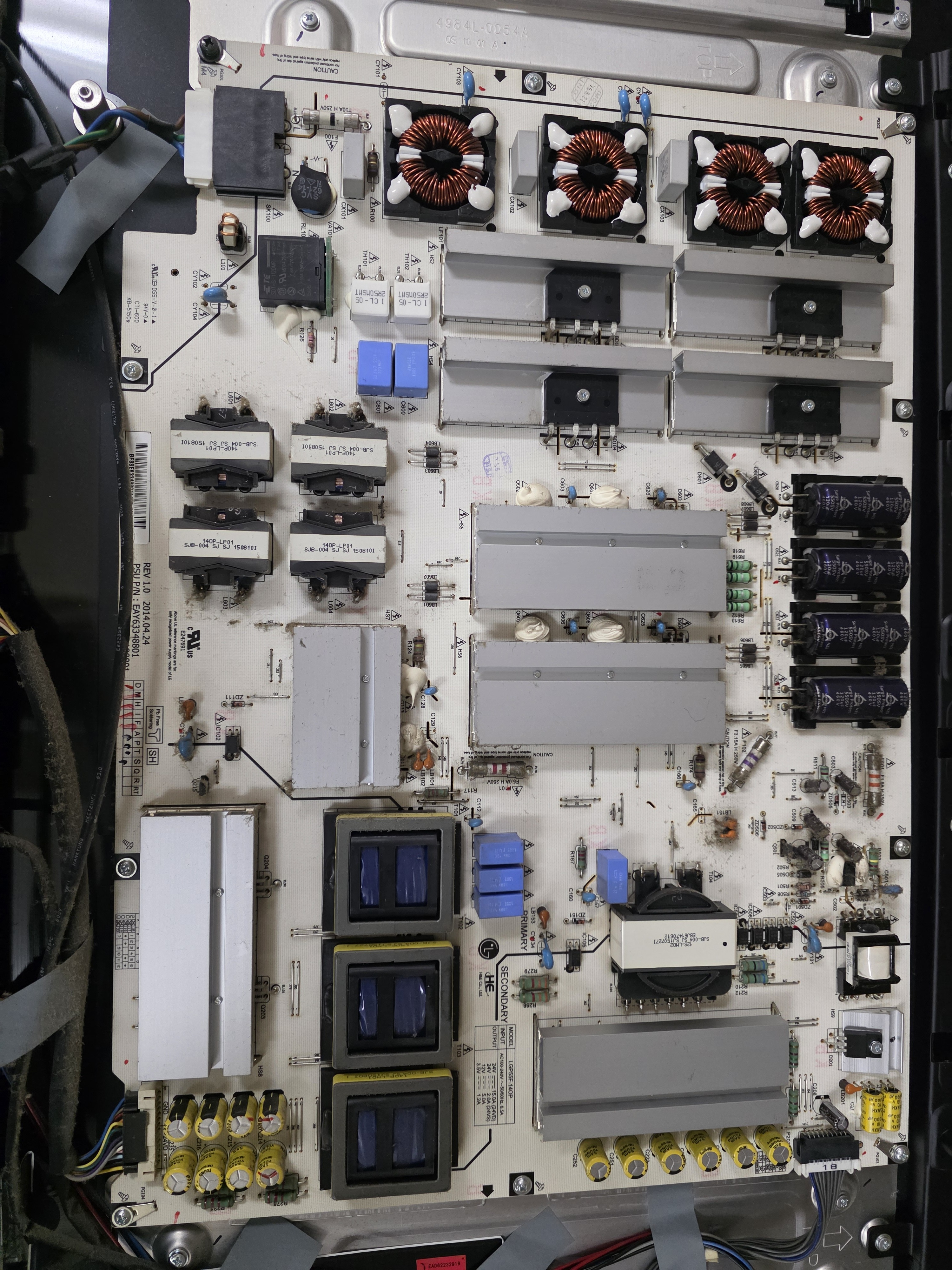

    I have this OLED in standby. With remote or local button it tries to start, relay clicks but switches off again immediately. I have noticed 24V dc out missing . But this was due to a missing signal from the mainboard at DRV-ON signal. If I apply 3.5 volts 24v is on but same result. Have disconnected TCON cables one by one but still same issue.
    Is there any mainboard reset procedure or testing please as am new to this model.
    Tks!

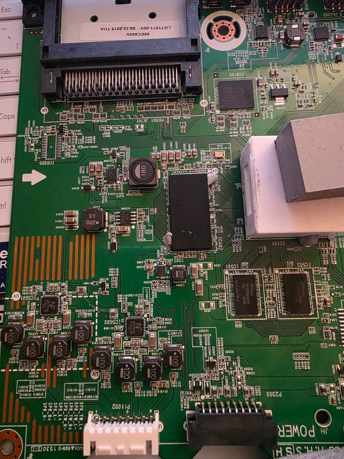

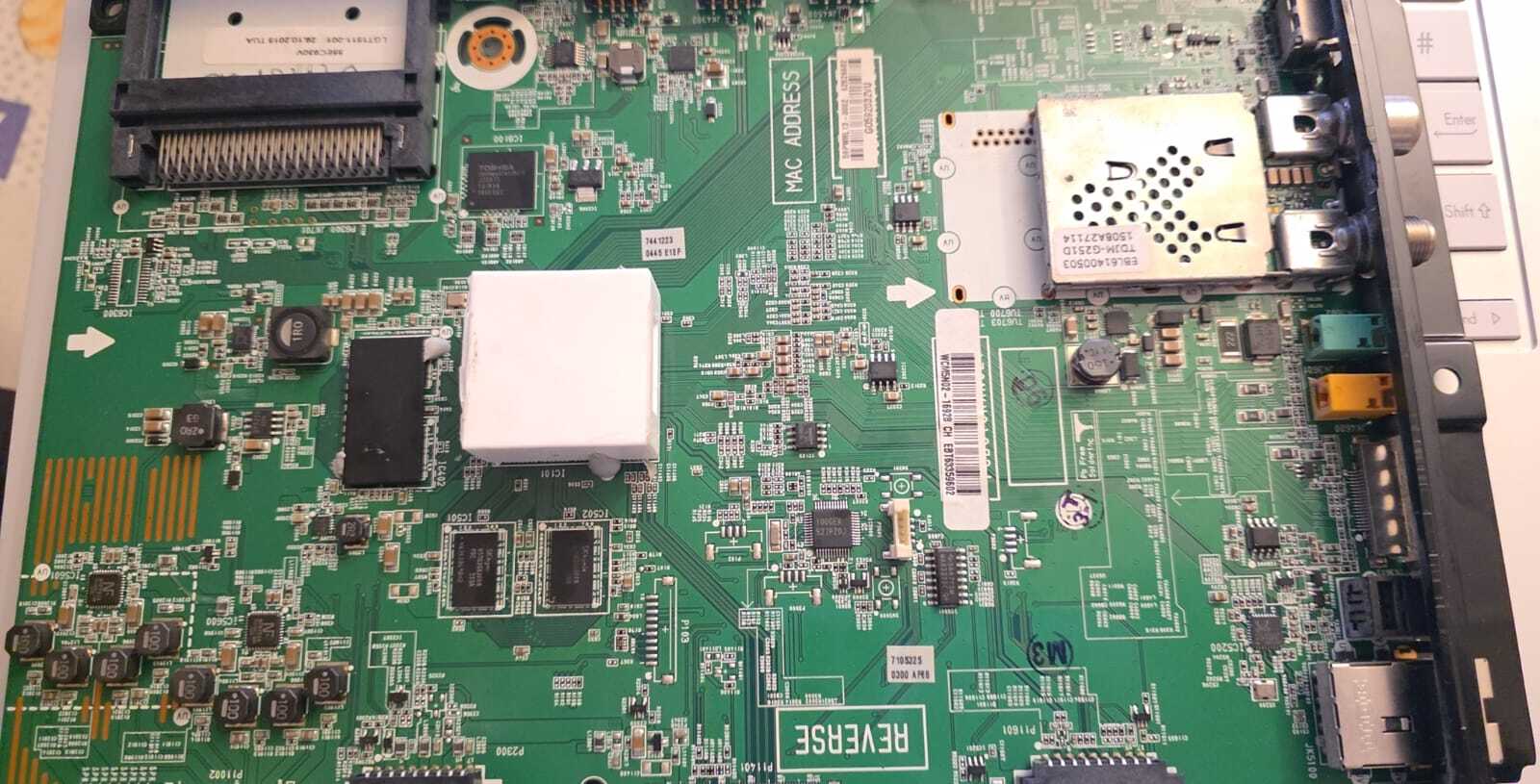

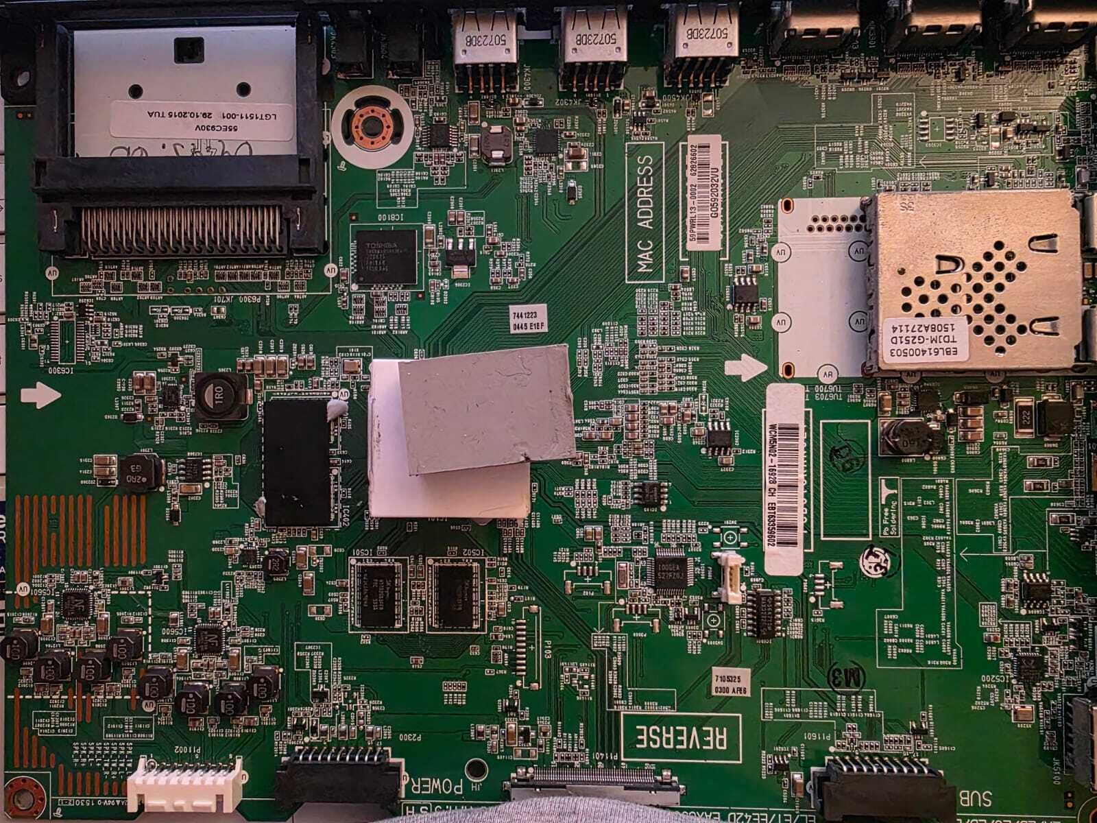

    On main board picture, top of the processor there is a small sot23-6 ic, how it is marked? Is it a reset ic?

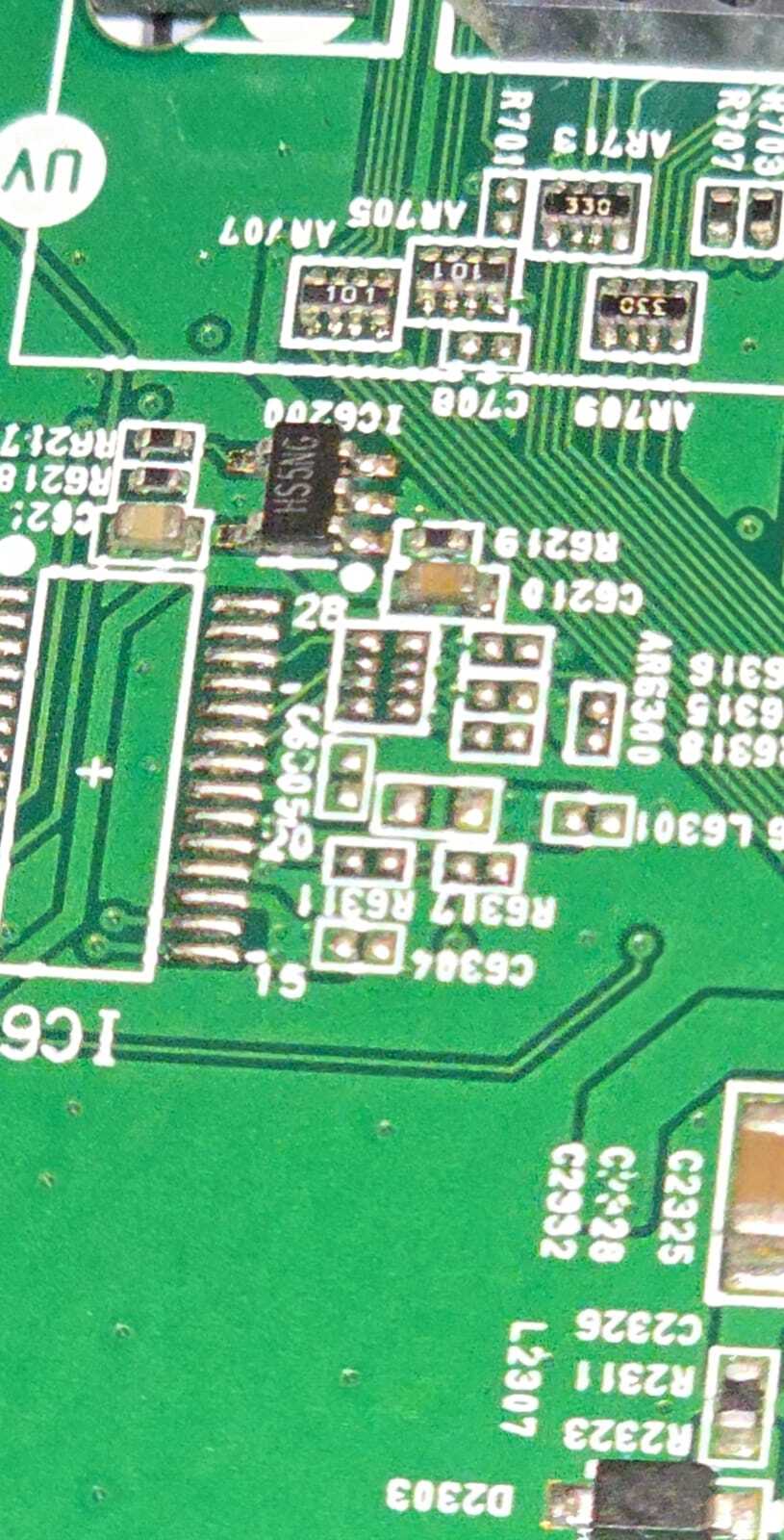

      I have uploaded some closeups. The only Sot23-6 IC is marked as HS5NG ic6200. In other posts there are mentions of micro switches on the main board for this model but I cannot find in mine.
      There is a very informative thread here https://www.badcaps.net/forum/troubl...wer-no-display
      Should try the In-Stop trick next.
      Any suggestions more than welcome!

        No, it was only a misview, them was only white markings, anyway my doubt was on the standby microprocessor, i wonder why the board picture is 3000x4000 but so very low detail, i cannot name the ic position.. if it is sold already programmed, i would do a try..

                    With the P-ON from remote the screen is lit for a few seconds but a vertical line only is visible. It will eventually go to standby again after around 3 seconds. I have removed Ribbons to screen 1 by 1 maybe I can get the LG logo somehow but didn't manage. Then I put back all connectors and removed the TCON signal cable and P_ON again and the same line was shown. I have checked the TCON for some burns or open fuses but all seemed good.
                    I am inclined to reason a defective panel but has seen wonders in this forum so fingers crossed there are some other procedures I can perform.
