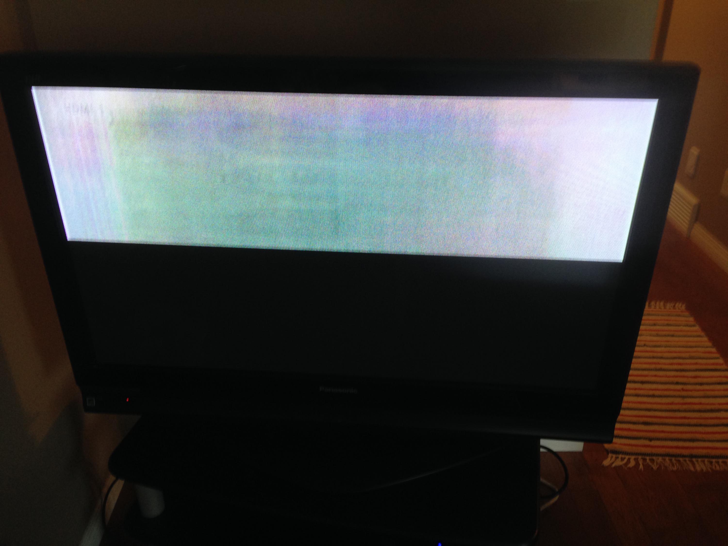

    I have a panasonic vierra 42" plasma tv that has the top half of the screen greyed out. Any ideas?
    Re: Top part of screen greyed out
    Can you supply a picture of the fault? It is hard to tell what you mean by "greyed out"...

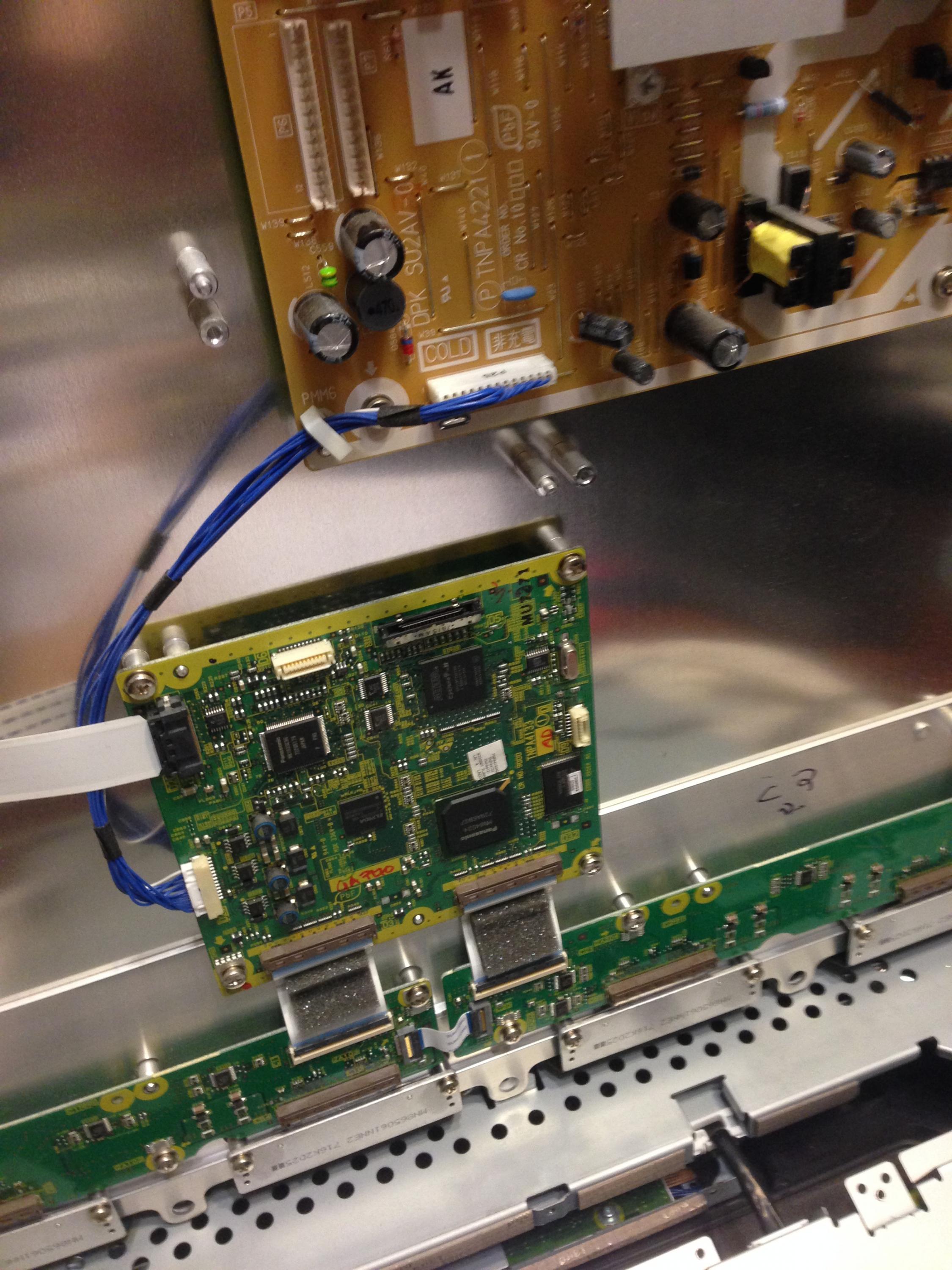

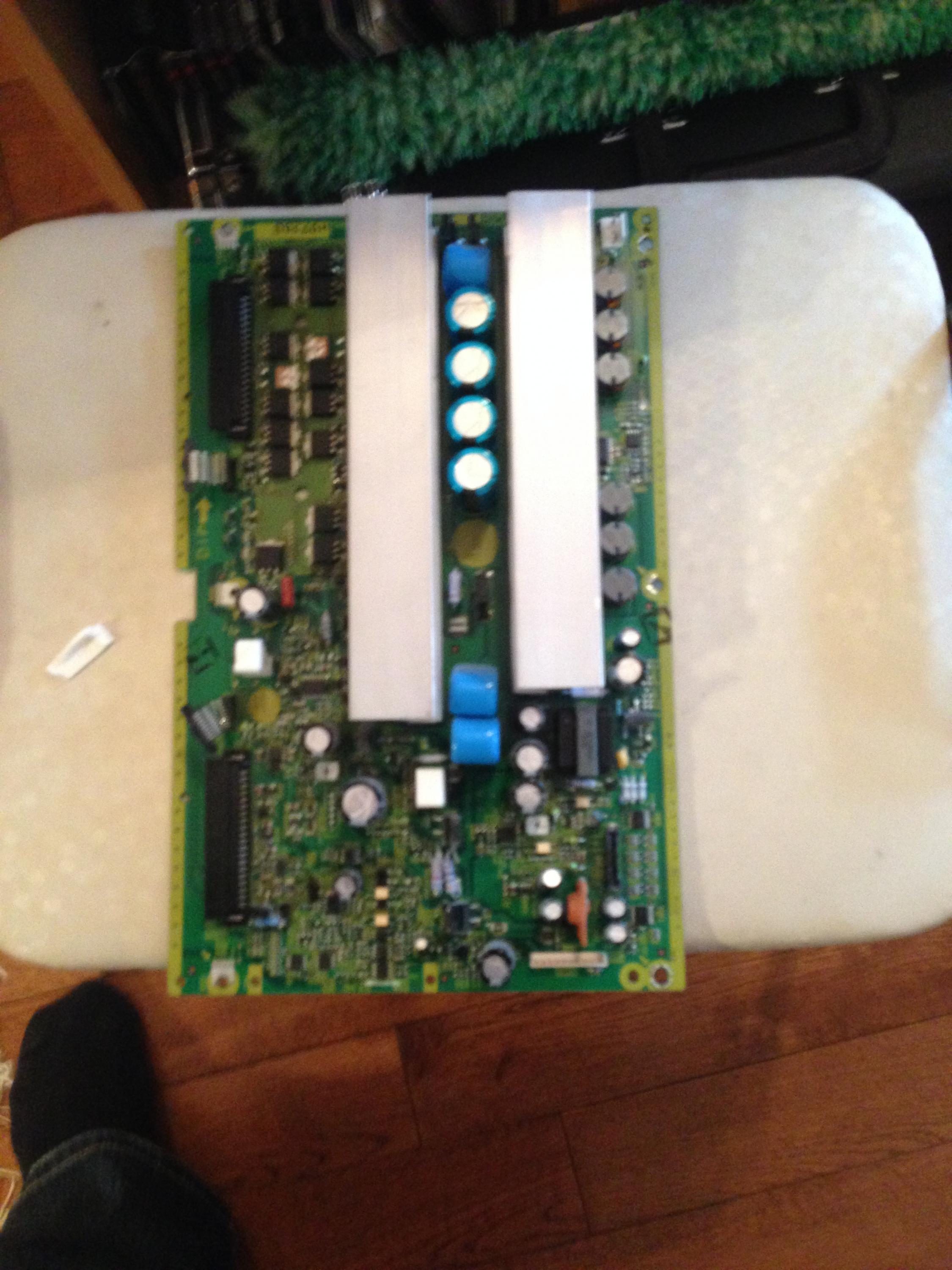

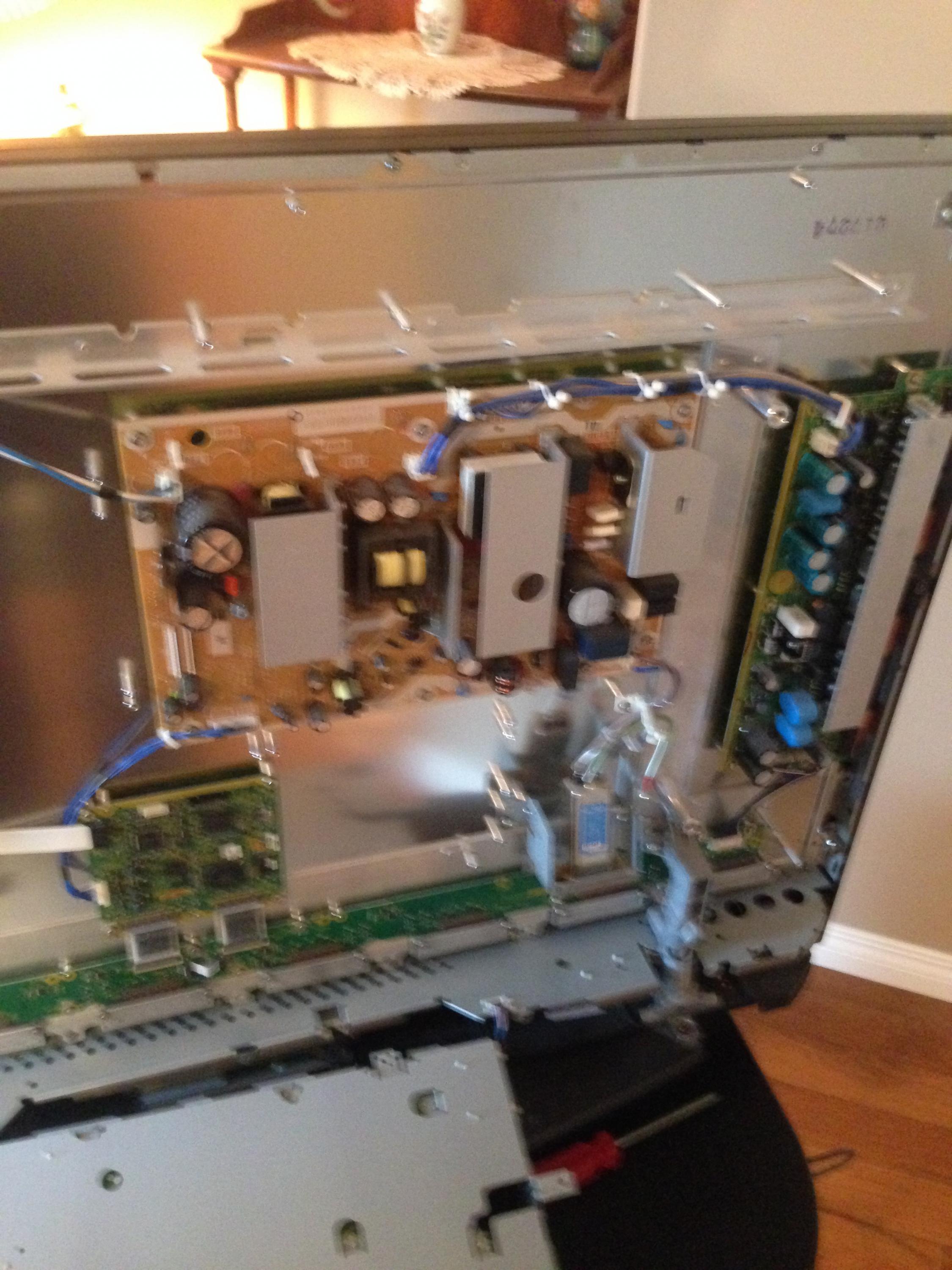

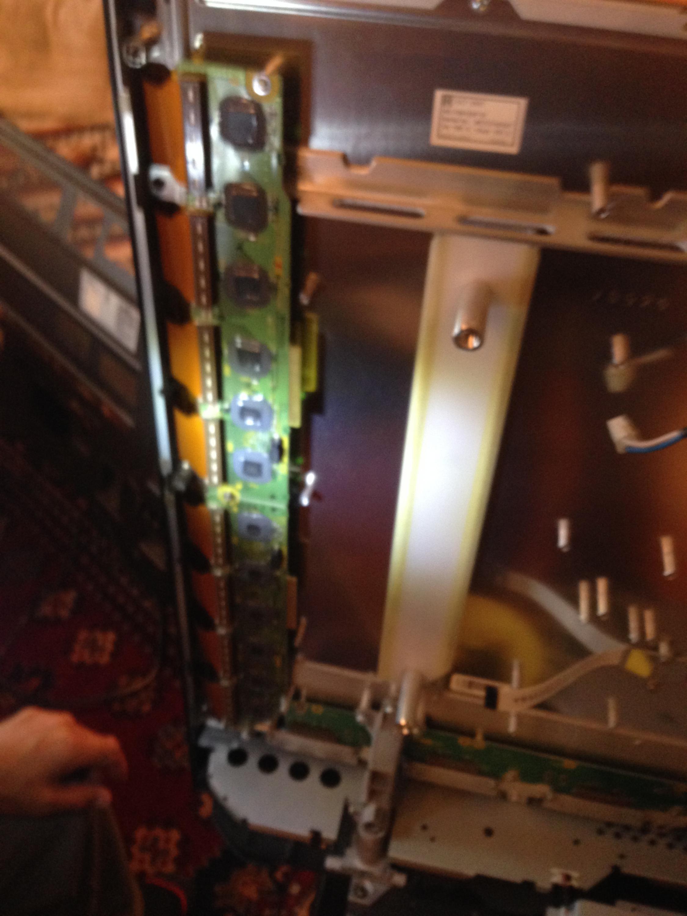

      Here are the pictures of the tv.
      The left side board is the Y SUS board I took out of the tv
        Probably Y-buffer fault. (SU or SD)
        Can you see Vscn test point on SC (Y-sustain) board?
        Please check the voltage and see what it is measuring. It should measure 120V to 150V wrt to -Vad (usually it is measured across a resistor.)
            I found another board, any idea what this does?

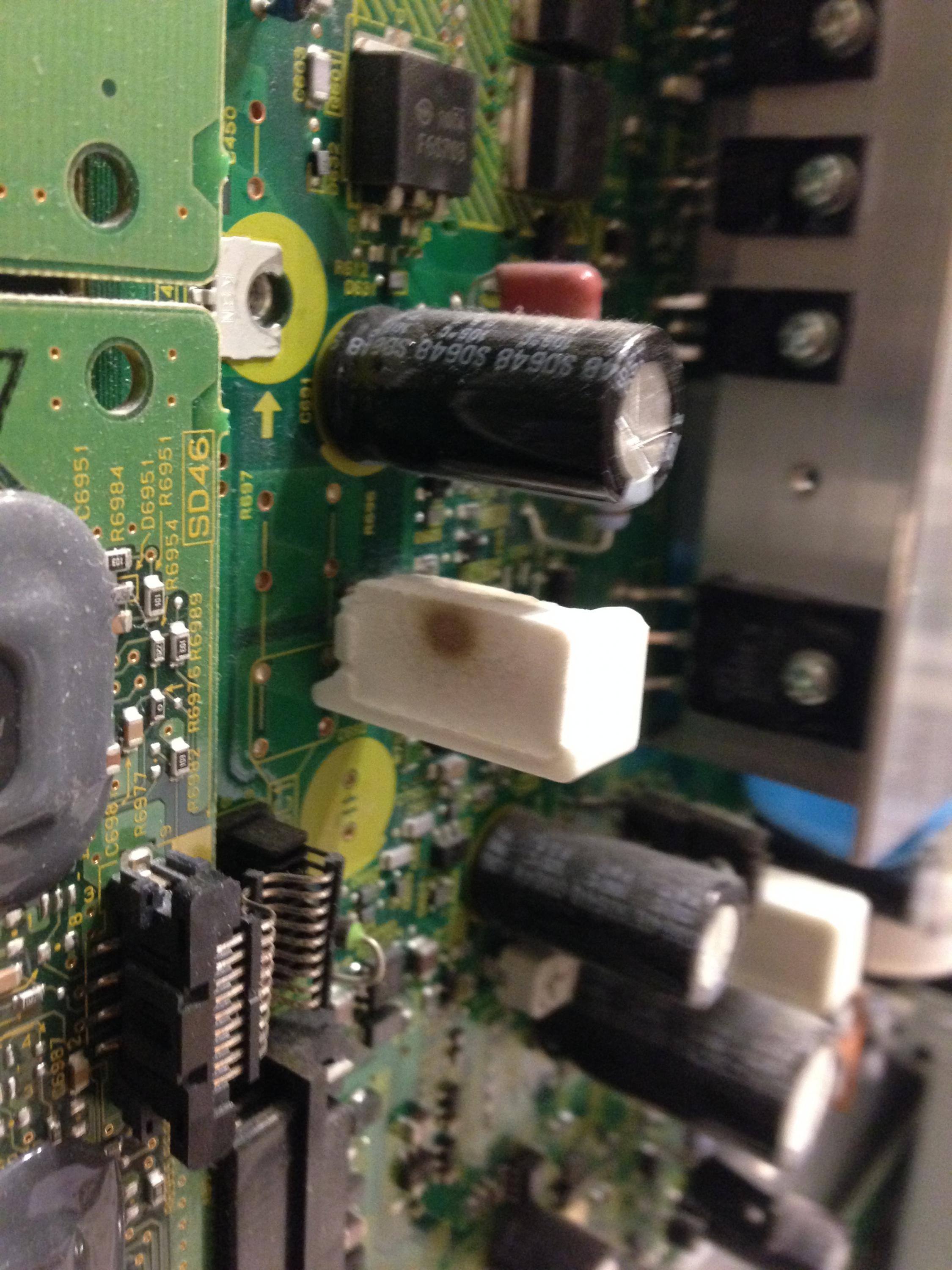

              I found a load resistor damaged and looks like it has a burn mark on it. It also gets extremely hot and is the burning smell is from this part. Problem on Y SUS board or the SU board.
              It is on the left side board (Y-SUS)
