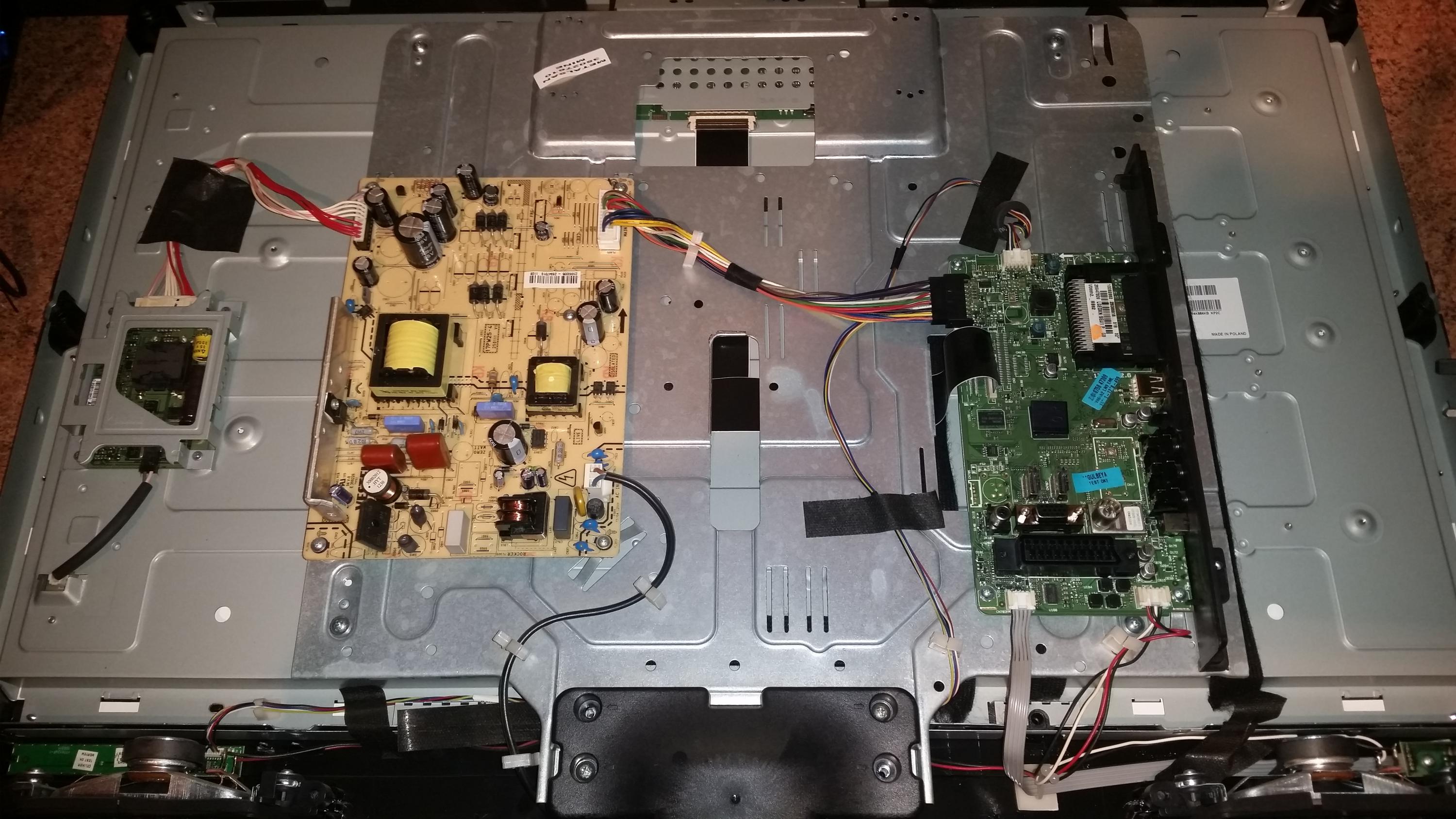

    hello
    i got this tv backlight comes on screen is lit up but no picture but has sound
    voltages seem fine as well

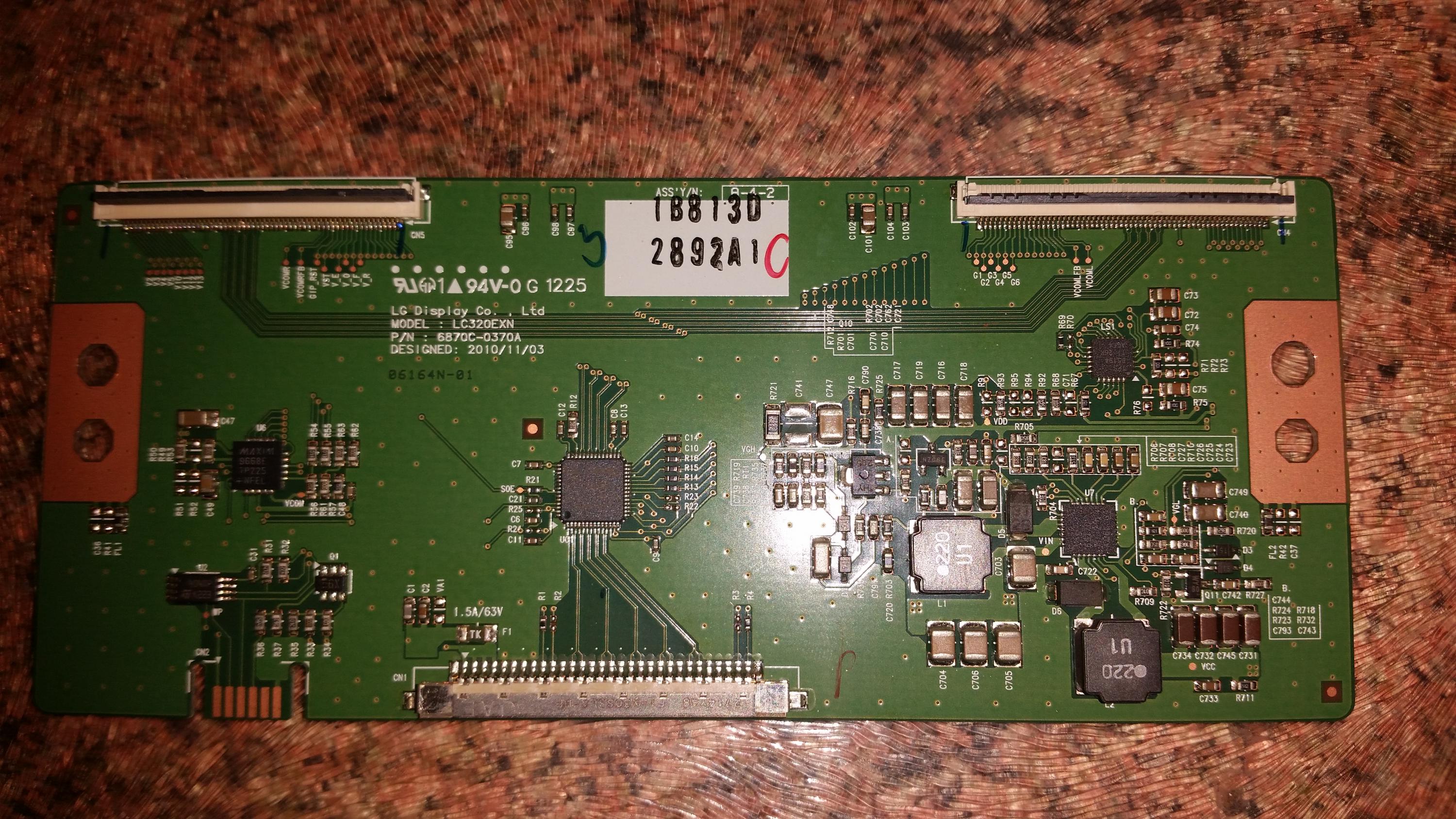

    Top center under the metal shield is the tcon. There will be a fuse somewhere close to the connector, check it for continuity (with power off).

            Can you remove the shield from the T-con and get us a picture of the board.
            • sordids999
              • May 2013
              • 2161
              • uk
              Re: Digihome 32dled906
              photo attached
                With the board installed in the set, try testing: VDD, VCC, VGH and VGL.
                Expecting:
                VCC - 3.3V or 5V approx
                VDD - 15V approx
                VGH - from 20V to 33V approx
                VGL - from -4V to -10V approx
                  VCC - 3.24v
                  VDD - no reading
                  VGH - no reading
                  VGL - -5.93
                    For no reading, do you mean 0.00 or a single "1".
                    You may have to use next voltage range up e.g. 200VDC.
                    Can you try those measurements with the LCD panel ribbons disconnected?
                      sorry tom i mean 0.00
                      ok VGH IS 3.1V set on 200vdc
                      VDD at 200vdc is still 0.00
                          If the voltages rise when the panel is out, it might be a bad panel; if not, it looks like a bad T-con board. I'll have a look in my pile, but I think I might have a T-con for this.
                            the same readings with panel ribbons disconnected
                              Good, I would think the T-con is bad then. I will search my piles. I do recall removing it from a smashed 32" Vestel (CCFL-backlit Alba model, 720p LG panel) but where it got put is another question.
                                  Unfortunately, the board I have only has one ribbon connector. It is an LC320WXE-SCA1 if you need it for another project though, I will stick it in the post.
                                      Update: Board arrived today tv all working again so testing it now
