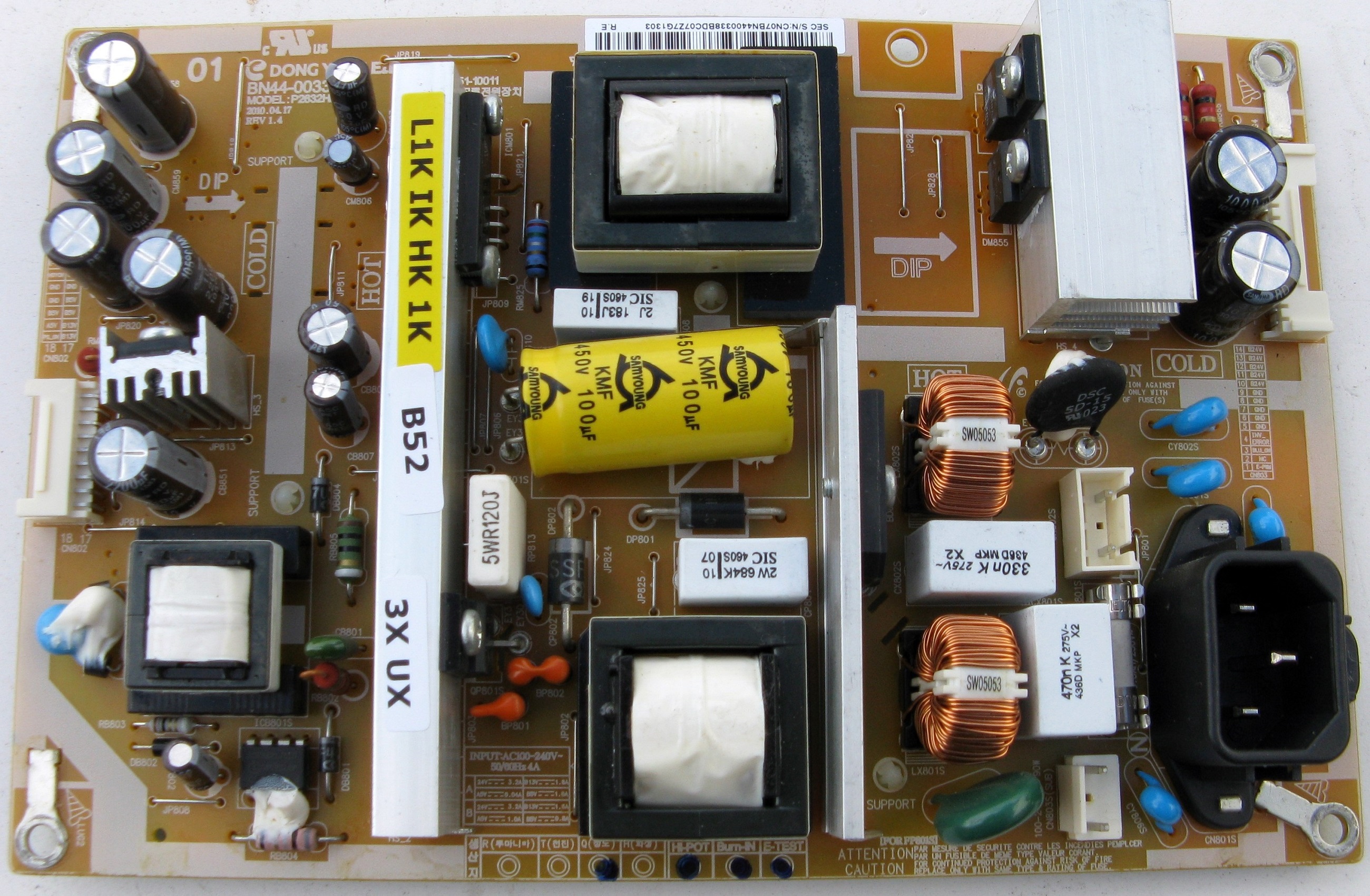

    I have got this small LCD TV. Red LED on the front is on but the set does not respond to either remote control or touch buttons on the bottom edge, and the red light stays steady on.
    Inside no components look burnt or swollen. No back light. STB 5V is OK as shown by the red LED.
    I took some measurements on the power supply board:
    * with Main Board connected both 24V and 13V lines fluctuate from about 3 to 15V and 0.6 to 4.2V respectively.
    * with Main Board disconnected the 24V line reads around 16.7V while 13V line reads around 8.6V
    * also voltage on LVcc pin of ICM801 (FSFR1700) is unstable.
    I am not sure where to look next. Is it a faulty switching IC (ICM801) or is it a protection circuit acting? Your guidance for further troubleshooting steps would be very much appreciated.
    Attached below are the pictures of the Power Supply Board and also its schematic diagram.

    Check the DC Voltage right at the TWO LEGS of the main filter cap to see if it has large fluctuation when TV is on.
    Try heating the board with hair dryer for 2~3 minutes and then apply the power to see if the voltage will be steady.
    Check the capacitance of the white rectangular cap that has '2J 183J' ptinting on top.

      Budm, your instructions were spot on. Thank you. It really amazes me how quickly and correctly you (and others on this forum) can recognize the issue and indicate direction to pin-point the problem.
      Yes, the capacitor (white rectangular with '2J 183J' printing) was creating the problem. Schematic indicates this cap as CM808 18nF, 630V. When measured off the board it showed only about 1nF. I could not find the exact replacement but substituted it with 22nF, same voltage range. The TV is alive.
      I hope that this slightly higher capacitance is not too critical in the long term. It seems to be doing well now.
      BTW - What is the role for this cap? It sits directly in the DC supply line to primary winding of the switching transformer. Why wouldn't the transformer operate without that cap? I would really like some theory on this point, if possible.

        It is the coupling/dc blocking cap for the primary winding of the transformer, you will need to get the correct type and value otherwise it will have problem. It has to be made for high switching circuits:
