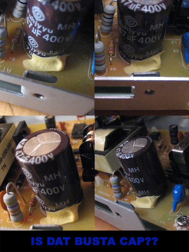

    Hello, I've got this piece of crap ilo DVD Recorder model# DVDR05 ZU, which is basically just a Cyberhome 1600 ZU DVD Recorder. This unit probably was functional for a total of 3 months. Although it should just be thrown in the trash and forgotten, I've kept it around with the idea of getting it to work again, or just use the parts for random projects should I throw in the towel. The unit basically *seems* to be functional, by means of powering up, the disc tray still opens\closes, all inputs\outputs still work, as well as the setup and display menus, etc. However the only thing that it won't do is successfully load a disc, it tries to; but eventually will display "no disc". I popped the top off hoping that the DVD burning drive would be compatible w\ a pc DVD Burner. Unfortunately I didn't see anything that'd allow that. While investigating the board & disc drive I opened up the disc support stabilizer cover and loaded a disc and noticed that the laser doesn't appear to completely make it to the inside of the disc, tries to moving out a lil and then spins down, tries again once more and then displays "no disc". I'm not sure if the laser is supposed to be focused in one specific spot, or if it's normal to be slightly refracted; when looking at the laser firing onto my ceiling it was definitely not focused to a point. I also noticed the board that holds the power supply has a cap that looks like it leaked goop onto board. However I dunno if this is truly the case. I included some pics, if anyone who could confirm this has the time to take a peep, I'd really appreciate it. Sorry about the long ass story, I didn't expect my explanation to be this long. Anyhow, thats all for now. If you've read this far, thanks!! -tmt-
    https://www.badcaps.net/forum/attach...tid=5869&stc=1

    The cap is fine, it's only glue holding it down
    Be careful with that laser, it's rated as Class 1 just because it is contained completely, when you remove the metal chassi the laser gets a much higher rating
    That laser has the potential to be fatal to your eyes.
    Try to give the guides for the laser some grease (if it looks like grease is supposed to be there)
    And also make sure that they are straight

      Check the voltage of each rail,(look at the the marking at the power board connector, it should say what voltage each wire is supposed to have).
      +/- 5 percent is good.
      I think the tiny white ribbon cable that connects the laser does not have a good contact. Remove the ribbon cable, clean it with alcohol , and then reinsert it back and fourth.
      That is what i do to repair my 3-year old cyberhome that refuses to read disc.

        The cap certainly doesn't look bulged or vented. If it had vented from the bottom, you'd expect to see some kind of bulge on the top of the cap and/or it sitting at a weird angle to the board. It could have failed without any physical signs; an ESR meter will show you if the cap is bad or not.
        Having said that though, it's a Fuhjyyu so only a matter of time before it does vent
        Also, Fuhjyyu usually DO show physical signs of failure. See my avatar pic
        You know there's something wrong when you open your PC and it has vented Rubycons...
