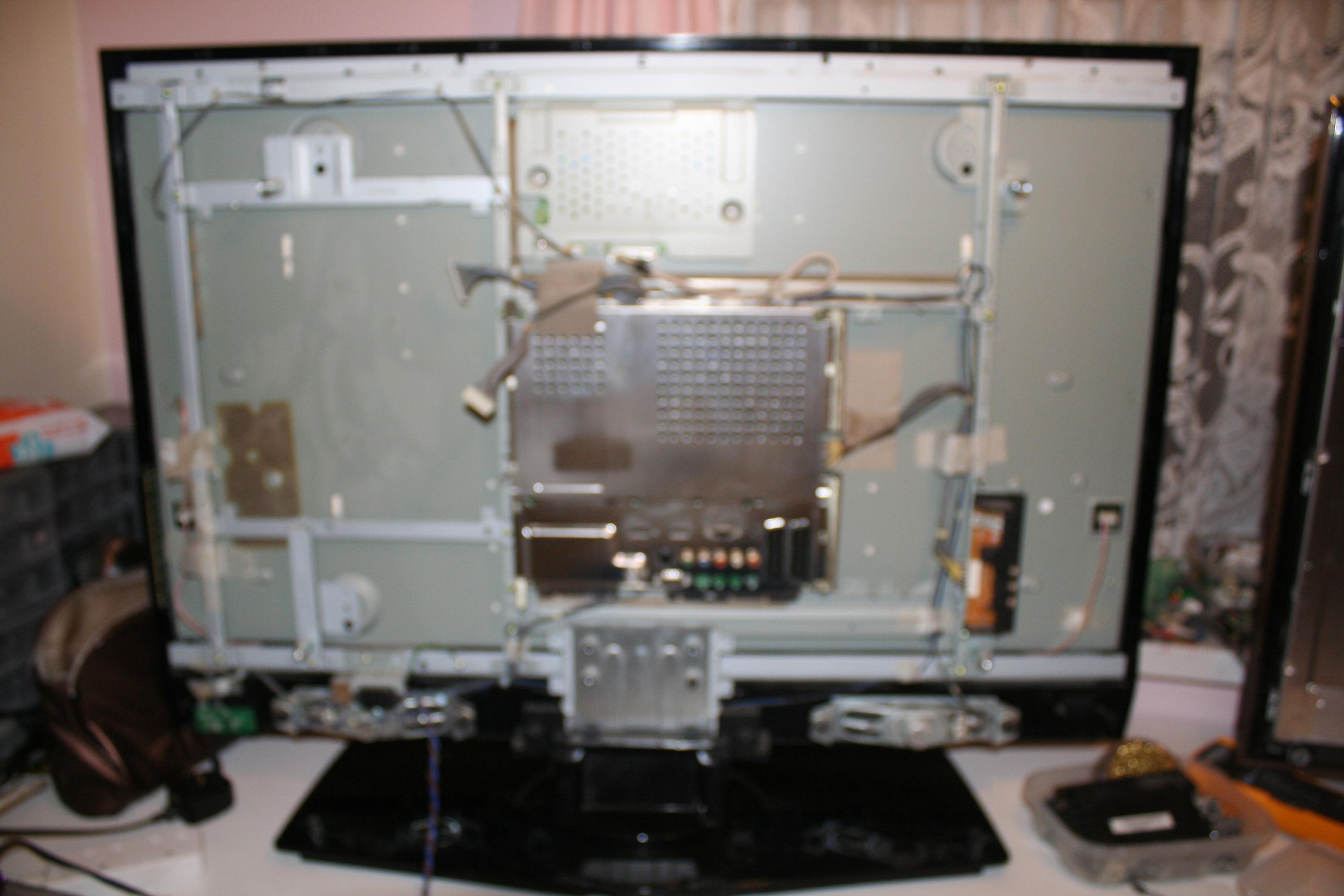

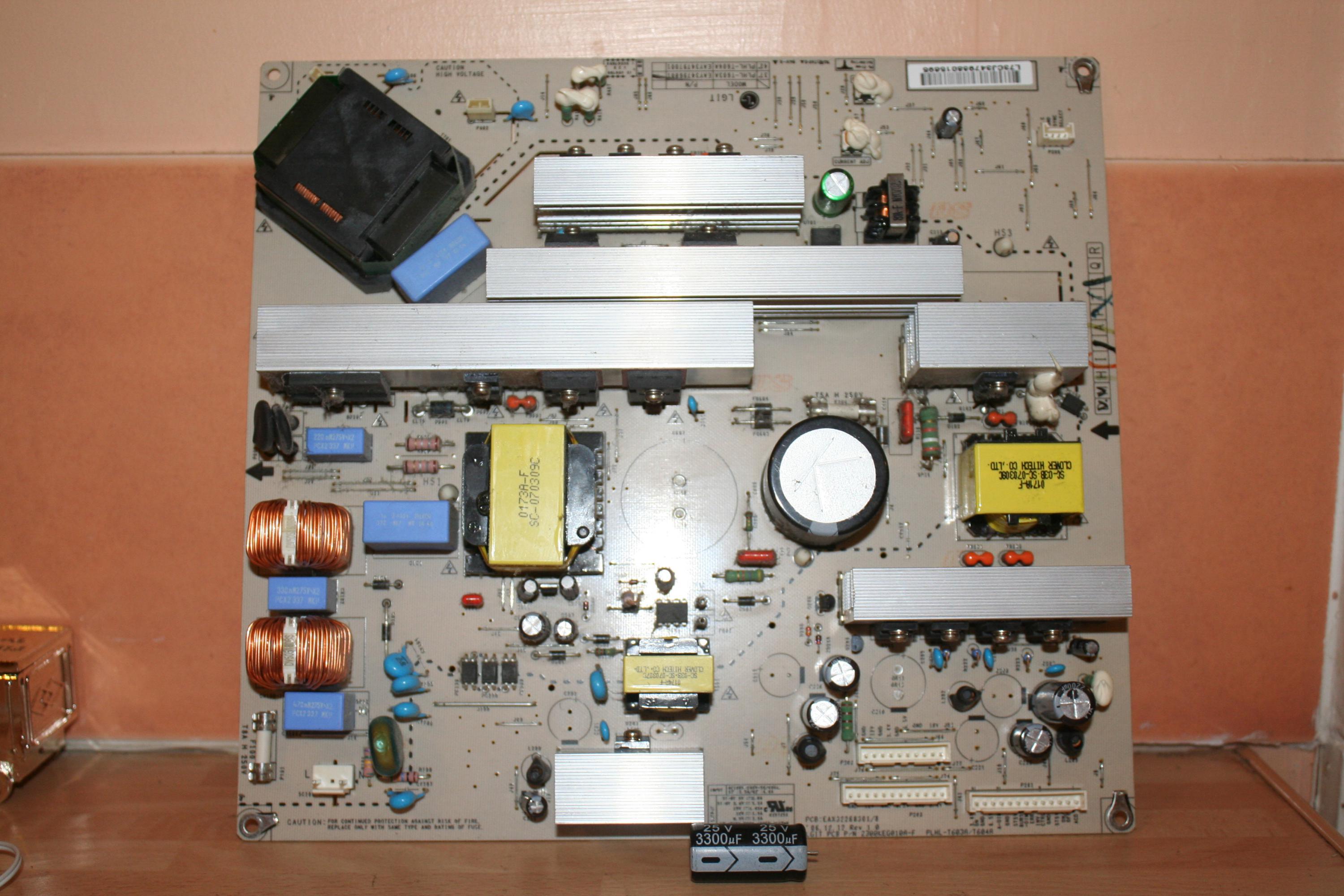

    Been given one of these, was a problem where after 20 mins screen starts to break up and eventually goes black. Asumed inverter or t-con board problem, after opening up appears some one else already had a go at fixing power board, some of caps have been replaced with wrong ones, im assuming this is whats causing problem. Until replaced with correct caps dont want to trouble shoot any further.

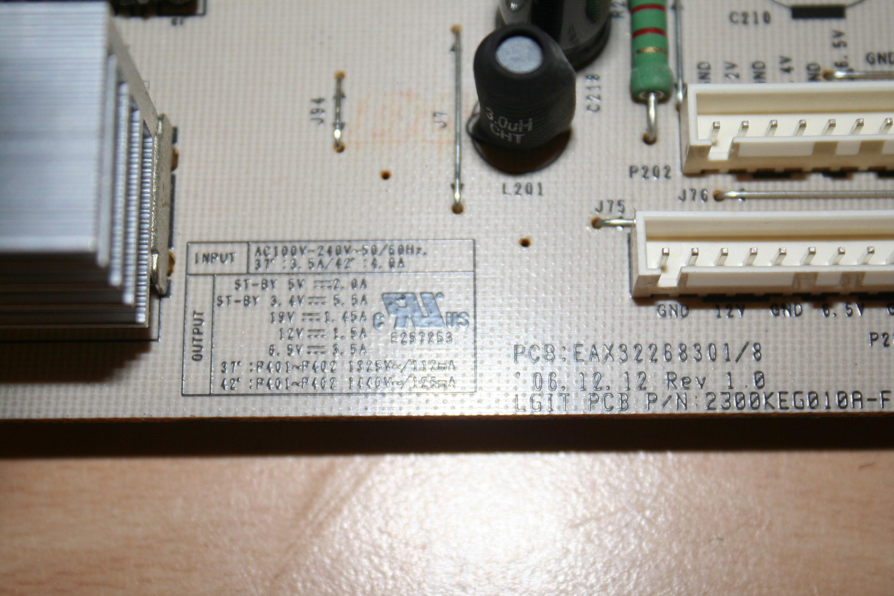

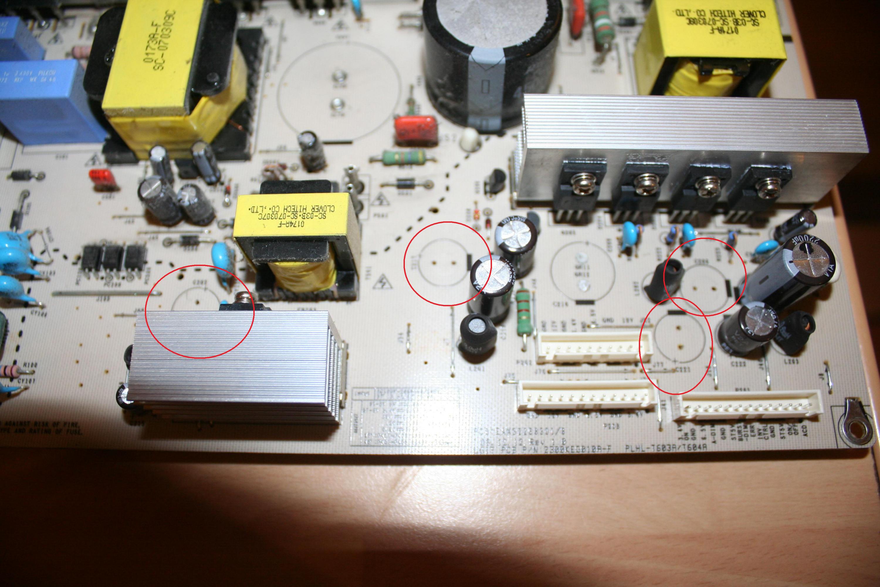

    I would rather repair the power board than buy a replacement, Power board is EAX32268301/8 tried searching for the board diagrams but havent had any look, does any have any experience with this set and one know what capacitors are needed for the following locations.
    C202
    C217
    C221
    C206
    Thanks for any help

    How about pictures of the whole back side of the TV so we can see what we are dealing with?

        Re: Lg 37lc46
        The caps that was put in was 3300uf 25v and they was obviously not the right sized caps for the board and im guessing not the correct rating, with the screen having problems after around 20 mins, I want to ensure the power board has the correct rated caps on so as to eliminate that as the problem.
          Re: Lg 37lc46
          The four smaller ones are all 2200uF 10V IIRC.
          The one bigger one is 1000uF 35V.
