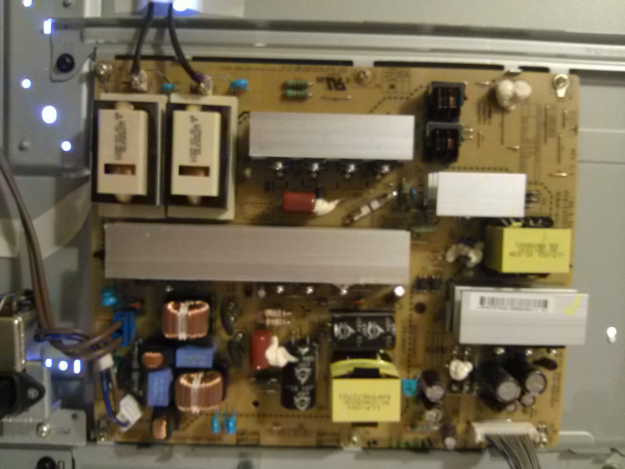

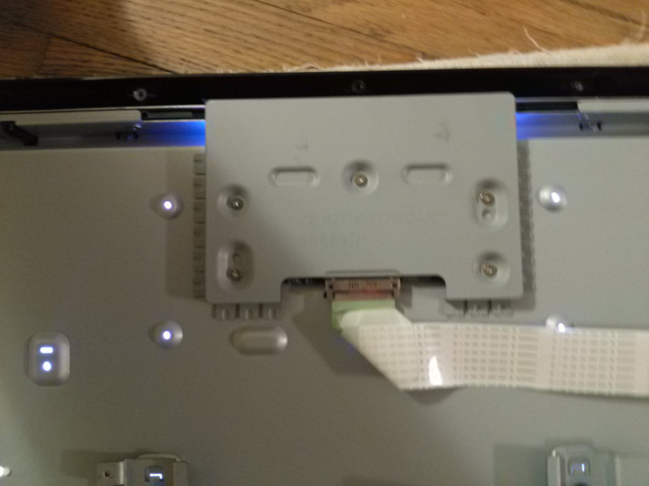

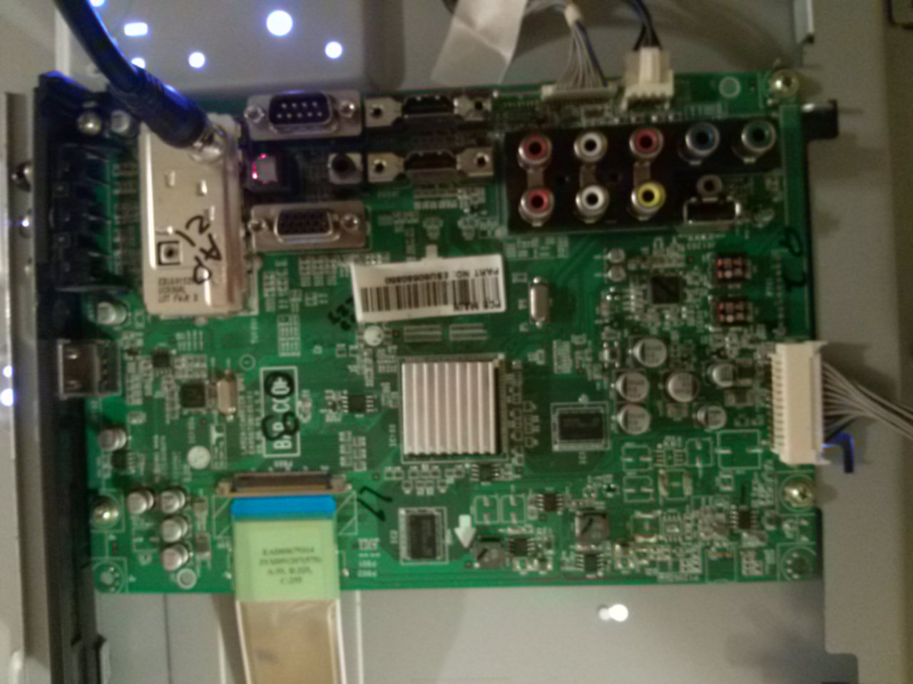

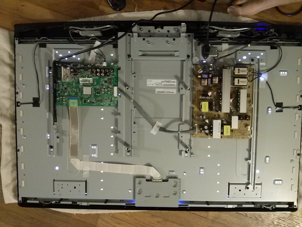

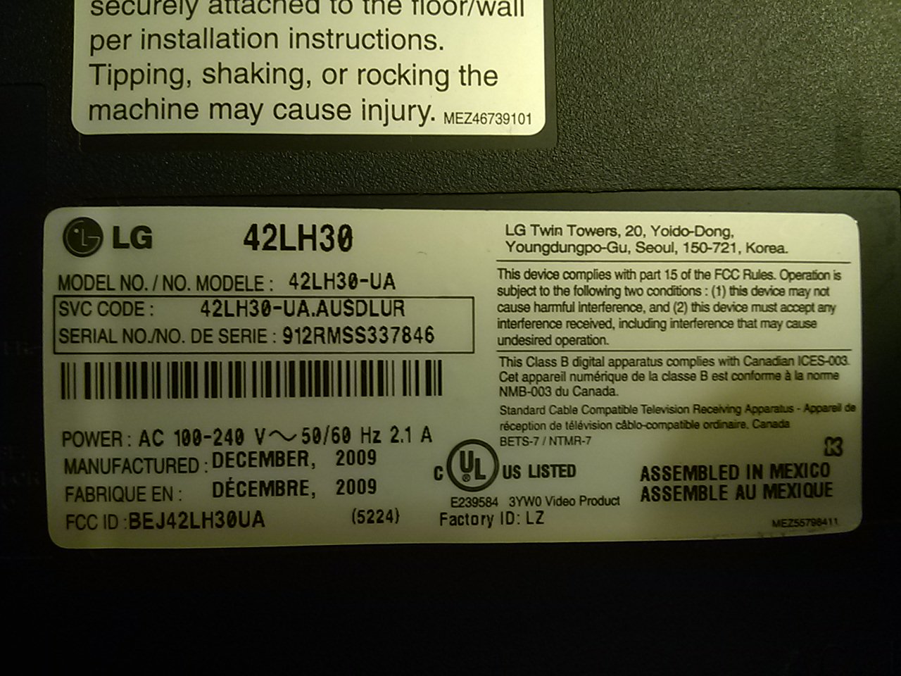

    I have a unit that loses color after about 30 minutes and the picture turns a little fuzzy. I can turn the set off and wait a few minutes and the color and picture returns to normal. Currently, I am think the it might be a TCON problem. Any ideas?
    Re: Lg42lh30 loses color
    So the pictures are in black and white? You can try cooling the T-CON board with canned air duster using it upside down to get freezing air out.
