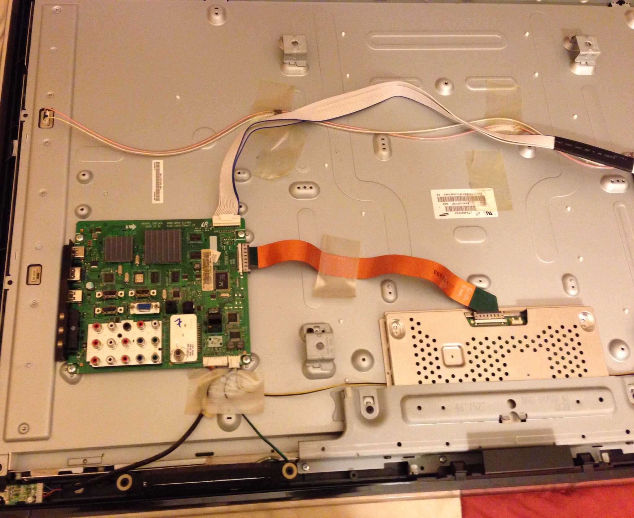

    Re: No backlight, with sound Samsung lcd LN46B640R3F
    Can we see the whole back side of the TV so we can see how all the boards are connected together?

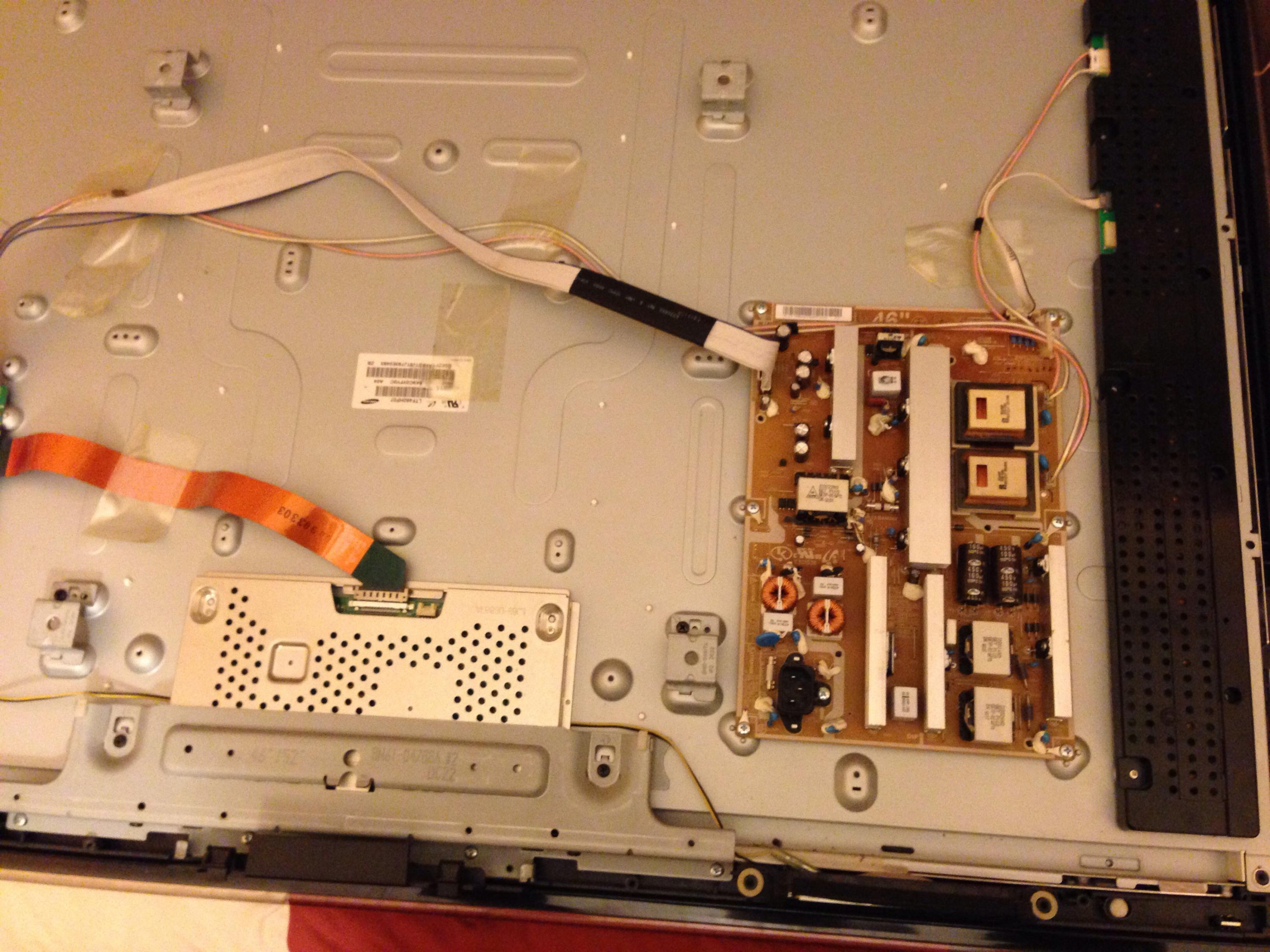

      Budm
      These are the pictures of the back. Left side first.
        Here is the right side. Can't post all at once?

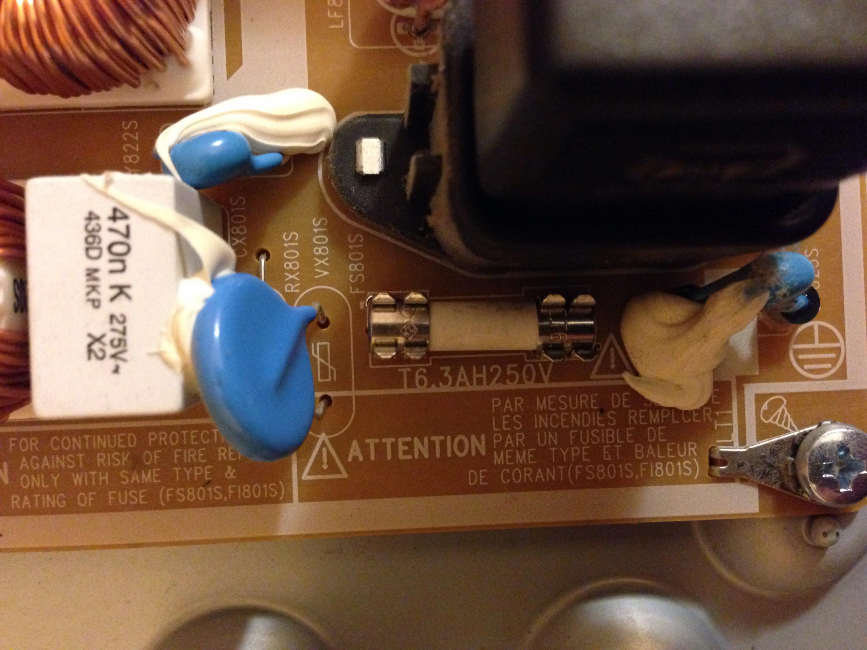

            These are the two fuses I checked. Both had 5 ohm resistance so they are good. The caps that I measured are cp802 and cp803 both, with a jumper on ps and sb, measured only 62VDC.
              Here is the second fuse on the top left. The two caps I measured are the on the right.
                "These are the two fuses I checked. Both had 5 ohm resistance so they are good"
                Fuse should have the same resistance reading as when you touch the two probes of your meter together. 5 Ohms reading on the fuse is not right.
                "The caps that I measured are cp802 and cp803 both, with a jumper on ps and sb, measured only 62VDC." Are you measuring RIGHT AT THE TWO LEGS OF THE CAPS as instructed? Just remember, you are making voltage measurement in the primary side of the circuits, you cannot use chassis as the ground ref point for the lack lead of the meter.
                Based on what you indicated for the voltage reading, you must have used the chassis as the ground ref, unless your meter is bad.

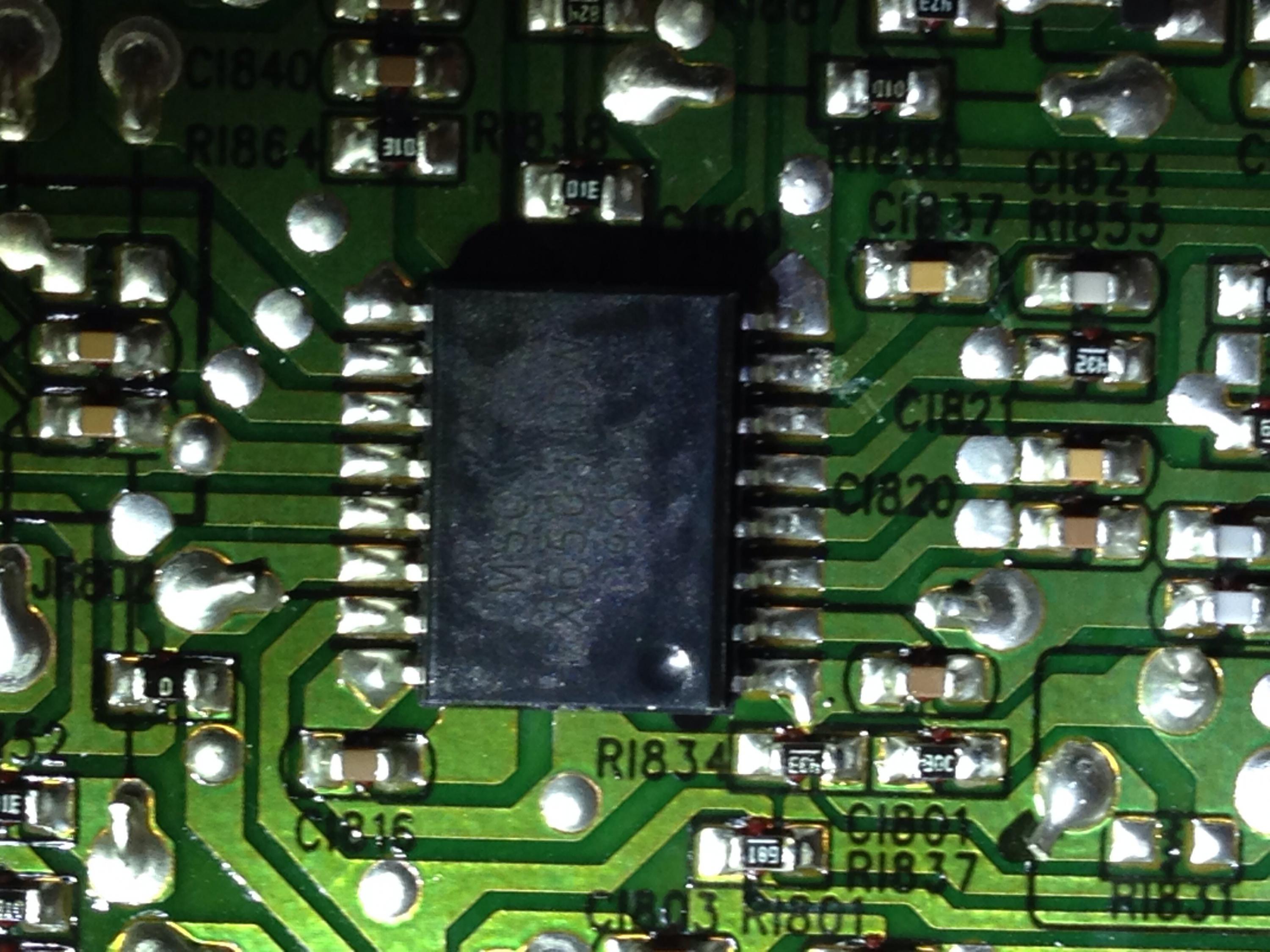

                              Went ahead and measured the voltage at the ena pin on lx6503 (second to last pin on the left side of the picture). Voltage was 2.56VDC ref to chassis ground and the same voltage was on cap labled c1837.
                                  Sorry picture is rotated. Second pin from the top, on the right is where I measured.
                                    What do you get on the VCC pin1? Also on drive 1 and drive 2 (check with DC and AC mode on the meter).
