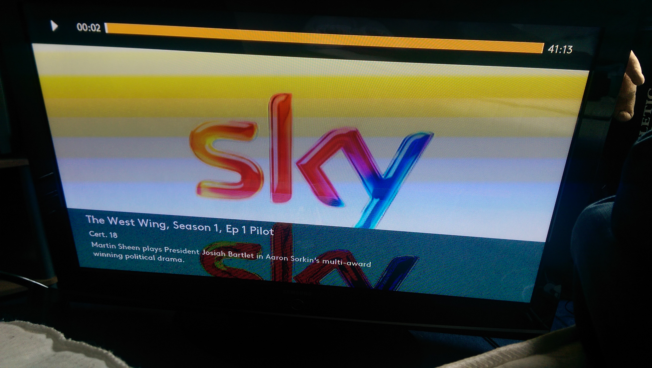

    Help again please guys.
    Just paid to have the Y-SUS and buffers repaired on a Samsung PS-50C96HD due to sound but no picture. They arrived back today and although I now have a picture every so often the top half of the screen ghosts into the bottom half and the Screen flickers. Had it running now for about 12 hours and I've tried a replacement t lower buffer as I had one spare but it made no difference. Don't want to question the repair untill I know if there is likely to be another cause. I bought the TV faulty with the Y-SUS issue so not sure if it might have had another issue .
    As usual any help what be great.

                            can you post pictures of the ghosting that your refering to?
                              Re: Samsung PS-50C96HD
                              Photo are not possible. It is a millisecond flick of the top half on the screen ghosted into the bottom half. Happens every couple of minutes or so. Got me baffled.
                                Hi. Finally after more attempts than I care to count got a pic. The yellow in the screen is not visible when watching but as you can see the top of the screen is in the bottom. Looks a lot worse in the pic. While watching its only really a ghost / shadow.
                                Anyone any ideas ?
                                  Hmm, looks like it could be a control board issue - but very hard to be sure.

                                    Silly question--Have you tried re-seating all the ribbon-cables to and from the Control-Board and the SUS boards....
                                    Worth a try....
                                    If not, prob is the control-board scrambling stuff up...
