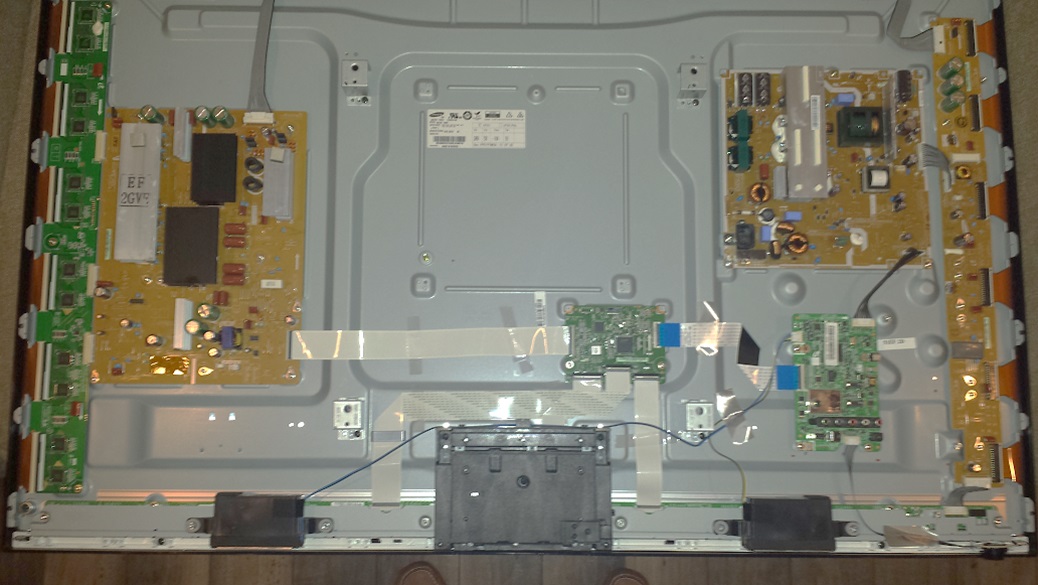

    Our 54-week old 51" Samsung plasma TV (PN51E530A3FXZA) suddenly stopped showing a picture last night. It is mounted on the wall, and the picture/sound is provided by HDMI from all sources. Would sound still be available if source is HDMI?
    Checked the Va and Vs on the power supply board. If checked when TV first turns on, the voltage starts out at the normal range and then steadily drops out to near 0.
    To my inexperienced eye, I am only seeing one fuse on this whole TV -- on the power supply board. Ohm check there matches the reading when testing the two probes of the DMM together.
    The green LED on the Logic board is flashing very slowly -- maybe 5 seconds on and two seconds off..?
    I was going to try and isolate the Y-Sustain, Z-Sustain, etc., but my unit does not have the same boards as most guides I'm seeing on the web.
    Are my Y-Main and X-Main on the same board?
    Thank you for any help you may be able to provide!

    Y-sus and buffer to the left.
    Doesn't have an the more Conventional XMain - just has an xbuffer.
    Your power supply probably isn't the issue as most samsung nowadays show the voltage then shut down once the error is detected.
    More than likely your y-sustain is bad.
    also Check the buffer ICs for shorts.

                          Re: Help identify boards in Samsung plasma
                          The voltage drop is caused by the control board, it is shutting down the power because it detects a fault with the X-main (or X-buffer), Y-main or Y-buffer.
                                  I think the logic board gets power from the X-buffer/X-main board; the power and control signals go to the C-buffers, and these are then routed into the control board assy.
                                    So the X-Main is NOT combined with the Y-Sustain/Main board? It is actually part of the long skinny board on the right side of the panel?
                                      Nah--In your set, the X-Main is the thin board on the right! In some sets, its even part of the PSU!
                                      These newer sets (and some older ones....) monitor the output signals from both 'SUS' boards, and if they are not right--as in wildly out in size, shape etc, or absent-- the control-board will shut down the power-supply rails, Vs and Va....
                                        Wow, well that's interesting news..
                                        So, looking at the picture in the original post, there is no way to isolate the X-Main from the Y-Main/Y-Buffer is there? The boards on the left side cannot receive power without power first being provided to the X-Main, correct?
