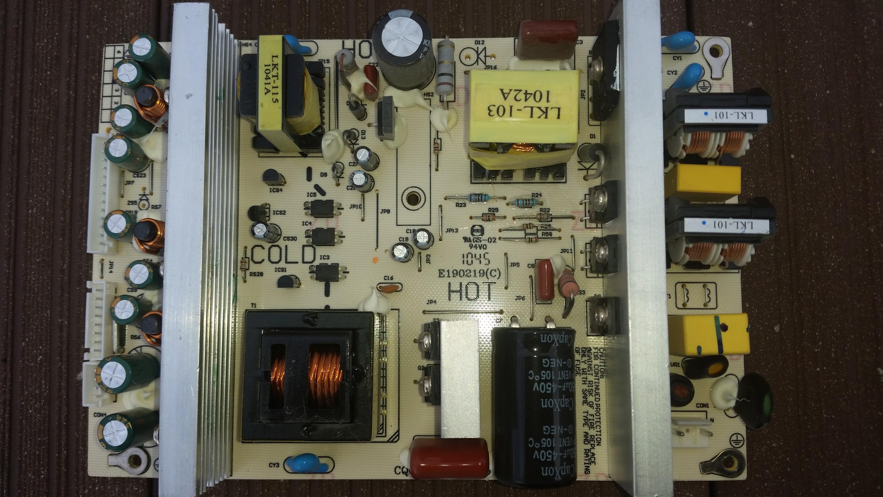

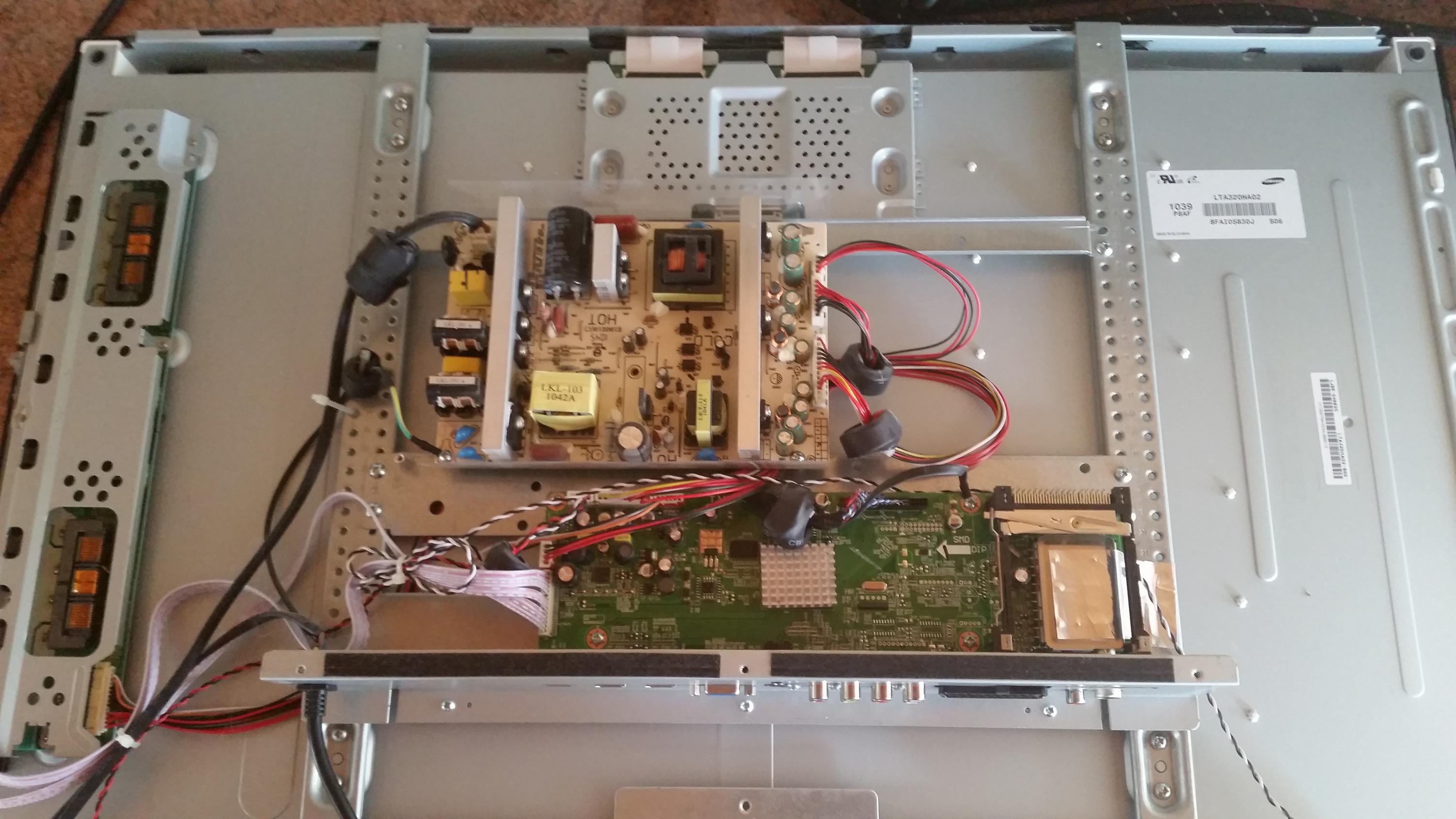

    Hello got this tv today no standby light totally dead until I checked voltages,which voltage readings on the psu seem to be all over the place
    Any ideas ?

                        Main 450v cap top left of psu reads 395v steady
                          Re: Technica M32/57G
                          Can you supply a close up picture of the power supply?
                            Is that ok ?
                              OK, I'd try replacing C27, C2? (C21 maybe, just below C27), C19 and C18.

                                Right replaced c27, c 18, c 19 the red standby light came on then went to blue but cut out again so I then went a changed c21, cs 30 but still the same

                                    ok replaced all these as above still nothing but just turned it back on to test the 5v standby and now its working tv all good
                                    very strange didnt work first time i changed the caps ?
                                      I'd soak test it for a while - you might have an intermittent fault somewhere.

                                        To be fair i run out of 22uf 50v caps so took two from a old board (maybe its them)so ill order some more
