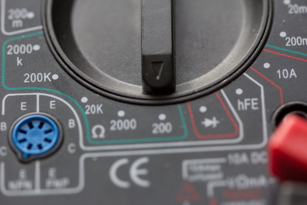

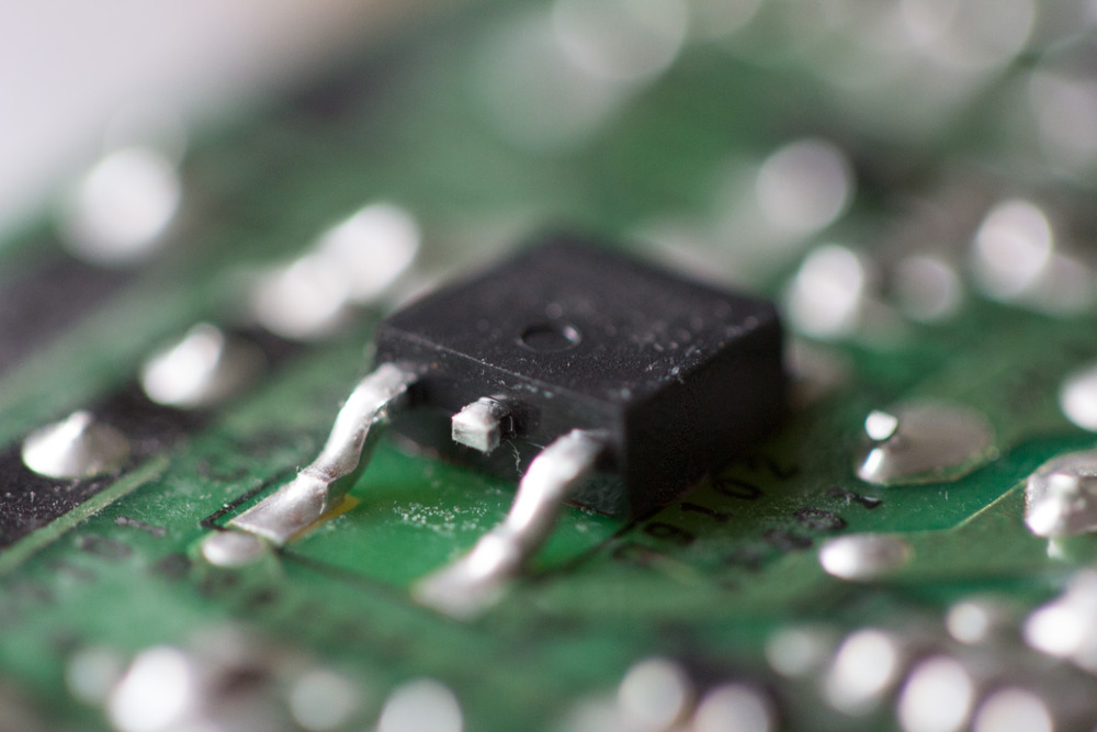

      Hey thanx. Hmm unless my cheap multimeter is to "off" its reads constant 1 on all legs of all these 3 components. I have the 200ohm on the meter - just took a picture of it - a bit unsharp i know my macro photolens is a bit hard to control or it can be my 35 years old eyes - no comments
      Alle 3 had the middle leg with no connection - se the photo mosfet example

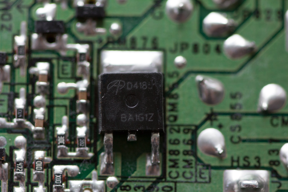

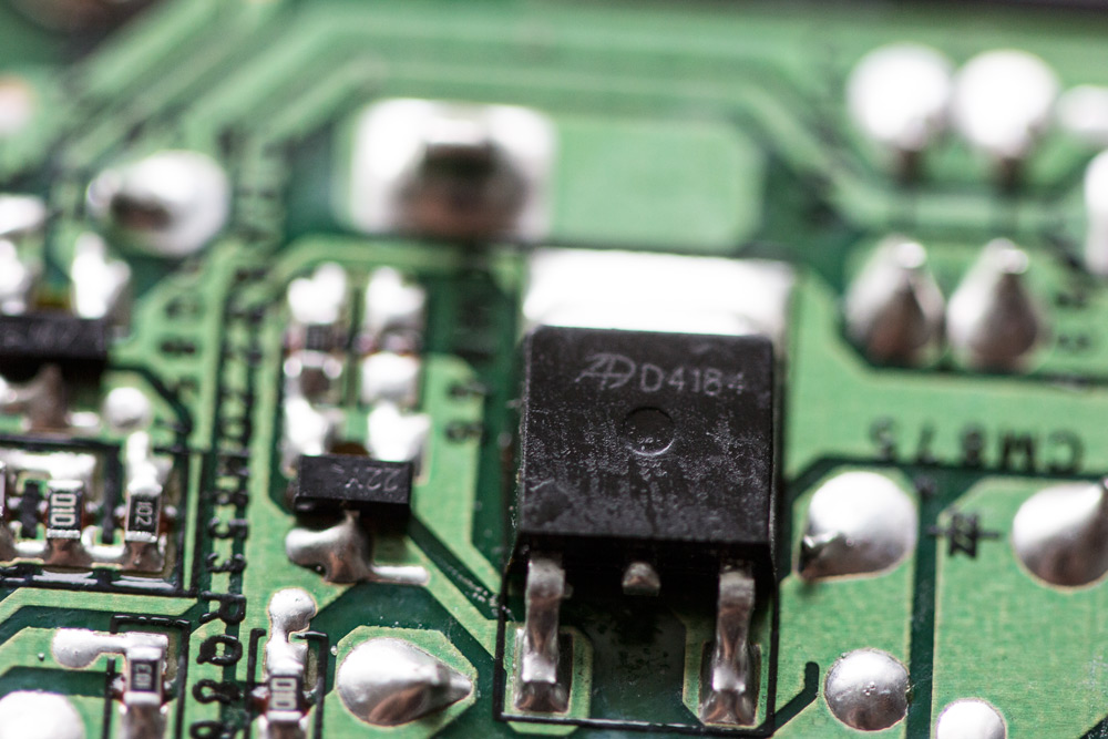

      The top QM854 dosent look burned actually
      Its named
      D4184
      looks like there is no number below this
      QM855 is named
      D4185
      BA1G1Z

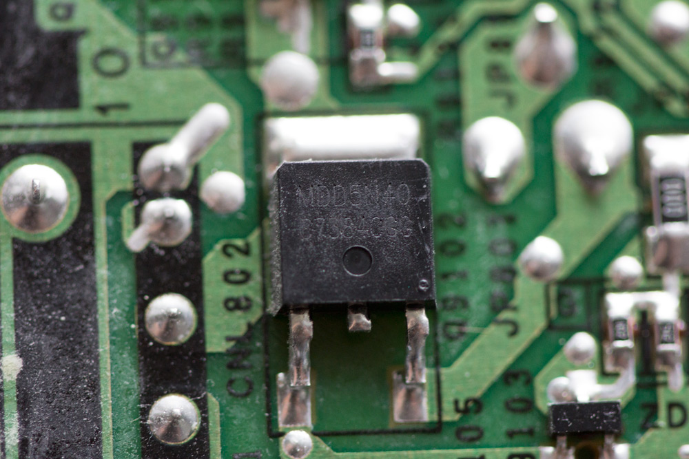

      Q9162 is named
      MDD5N40
      C7384CGG (the last CGG is hard to read - can also be GGG or CCC)

        OK 0 they are all mosfets and seem to be ok - at least not shorted.

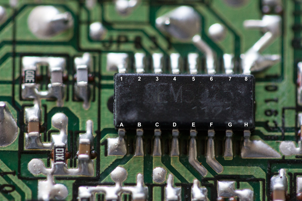

            Its
            SEM5025
            1121
            just set numbers and letters on the legs if there is anything i maybe need to messure on that
            • selldoor
              Slow Learner
              • Dec 2010
              • 7870
              #46
              Re: Samsung tv dosent turn on (no signal/standby light out) after lightning hit the h
              I am struggling to find a datasheet for the Samsung SEM5025 maybe it has not been released/leaked yet. Nearest I can find is SEM2005 but looks to me it may be for a non LED set. If no-one else can help may have to resort to hoping the pins are the same - if not the values.
