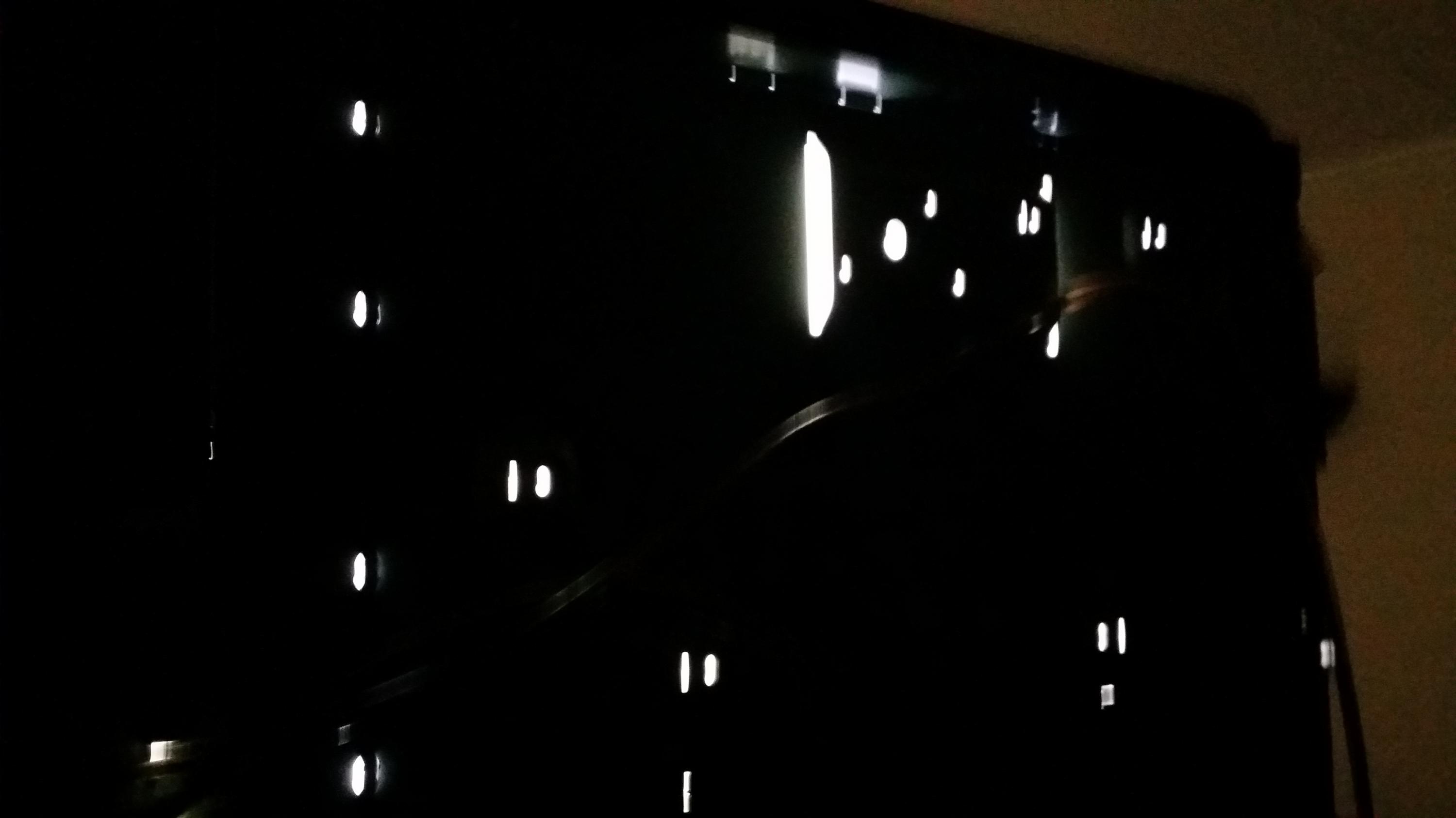

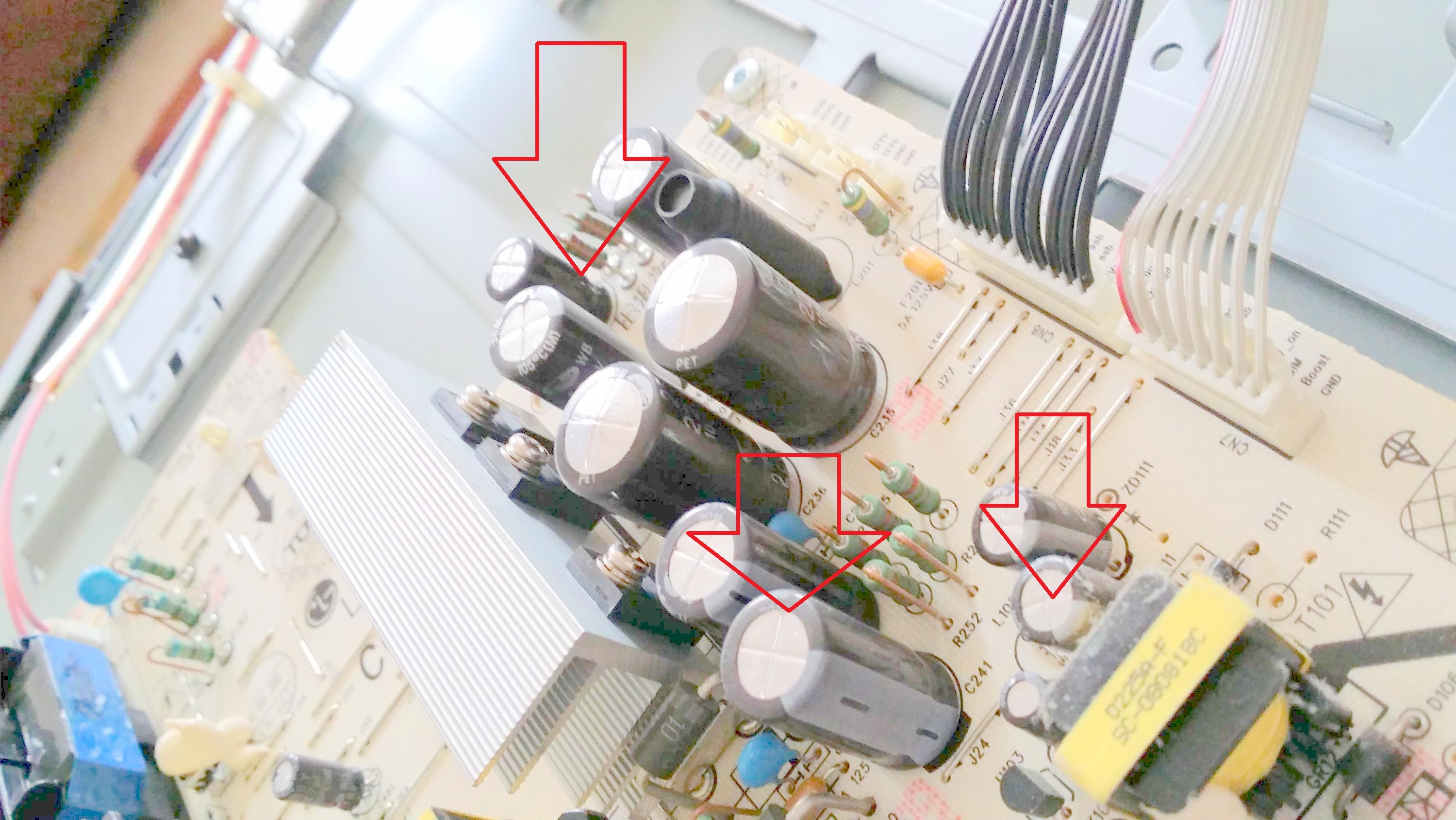

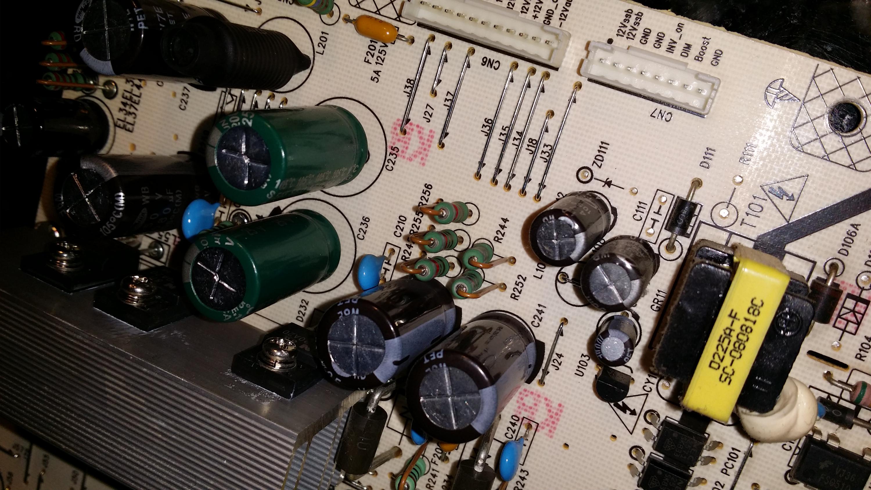

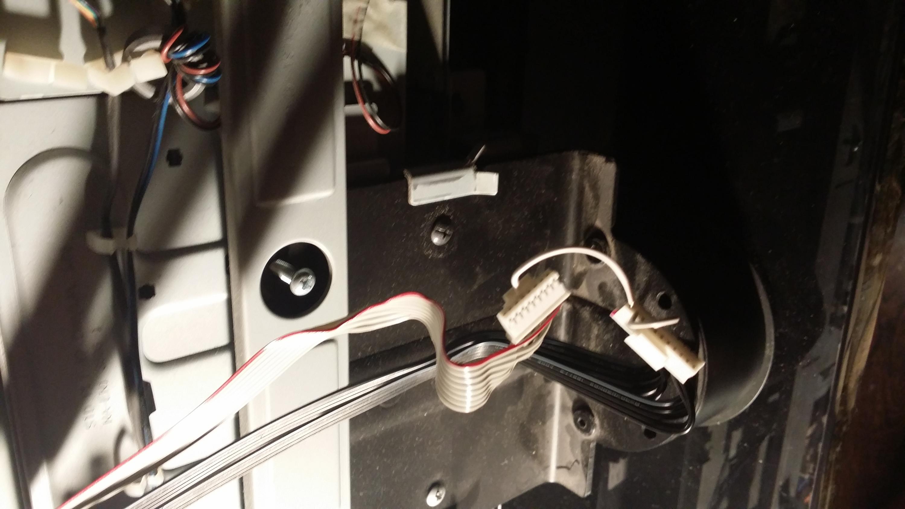

    Replaced two caps (pic 3), SSB and T-Con board and still won't turn on...
    Did some tests:

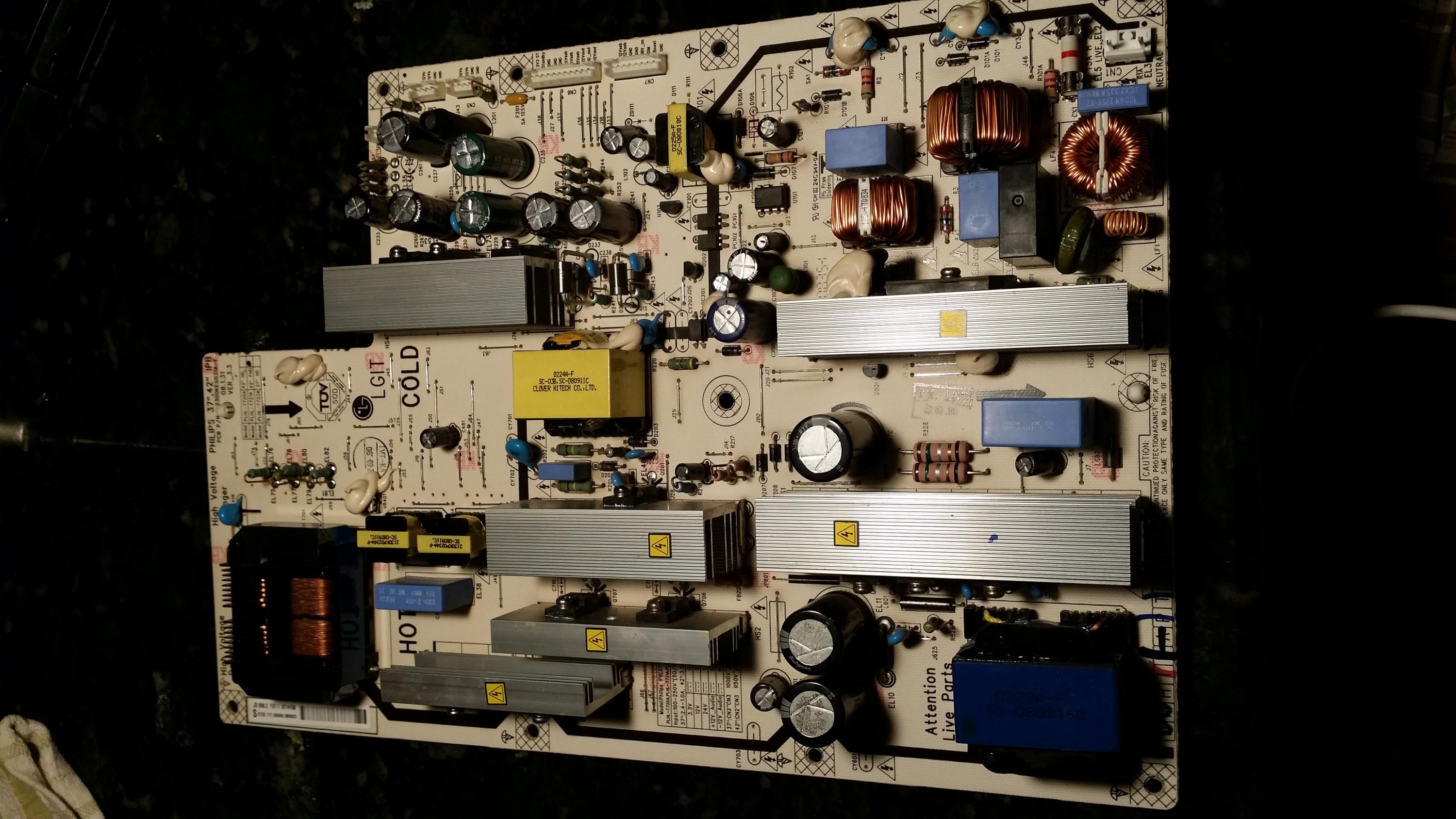

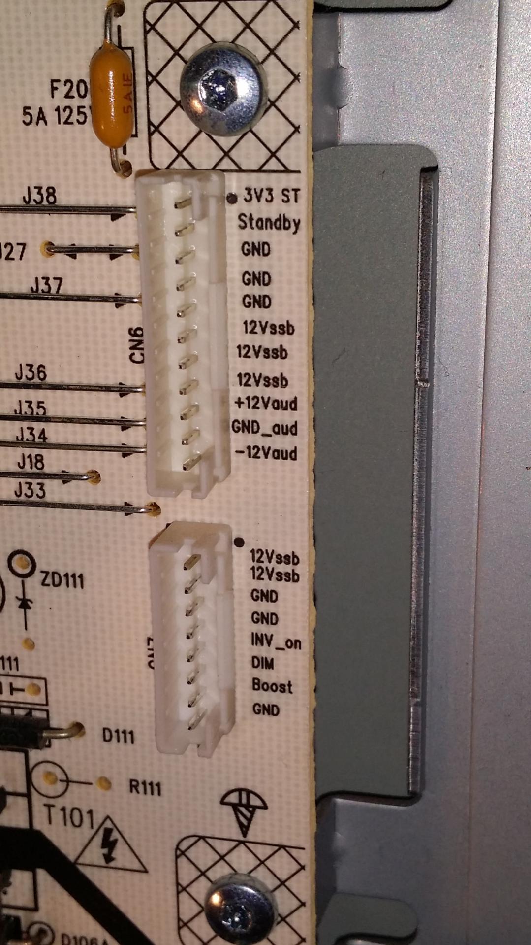

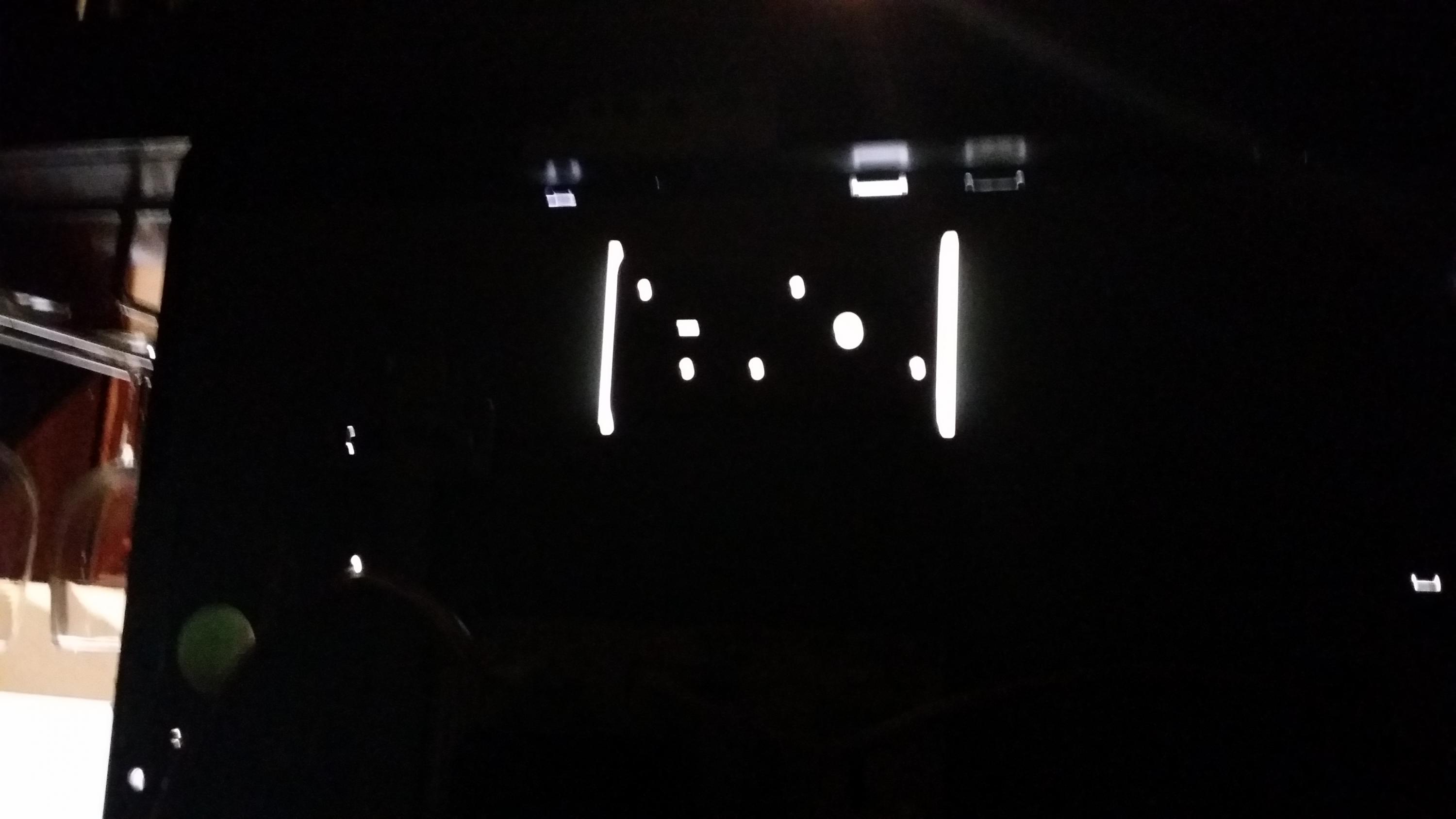

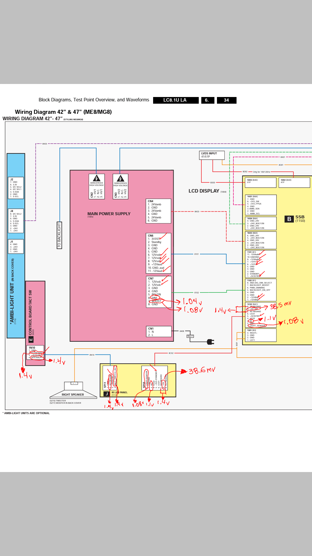

    Put a jumper on CN6 pin 2 (2.6v) to Pin 4 (ground) to check the backlights (pic 5) and after a few min it did turn on (pic 6), then added another jumper from CN6 on Pin 1 (3.3v)st to CN7 on pin 5 (inv_on) (pic 7) after connecting the power cable immediately the back lights turn on (pic 8)
    Then checked voltages (pic 9)
    Questions:
    On (pic 9) the voltage from the SSB on pin 8 (+5v SW) to the "IR Led Panel" pin 8 (+5v) reads 5v but I'm only getting 38.5 mv; do this means the SSB is defective?? Even so I just replaced
    The test to the backlights which did turn on and voltage check on the PSU were correct, this mean the PSU is good??
    And if the backlights turn on before I replaced the T-Con board means that this one was not defective??
    Can you please help me on this one? Give me some suggestions or tests, or should I just give up??

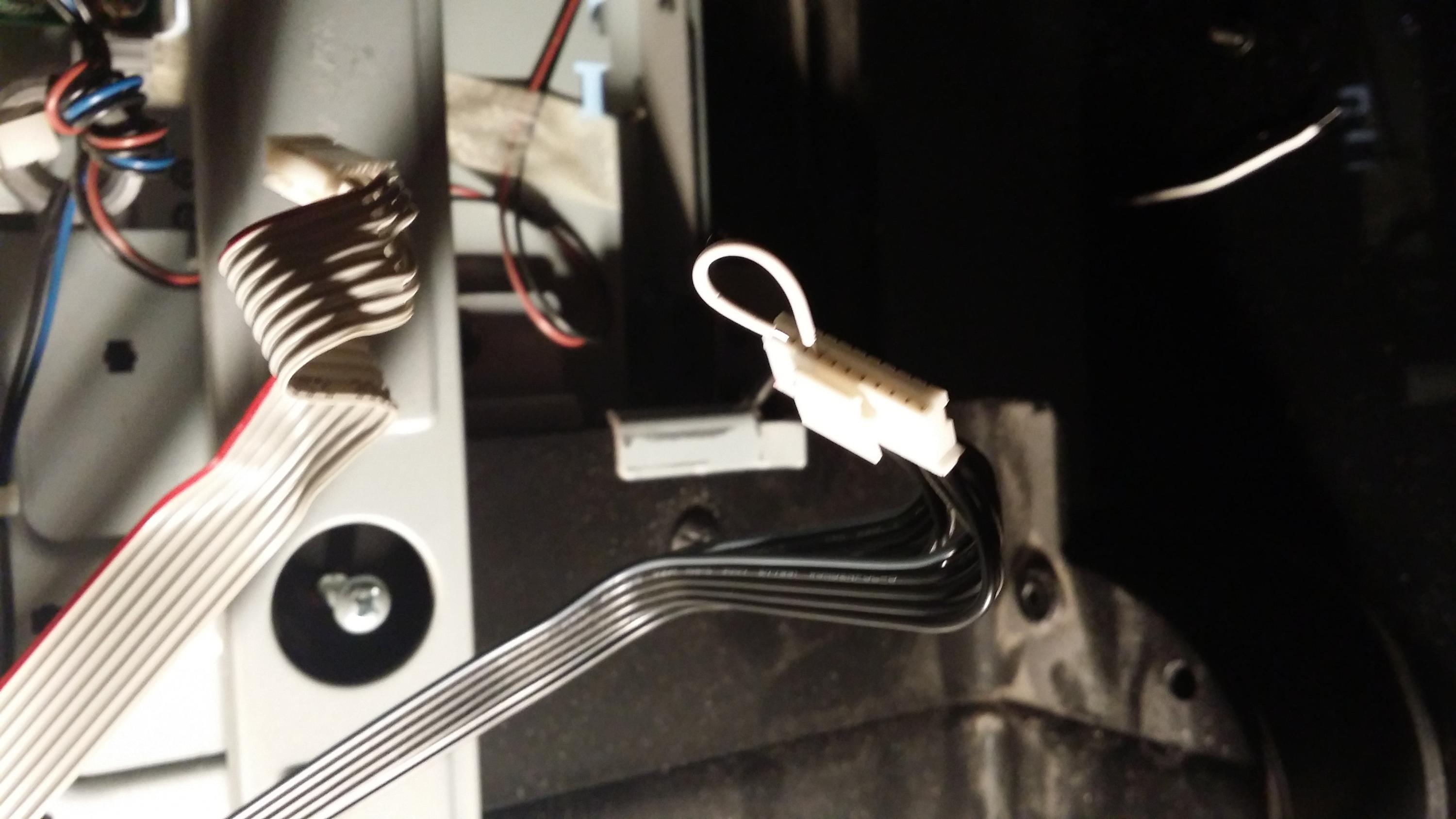

    If you unplug the IR board,does the 5volt come back up?
    Proud owner of dozens of broken TV's and many,many,many boards.
    Our website and passion:http://hollenhundshepherds.com/
    • beng3518
      • Jul 2014
      • 26
      Re: Philips 42" LCD TV 42PFL3603D/F7* changed SSB & T-Con Board won't turn on, help
      It does not, actually it read lower:
      9- Keyboard = 8.6 mv (this one reads lower too)
      8- +5v SW = 000.7 mv
      7- Keyboard = 1.4v

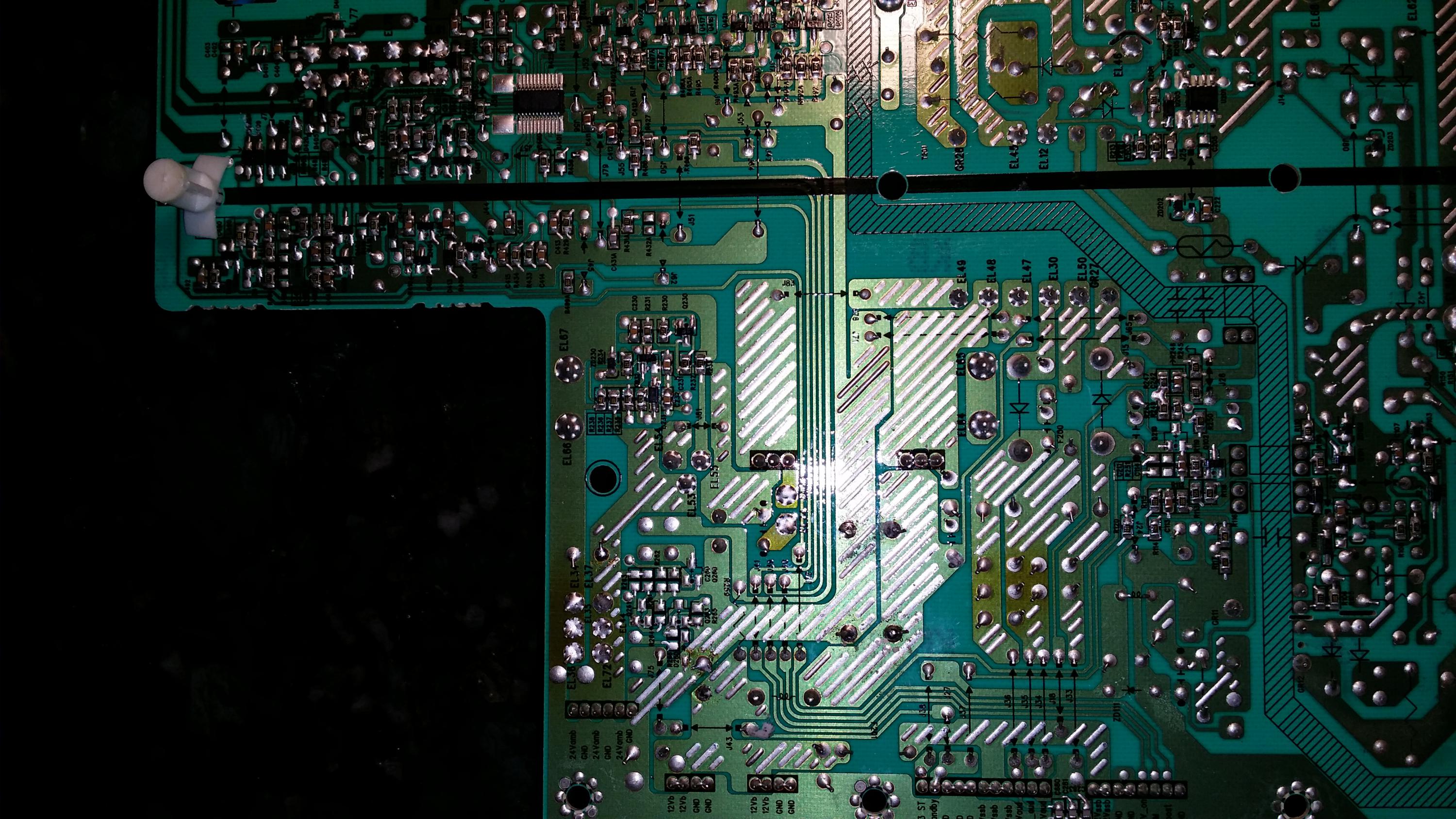

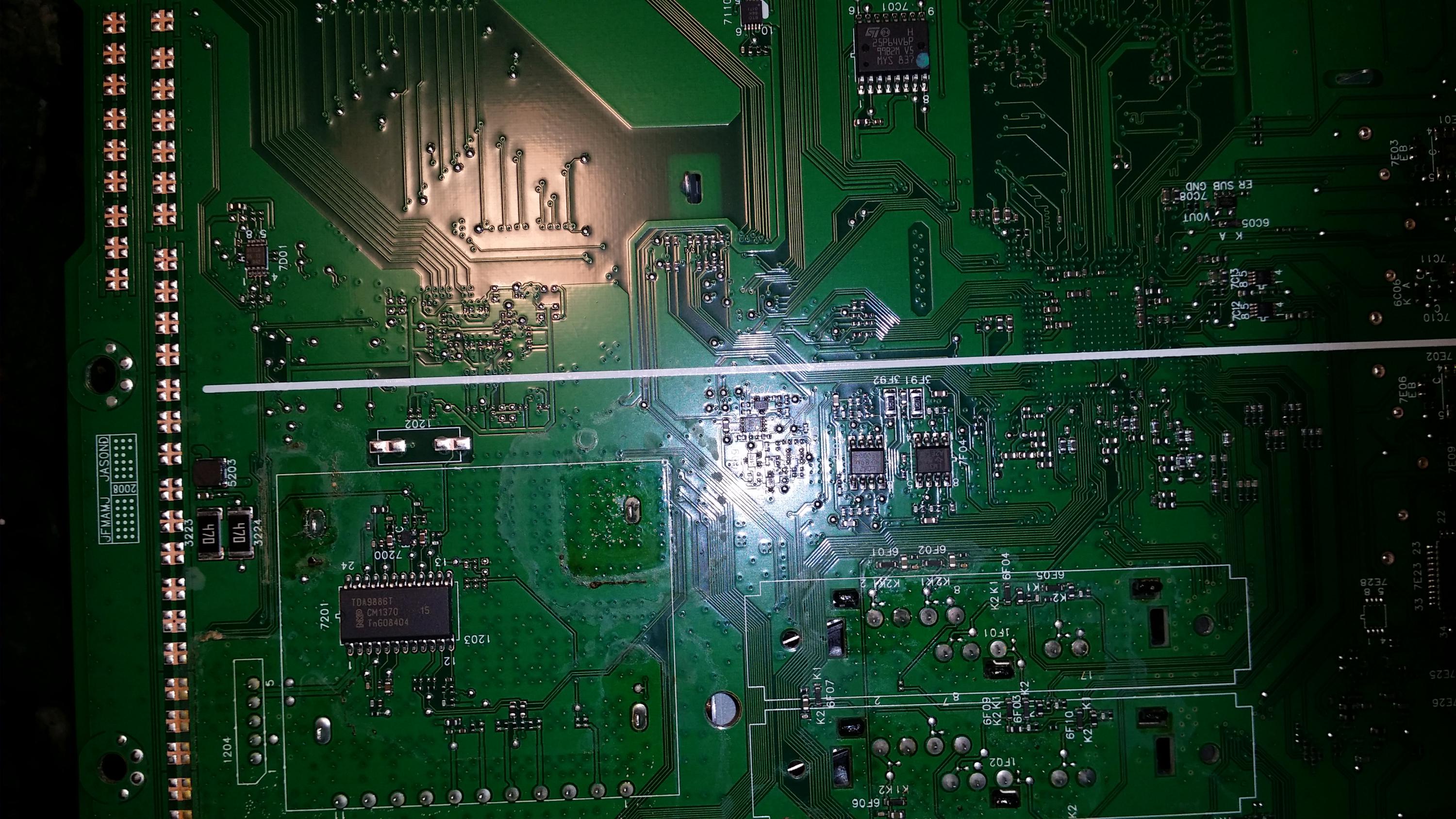

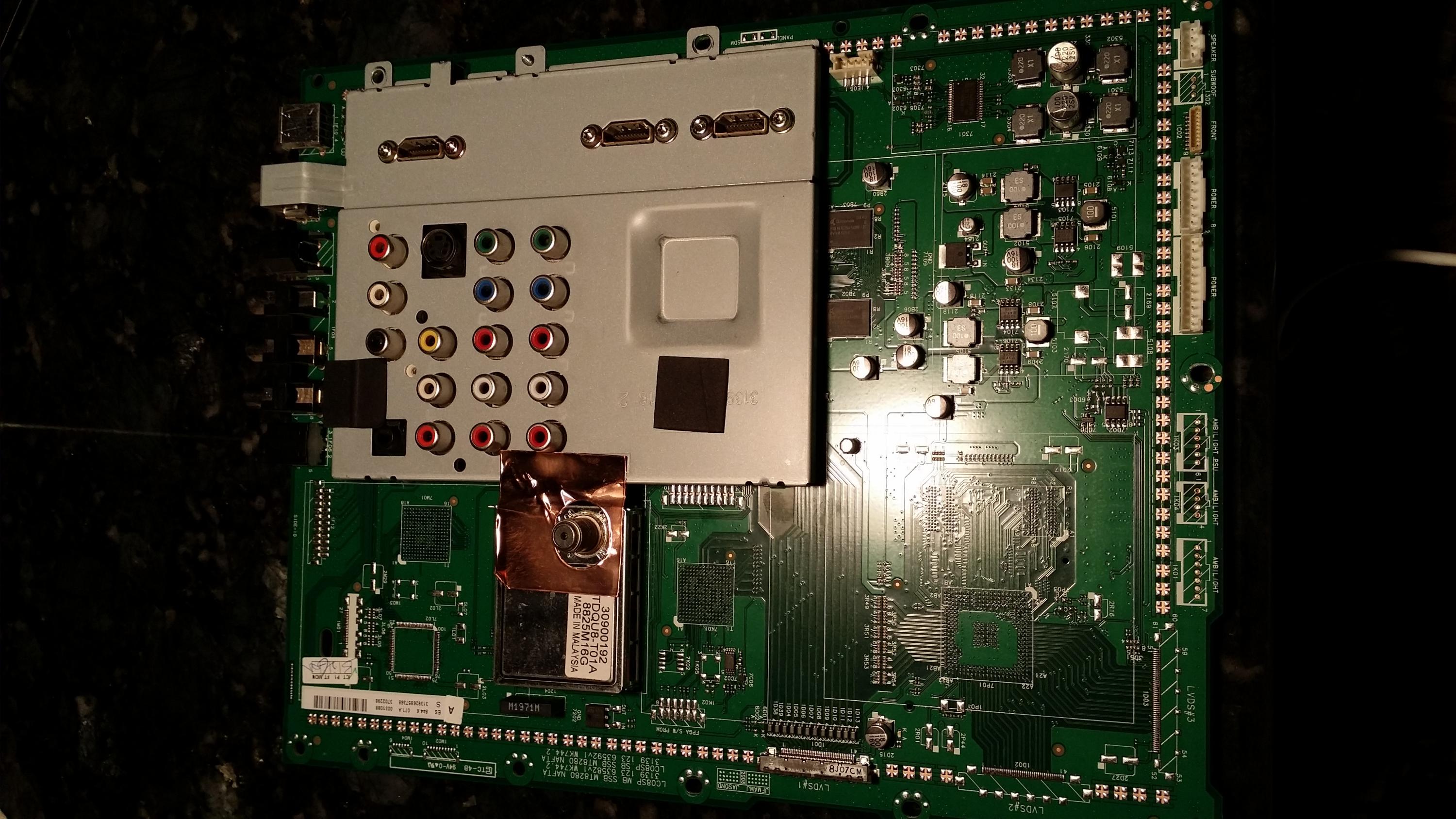

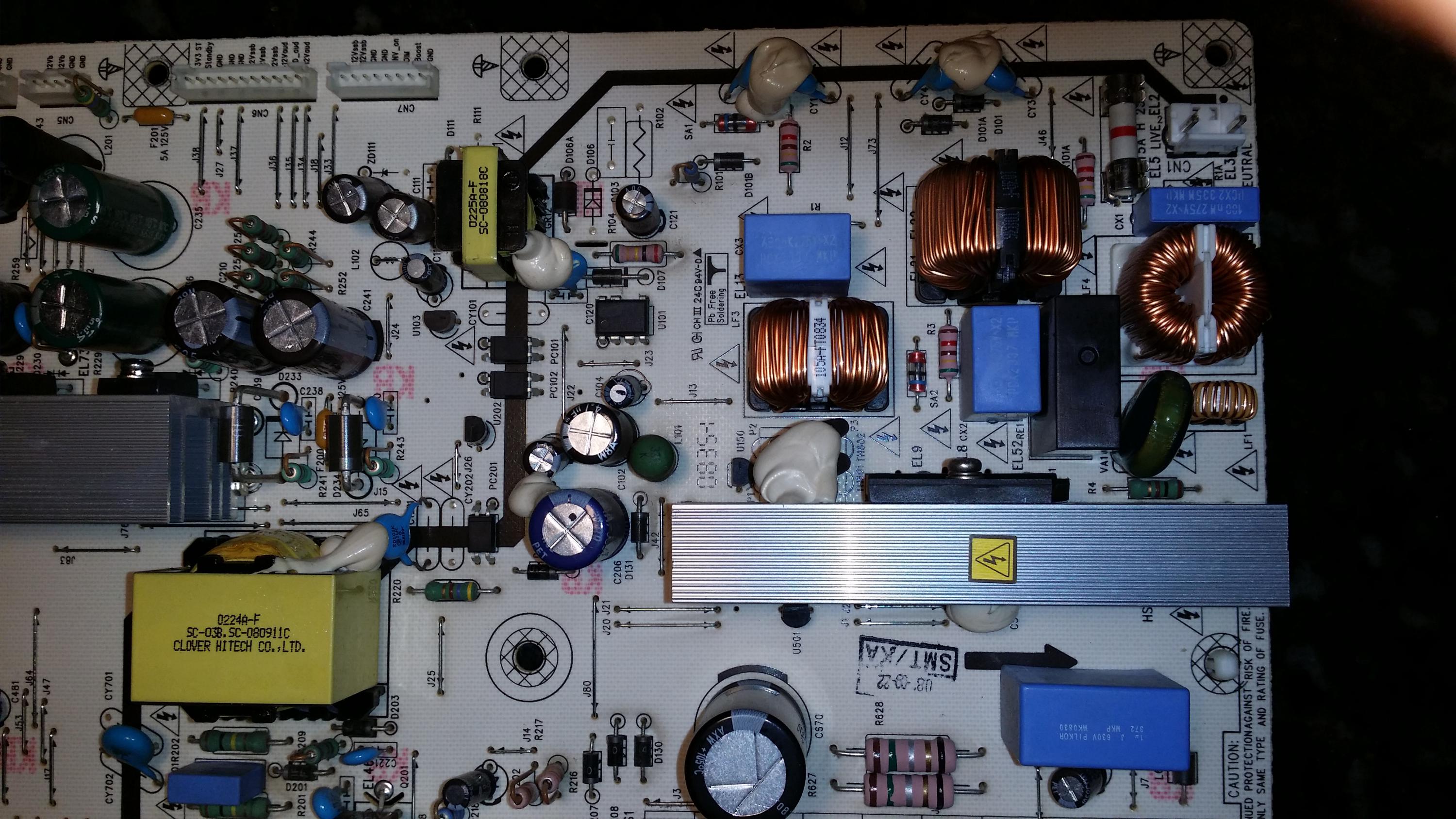

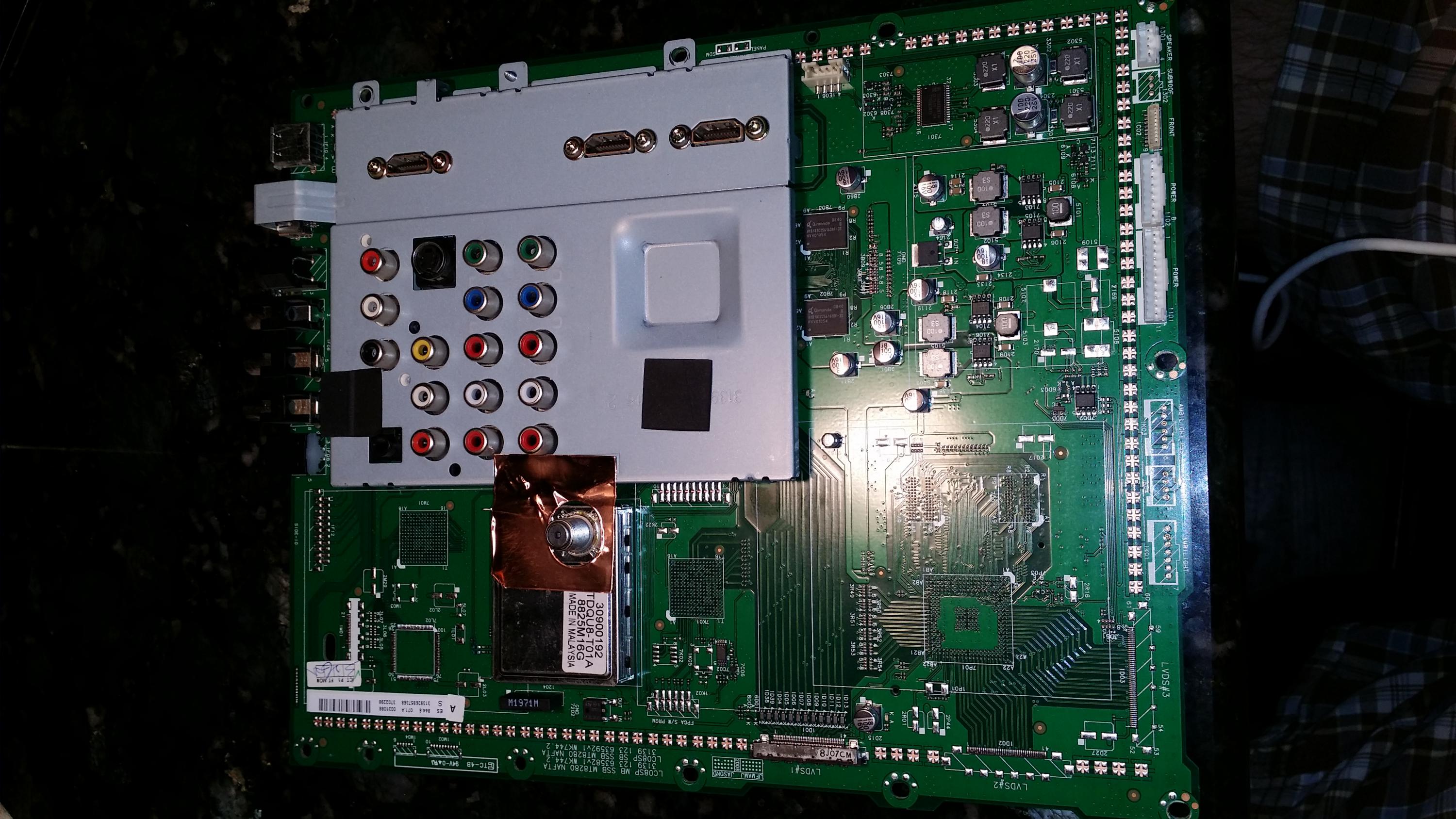

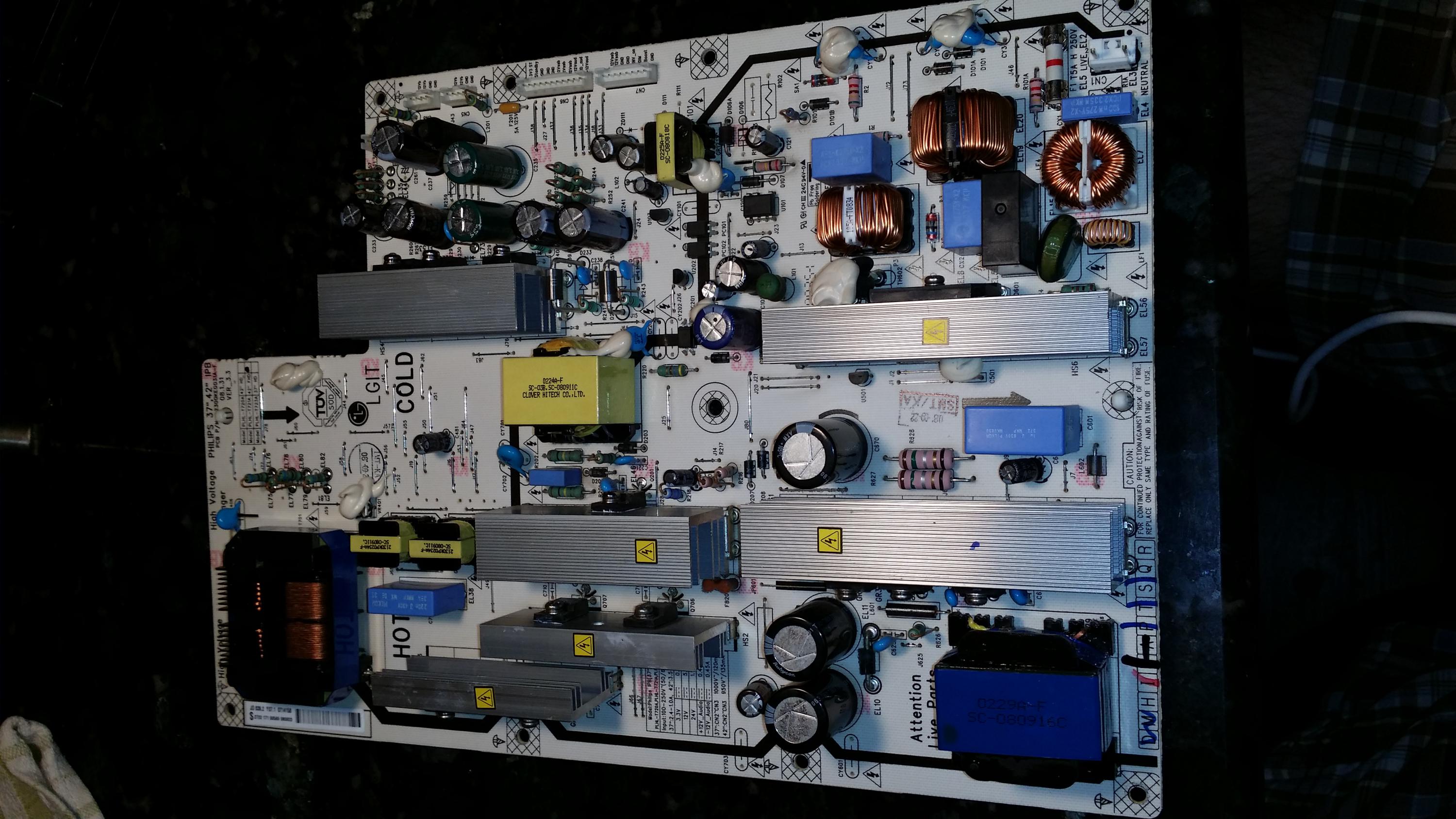

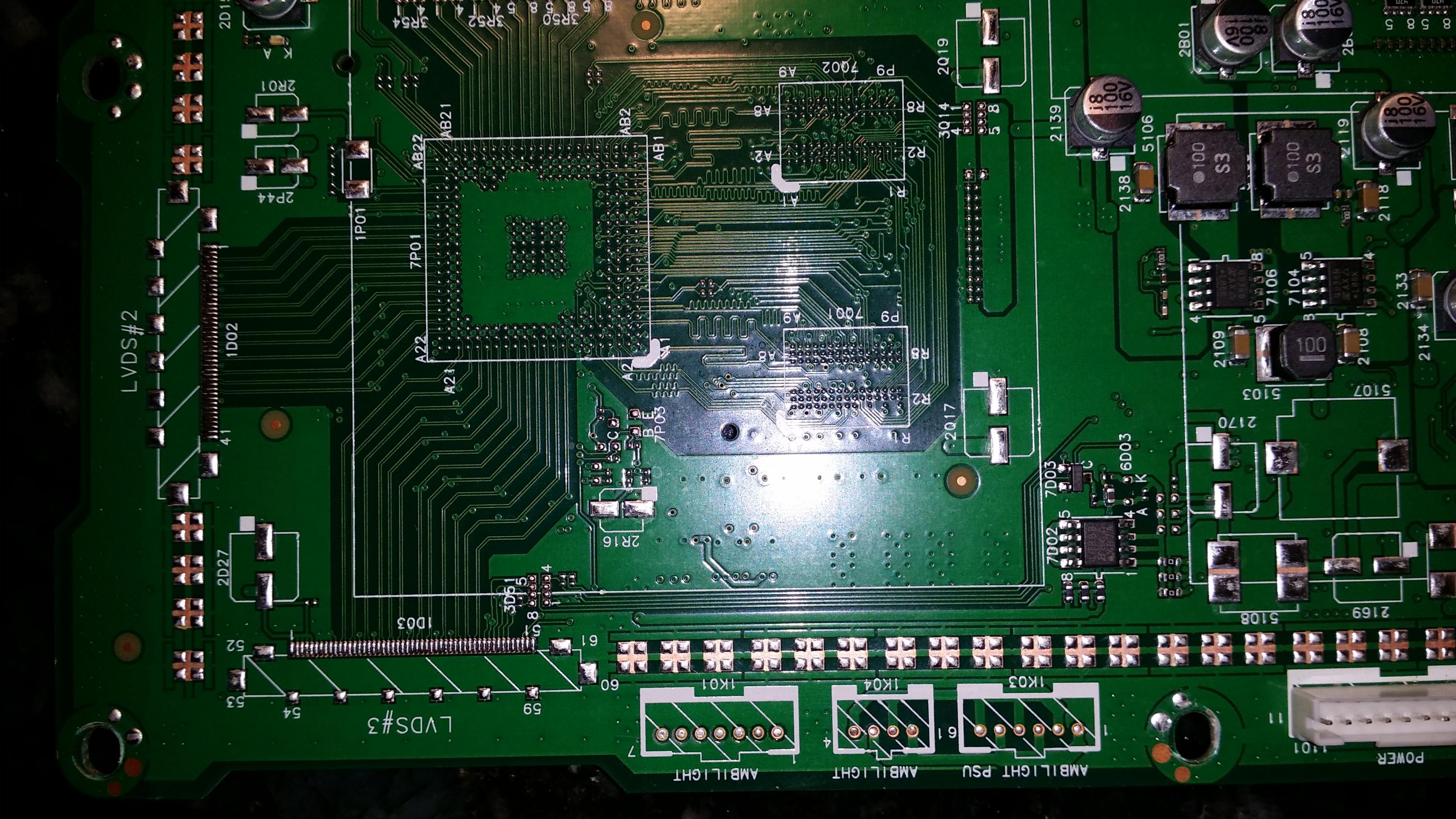

          Can we get a picture from the mainboard? Front and back ?

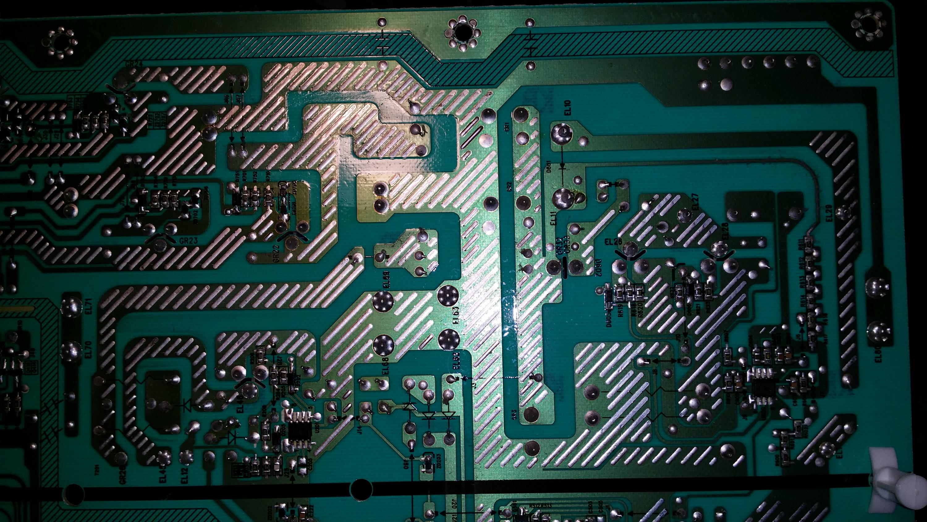

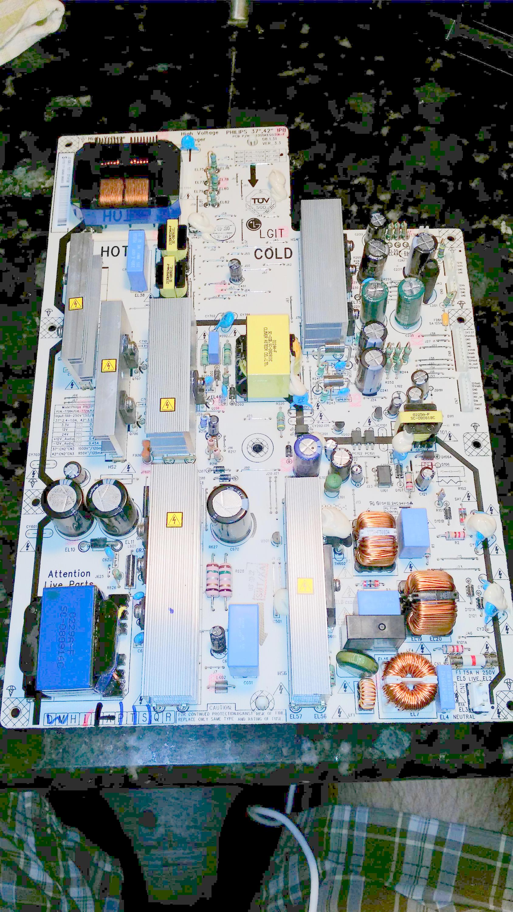

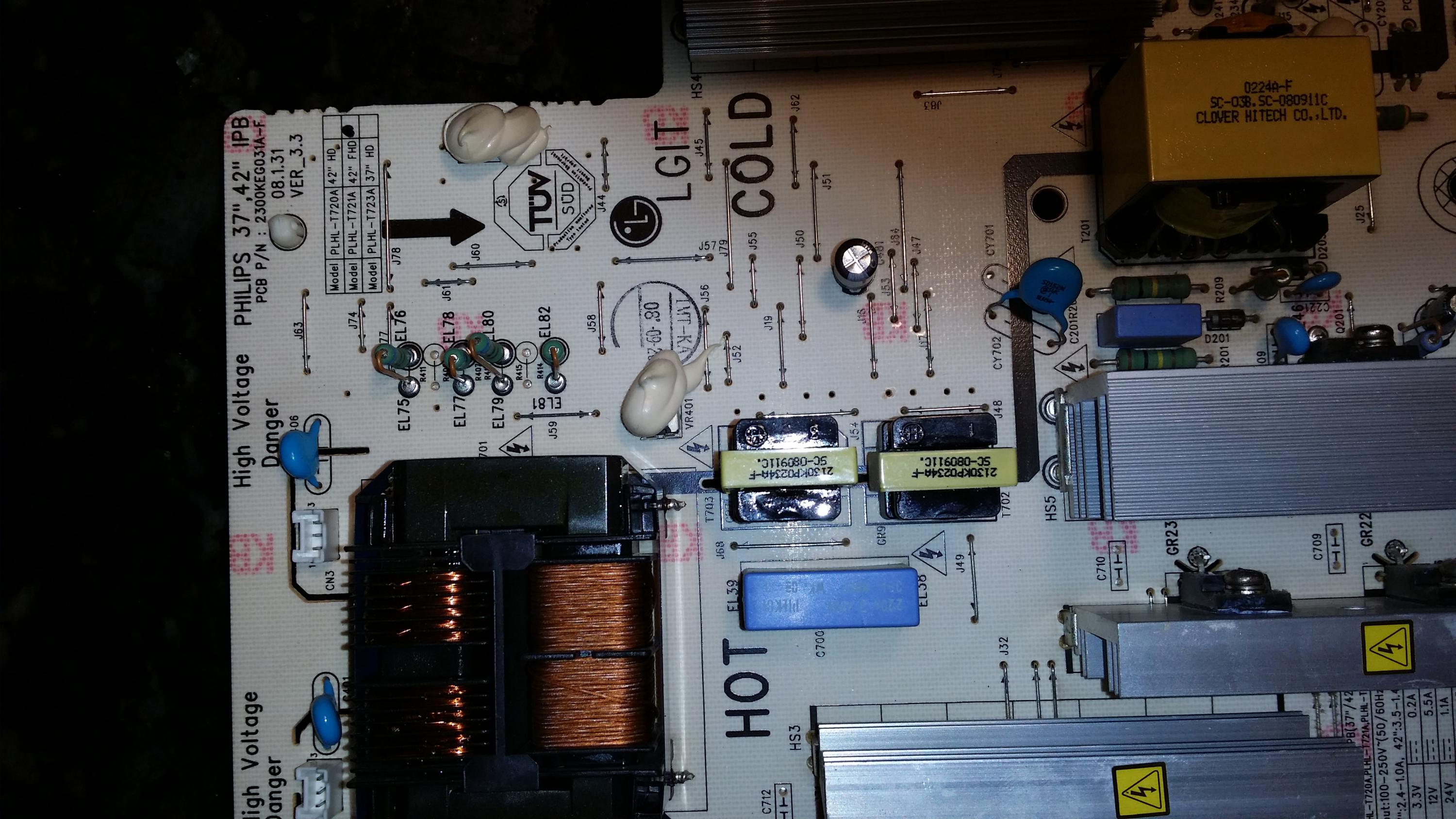

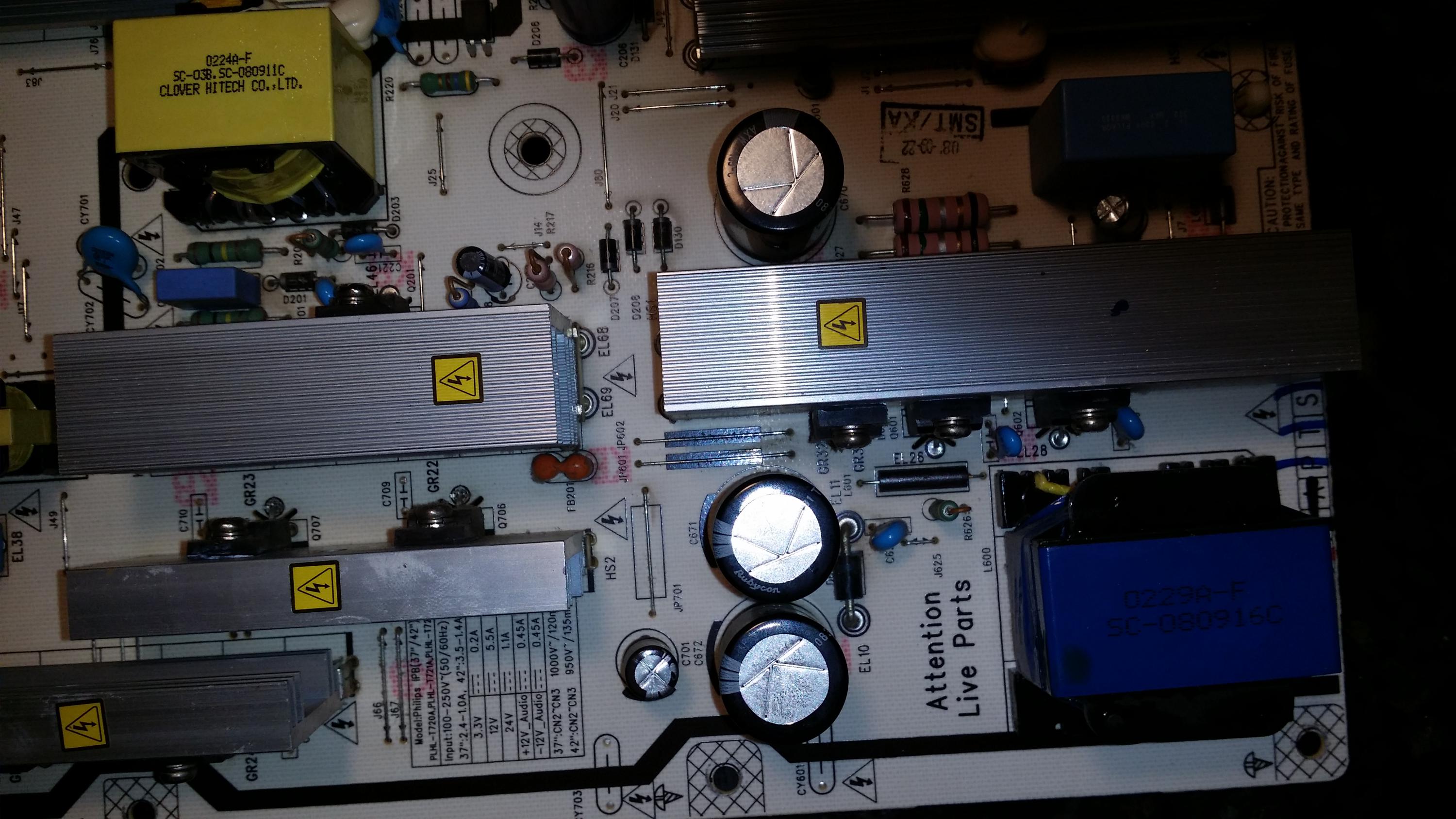

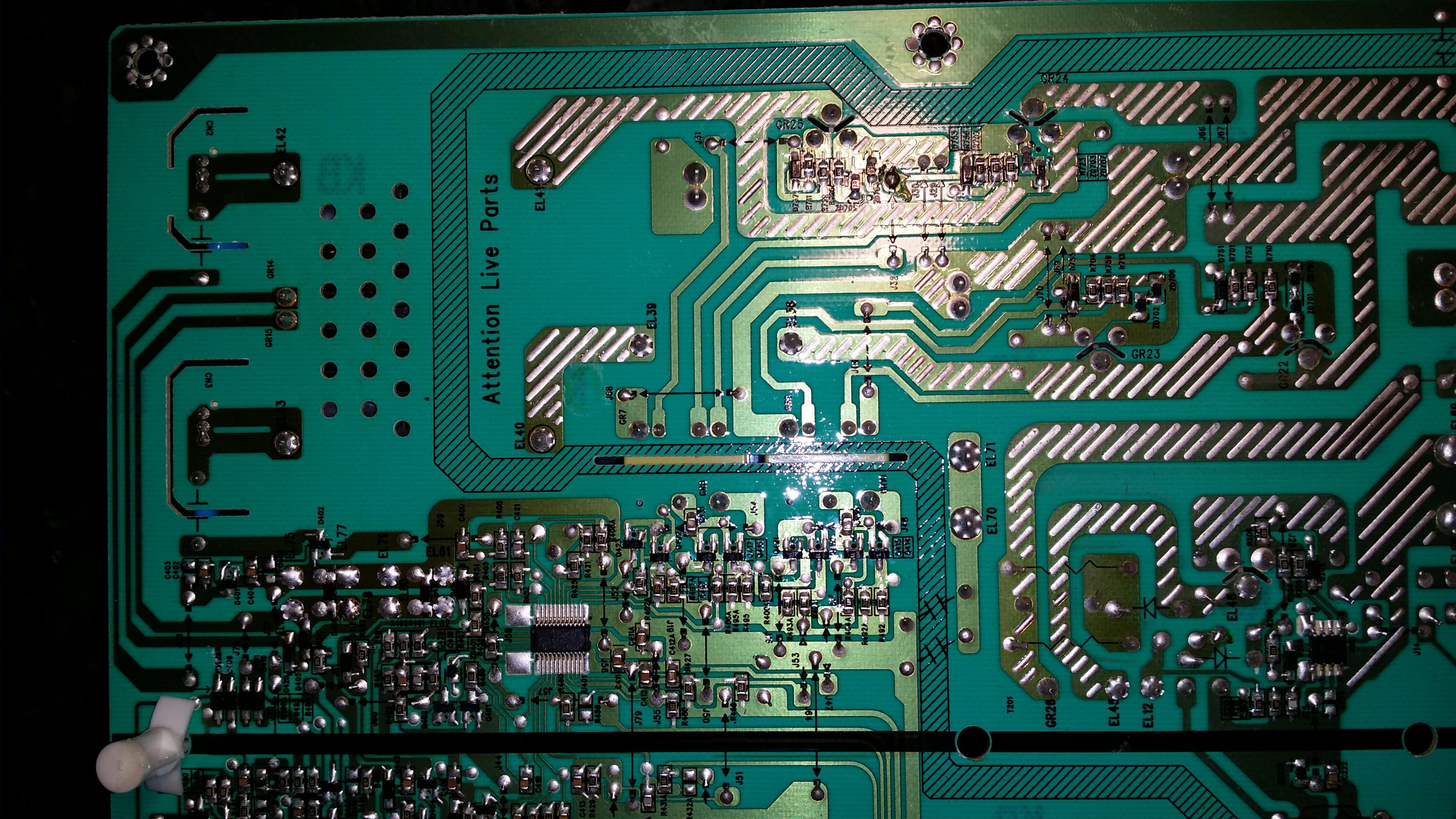

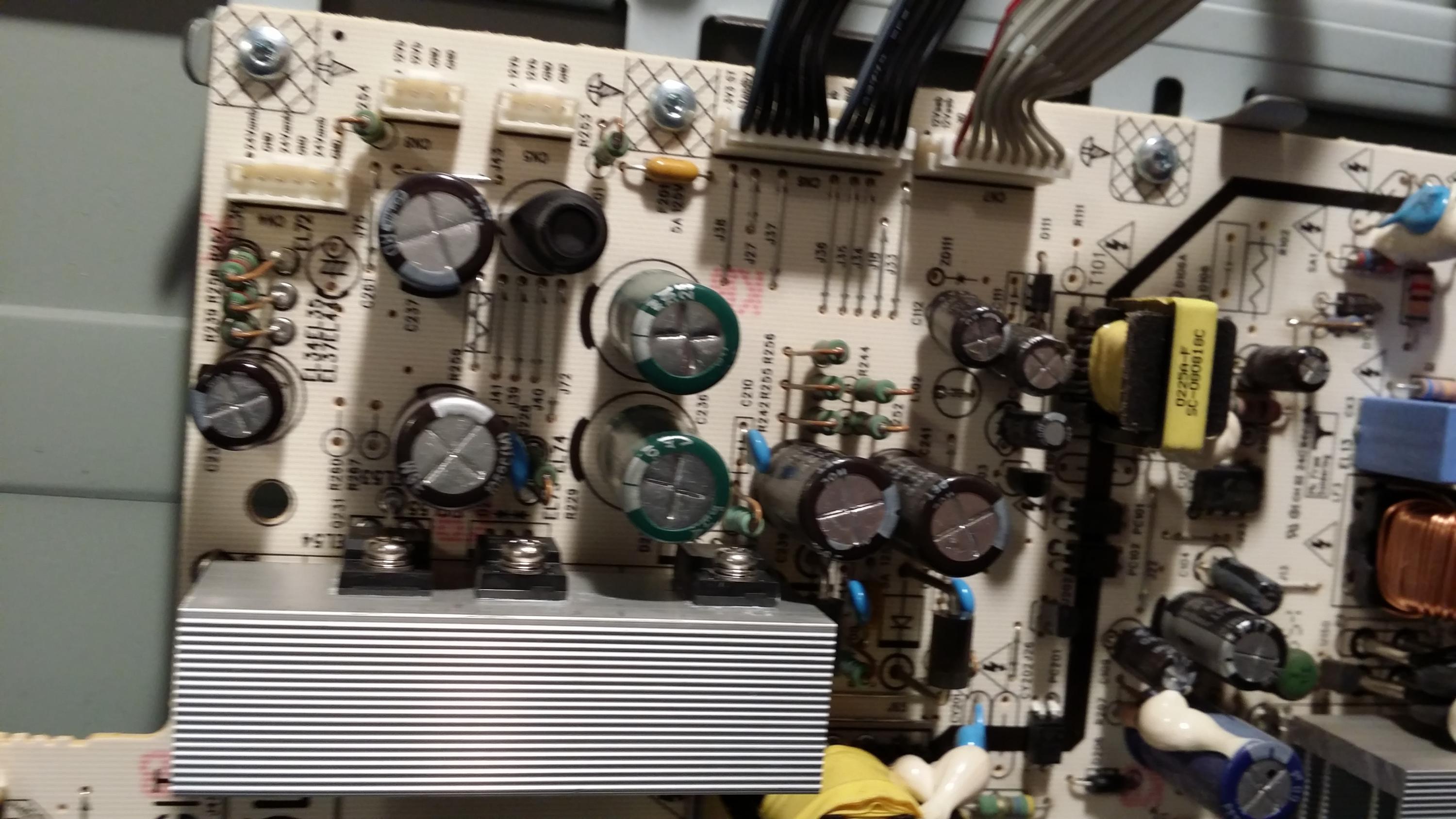

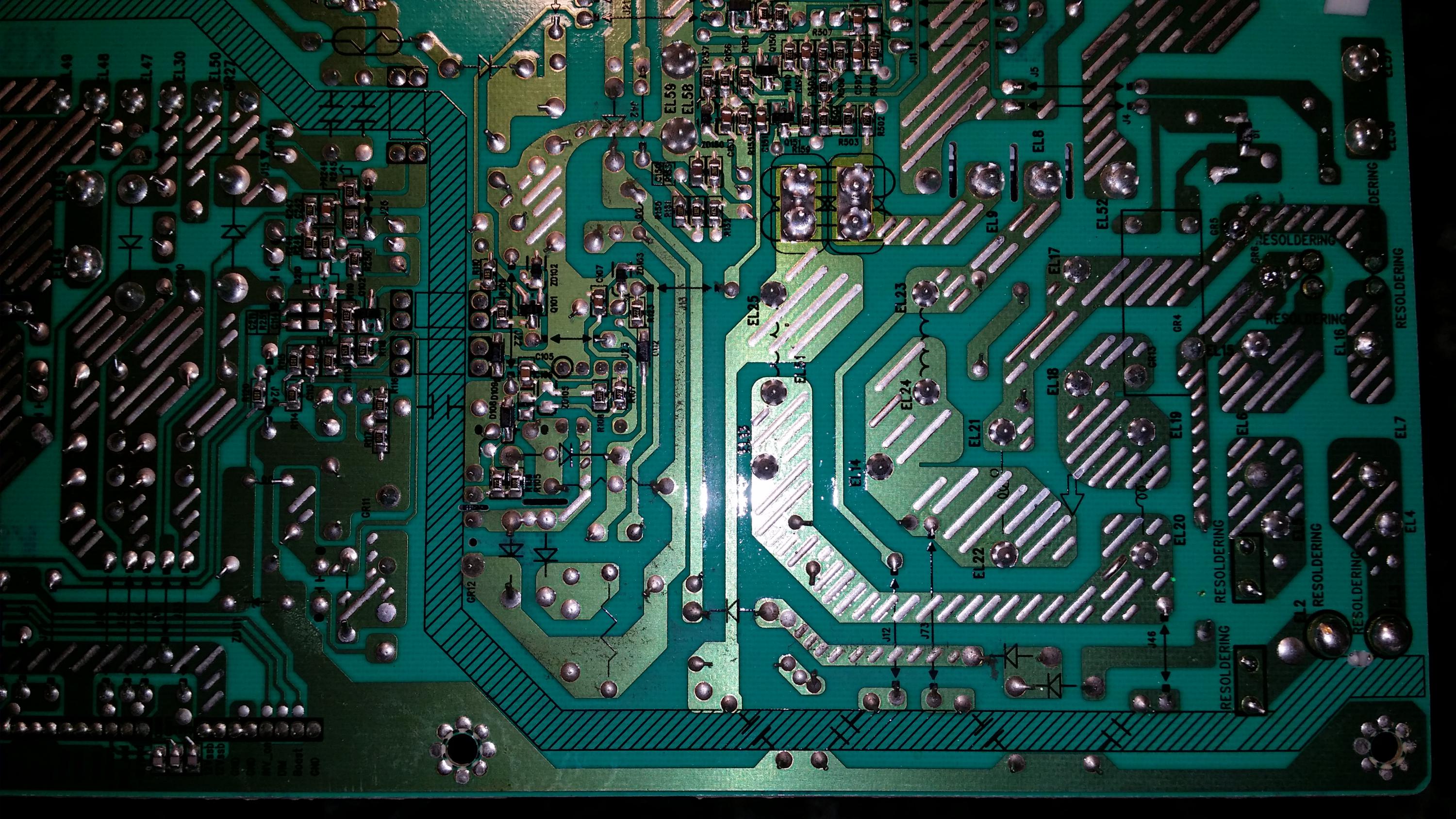

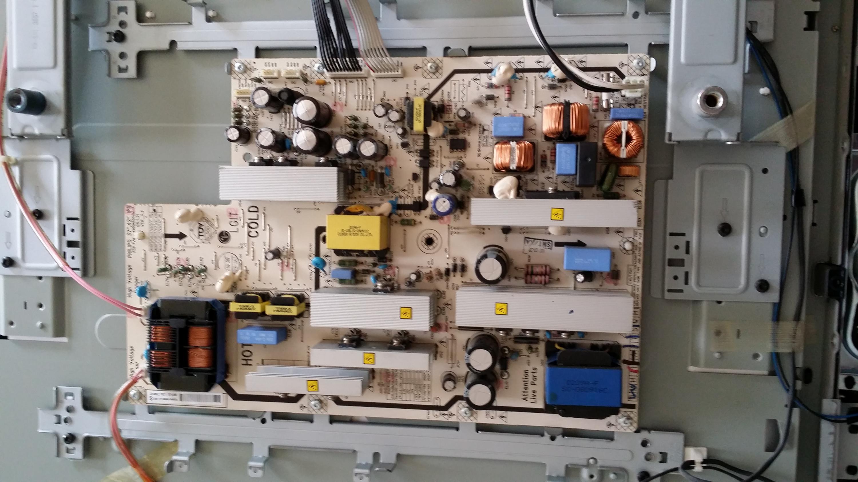

            It also needs to be in focus - can you re do the power supply picture front and back.
            Have you tested that small yellow fuse (think its a fuse can barely see it) near the connector

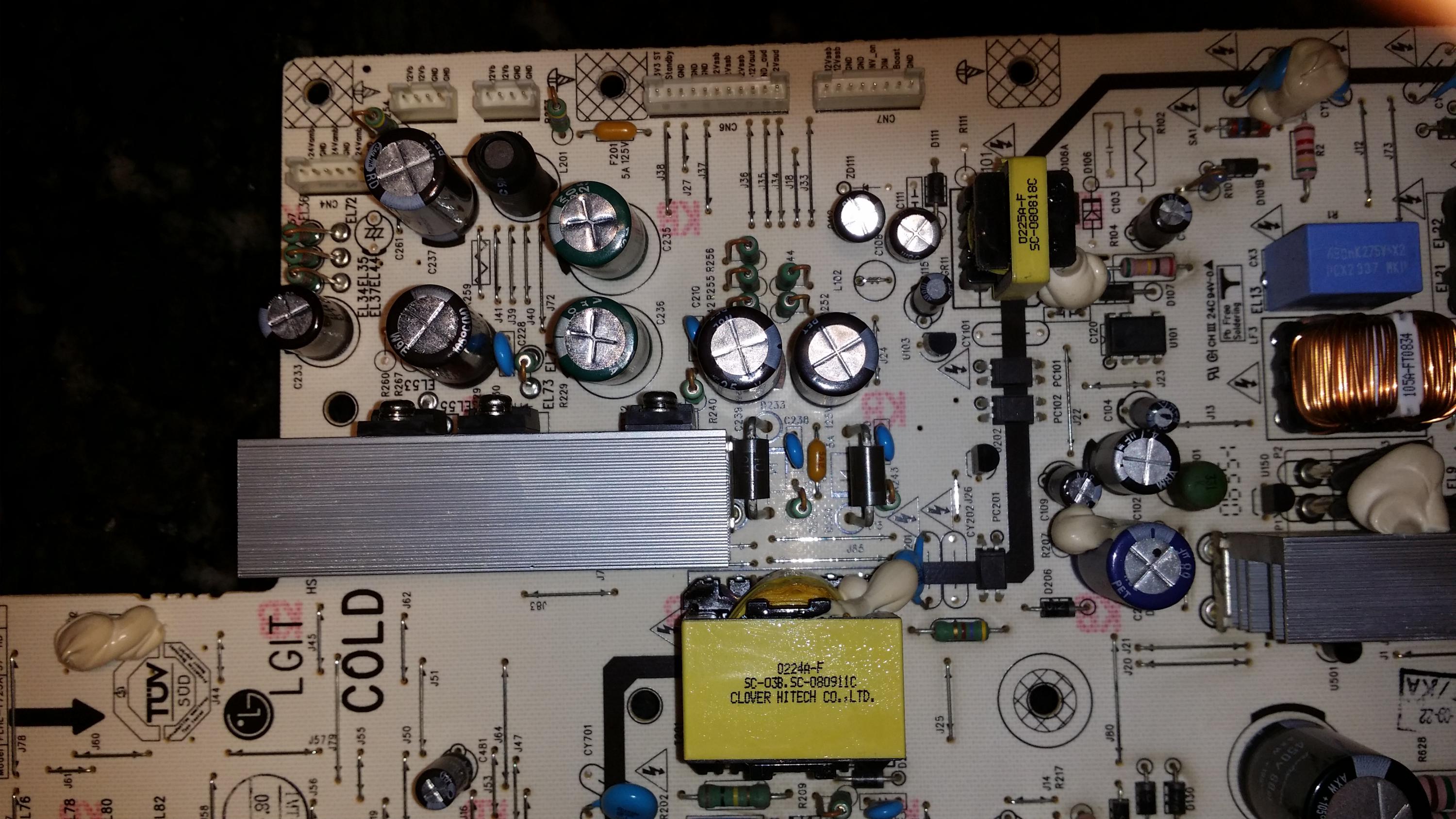

              Here are the pictures from the PSU

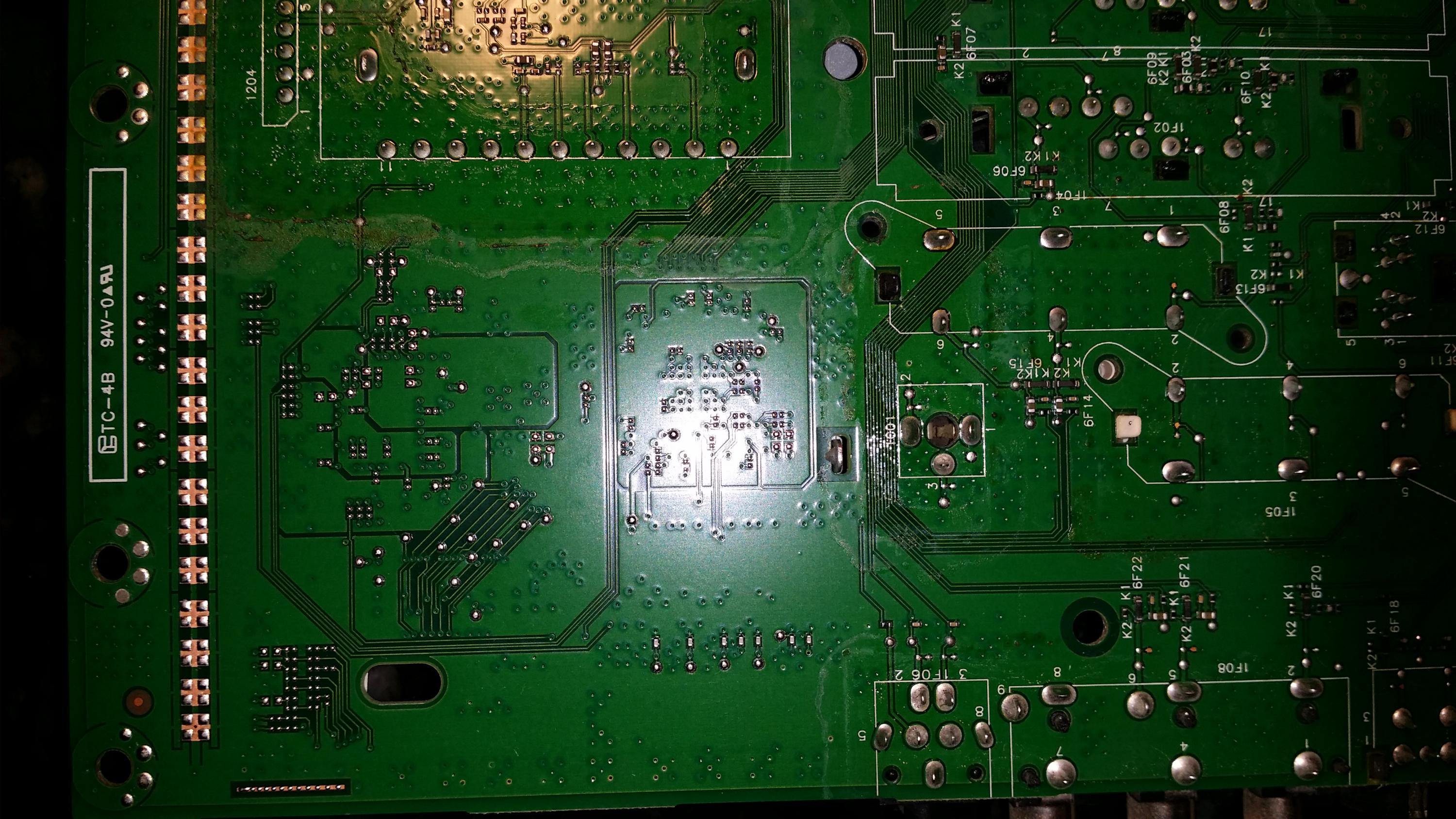

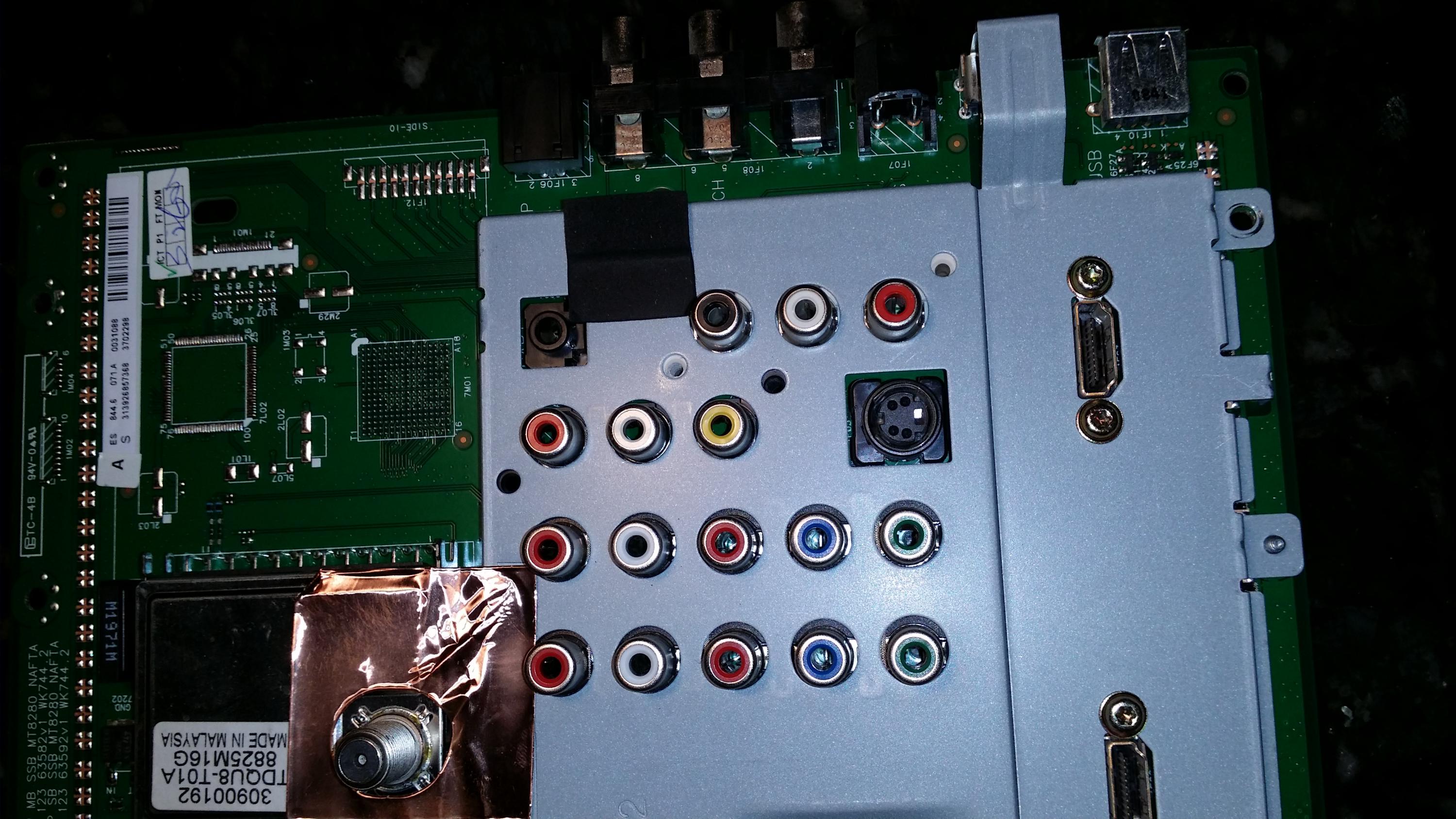

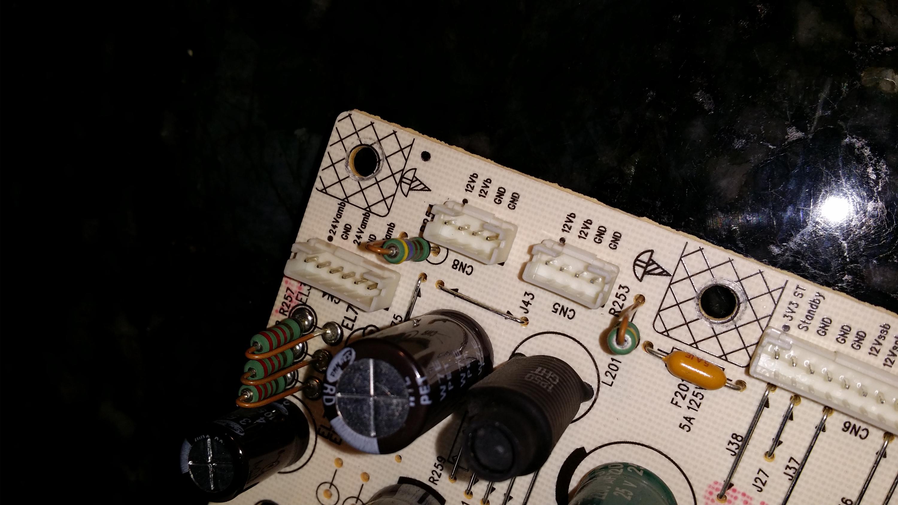

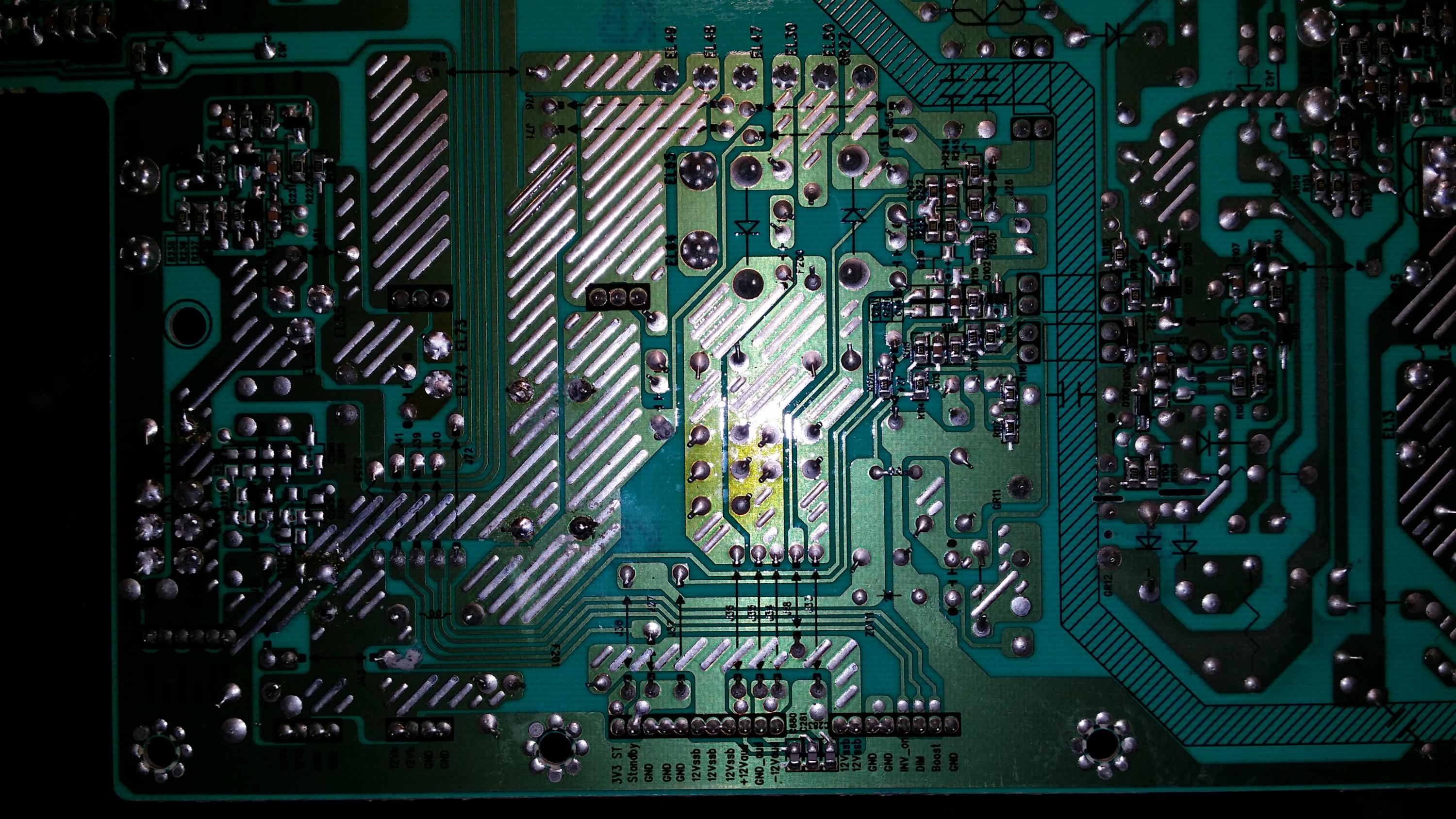

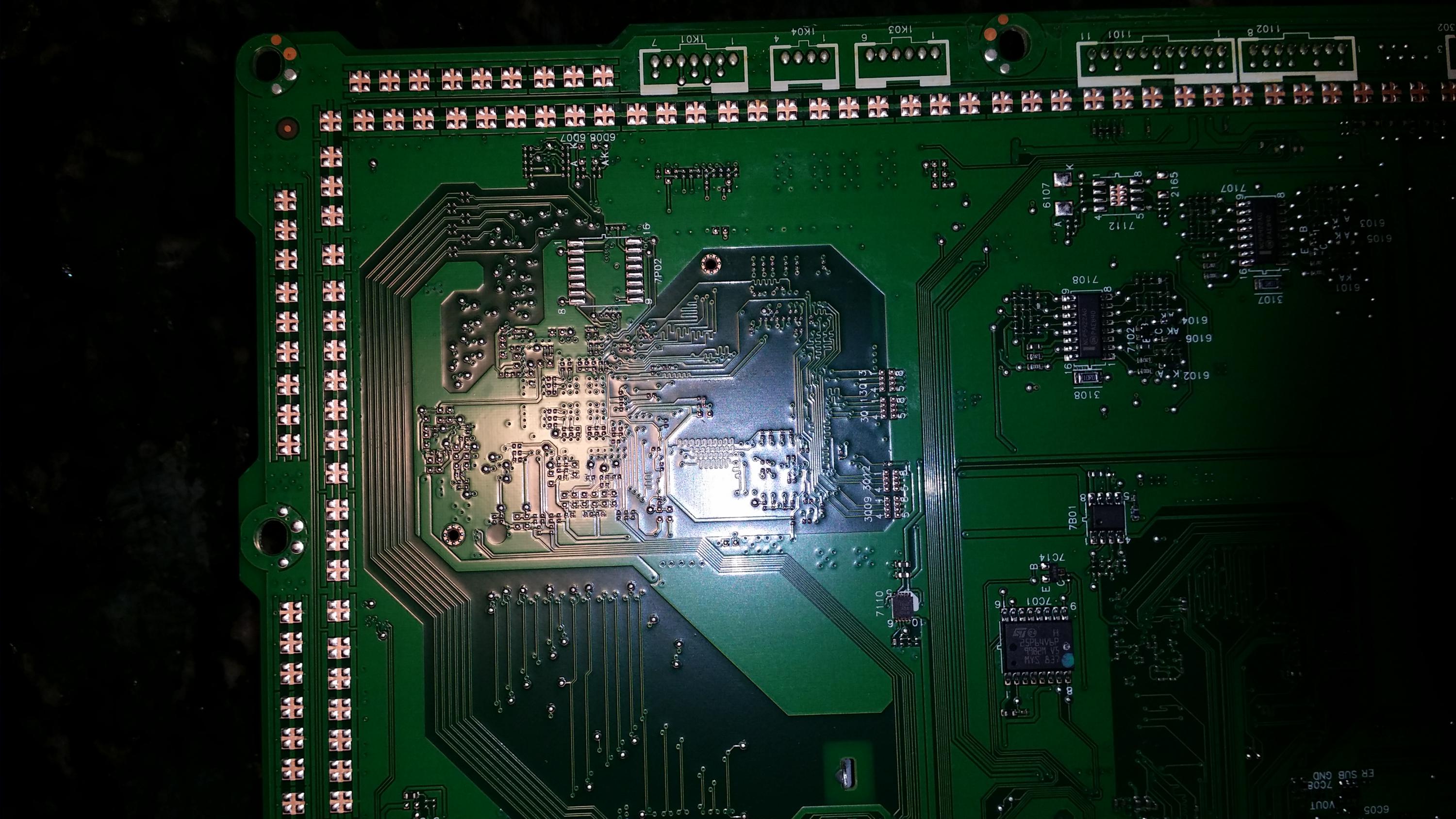

                  So 2 small fuses F200 F201 - are they good. Also that group of resistors near the
                  connector looks to be hot - maybe the light but joints look ringed - perhaps you should reflow those.

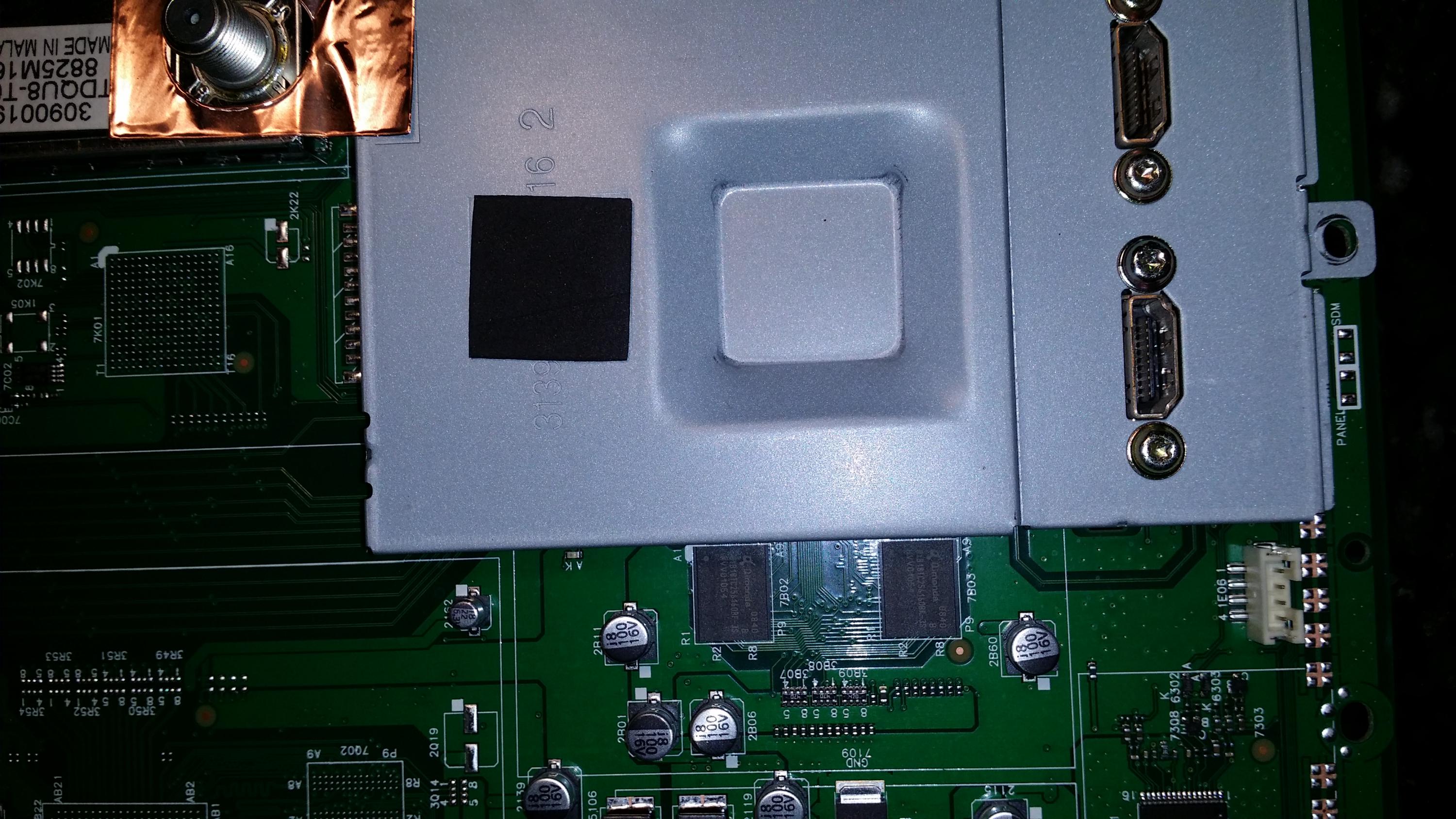

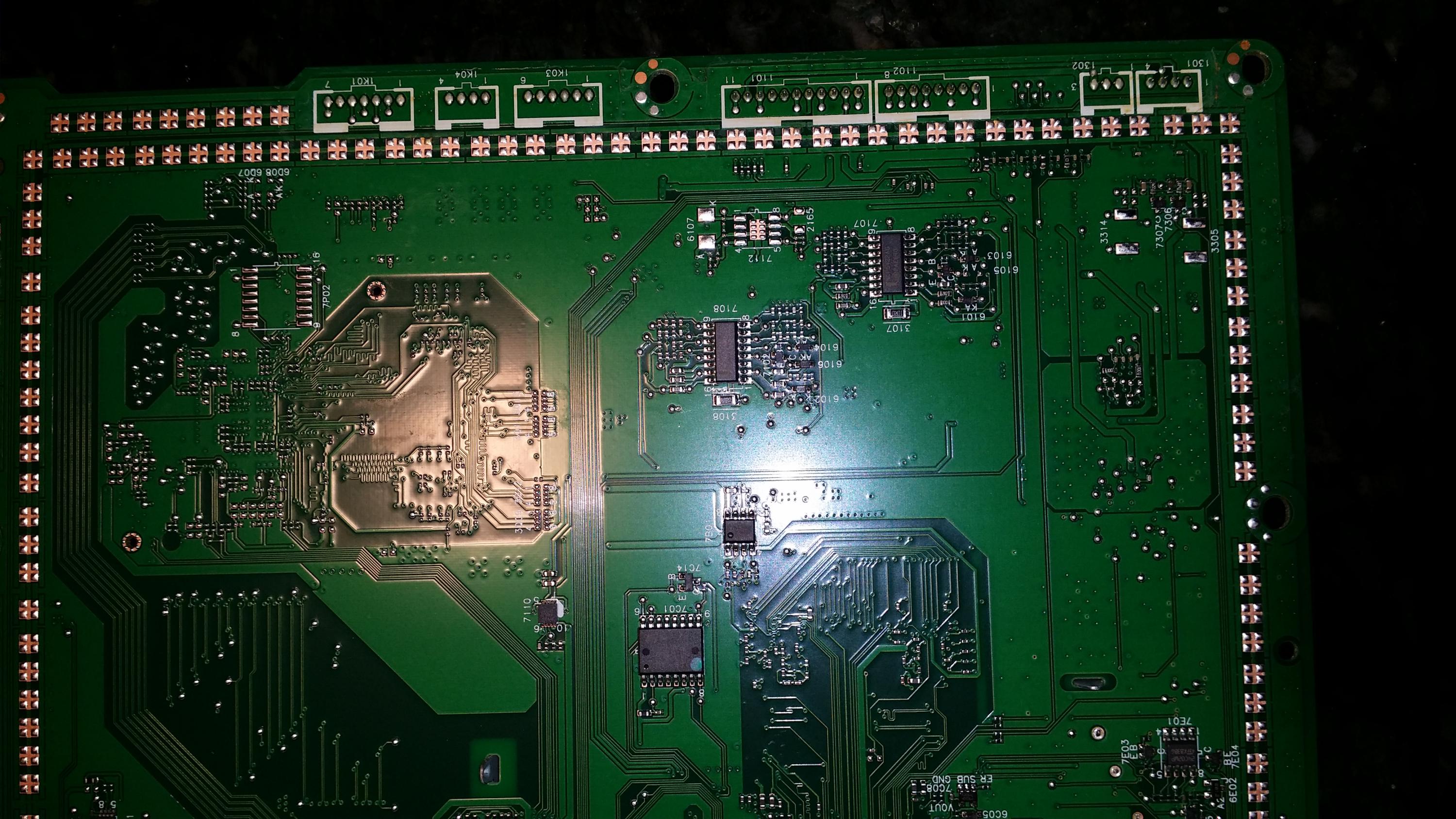

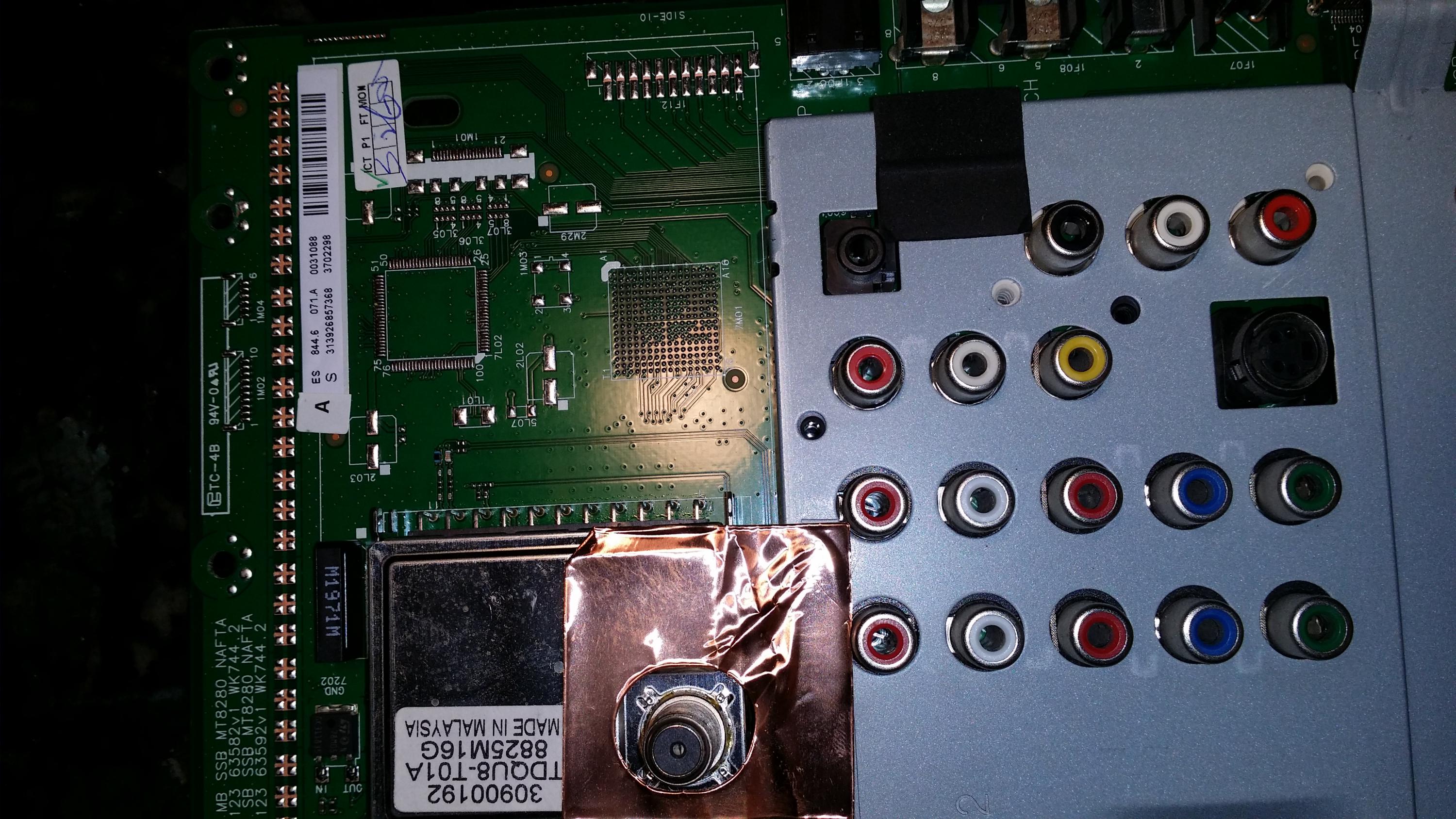

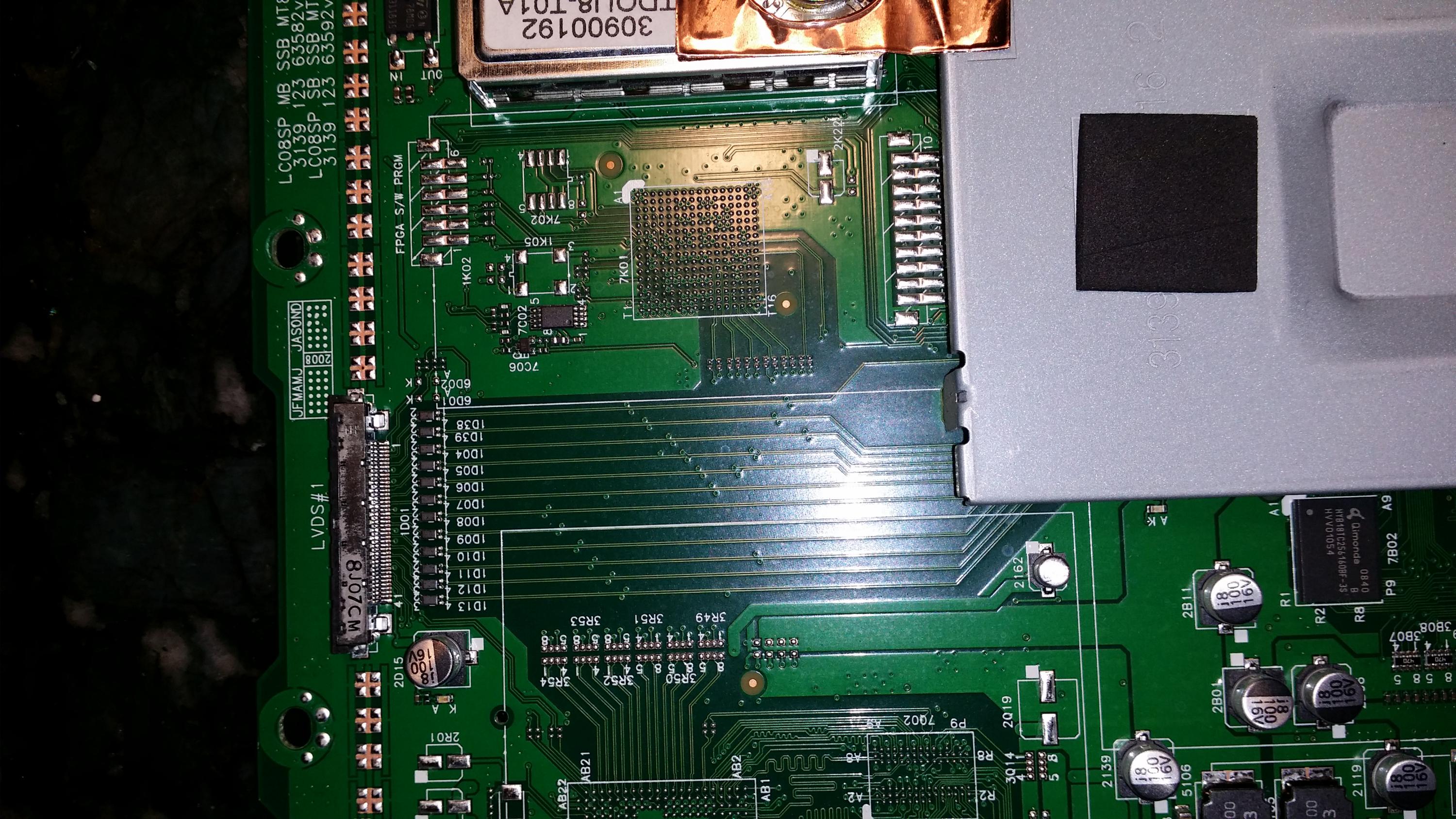

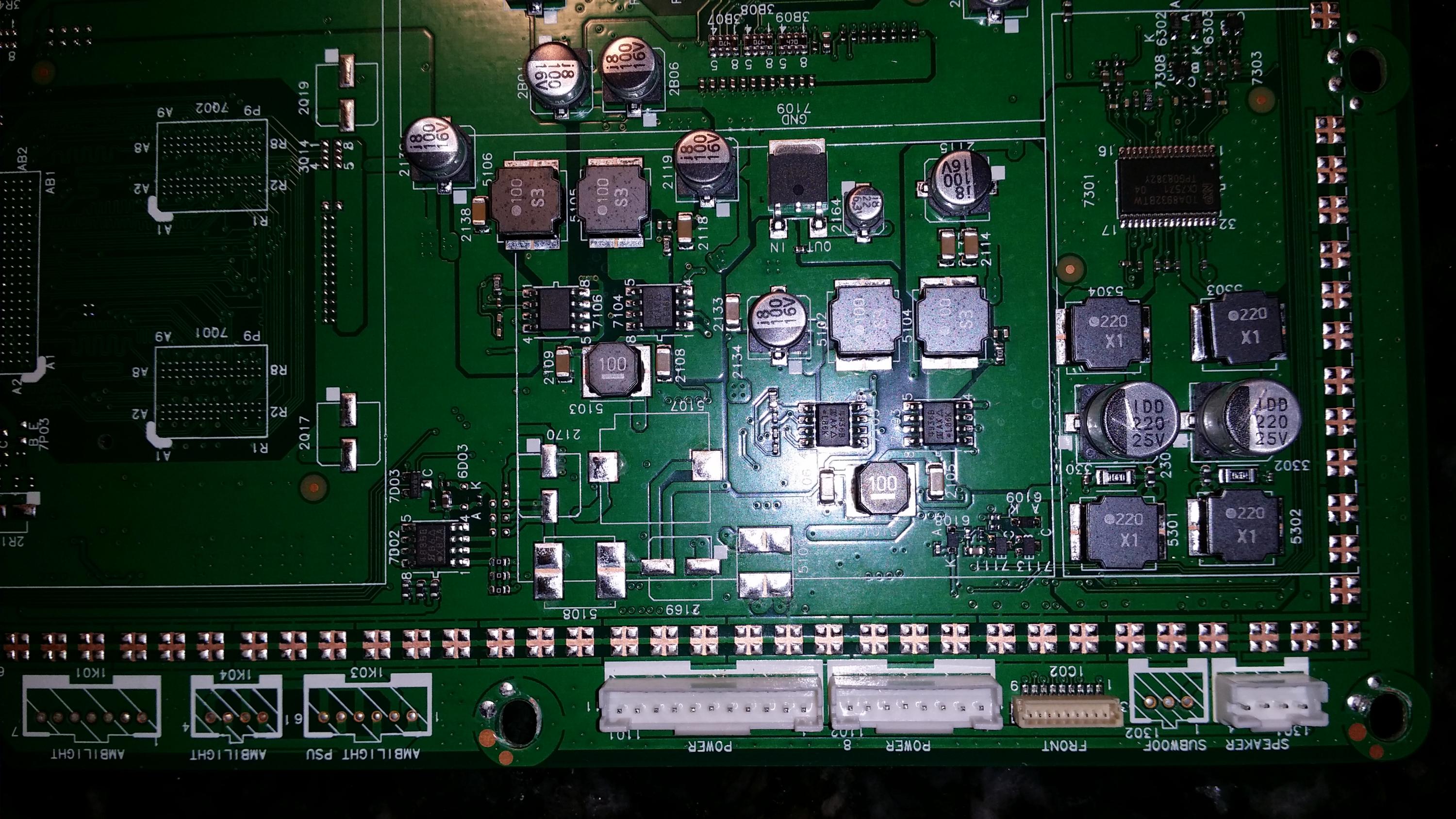

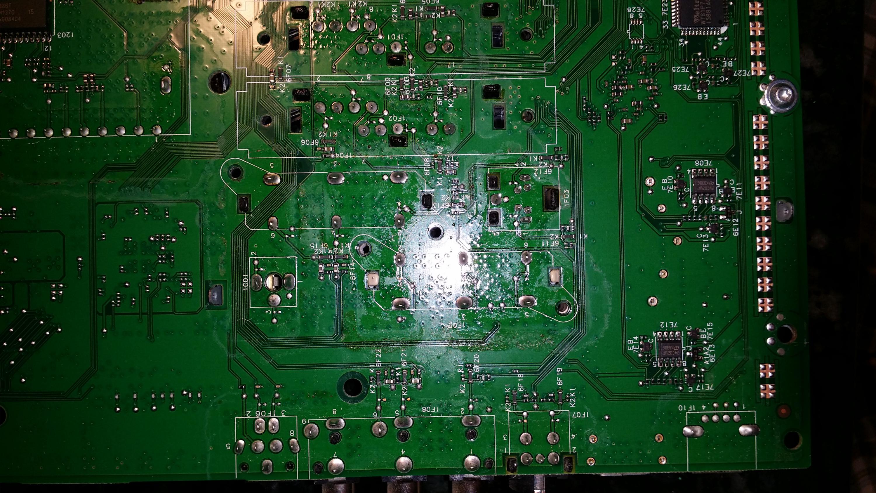

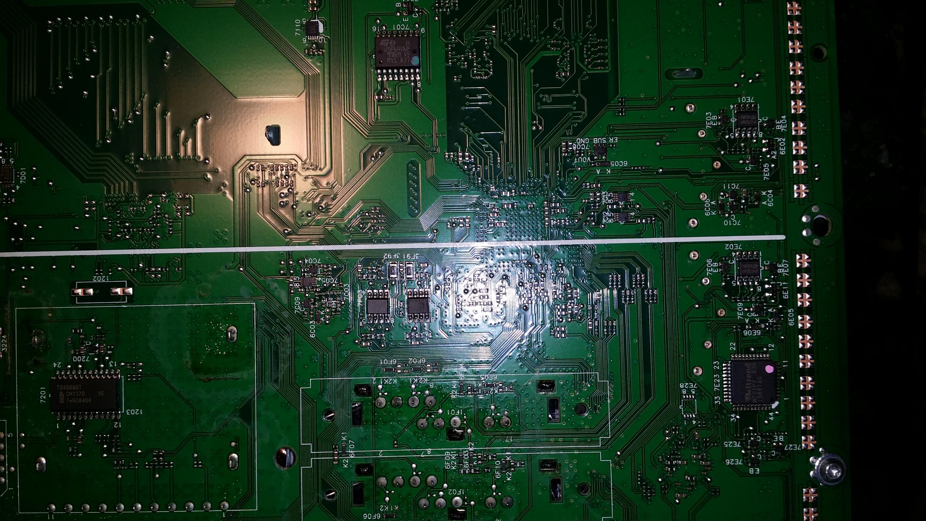

                    Here are the pictures from the SSB:
                    • beng3518
                      • Jul 2014
                      • 26
                      How do I check the small fuses? Continuity? If yes; they are good
                      and which resistors? Pic 1 or 2?
                        White the boards are out can you do a pic of each showing the full board.
                        • selldoor
                          Slow Learner
                          • Dec 2010
                          • 7870
                          Continuity is ok but ohms are better. Oddly enough we have had cases where fuses give a continuity beep but were actually blown.
                          I was meaning Pic 2 if you look at them closely you may find they are ok.
                          Pictures sometimes have shadows that make things look worse than they are.
                          I didnt get drawn to pic 1 perhaps as they are on the side of the board
                          there is less light. Usually recommend daylight rather than flash.
                            Like this?

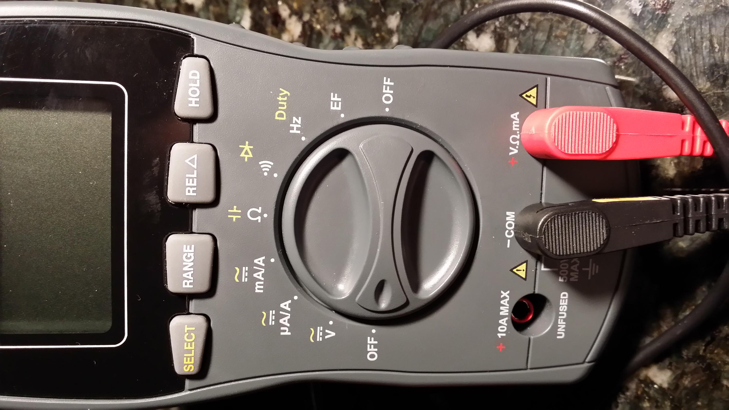

                              How do I check ohms?

                                Sorry as your first post was so good I didnt realise you lack experience
                                Upside down horseshoe / Omega symbol is to test ohms.
                                Two simple rules -- Measure voltage with nachine plugged in and turned on (usually when asked)
                                Measure Resistance -- Voltage off and machine unplugged.
                                (so for ohms tests boards do not need to be connected or powered)
                                Perhaps read this :https://www.badcaps.net/forum/showthread.php?t=10419
                                start at post 19 lots of tests you can do most without power to the board.
                                If the voltages ARE correct then there is agood chance that the power supply is ok
                                BUT sometimes they can read good but then when a load is applied (eg lamps come on)
                                it hasnt got enough umphh to power them.
                                First test we often ask is on the BIG capacitor. But you need to be very careful
                                working on a non conductive surface meter on volts you power up Just the power board
                                and check the voltage (DC) on the BIG Capacitor it may be 300-400 volts.
                                We also ask if that is maintains steady for 5-10 seconds
                                Use a RCD if you have one.
                                If you dont want to do that the next test is initially with just the power supply
                                check the voltage on each socket -post the results like
                                CN7
                                Pin1...12v.... 11.99
                                Pin2...12v.... 13.72
                                and so on
                                Do this for each connector.
                                Actually I dont see the connector with 24v on where is that?
                                Then you do it again with the other boards connected.
                                I see you did the jump start test so as the lamps lit ( did they stay on for a minute or two?) the board should be good. The pins we are interest in are the BLON and Power on. As of they do not get a signal voltage when the machine is switched on
                                it is likely to be a main board fault.
                                Another test is to have it all connected then diconnect the lvds cable from the main to the Tcon and see if that aloows the lights to come on ( You may have doen that already?)
                                Well thats enough to be going on with -you will think I have gone awol

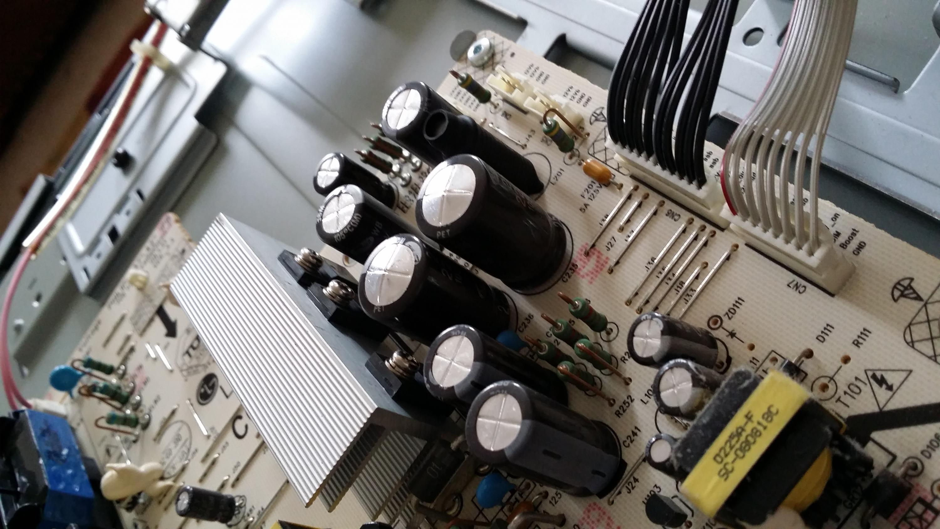

                                    you only replace two bad caps, when its known that the other caps could be failing too.Even if they are not swallowing on the top. I will replace all filtering caps on this power supply. Where did you get the two replacement caps?
