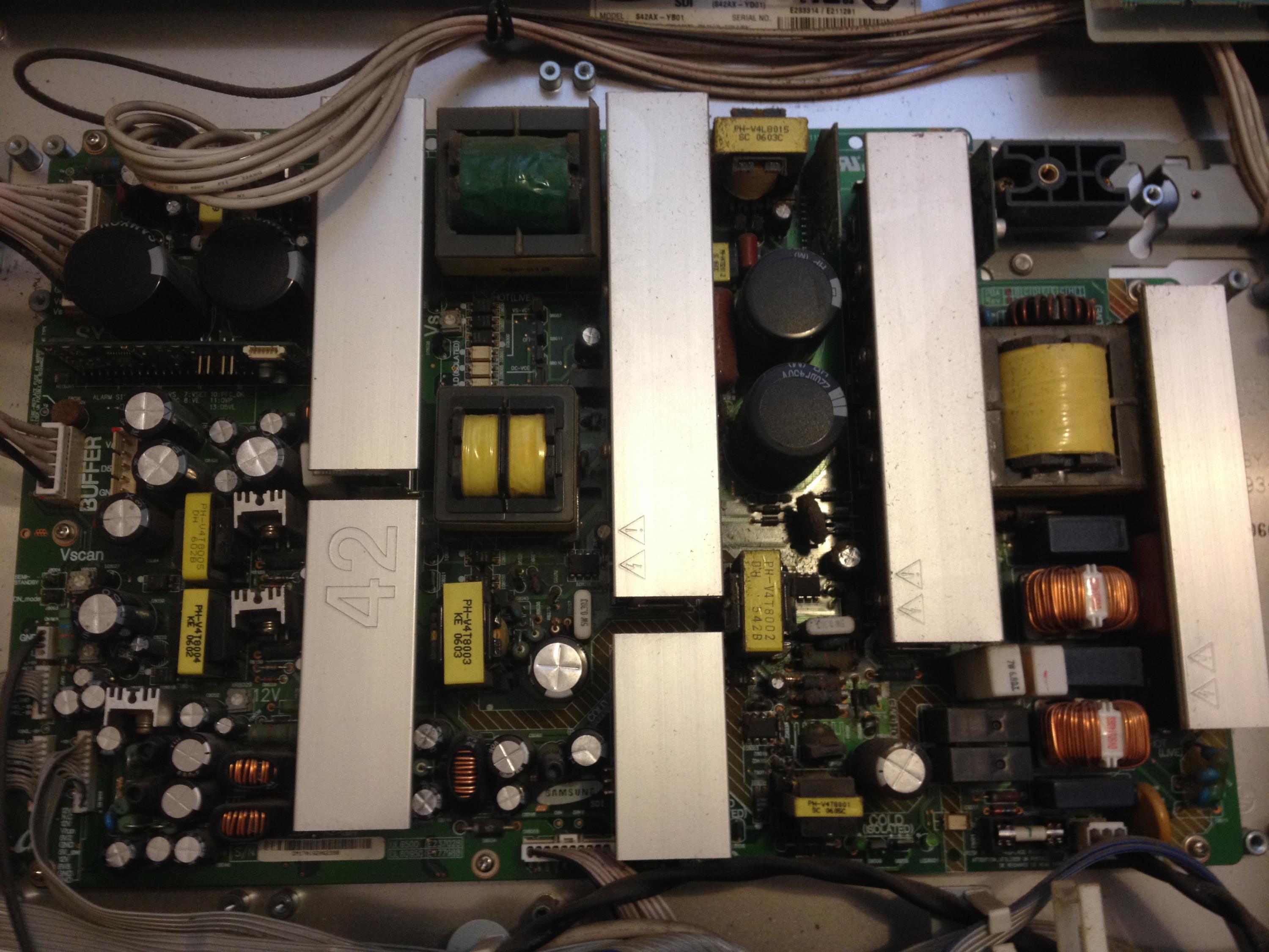

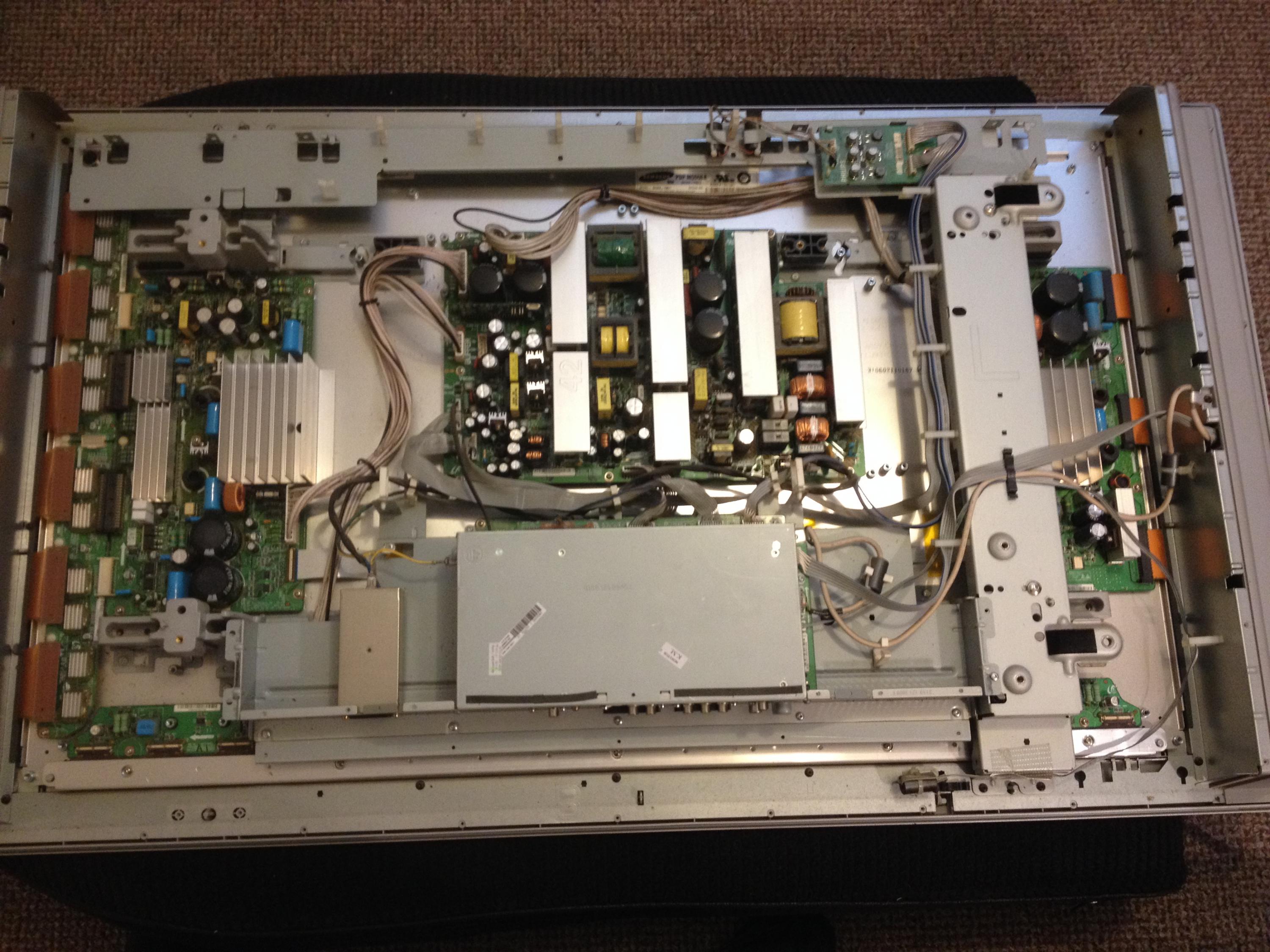

    been a while but just got a Phillips 42PF7521D
    owner said it just wouldn't power on one day

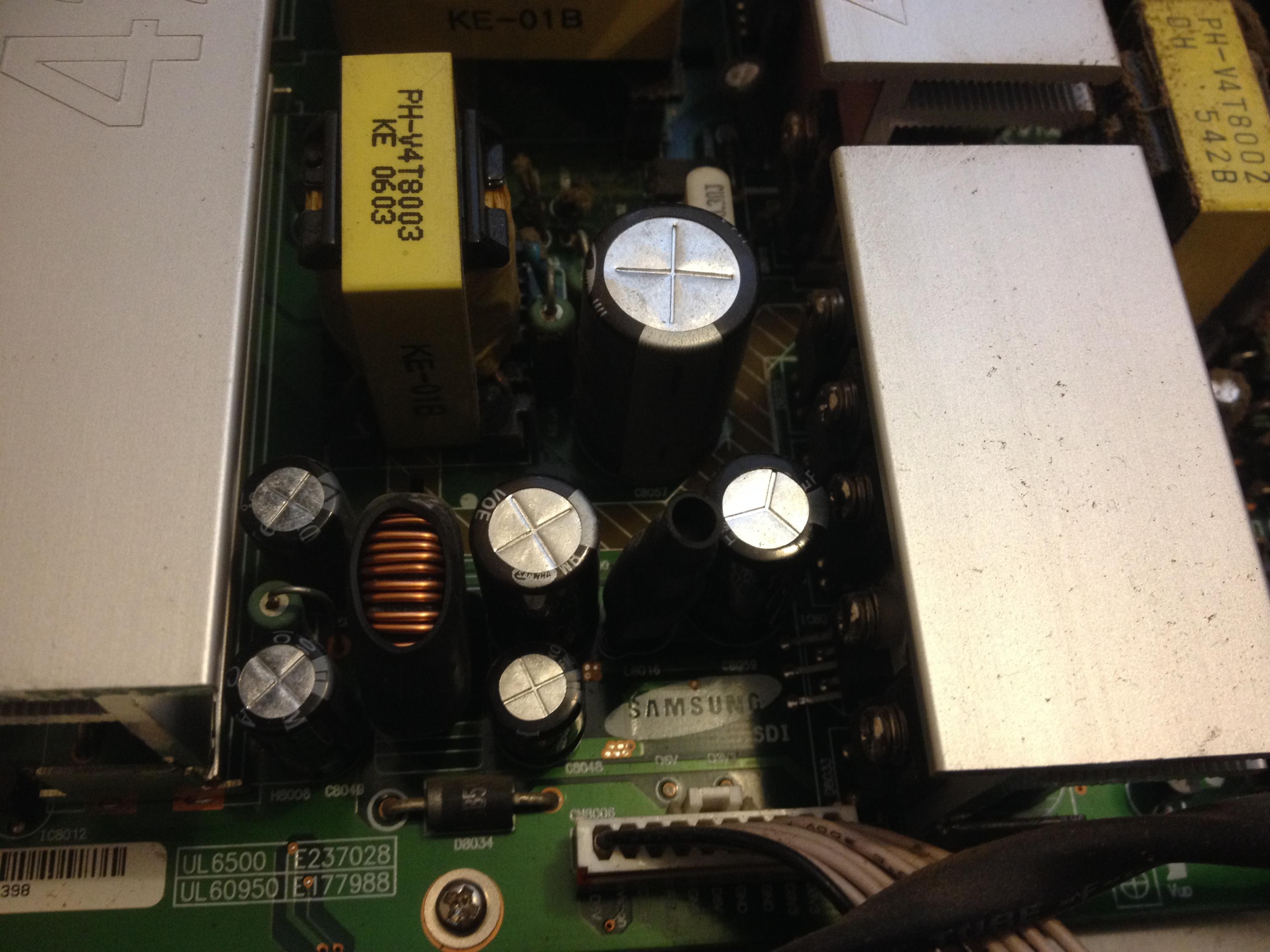

    looked inside no obvious caps on PS but did find one on the zsus - c5040 100uf 50v
    replaced that but still the same issue
    when you plug it in you get the 2 clicks and LED's on PS light up then 4 seconds later as the main board LED's are flashing it shuts down
    then i get 3 flashes on the sub board on the top left of the PS pic
    its strange though as the LED on the front just stays green the whole time as if its on no red LED at all
    If i isolate the zsus the PS stays up, my question is does that mean its a zsus fault or when it trys to pull power thats when the PS fails ?
    there are 2 other caps on the zsus that look suspect but i will have to raid the spares bin as i dont have any 68uf 63v

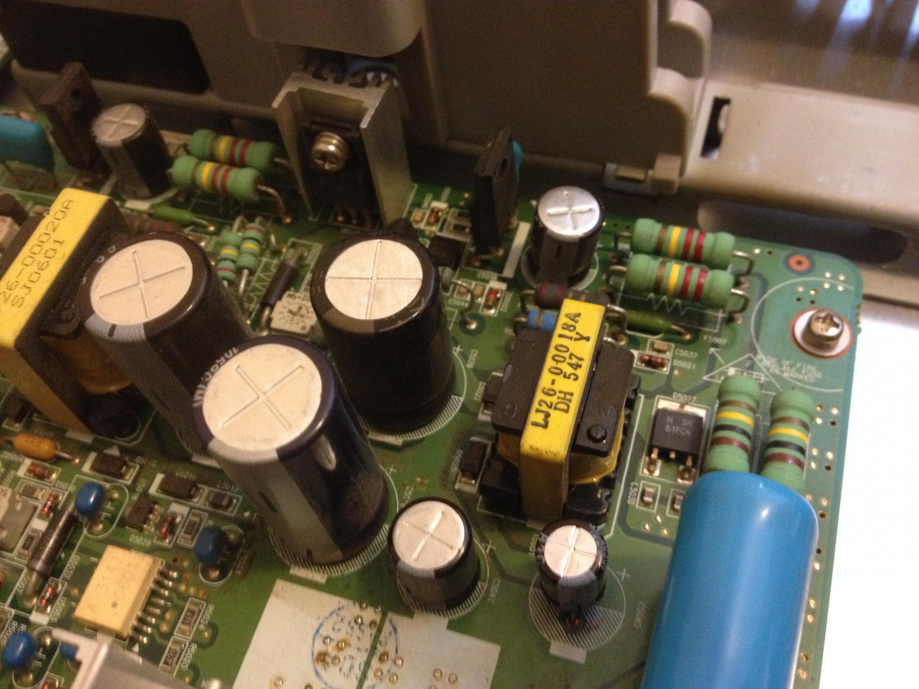

    Re: Phillips 42PF7521D - Just Green LED - wont power up
    Did you test all the voltages out of the power supply - is fuse 5607 good?
        Originally posted by noledud
        Fuese on the zsus is good and all voltages are as expected until shutdown
        I dont know which board 5607 is on - your pictures are not labeled - but it is in picture 2. If it is on the power supply and all voltages are good then fuse must be ok.
