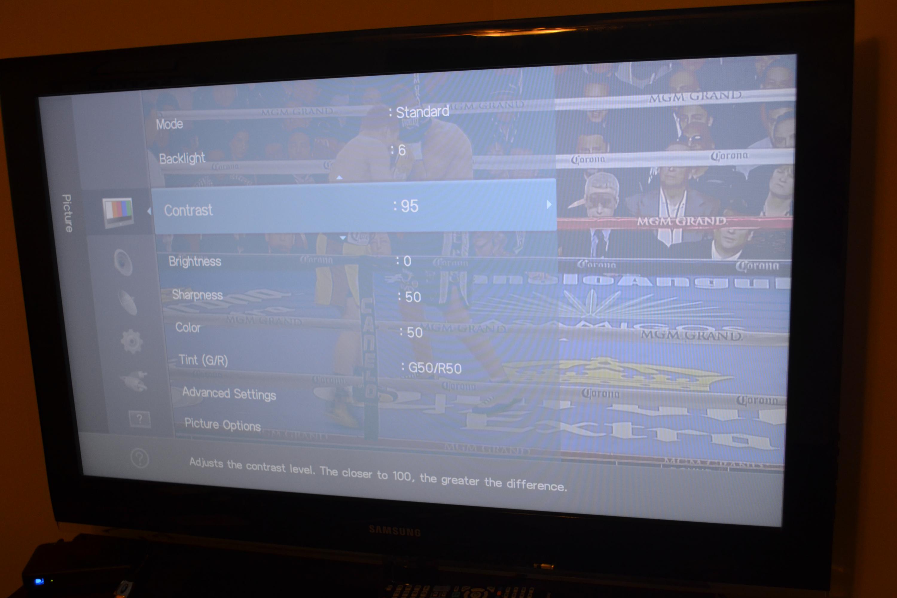

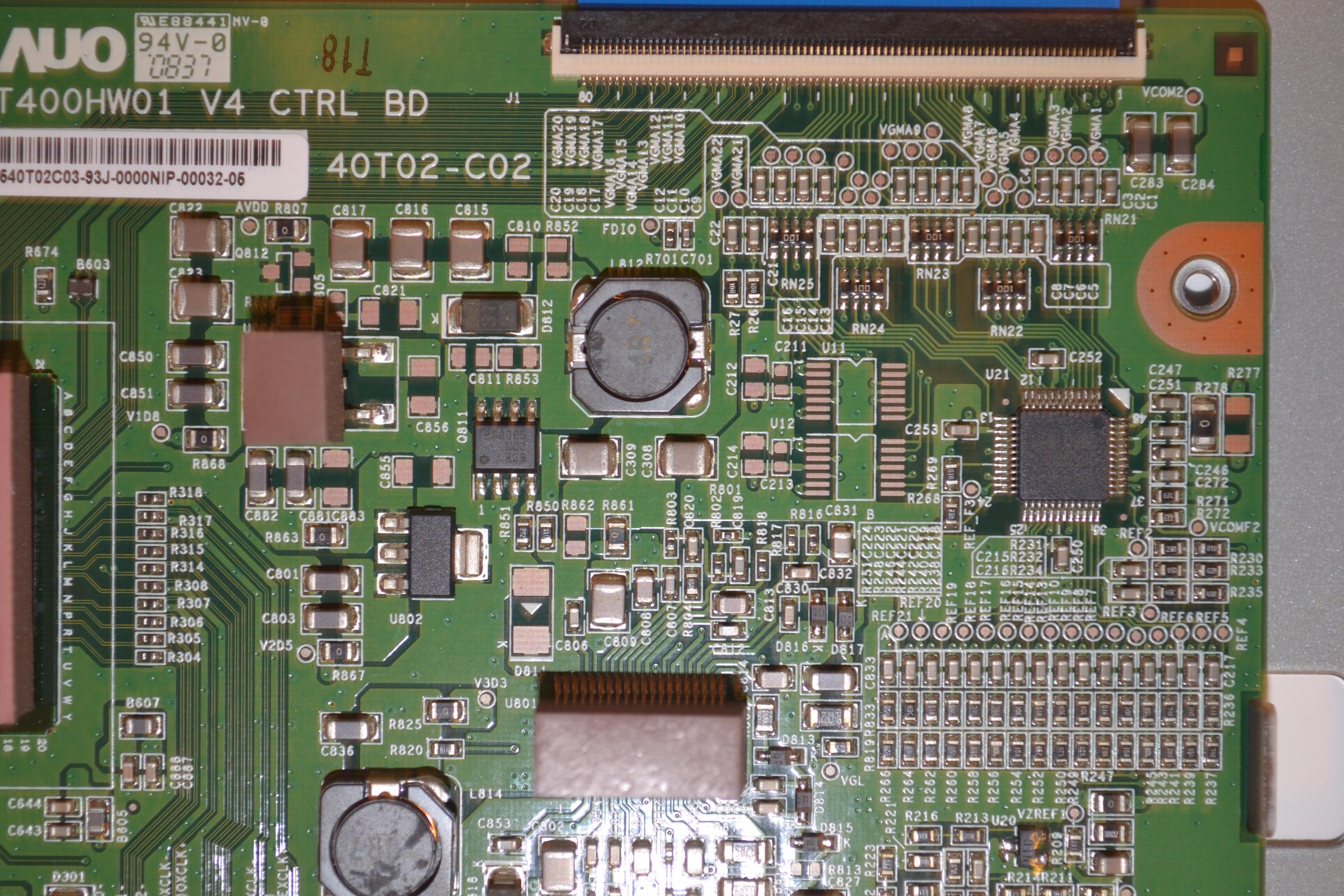

    My Samsung TV model LN40B530P7N, is not functioning properly. It began when the display distorted the colors after about 10-15 minutes of use (before the picture was perfect). I was able to adjust the color/brightness options to correct the issue until now. The picture is saturated with brightness immediately when I turn the TV on and i cannot adjust the brightness/back-light to compensate. Attached is what the picture looks like with all the brightness taken out. I went into the service menu to make changes and nothing I tried was successful, I even reset to factory settings. Any help would be appreciated.

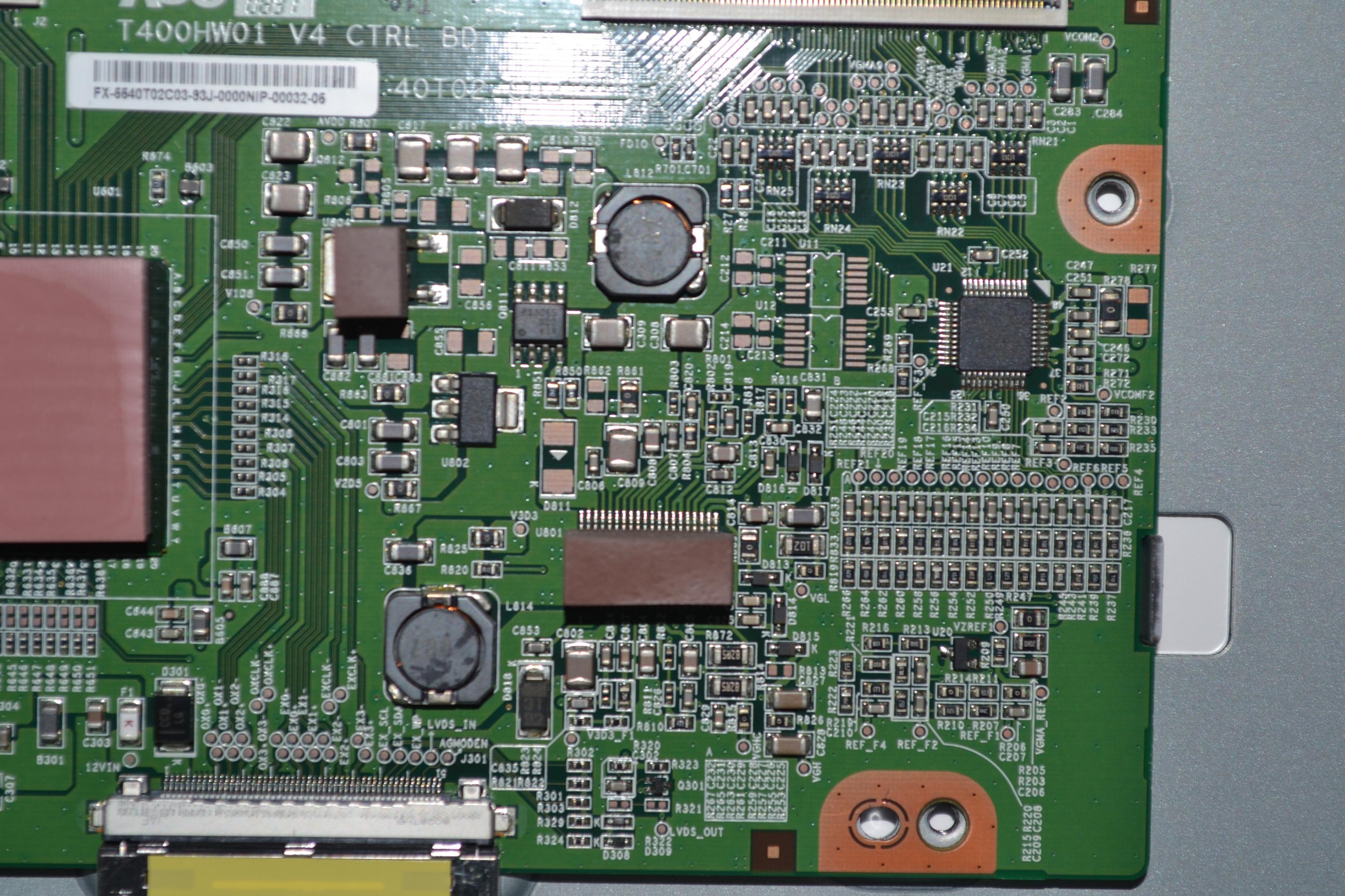

    Could be bad gamma IC on the tcon board. Can we get close up photos of the Tcon board? We're looking for an IC chip labeled AS15.
      Re: Samsung LN40B530P7N

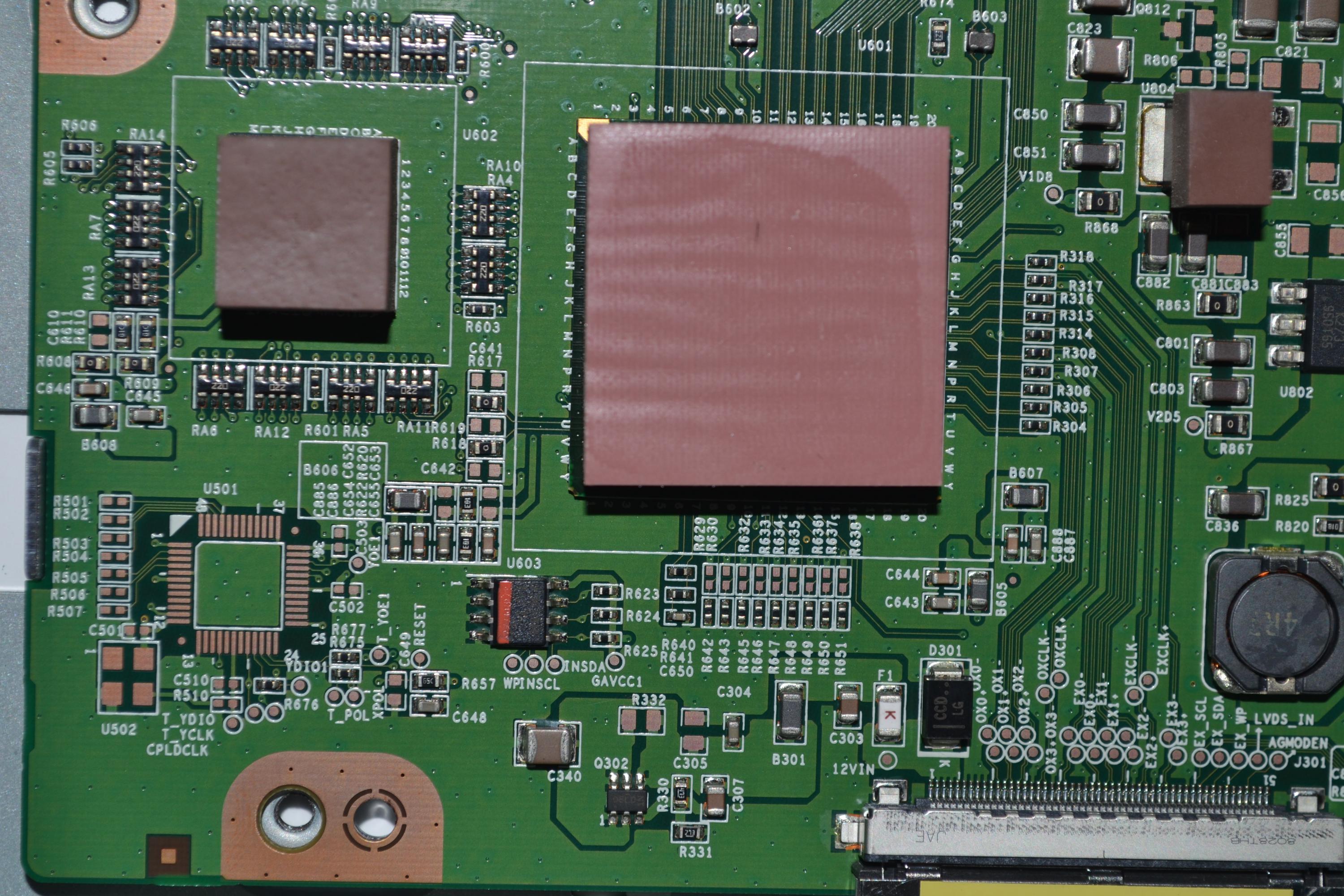

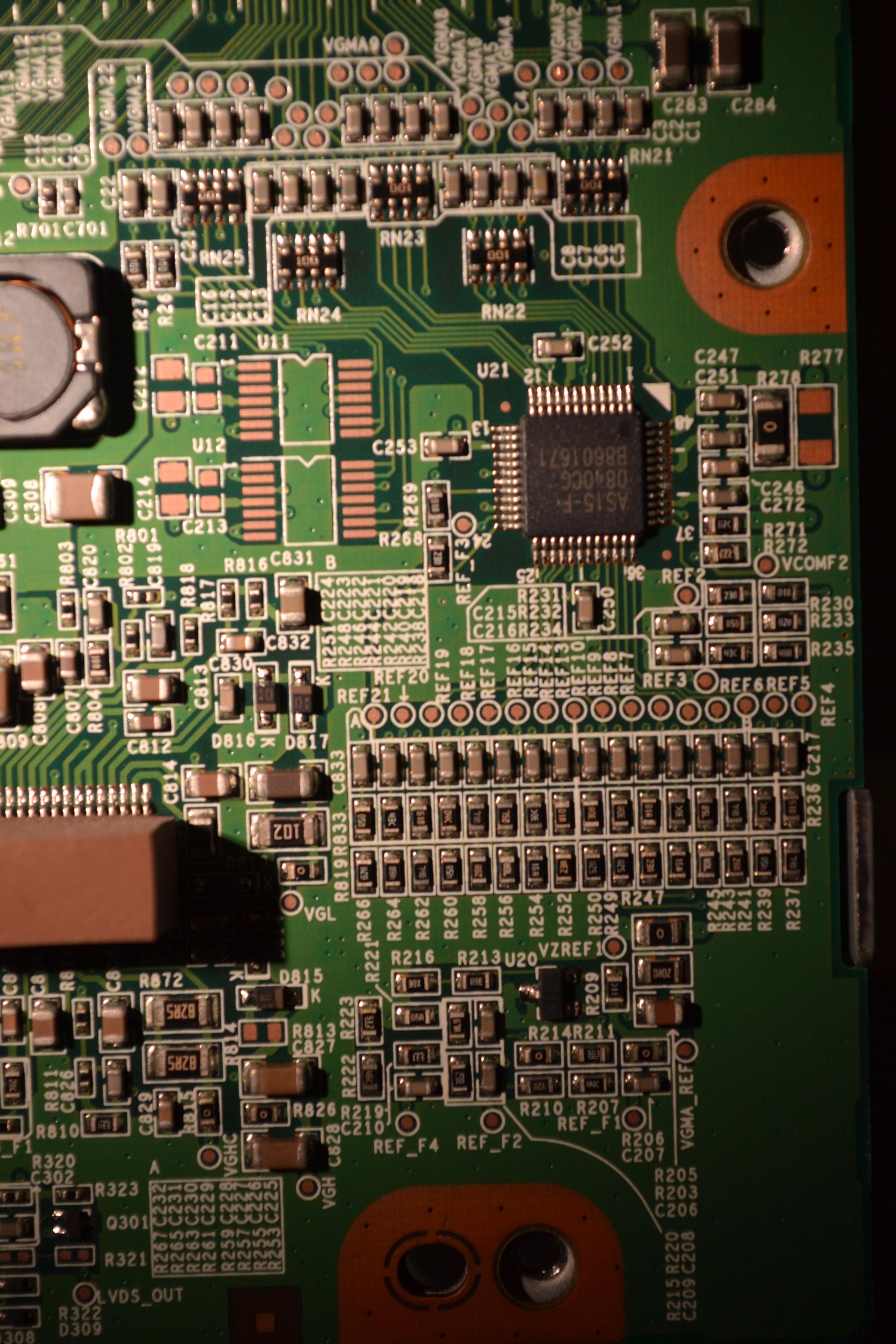

      Here is the pictures i took of the Tcon board. Let me know if you need anything else.

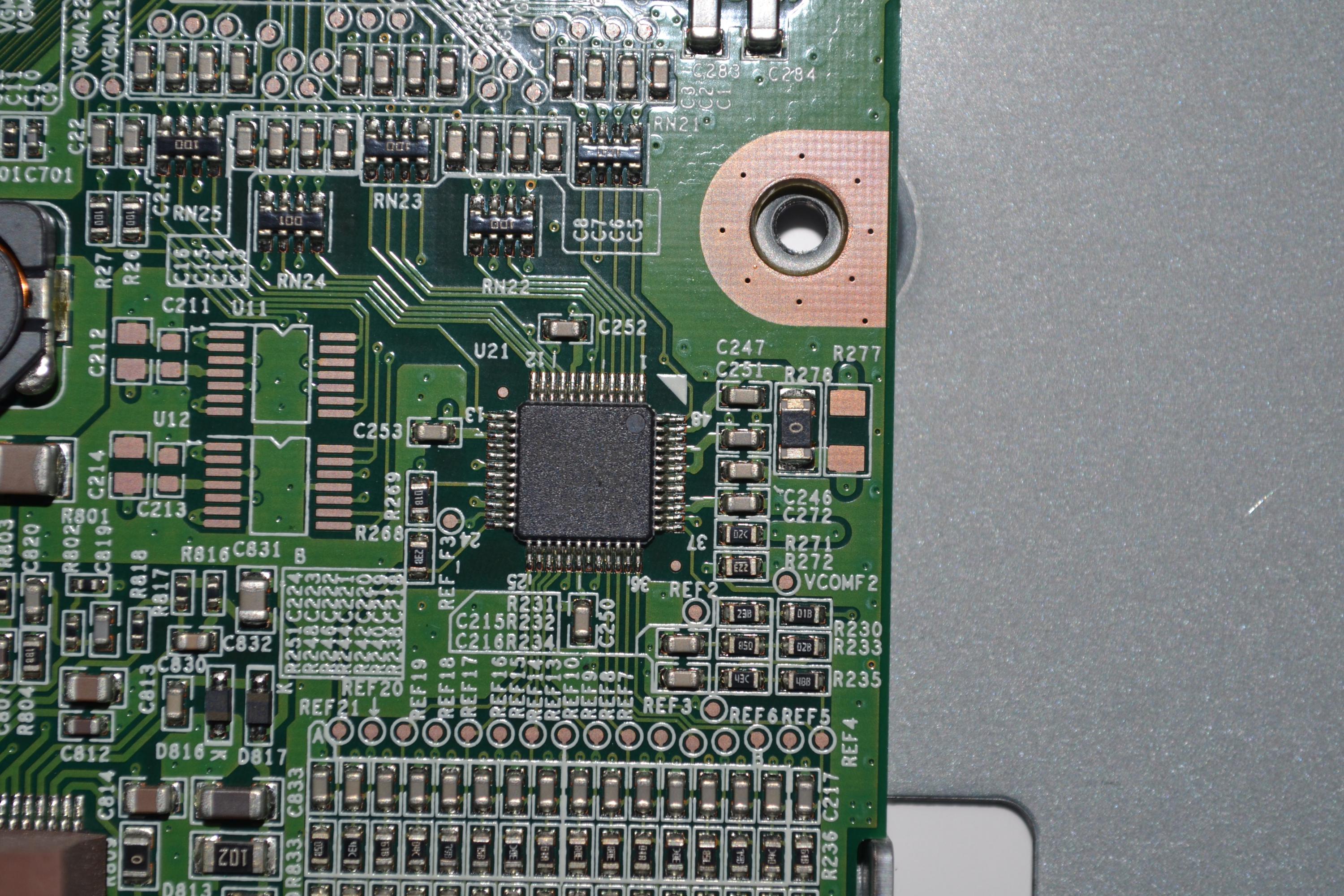

        I think it's the big chip on the second photo, is it labeled AS15? (AS15-F, AS15-G, etc)
        If you have that chip, do you see the test points labeled Vgma1, Vgma2, ..., Vgma22,
        Measure each voltage in order for each test point and report it here.

          U21, AS15 GAMMA IC more likely to be bad. Yes, check those GAMMA Voltages and report each DC Voltages.
            Yes the chip in the second photo is AS15-F, the voltages for VGMA1-22 are as follows.
              The chip is bad.

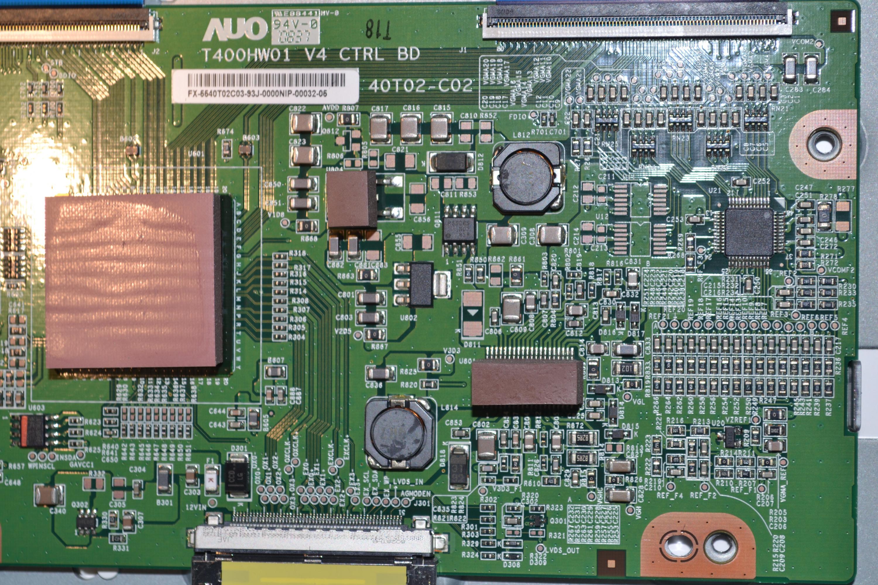

                          Well you better post a picture of it? Good clear and in focus so we can read the detail on the board
                            Top of picture 2.

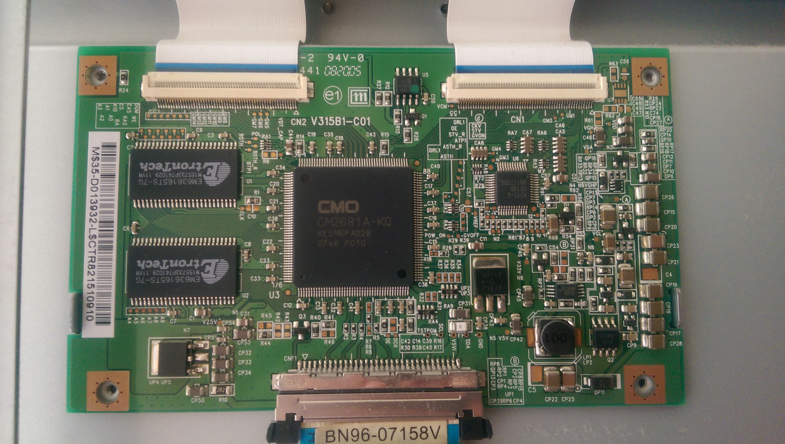

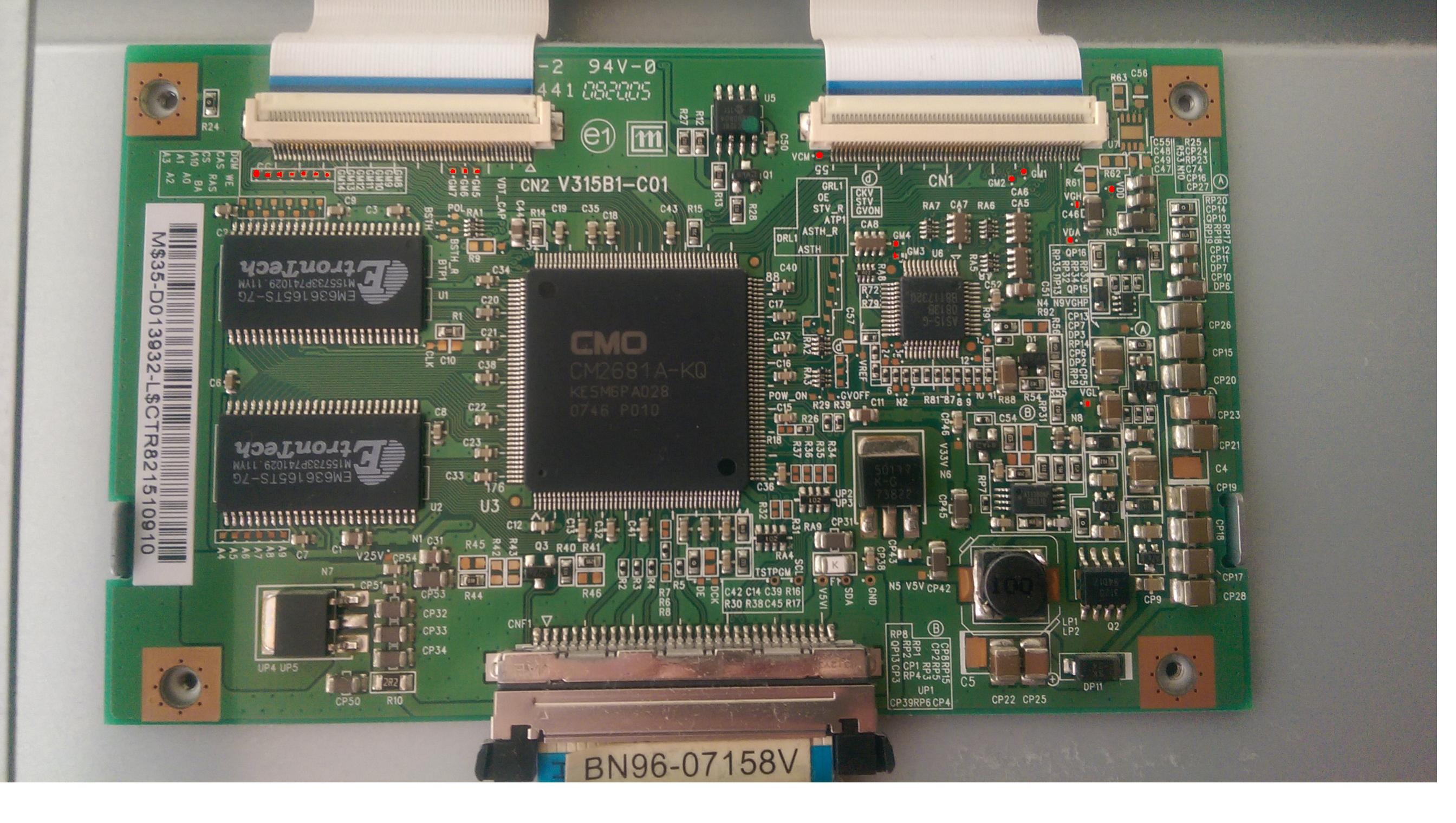

                                Here's a pic of the whole board, it probably will be a different board, as its from a Samsung LN32A330. I did find test points GM5 through GM14 near the top left. But thats all I could find....this is like where's waldo
                                  I am not happy that you have jumped an unrelated thread but have marked the Gamma test points Please start your own thread to list the results of the test - I actually have no idea what they mean but others can interpret them.
