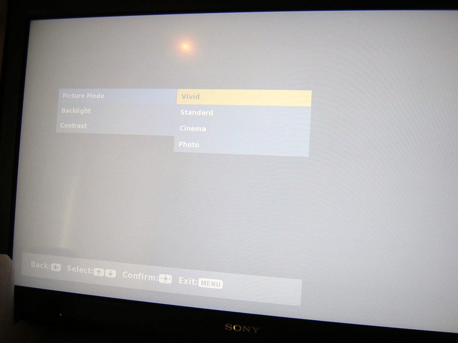

    Hi I wonder if anyone can help me
    I have a Sony kdl-375500 witch has a screen problem
    It is very pale white as if it,s misty, could this be the T-con board
    any help would be appreciated
    Thanks in advance Graham

      Re: Sony kdl-37s5500
      Seems like the gamma problem with the failed AS15 chip on the Tcon board.

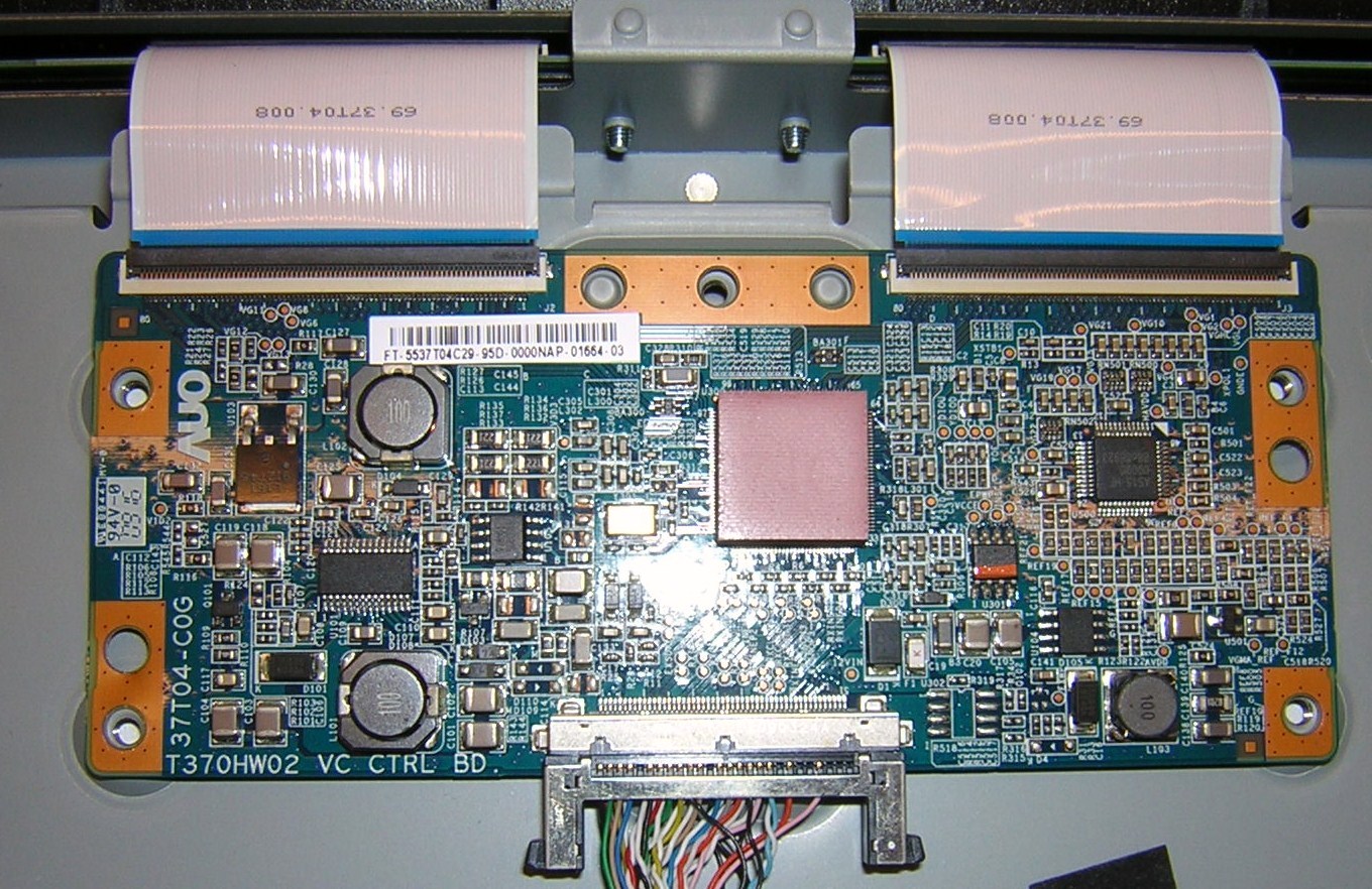

          Post a picture of the T-con board and we can help you test it if you have a multimeter of some kind.
          I had a KDL-37U4000 with a similar issue, I believe it to be of a similar series. And it was an AS15 gamma IC fault.
            Hi, picture of T-con board
            regards Graham
              Top right corner of board.
              https://www.badcaps.net/forum/attach...6&d=1404632754
              There are points marked VG1,VG2,VG3...VG22. (Some may be missing.)
              With your multimeter on the 20V range (or autoranging DC volts if available) test the voltage on each point. Red probe on the test pad, black on the chassis. Report each reading in order.

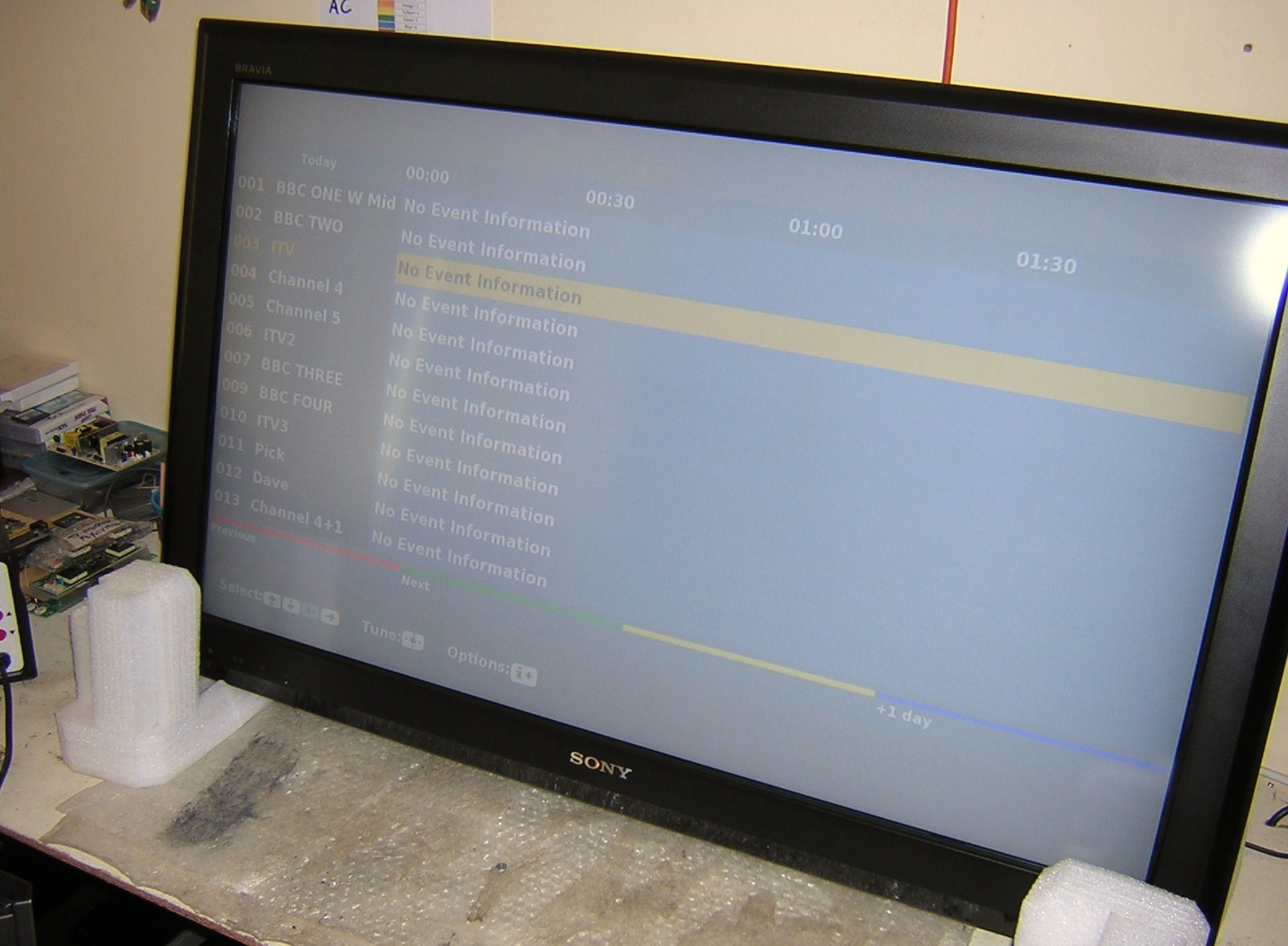

                Hi have the same problem, customer took it to Authorised Sony service and they say it's the LCD and quote about $600 for repair. I am an apprentice trained TV eng and though a bit rusty on LCD I am no t stupid What do you think? It did Once flash up ok.

                  You can do the same test as detailed above and post your results. If you have decent surface mount soldering skills, repair will be easy and cost only a few £.

                      No, you can use AS15-F to replace AS15-U for example.
                        Yes it does. AS-15G must be replaced with AS-15G same with the F suffix and any others.....

                            From what I've heard, no T-con relies on the difference
                            (AS15-U = Unleaded, but not RoHS compliant due to bromide content; AS15-F = Lead Free RoHS, AS15-G = Lead Free RoHS with Thermal Pad.)

                              Sony authorised say its is the LCD and will cost £400. Don,t believe them as raster is present and vague, washed out image is there. Set brought to me after Sony. All PSU voltages correct
                                I think it is a gamma reference problem. However if you want to be sure, you can check the VGAMA, if they are poor it will prove the problem.
