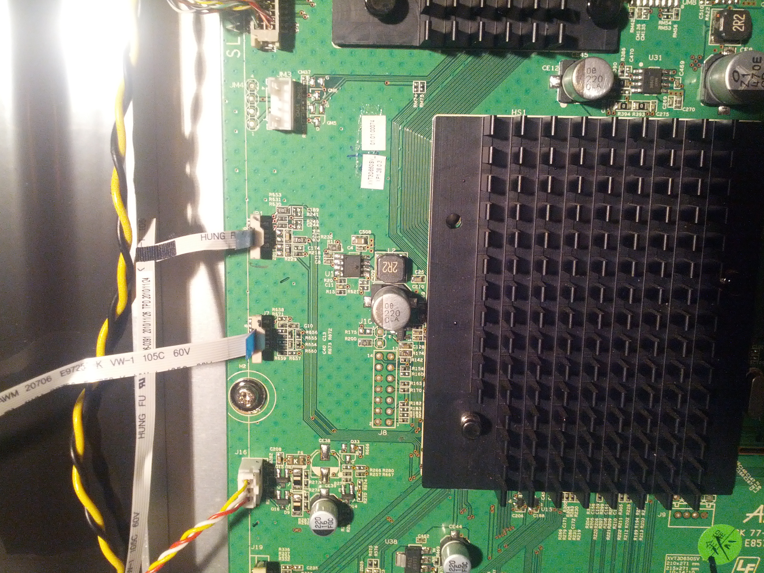

Vizio XVT3D650SV - Help
  • newpey
    replied
    Re: Vizio XVT3D650SV - Help
    Rest of pictures!
    Leave a comment:
  • newpey
    replied
    Re: Vizio XVT3D650SV - Help
    Closeups round 1... more to come of the other boards..
    Leave a comment:
    replied
    Re: Vizio XVT3D650SV - Help
    Can you please post clear focused pictures so I can read the labels on the board?
    Leave a comment:
  • newpey
    replied
    Re: Vizio XVT3D650SV - Help
    Sorry I mean it spikes at first then drops to 0
    Leave a comment:
  • bammbammfran
    replied
    Re: Vizio XVT3D650SV - Help
    Originally posted by newpey
    Thanks for the help! Unfortunately I am getting resistance from the fuse to the left. The fuse on the right is reading at 5 volts on each side. I took a close look at the bottom right of the board and I do not see anything.
    I am still stumped
    You are not supposed to get resistance on a fuse when you check it end for end.
    Is there any voltage at that fuse ?
    Leave a comment:
    replied
    Re: Vizio XVT3D650SV - Help
    check the voltage regulator in the second foto of your last post.
    7805 should have 5v coming out, and over 7v going in.
    pinout is printed on the board.
    check any others you find too.
    Leave a comment:
  • newpey
    replied
    Re: Vizio XVT3D650SV - Help
    Thanks for the help! Unfortunately I am getting resistance from the fuse to the left. The fuse on the right is reading at 5 volts on each side. I took a close look at the bottom right of the board and I do not see anything.
    I am still stumped
    Leave a comment:
  • bammbammfran
    replied
    Re: Vizio XVT3D650SV - Help
    the part that I thought looked iffy in the first picture looks better in the closeups.
    The fuse , on the other hand, in the second picture might be blown.
    Use your voltage tester and check voltage at the side that is closest to the plug and then check the other side of the fuse.
    If power is not going through. Unplug the plug from the power board and if your tester has ohm readings- check the resistance on the outgoing side of the fuse against the ground (pins marked in black) to see if resistance is there or if it shows zero which would mean a short.
    There is also a fuse like this on the 4 pin plug that is near this plug that can be checked.
    If you do not have power to either side of the fuse, it may not be powered up yet and would have to be checked with just the ohm meter by touching both ends of the fuse . I n this case, you do want to see zero on the reading.
    Leave a comment:
  • newpey
    replied
    Re: Vizio XVT3D650SV - Help
    Close ups of main board
    Leave a comment:
  • bammbammfran
    replied
    Re: Vizio XVT3D650SV - Help
    probably the main board
    Can you post a straight on picture of that board (near the boitom of the board, one part looks burned, but that could be a shadow ??)
    Leave a comment:
  • newpey
    replied
    Re: Vizio XVT3D650SV - Help
    pictures!
    Leave a comment:
  • newpey
    started a topic Vizio XVT3D650SV - Help
    Vizio XVT3D650SV - Help
    Hello all,
    I am reading and reading but can not seem to find what I need to get my TV working again.
    When I plug it in, the Vizio logo glows orange. It then dims a little but stays solid orange. I have no picture and no sound. The TV does not want to turn on at all. I replaced the power board with a tested good one. Nothing changed.
    I am GUESSING it is a problem with the main board but not sure. I have a multimeter I just need to be told what to test and I can certainly do that.
    Attached are pictures. Thank you guys so much for the help in advance!
    ~Chris
  • Hakuu
    by Hakuu
    Hi There,
    More Details
    TV Model - LG OLED77G1PUA
    07-12-2023, 02:37 PM
  • m1ch43lzm
    by m1ch43lzm
    05-12-2025, 08:37 PM
  • jb_Bak
    by jb_Bak
    CN6401
    Pin 01 NC
    Pin 02 NC
    Pin 03 "BL_ON": 0V
    Pin 04 "N/C"
    Pin 05 "STBY 3.3V": 3.5V
    Pin 06 "GND": N/C
    Pin 07 "AC_OFF"...
    09-27-2021, 04:52 PM
  • canadaboy25
    Panasonic TC-P54VT25 No image. A or D board?
    by canadaboy25
    I have a Panasonic TC-P54VT25 that will power on and prime the display but there is no image at all.
    The panel is primed as there is a slight glow from the entire panel. This means the problem should be logic related. The service manual also confirms this and recommends replacing the A or the D board.
    I have tried to get the TV to display the test sequence but I have been unable to and I don't even know if this TV has a test sequence or not. I tried following tom66's instructions in post #3 on this thread https://www.badcaps.net/forum/showthread.php?t=26790. There was...
    01-17-2021, 01:06 AM
