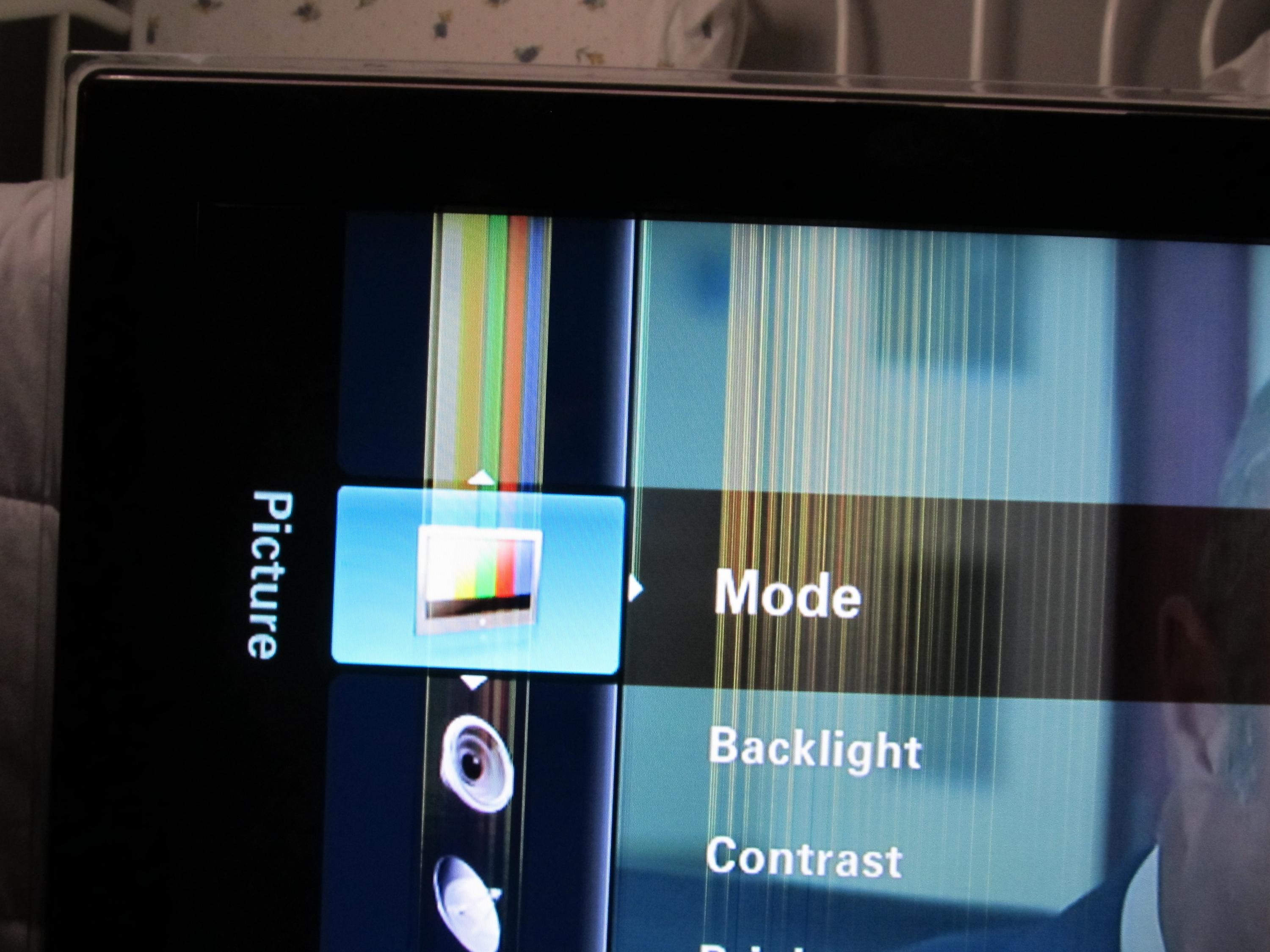

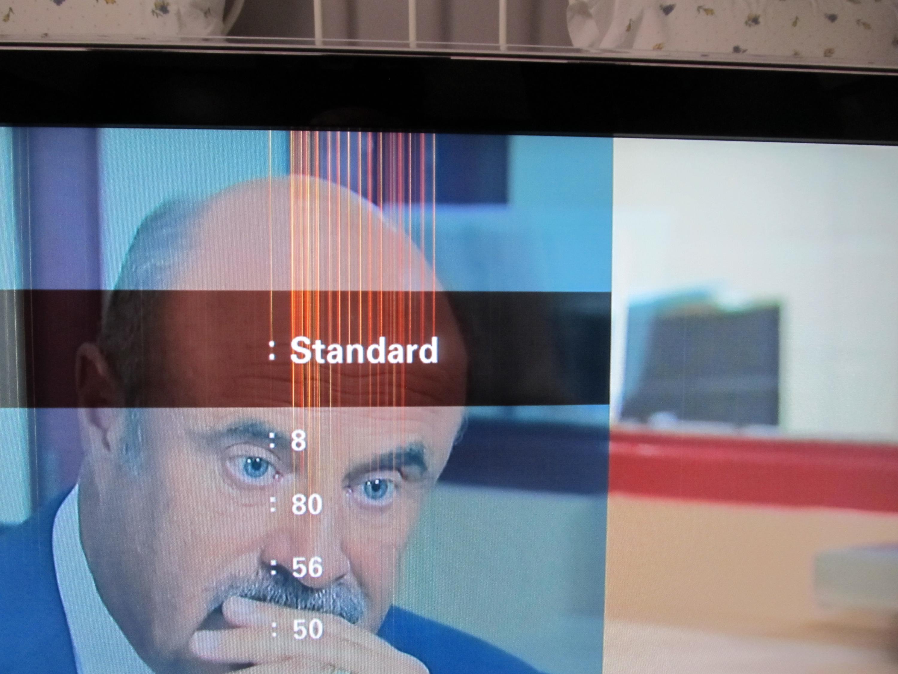

    About 3 years ago I fixed an LE40A656 for my parents with the common bad capacitors issue.
    Now the TV exhibits another fault, which is rather odd. Essentially any bright part of the image will bleed vertically across the panel although it's more predominant near the top of the panel. Turning the contrast down below about 85 hides the lines except on the menus, which seems to have a fixed brightness.
    I have a theory that the panel itself might be aging, rather than this being a tab bonding issue. The bulbs emit UV light which might be damaging the pixel TFTs requiring a stronger or weaker drive voltage. Or it could be related to heat over time - perhaps temperature related.
    I am going to investigate changing the VGL voltage (this turns pixels off, I suspect it may be too marginal), if this is not possible I will try reducing AVDD.

      Thing is the picture is OK mostly - only bright lines cause the bleeding. If you set the contrast low they never occur. Apparently the issue occurred slowly and got worse over time, which is interesting.

            Re: Samsung LE40A656 vertical line bleed, ideas about fix (panel ageing?)
            Long delay in posting.
            Going to have a look at this thing soon.
            Found that increasing AVDD (by loading feedback point) made fault worse.
            Going to try decreasing it.

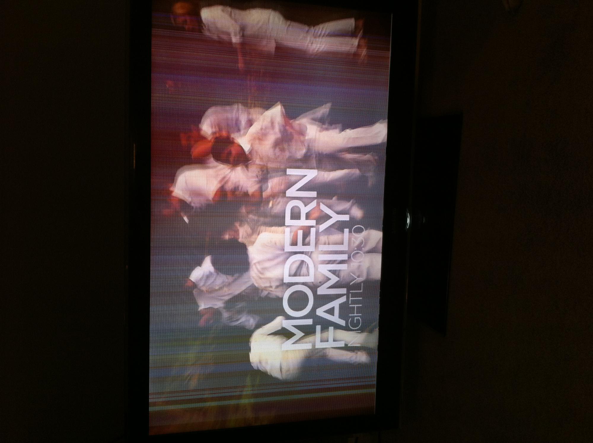

                I have a LG LN40A630M with the same symptoms. It gets a decent picture with the contrast turned down. Do these pictures look like your fault.
                  Yep, that's the same as what I'm seeing. Haven't had a chance to hook it up to a source properly yet.

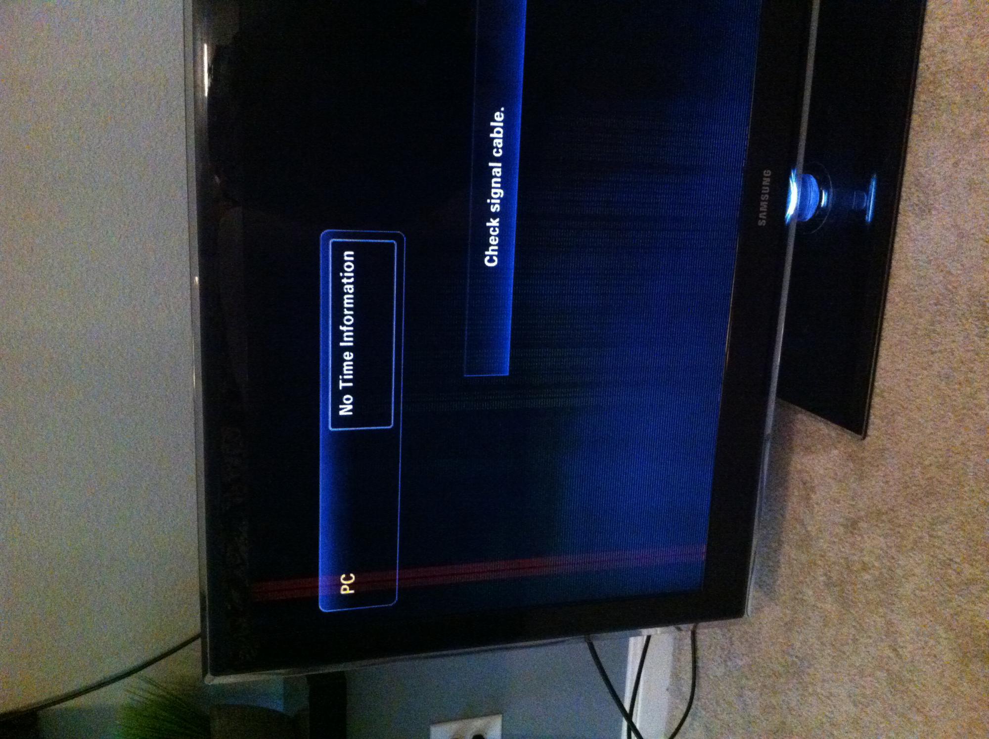

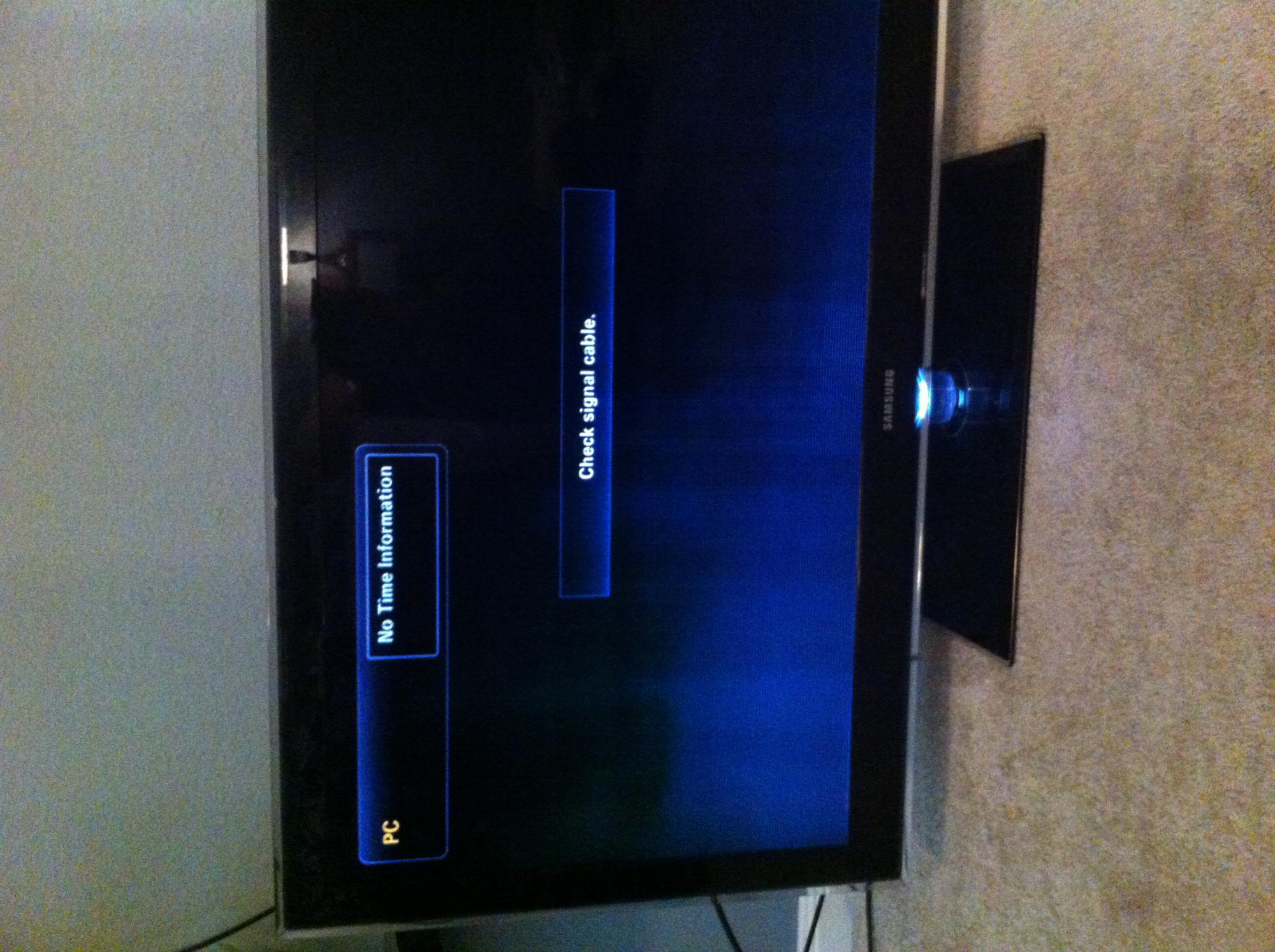

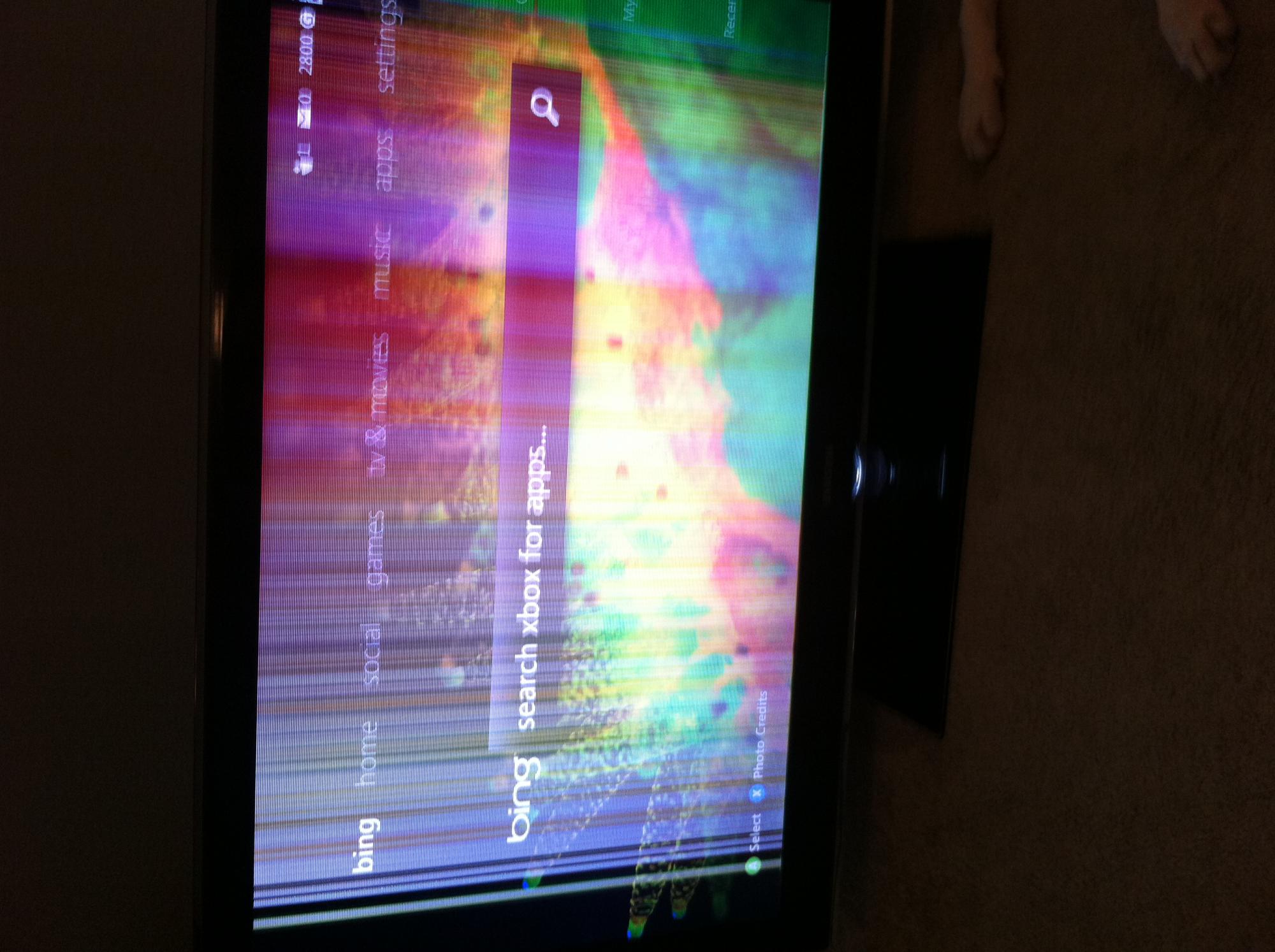

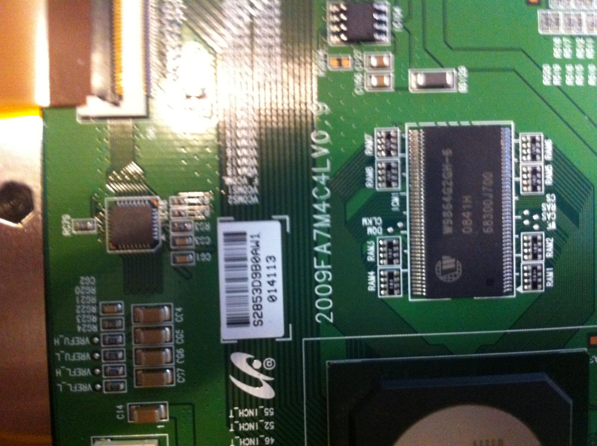

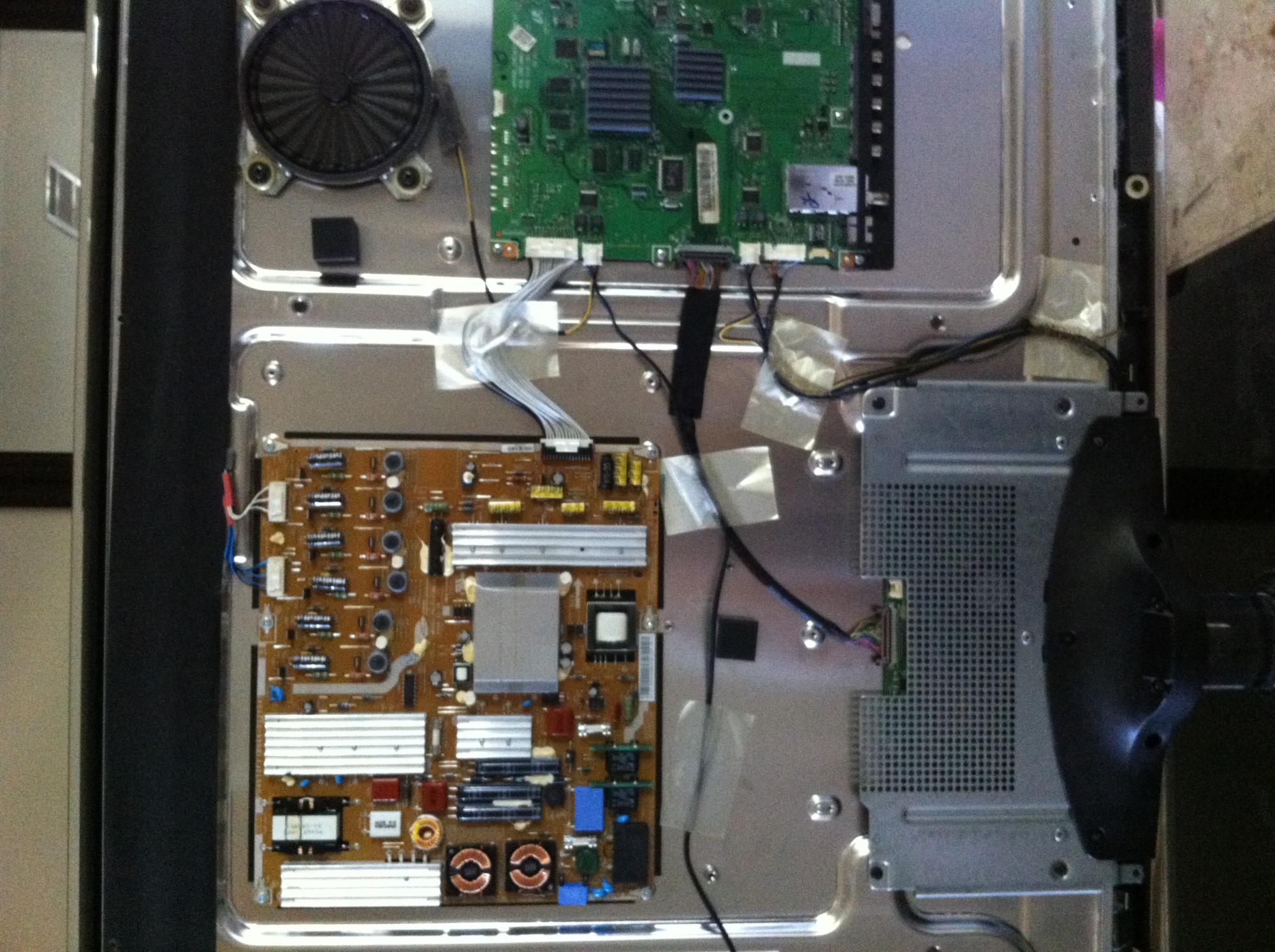

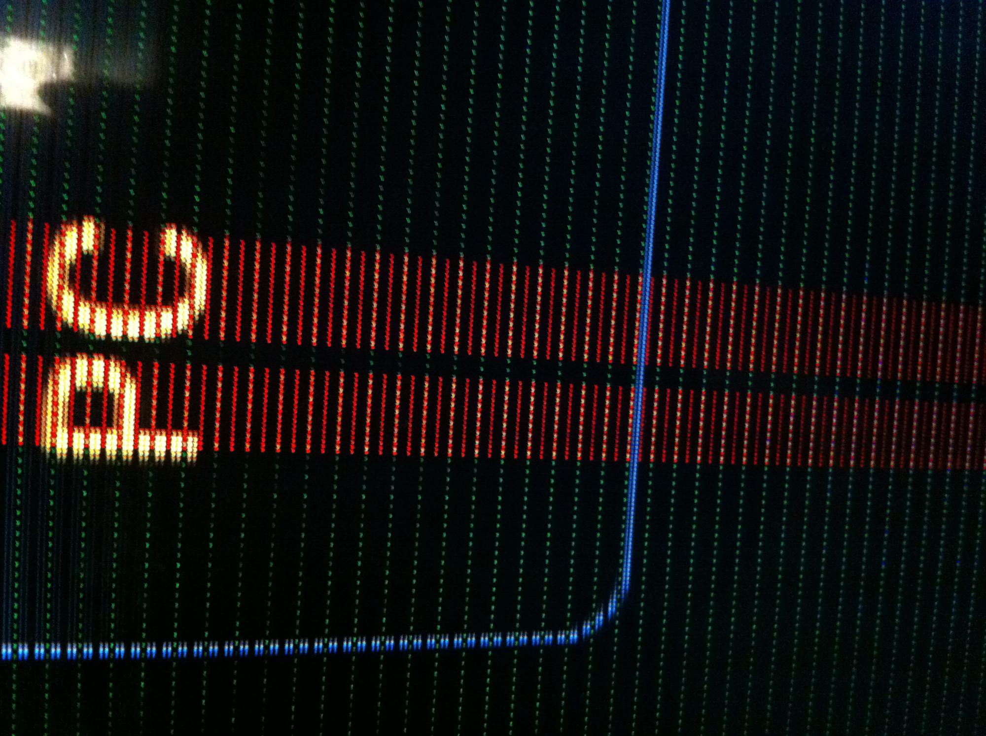

                      Okay here are some pictures of mine.
                      1-Tv right at startup
                      2-After about a minute in PC mode
                      3-Close up of lines in PC mode after 1 minute
                      4-Xbox guide Hdmi after 3-5 minutes
                      5-Cable after 3-5 minutes
                      6-Back of tv
                      7-Tcon board LJ94-02853
