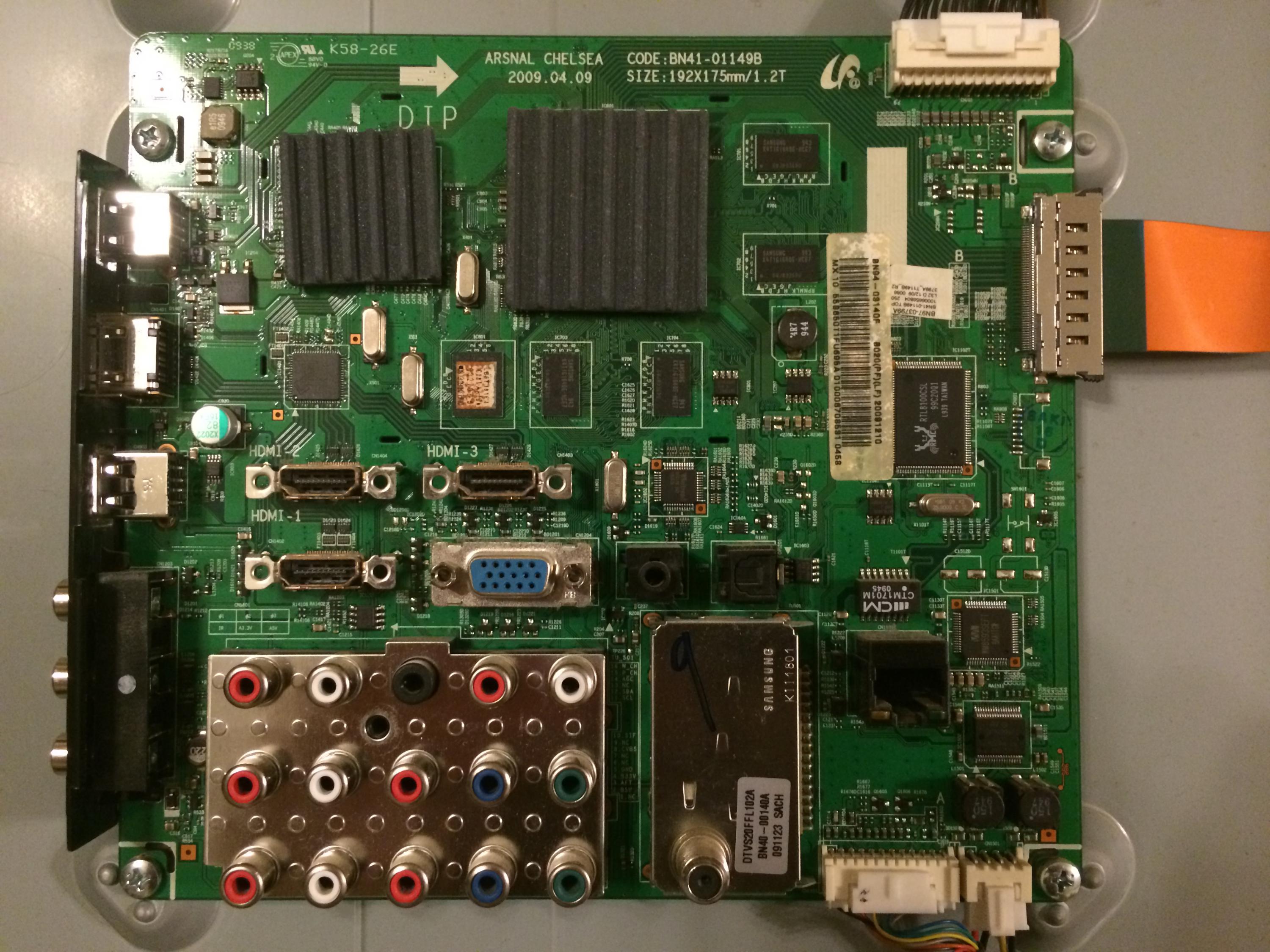

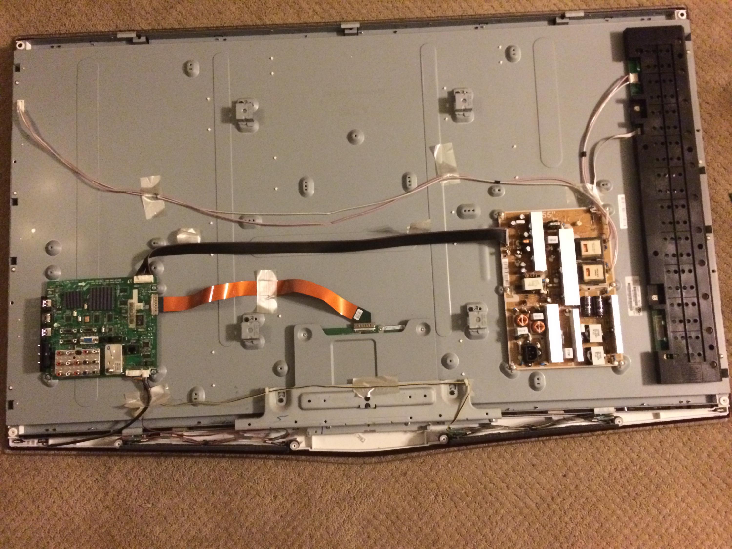

    Good Morning all,

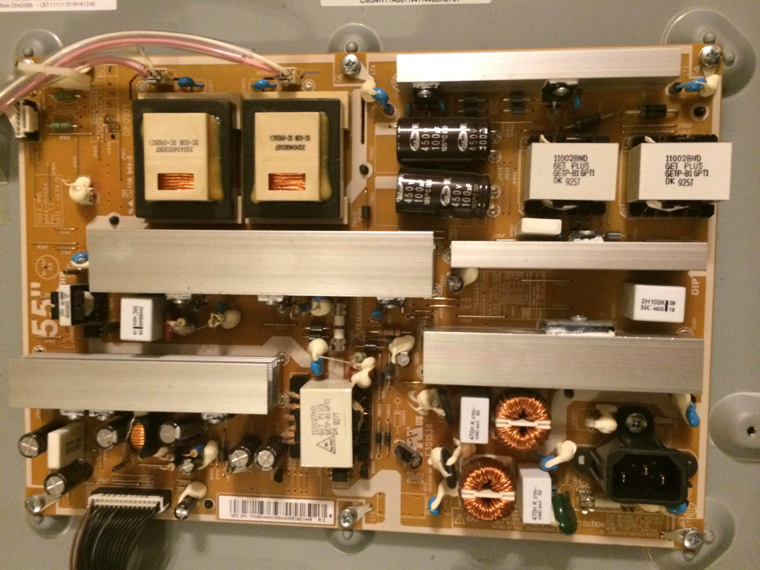

    I have a Samsung LN55B640R3FXZA that will not power on. We had a power outage and everything came back on except the TV. The red standby light comes on but once you press the power button on the remote it goes out and nothing happens. No power on tune, no audio, just a black screen. I originally thought it was the PS but didn't see any visible damage. When the ribbon cable is removed between board with all the inputs/outputs (logic board?) and the PS the screen lights up.
    I know very little about electronics in general but would like to know more and any help would be greatly appreciated.
    Thanks!

    The input board is called the mainboard. If your screen lights up with the main disconnected from the power supply (PSU), your PSU is fine. Your mainboard is probably not. Before you replace the mainboard, unplug the orange ribbon that connects the T-Con board to the main and see if the set will come up with the main connected to the PSU.

              I removed the orange cable from the mainboard and still have the same symptoms as before.power tune doesn't play and the standby light goes off.
              Anything else I can do to narrow down the problem?
                Re: Samsung LN55B640R3FXZA issue after power outage
                May be the main board got scrambled when you had power outage, so far it looks like the main board is the problem. With the TV off, hit the mute, 1, 8, 2, and power button on the remote in sequence to see if you can get to the factory setup menu to come up.

                  Ok tried the factory reset with no results, the standby light stayed on but no audio or display.
                    You can do visual inspect of the main board to see if there is any damaged/burnt component, also look at shopjimmy to see how much the new board will be.

                      Thanks for all the help, I couldn't find the logic board on shopjimmy but was able to get one on Ebay fairly cheap and the tv is back together and working.
