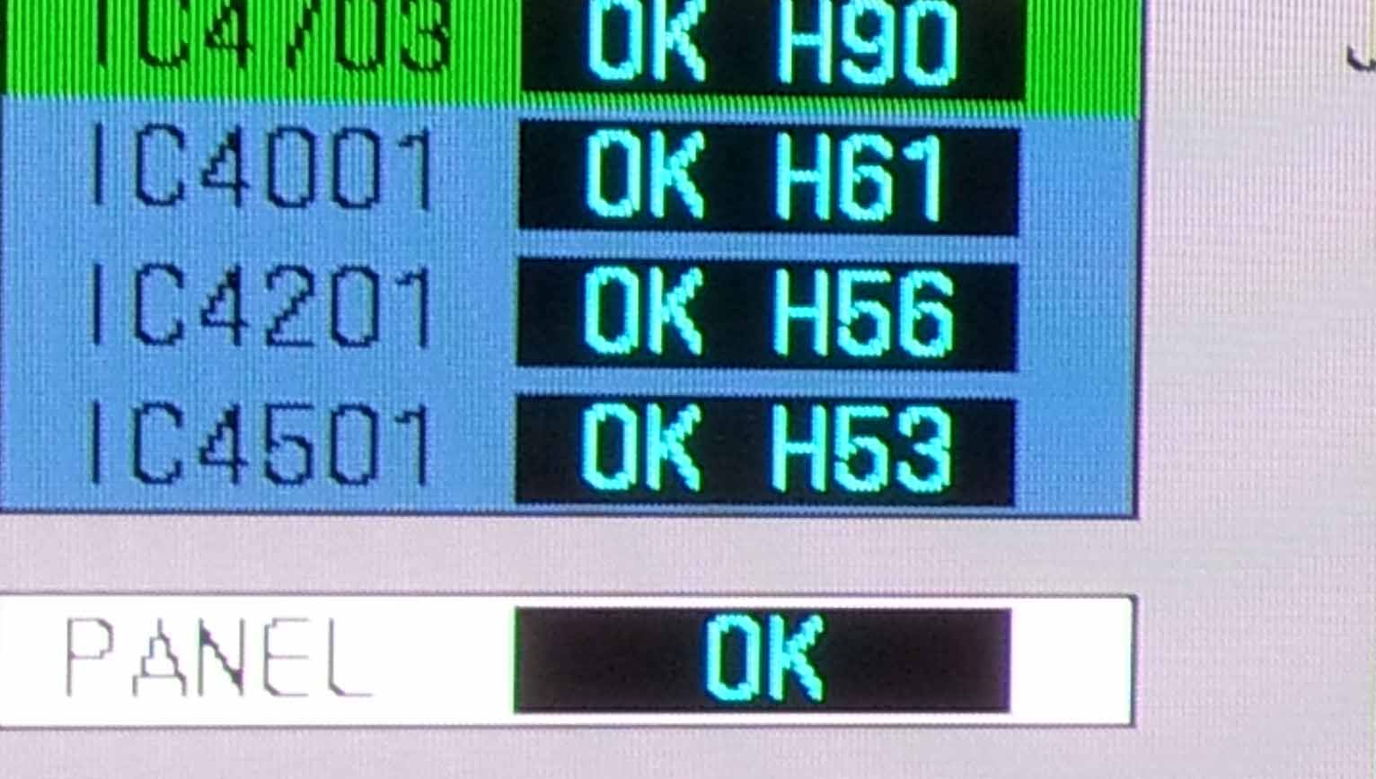

    The OSD is not legible once the pictures goes away. I attached a screenshot when it runs normal.

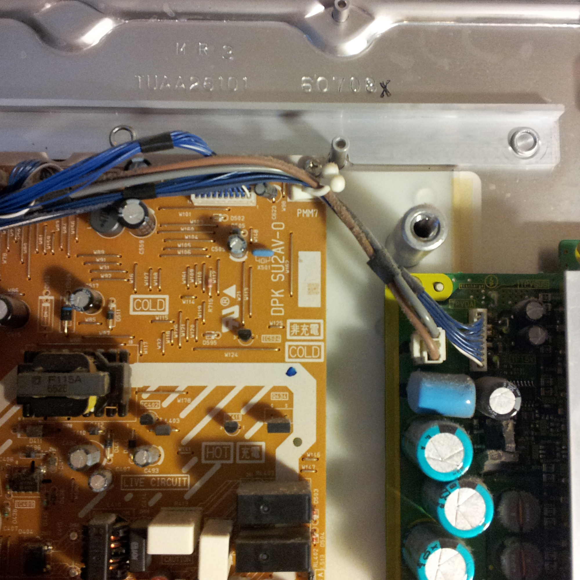

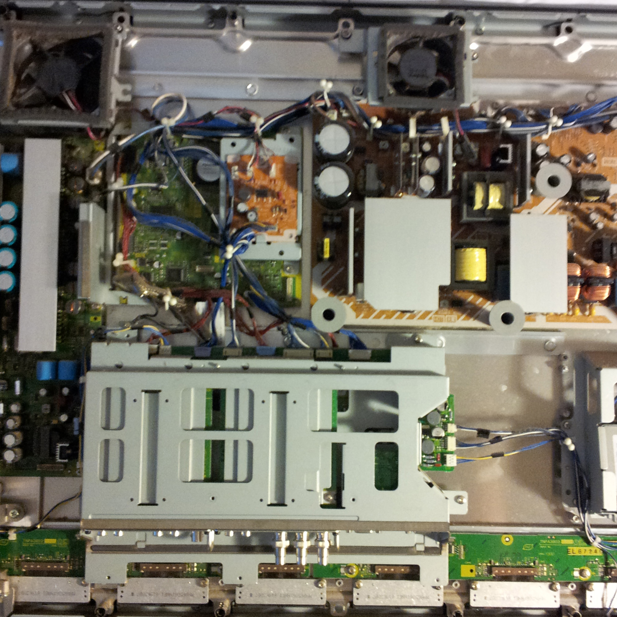

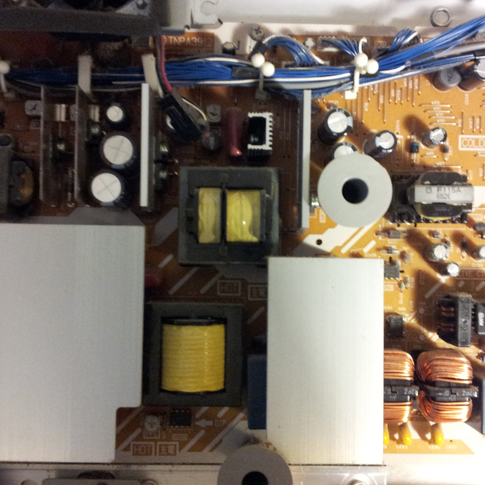

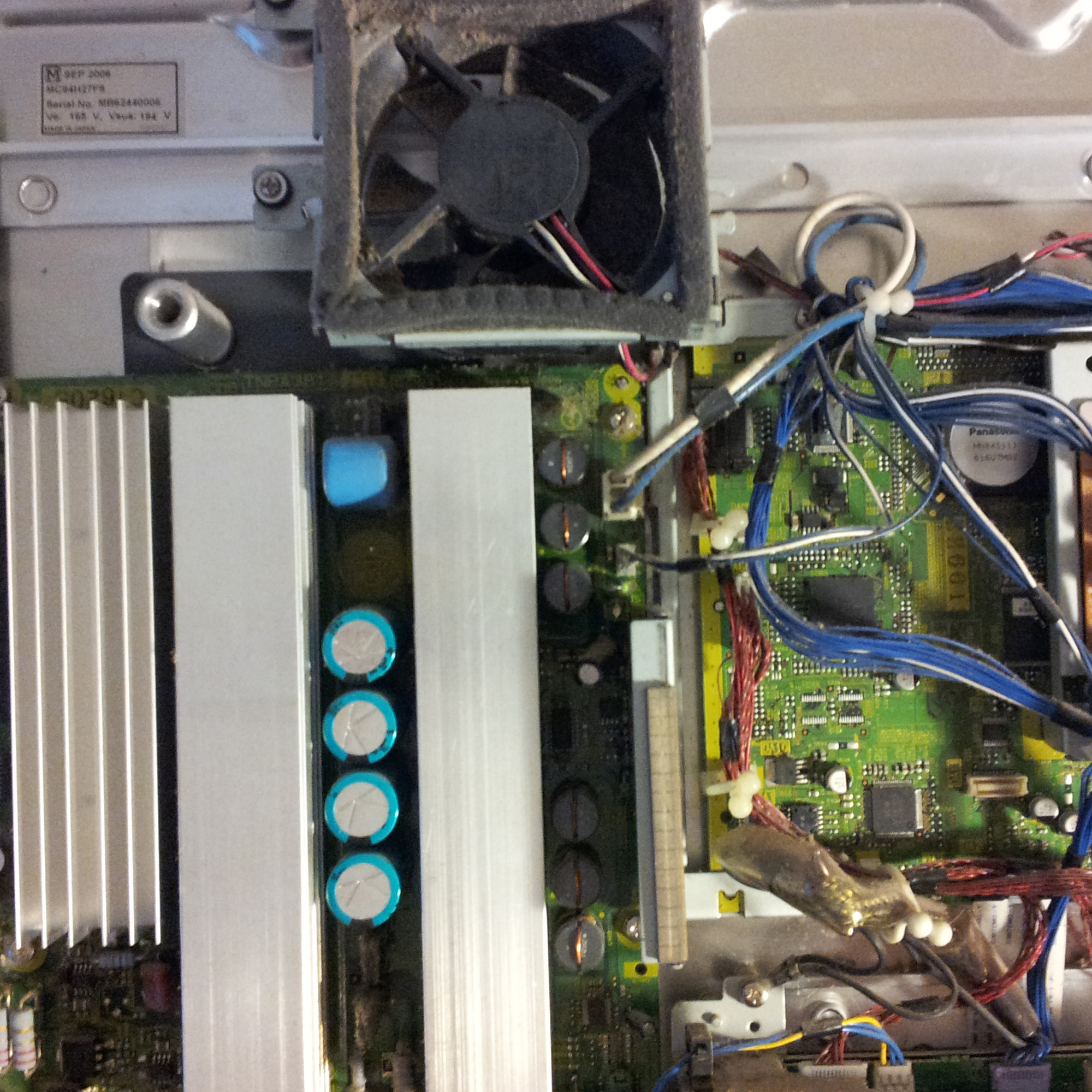

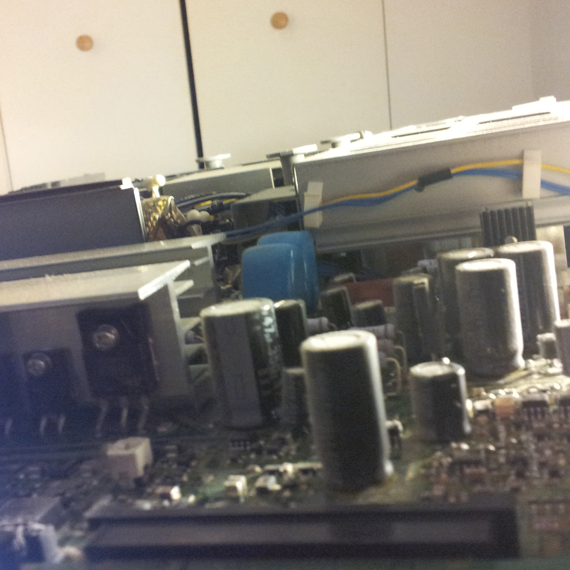

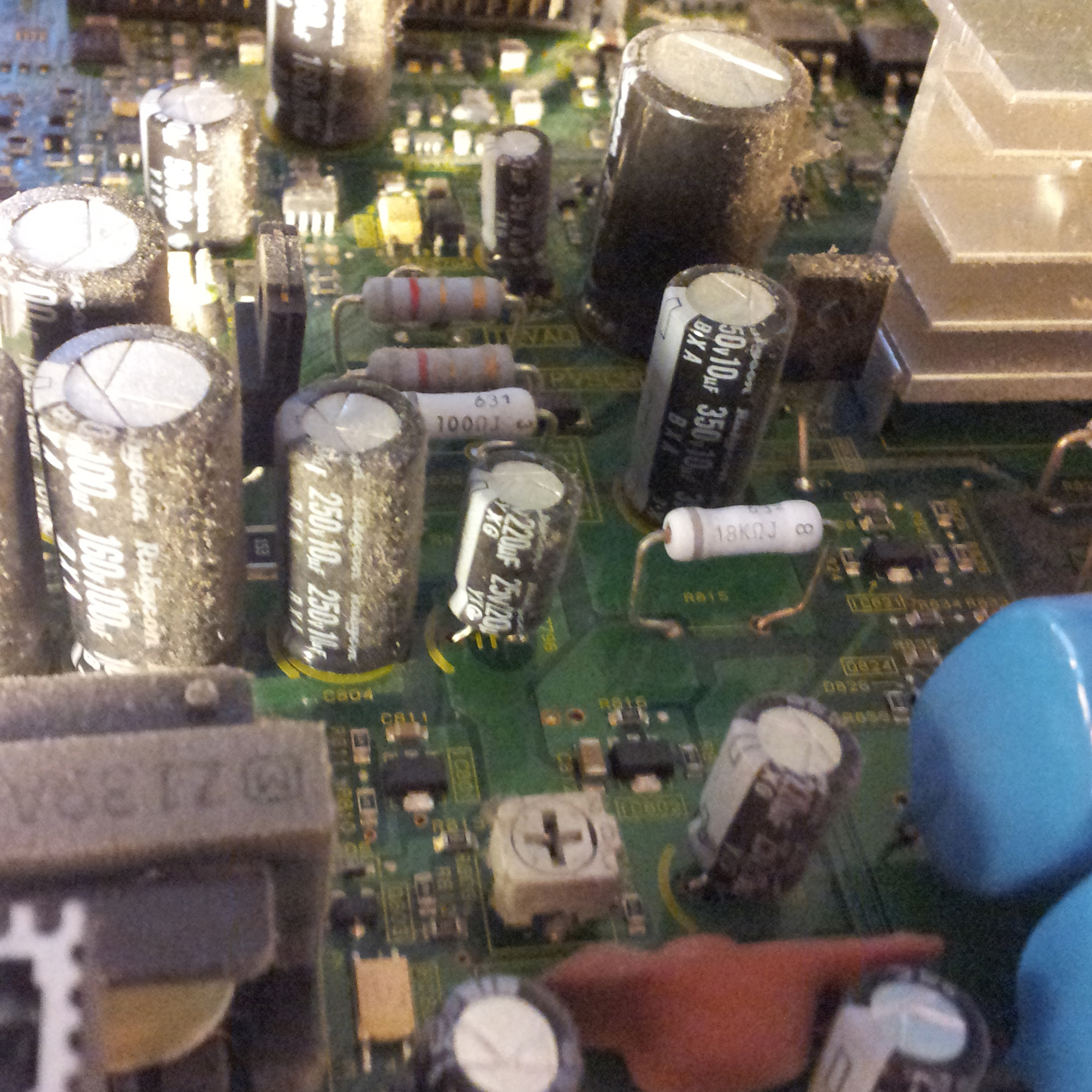

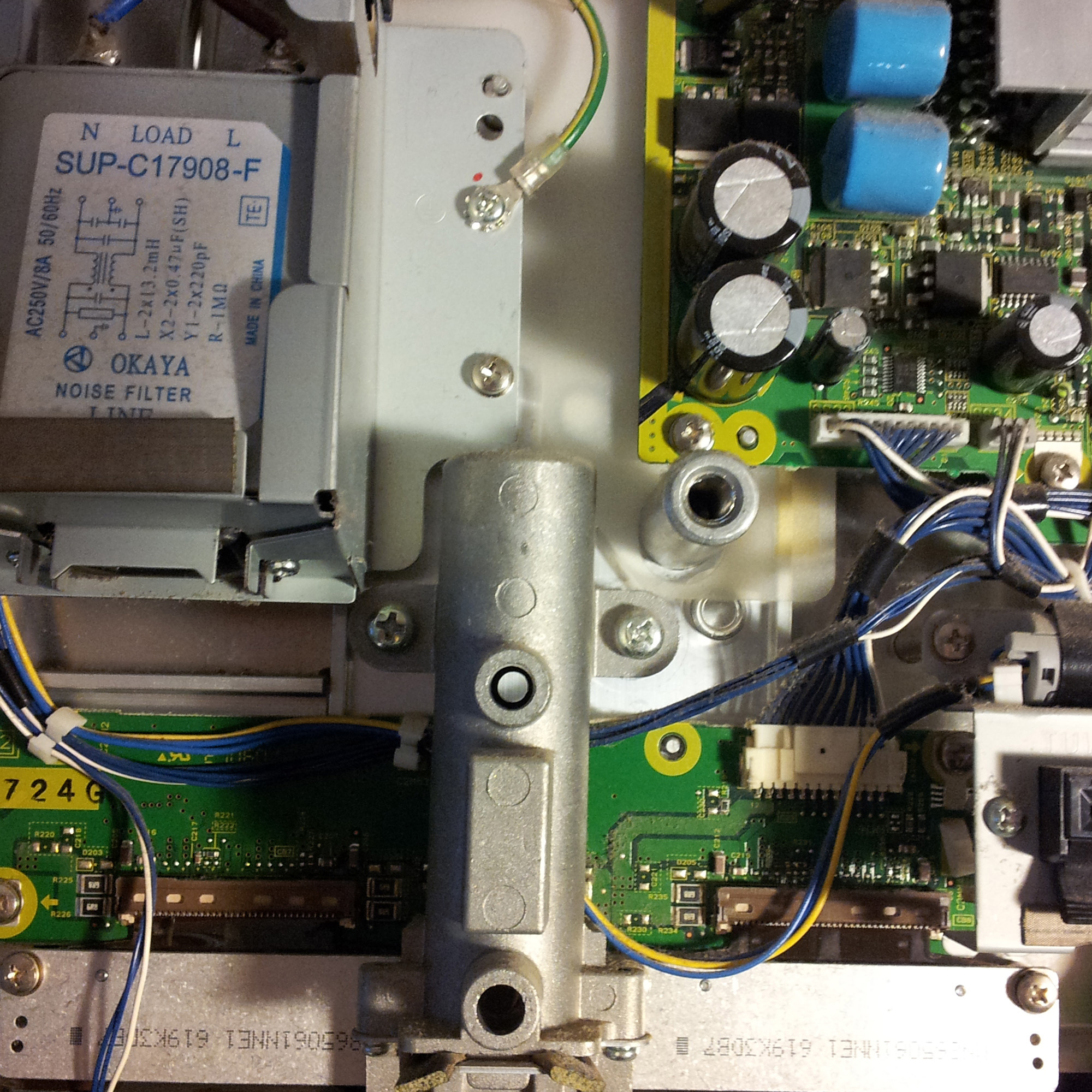

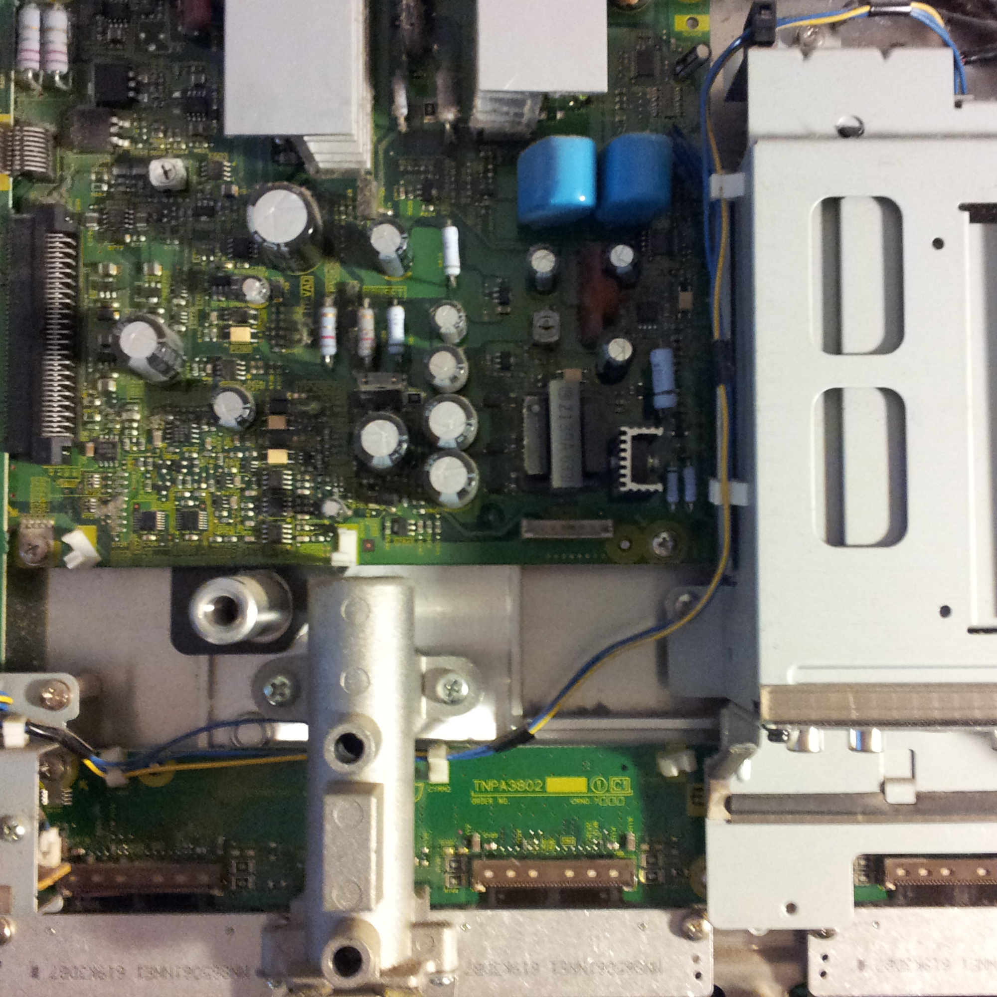

        Nothing is jumping out at me as far as leaks and or burns marks. I'm struggling to get great pictures with my camera phone. Let's see how these look.

          Sounds like bad LVDS cable connections.
          manual
          I'm looking at the DA board connector DA5 to D board connector D5.
          Try reseating or manipulating those and see what results you get. Have had a 2006 TV with that issue and I had to reseat several times to clean the connection and then used gaffa tape over the plug to secure it once it was all good.

            Hi pictures are not great for troubleshooting but at least it gives us the layout of the boards. I do notice a lot of dust in there - nice cosy jacket - will cause overheating - try and give it a clean out with a brush and vacuum. Wont fix the problem but makes it easier to see and will prolong its life when it is fixed.

              Thanks. I posted a comment in that thread. The monitor has been on its best behavior since I gave it a vacuum and gently pressed on some of the clips. I doubt that solved the problem, but I'll open it up and check out the DA to D board connectors.
              This was also a good experience as I would like to put an HDMI card in there at some point. I did not order it with one in 2006.

                For what it's worth, this was a quick run down on the 2006 TV with what to me sounds like an identical issue.
                https://www.badcaps.net/forum/showthread.php?t=31366
                If it's fine for now, maybe just let it go and when it fails again, have a look.
                I do believe it's just dirty/bad connector, age , oxidisation. The one I did has been fine ever since but I did have to work the connector in and out numerous times before it was fairly stable.
