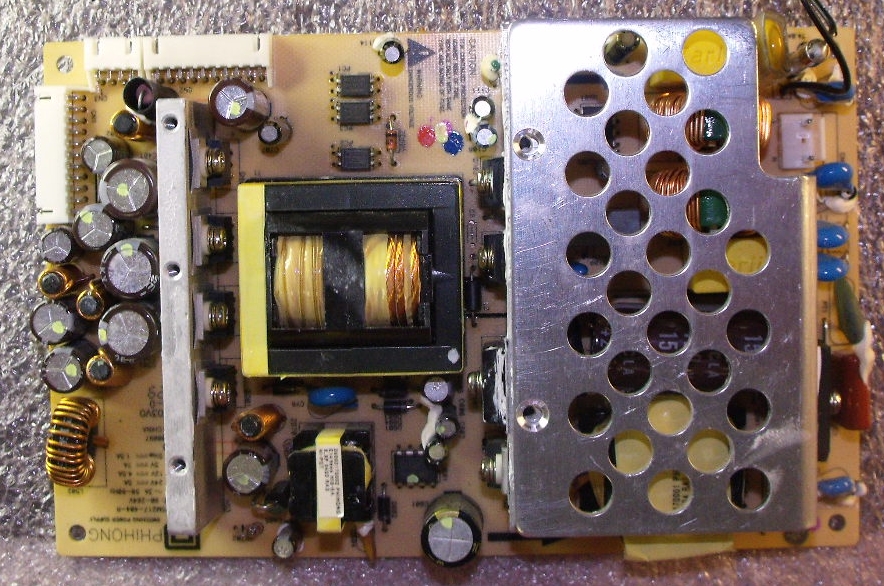

    Well guy's here is yet another TV I can't seem to fix and need my hand held. LOL
    Westinghouse LTV-32W3HD It was totally dead when I got it and I found 2 bad mosfets and a blown fuse. I replaced those and looked over everything else and did not see any swollen caps and checked the diodes on top for short or open and nothing so I put it back in and when plugged in the amber light by the buttons flahes once then pause then two more flashes then out. during this time no backlights flash and when pushing the power button still nothing. Olnly get amber light when plugging in. I have 5v standby but that's it no 12v or the other 5v on the connector. I also removed the other heatsink and checked all those mosfets. HELP??

          What is the board number.
          Can you read the part numbers of the two ics - one 8leg middle bottom
          another under the heatsink left hole second row down
          • CraigR
            • Dec 2013
            • 959
            Re: Westinghouse LTV-32w3HD 3 blinks to dead
            Board number PSM217-404-R IC #DM0265R and under that is BVG11 next LM393N and under KXG622

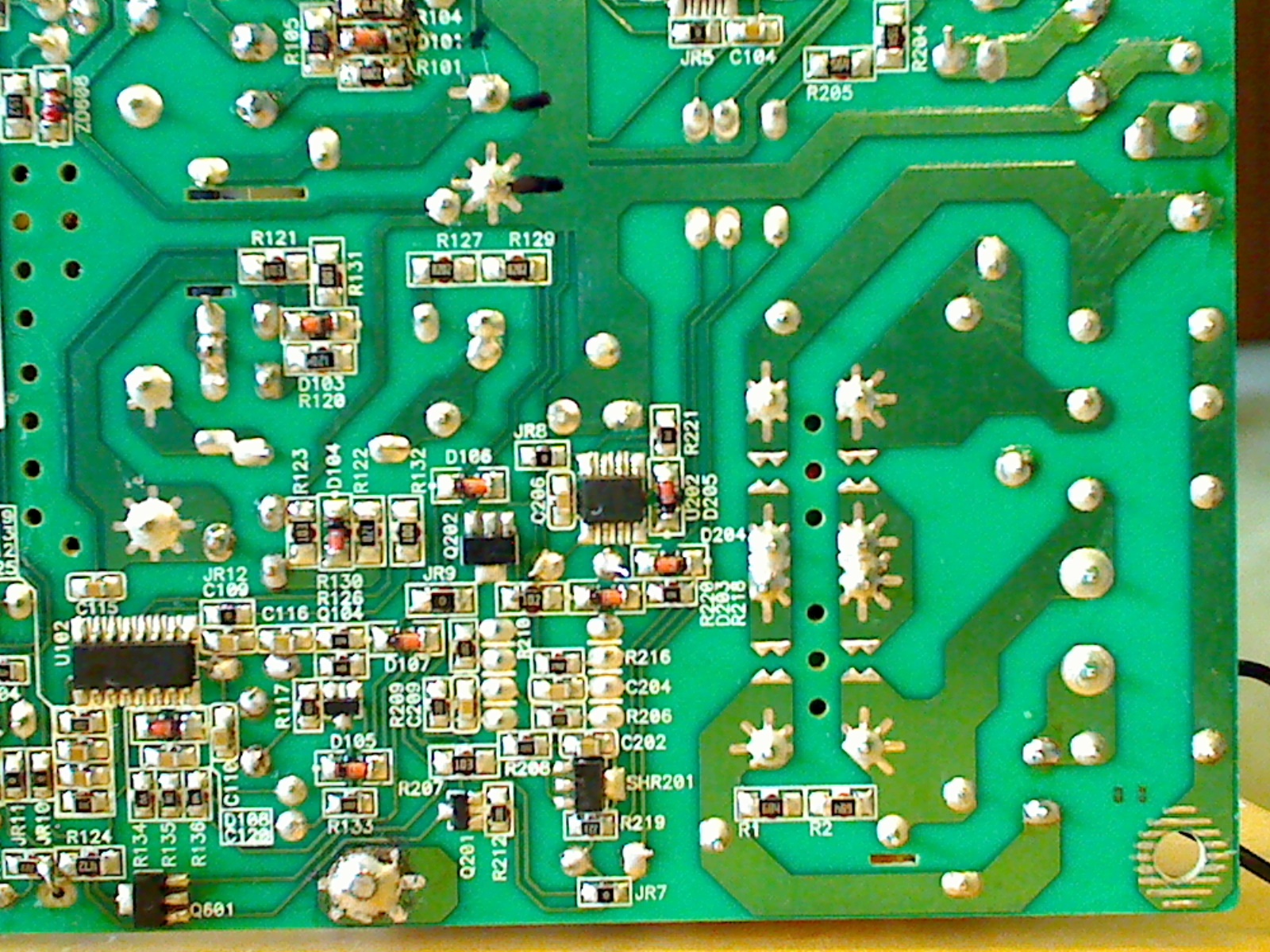

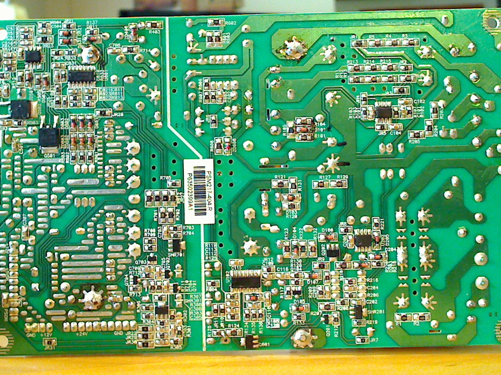

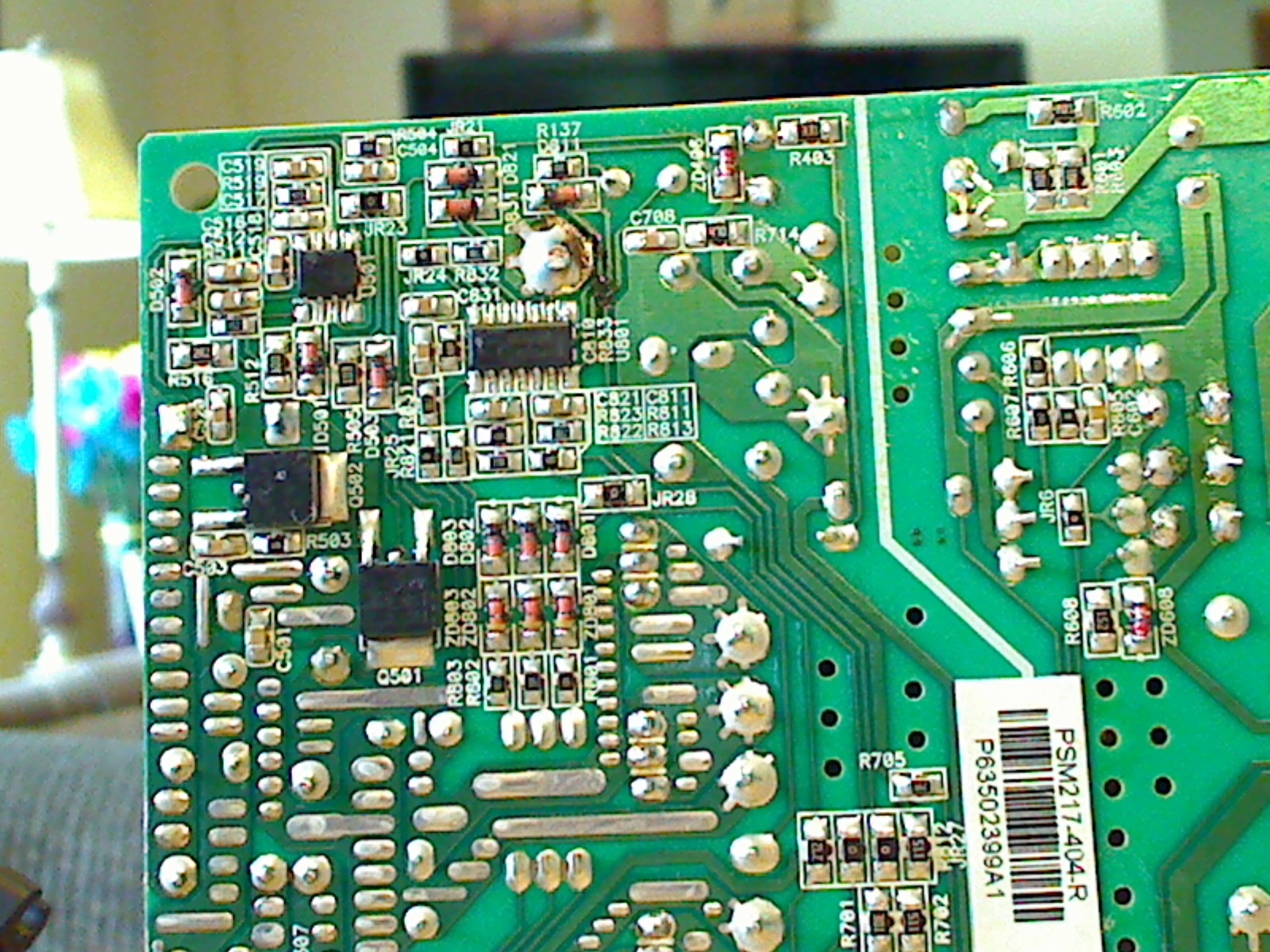

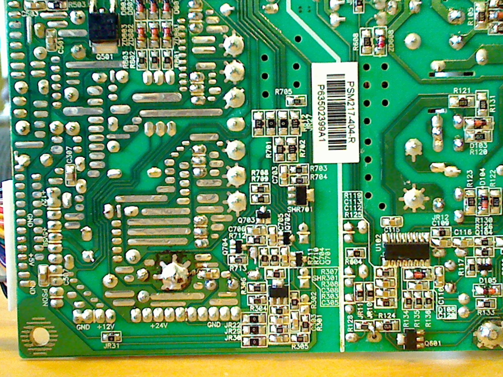

                                  OK, at least the PFC is working. Which two of the MOSFETs you have replaced?

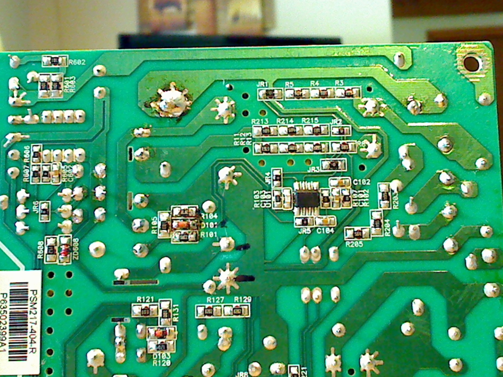

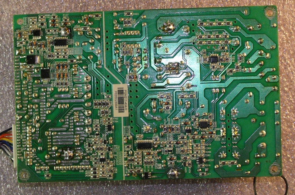

                                  Can you please also post the pictures of the bottom side of the power supply board?
                                  • CraigR
                                    • Dec 2013
                                    • 959
                                    Q102 and Q103 I replaced. Hope this picture helps.
                                      OK, so those two MOSFETs are used for driving that main power transformer.
                                      Please take the staright shot pictures of the bottom side in 4 sections so I can trace out the connections.
                                      • CraigR
                                        • Dec 2013
                                        • 959
                                        This is about as good as I can get.
