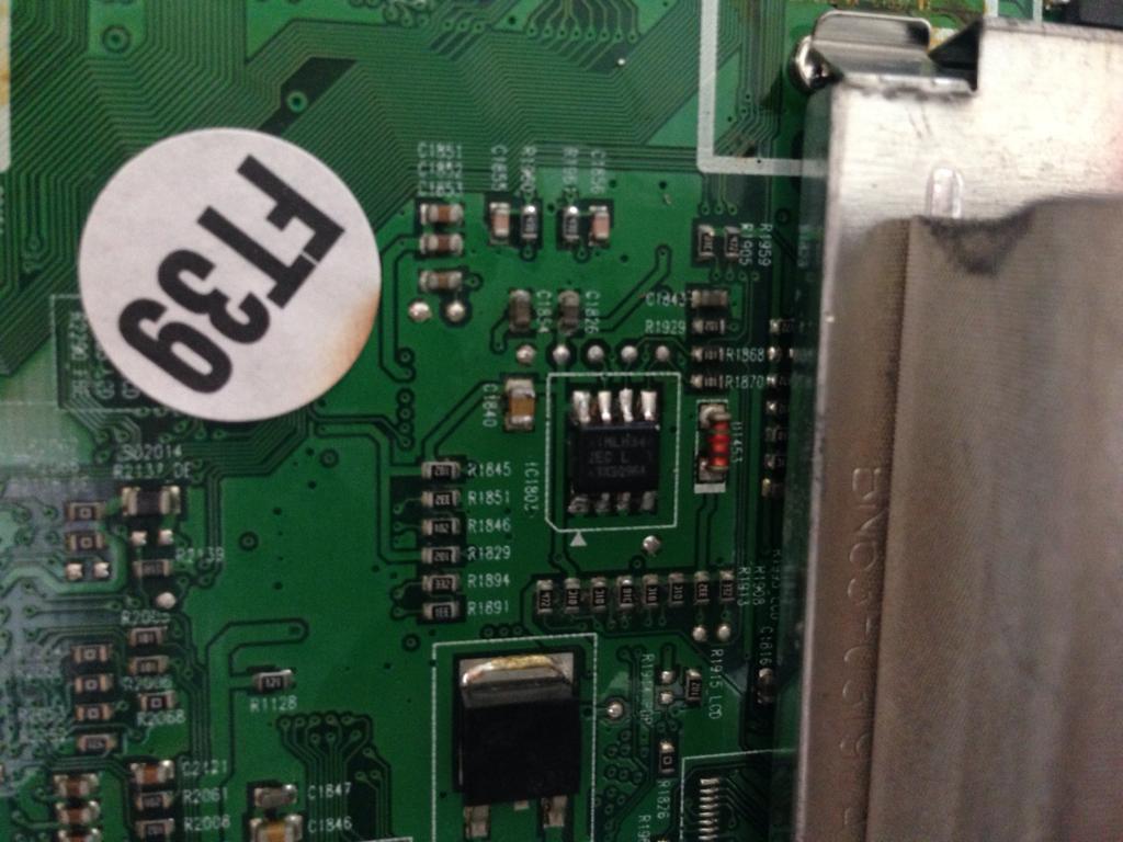

    Says to replace secondary side capacitors and if tv fails to power up replace the EEPROM IC1803 on the mainboard.
    Being slightly naive I replaced the caps, tv still clicking, unhooked the mainboard and jumped pins 1-3 and the powerboard clicked on and didn't click off, I assumed it must be the mainboard so ordered a new EEPROM.
    Few days later Installed the EEPROM and of course the TV still clicks.
    Apparently according to another forum you can remove the EEPROM and power up the tv, if you get 'snow' ie analogue signal but no digital service. Then the EEPROM is at fault and needs replaced.
    I removed the EEPROM completely and the tv still clicks away. Therefore I'm assuming the powersupply has an underlying fault.

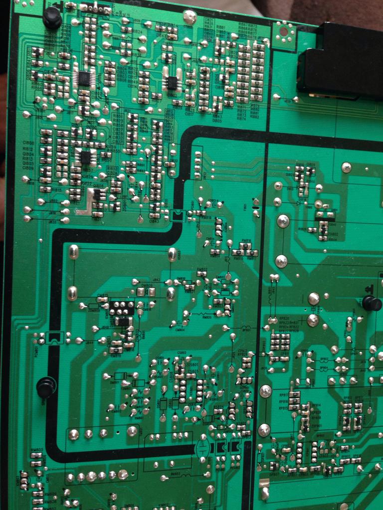

    EEPROM replacement.
    Heatsink that gets roasting and replaced capacitors.

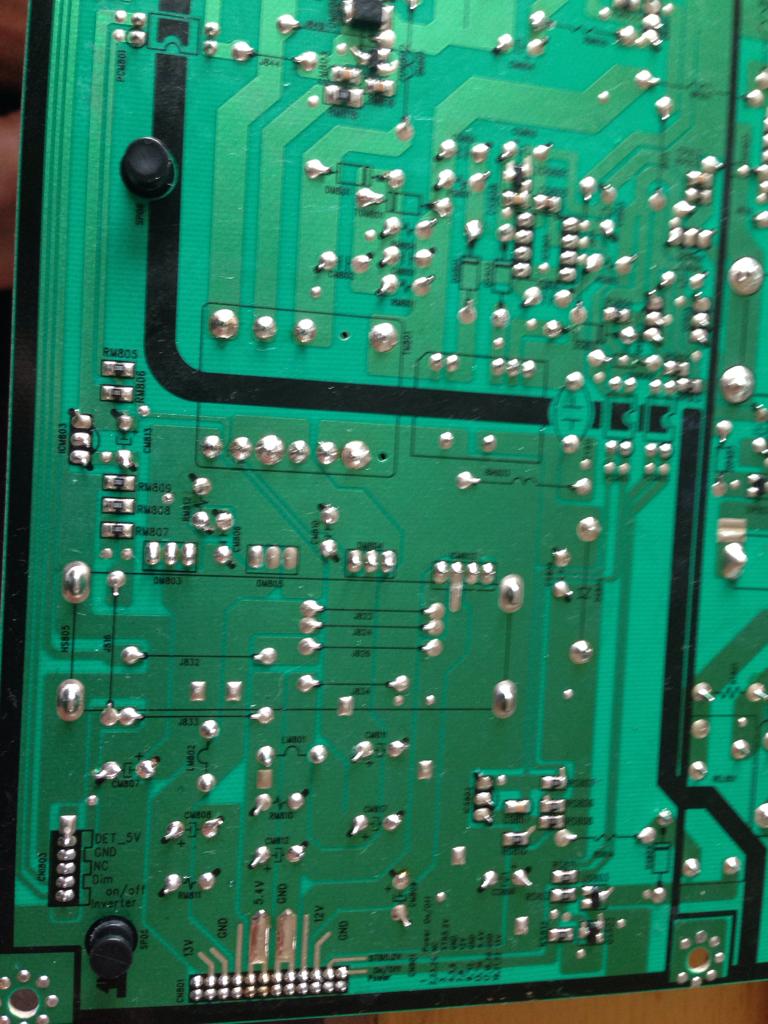

    Powerboard
    Soldering work on replaced caps, diodes and IC
    Underside of board.
    Any other pics required please ask.
