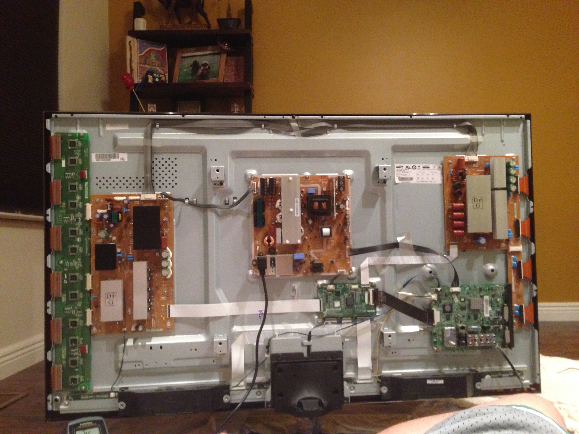

    Hello, I have a Samsung PN51D550C1FXZA which has a start up clicking issue. The red LED up front will blink twice 5x then nothing. I've tested some components on the boards and my findings are below. Any help that can lead me fixing this issue via replacing components or boards would be greatly appreciated.
    All boards connected. (tv clicks and led blinks)
    No PS-Vs, PS-Va, Y-Vs, X-Vs, VSCAN or Ve reading
    All boards connected but all ribbons removed from the main board. (tv clicks and led blinks)
    All boards disconnected from the PS. (no click and no led)
    Only logic and main board plugs removed. (no click and no led)
    Only Y-main plug removed from PS but ribbons connected
    PS-Vs goes from 207 to 0, PS-Va goes from 58 to 0, Y-Vs=0, X-Vs=0, VSCAN=0 Ve=0
    Only X-main plug removed from Y-main board but ribbons connected (tv clicks once)
    PS-Vs goes from 207 to 0, PS-Va goes from 58 to 0, Y-Vs=207 to 0, X-Vs=0, VSCAN=goes -187 to 0 Ve=0
    Only X-main plug removed from Y-main and X-main ribbon removed from main
    PS-Vs 11v, PS-Va goes from 58 to 0, Y-Vs=11v, X-Vs=0, VSCAN=goes -187 to 0 Ve=0
    All Y & X main plugs and ribbons removed
    PS-Vs=239v, PS-Va=58,Y-Vs=0, X-Vs=0, VSCAN=0 Ve=0
    Only Y-main ribbon with X-main plug and ribbon removed. (y-main plug still connected)
    PS-Vs=207v, PS-Va=58,Y-Vs=207v, X-Vs=0, VSCAN=-187v Ve=35.0mv
    Any suggestions on whats going on and how to fix it would be greatly appreciated.
    Thanks in advance

    I'm confused why when the Y-main is plugged in but the x-main cable and ribbons are removed I have no voltage till I also remove the Y-main ribbon. Can I conclude that the x-main is bad?
      Re: Samsung PN51D550 Clicking and blinking led
      Could you include a picture of the parts in the TV so we can see how it is laid out?
        Vola!

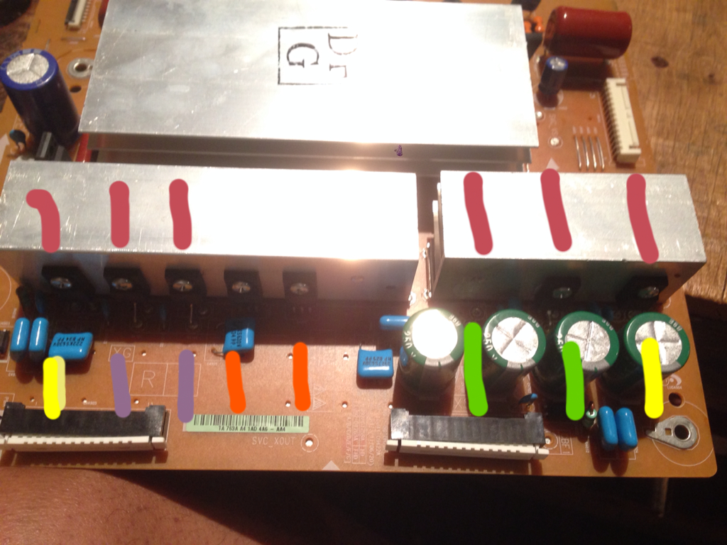

          To me, it looks like a Y-main fault.
          Samsung plasmas shut down Vs/Va after a few seconds if X- or Y-main activity is not detected. You have very low Vs without Y-main, but you do get brief Vs with it out.
          It is possible both X- and Y-main are bad, so try checking the transistors for shorts too.

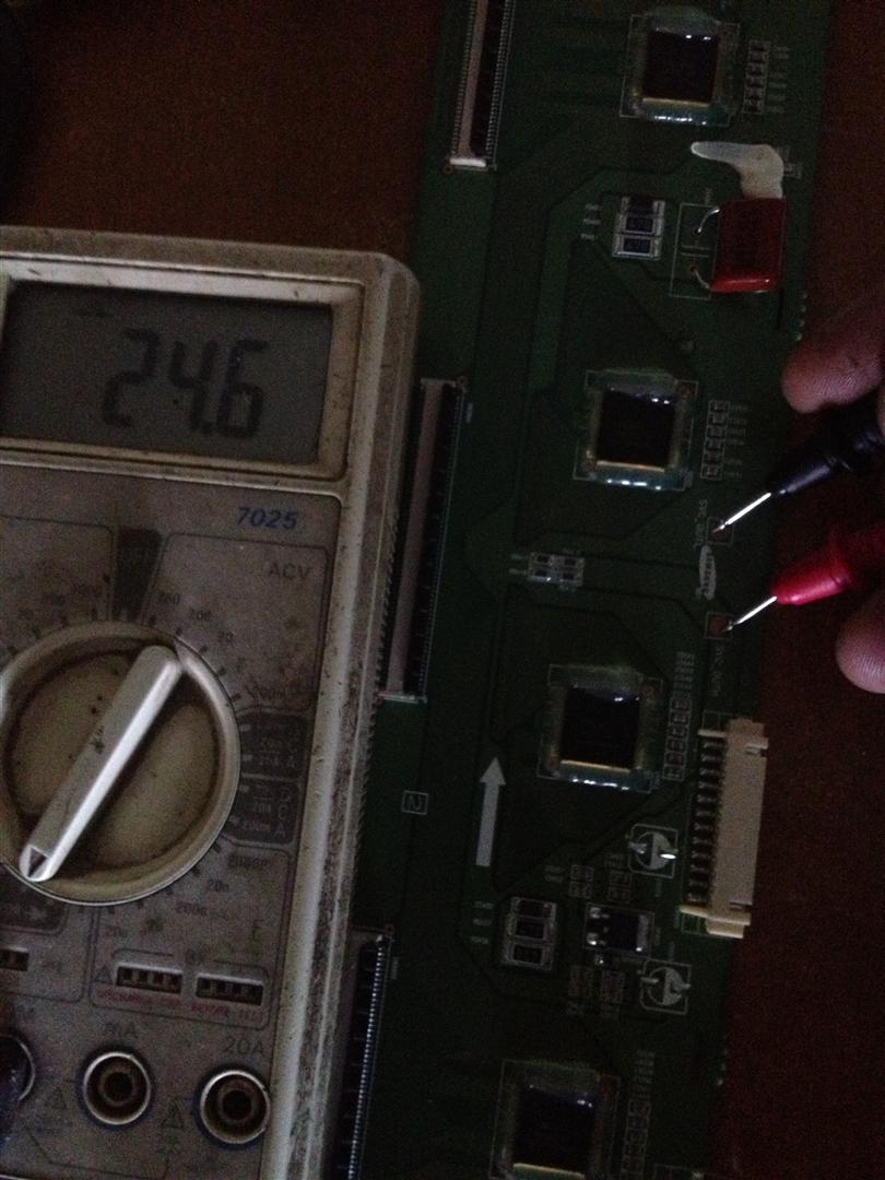

            On bufferboard(far left narrow board) just above the top white connector you find two test points,SVC_OUTH and SVC_OUTL.
            CAn you measure resistance between those two with ohm meter?
            If bufferboard is shorted,you will measure around 24ohms.....

                This SVC checking should be done by disconnecting the yboard from the bufferboard,its purely to test if the bufferboard is shorted out.
                SVC_OUTH<<-----OHM----->>SVC_OUTL

                  See pic for sample,this one is shorted out as you can see from the ohm reading....sry about the dark pic...
                  Proud owner of dozens of broken TV's and many,many,many boards.
                  Our website and passion:http://hollenhundshepherds.com/
                    Any value than a few 100kohm is bad across those points.

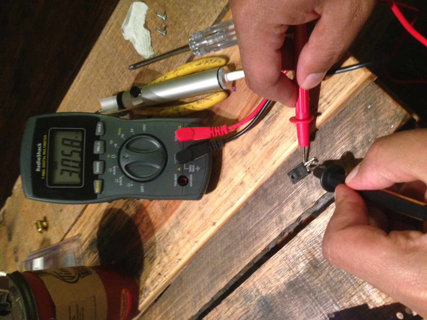

                            Ok so I removed the y-main board and removed 2 of the transistors on the board for testing upon removal I found that I can only get a reading from touching my negative lead to the collector and the positive lead to the emitter everything else gave me an O.F reading. Based on what I've read online I'm guessing this means I have a bad transistor (Fairchild - FGPF4536)?

                              Ok so I woke up this morning and did some more research on how to test an IGBT transistor and found out that my transistors are OK. Any suggestions on what to test next.
                                Test all the transistors you can see. You don't need to remove them for checking for short circuits. Simply test across all three pins (1-2, 2-3 and 3-1)
                                  Tom66 what setting should I have my DMM on and what values I'm I looking for?
                                    200 ohms. Any reading lower than a few ohms is suspect.

                                      Ok so everything seems to check out on the y-main board. So I took out the X-main and test the transistors and found a couple giving me a short reading and <20ohms. So I desoldered the transistor and it still tested short on all legs and <20ohms. Its a RJP30H1 transistor and I've also noticed all the transistors on the same side of the board are testing the same way in circuit (short and low ohms). Please refer to the pic the transistors with a red mark are testing short in circuit and low ohms. The yellow transistors are model #AUK-61825-SF10A400H Purple# 30G124 Orange# AUK-91811-SMK1820 Green# RJP30H1.
