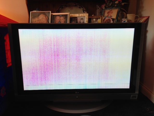

    lg 50pc1d zsus or ysus fault?
    Hi any advice as to what the problem looks like? Im thinking ysus or zsus fault? I can get this quite cheap but dont want to buy it if its unrepairable

      I wouldn't bother with these. They are nightmares. You are probably looking at a Y-sustain fault and that single line may be a panel problem or a buffer board problem. After you fix that fault you can look forward to LG sparklies, which may need to be cured.

        Re: lg 50pc1d zsus or ysus fault?
        Ok thankyou tom I will leave buying the tv then
