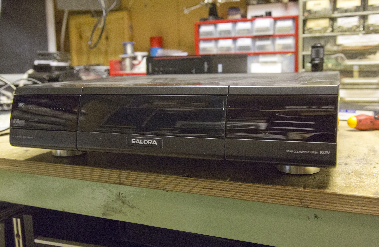

    Does anybody have it, or does anybody know who made the unit? Toshiba and Sanyo parts inside.
    It was the upper end model in early 1990's.​ It even has the audio recording balance and volume knobs.Click image for larger version

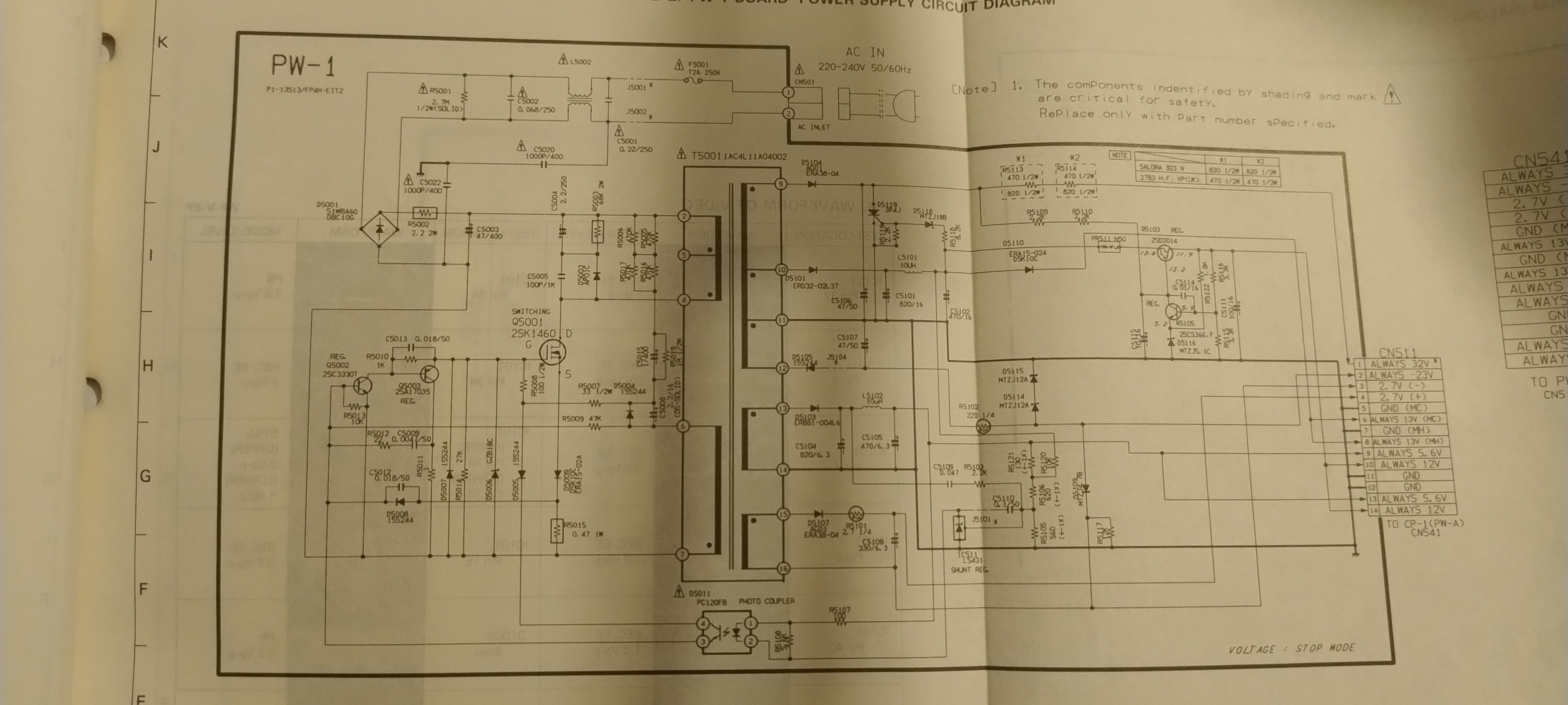

    Not sure if this will help or even the right schematic - hope it helps - Good luck mate!

        The schematic looks like correct, at least the conncetors have same name. Maybe the fault is in the PSU, as only sign of life is the red light in front panel.
          Pins 3 and 4 have -18 and -13 V instead of those in the schematic. Others are almost exact.
            That is because pins 3 and 4 are not referenced to ground, check the voltage between pins 3 & 4, it is likely correct (it likely fees the vfd heater pins)

                A good place to start is checking the electrolytic capacitors, probably all original.
